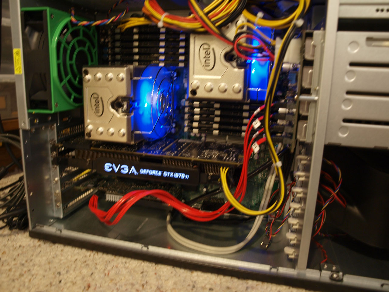

    Today's freebie was a Dell Precision T5400 w/ 2x 5450 CPU's @ 3GHz, 16gb FBDIMM's, 1tb HDD, with a quadro 310. Working condition. Tossed Mint 20.2 on it... For some reason Mint only sees half of the 16gb RAM, but windows sees it all....
    Of course this post from it..
    Fixed the RAM issue...it was the usual crudded contacts.... Weird that BIOS showed all 16gb, windows would show all 16gb, but only say 8gb available.... Mint only saw 8gb. After cleaning contacts on all modules and slots, all RAM is there.
    Researching reveals this system supports crossfire....hold my beer, I'm gonna try something!
            Confirmed. The T5400 and the T3400 both support crossfire.

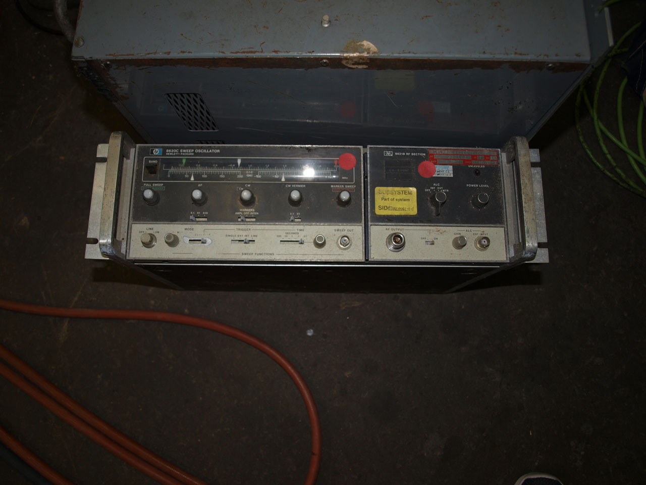

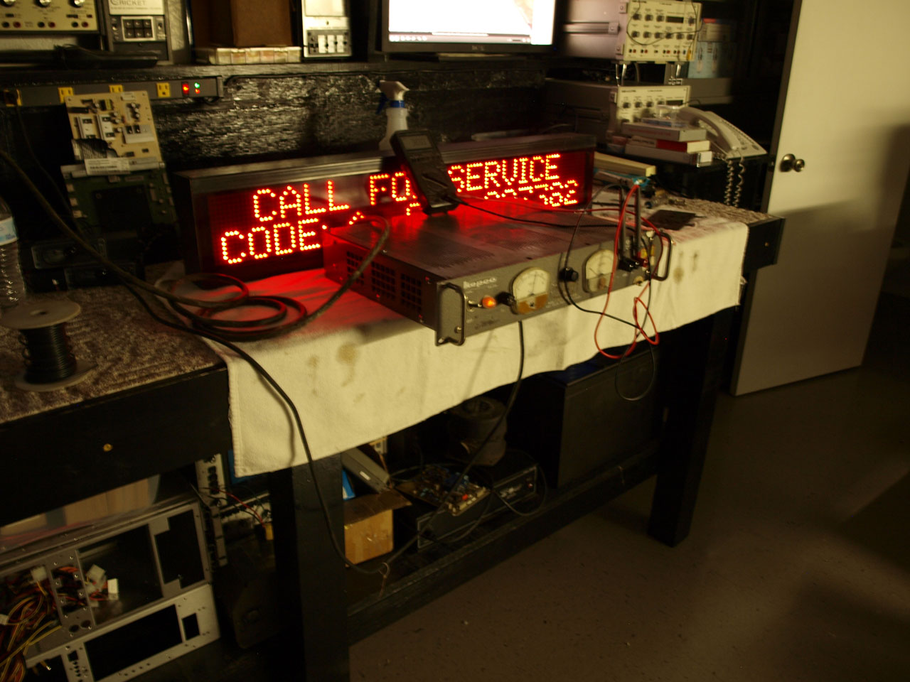

                Today's freebies from a telecom engineer are:
                Old HP sweep marker generator.
                An old tube-type variable 500v @ 300mA x2 channels regulated HV DC power supply:
                Another regulated variable 0~36v @ 2a DC power supply:
                Some old radios.
                An old LED programmable sign..... "Cybernetic Data Products model ADT 7405", nothing out there on this thing. Programs through a serial port....but couldn't find any software. It does power up/work though.....
                The pick of the litter; 70's vintage Sansui 4 channel receiver amplifier...working but needs the usual pots cleaned (crackling volume control)...
                Not too bad!

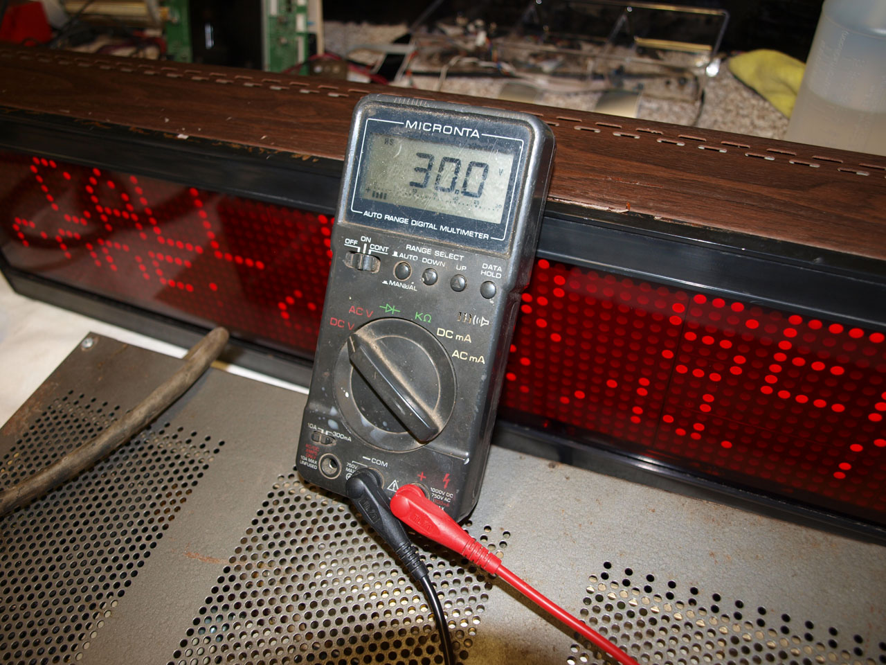

                    The sign and the 36v DC power supply.... That's all the sign does, probably the default if no programming. The PSU powered up.
                    I didn't put a load on it, but seems accurate. Has a cooling fan in it that's scraping on the case, I'll have to fix that.

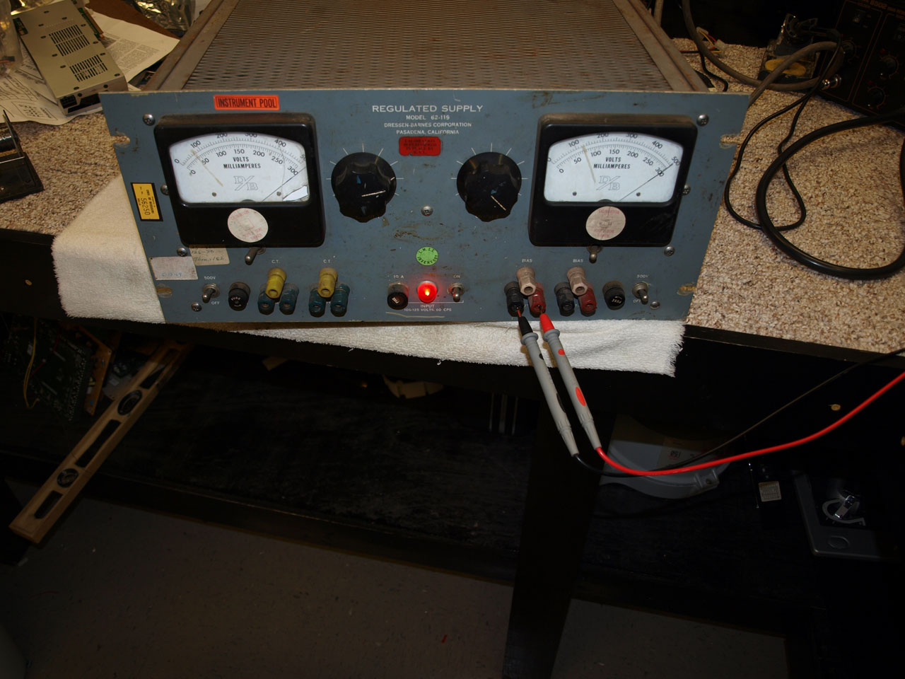

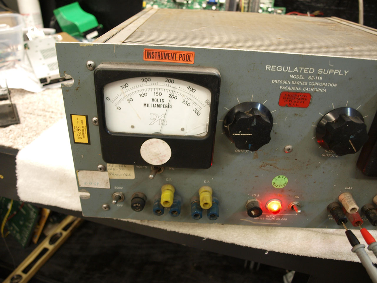

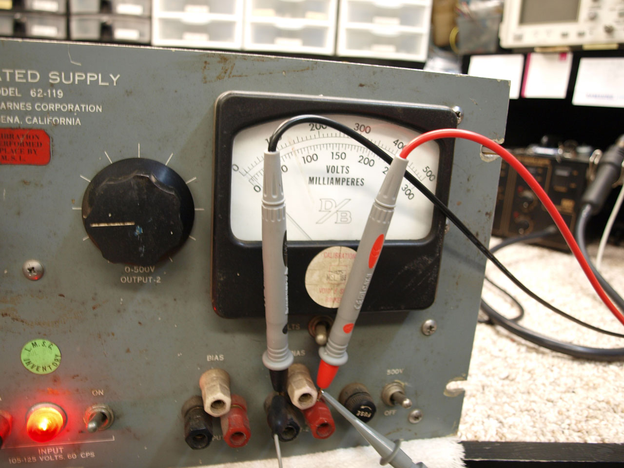

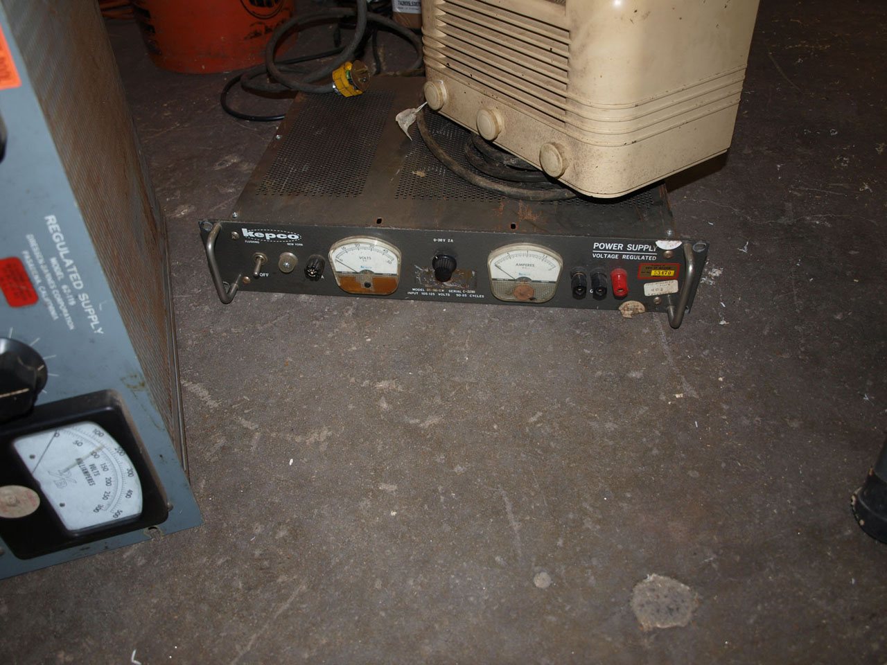

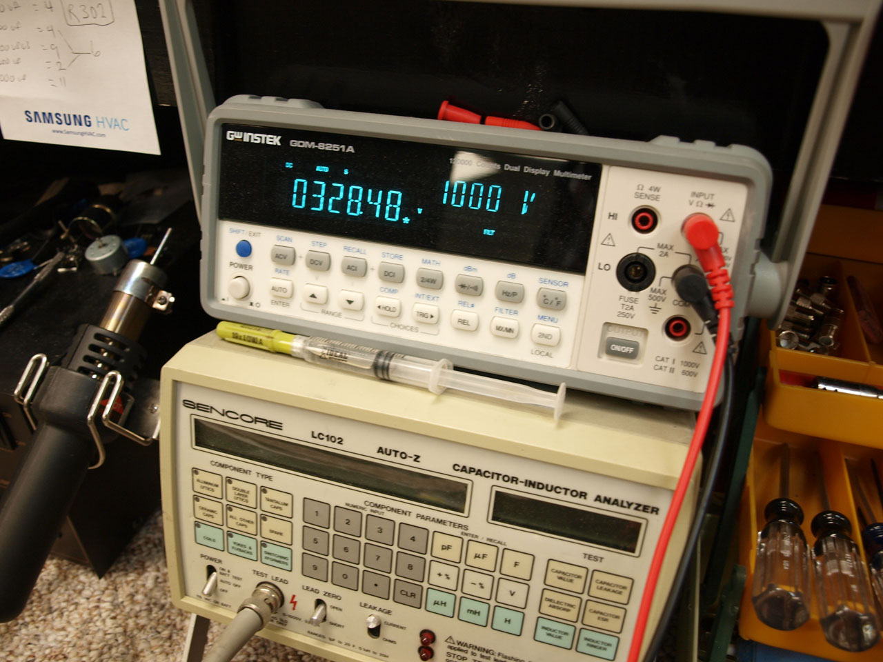

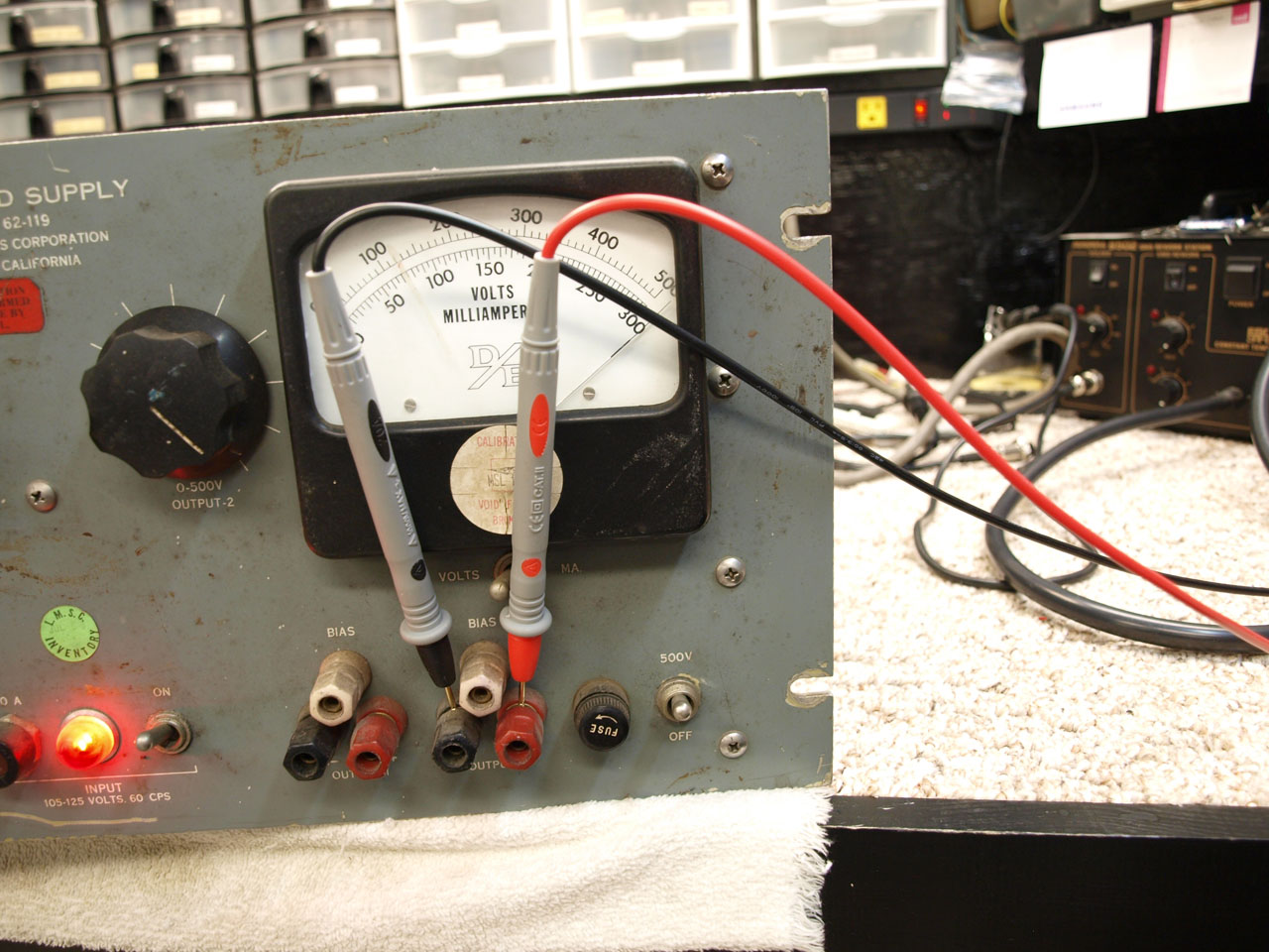

                    Now for this engineer slayer! This thing could kill you real dead real quick if not respectful of it. Especially this one. Output 1 is malfunctioning.
                    Output 1 isn't dead; IE, no/low output...it's putting out way too much! With the rheostat all the way down it's ~300v.
                    This is about 3/4 the way up, maxing out my VOM. Any higher, it just displays o/l. I measured it with my scope wide open; it's safe to 2kv through the 10x probe. It topped out at 1450vdc! I didn't snap a pic though.....but below....yea, that's over a 1kv on the old GW.
                    Now for output 2, which appears to be functioning as it should. Rolled all the way to max.
                    What's on the gauge on par with the meter.
                    100v cal check....
                    7 volts off.....but who's counting....
                    My scope concurs with the meter by a .4v margin.
                    Rolled all the way down. Lowest it would go is 12v.

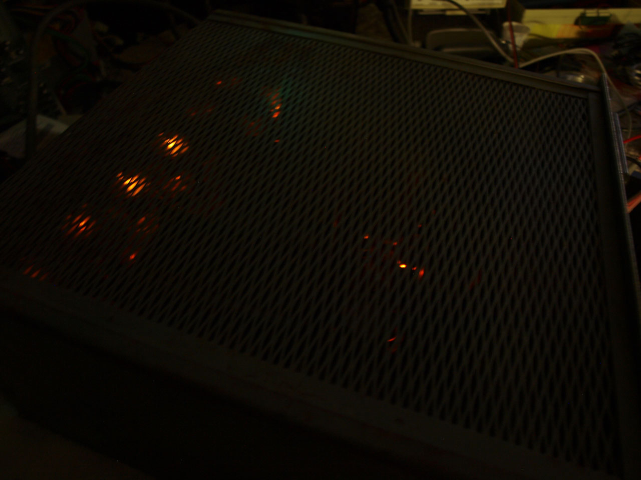

                    Lights out to see some glowy tubes!! This thing created some heat and of course had that 'smell'.....that glorious smell old electronics have when hot!
                    Rudolf with your nose so bright.....
                    That concludes today's free fun!!

                      #5070
                      the led sign probably has a leaked nicad battery in it - i fixed one before with that issue.
                        Niiiice!
                        Be sure to check the caps in it, if they are bad you might burn out the tubes...

                            Niiiice!
                            For sure. I also need to figure out why output 1 puts out nearly 3x what it's supposed to!
                            And if you do pronounce it, I claim dibs!
                            If I can't figure it out, it's got your name on it.
                              Maybe it is correct, don't you get 500v from positive to the center tap and then -500v from the negative to the center tap? (Edit: no, I see it says "bias" and not "CT" as I first assumed).
                              Also take a peek inside the unit, maybe it will have a electrical schematic attached somewhere.

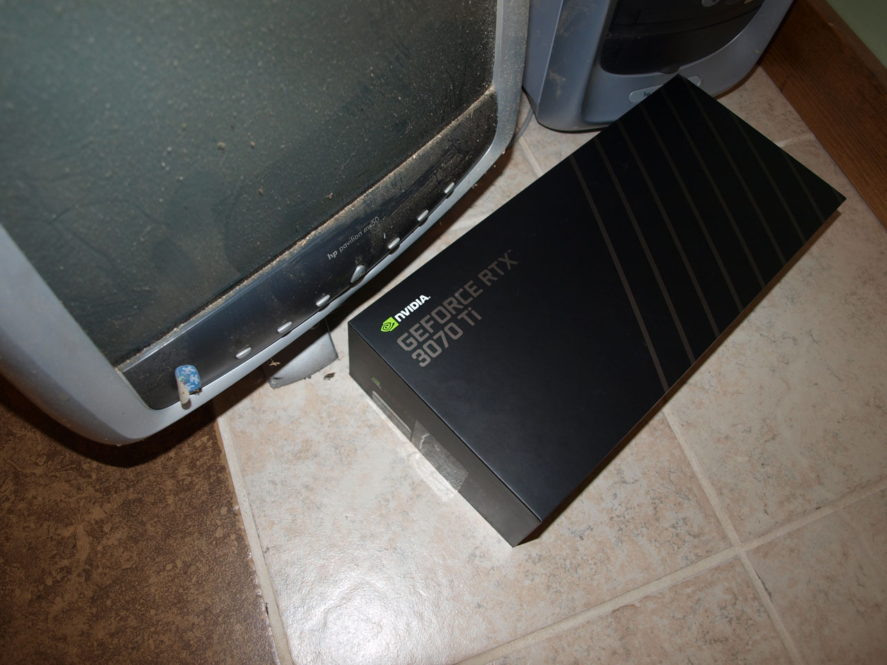

                                      Today was another interesting day. It started with a phone call at 9:30am from a guy that had a 70" 4K TV hit by lightning and needed it checked out for his insurance company. He said I can keep the TV, he just needs paperwork for his insurance claim....ok, no big deal, I do this all the time....but the free 70" 4k isn't the whole story....just keep reading!!
                                      It was wall mounted and he was older, so I went to his house to pick it up. I got it down, loaded into my truck. Of course being wall mounted, the feet are missing.... :-/
                                      Anyway....I'm not sure if the mainboard or the power supply (or both) are bad.... Has red standby light, press power, the STBY light flickers for a split second, and that's it. Never does power up.....I didn't dig into it that deep....but it looks to have been buzzed. The power supply is missing some voltages and the processor gets VERY hot. It's a 70UH6350.
                                      Here's where it starts to get interesting....he asks since I took the TV, would I be willing to take some computer stuff his grandson left in his garage when he left for college a couple weeks ago that's out of state, and told him to get rid of it......of course he tells me his grandson is a computer expert and knew more about tech than all the instructors in high school, and builds massive PC's for everything short of NORAD (yawn yawn, I hear that all the time)....so I'm skeptically optimistic that I'll find some kickass system out in the garage.....well, it's complete....but at no point was it ever 'kickass'.....complete HP P3 system including CRT monitor, tower, KB/Mouse, disks, some other flatpanel monitor, and a box with some empty boxes that hardware came in.
                                      I was just going to pitch the box full of empty boxes in the dumpster....there was the box for a wifi router, a box for a NVMe SSD, a box for a 32gb DDR4 RAM kit, all empty....and then a box for a RTX 3070ti....and it felt a little heavy to be empty.....
                                      Ok, those of you that got excited and thought there was indeed a RTX 3070ti in there, sorry to disappoint you.....but it wasn't a total loss....
                                      This is what was in the box:

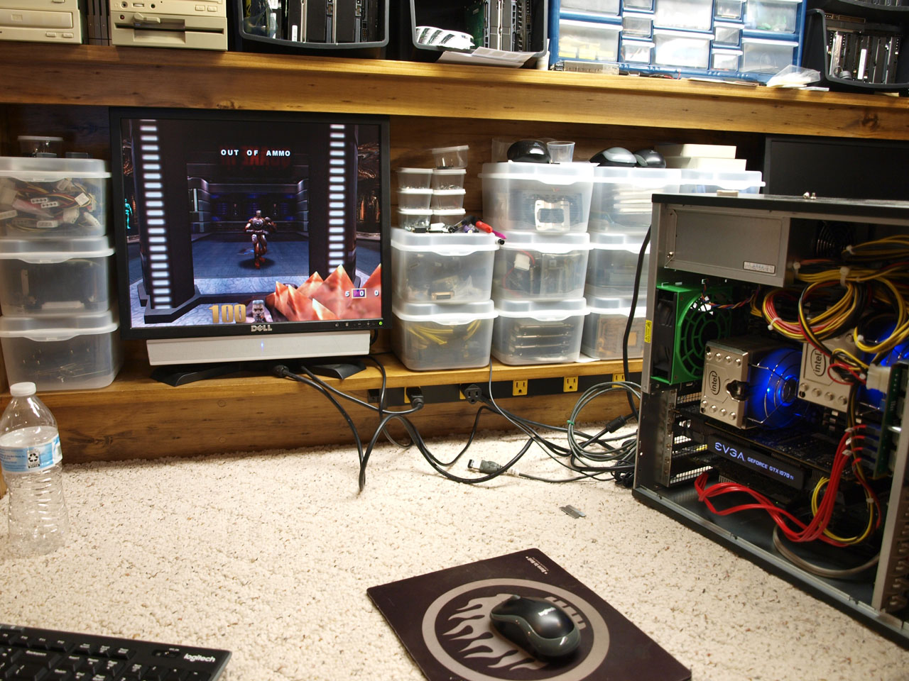

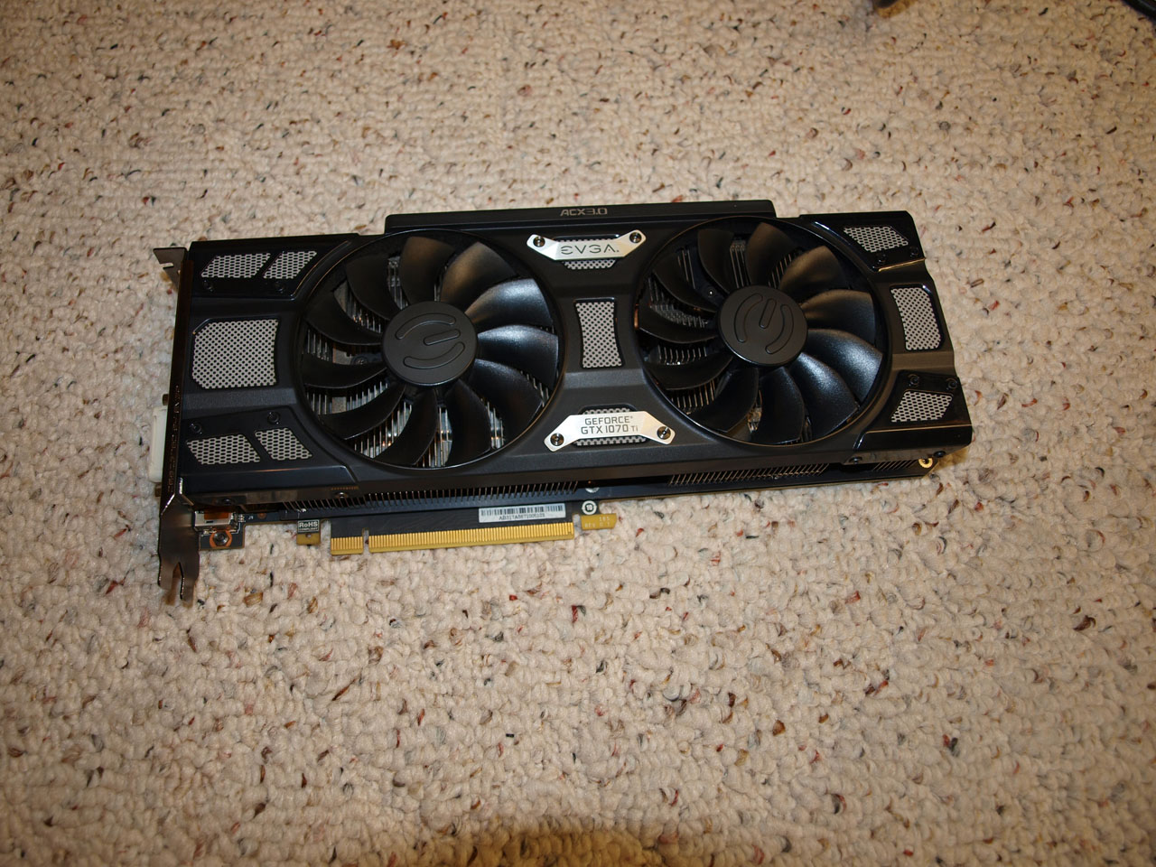

                                      Ok, I'm thinking the same thing you are; this thing has to be bad....nobody just tosses a 1070ti...even though gramps is a doctor......the card has to be bad....
                                      Well hmmm.... It's POST'ing...
                                      Installed the driver, no problems.....and even a little quake.... I did some other testing as well, it never missed a beat! WTF!! Is this kid really this spoiled?

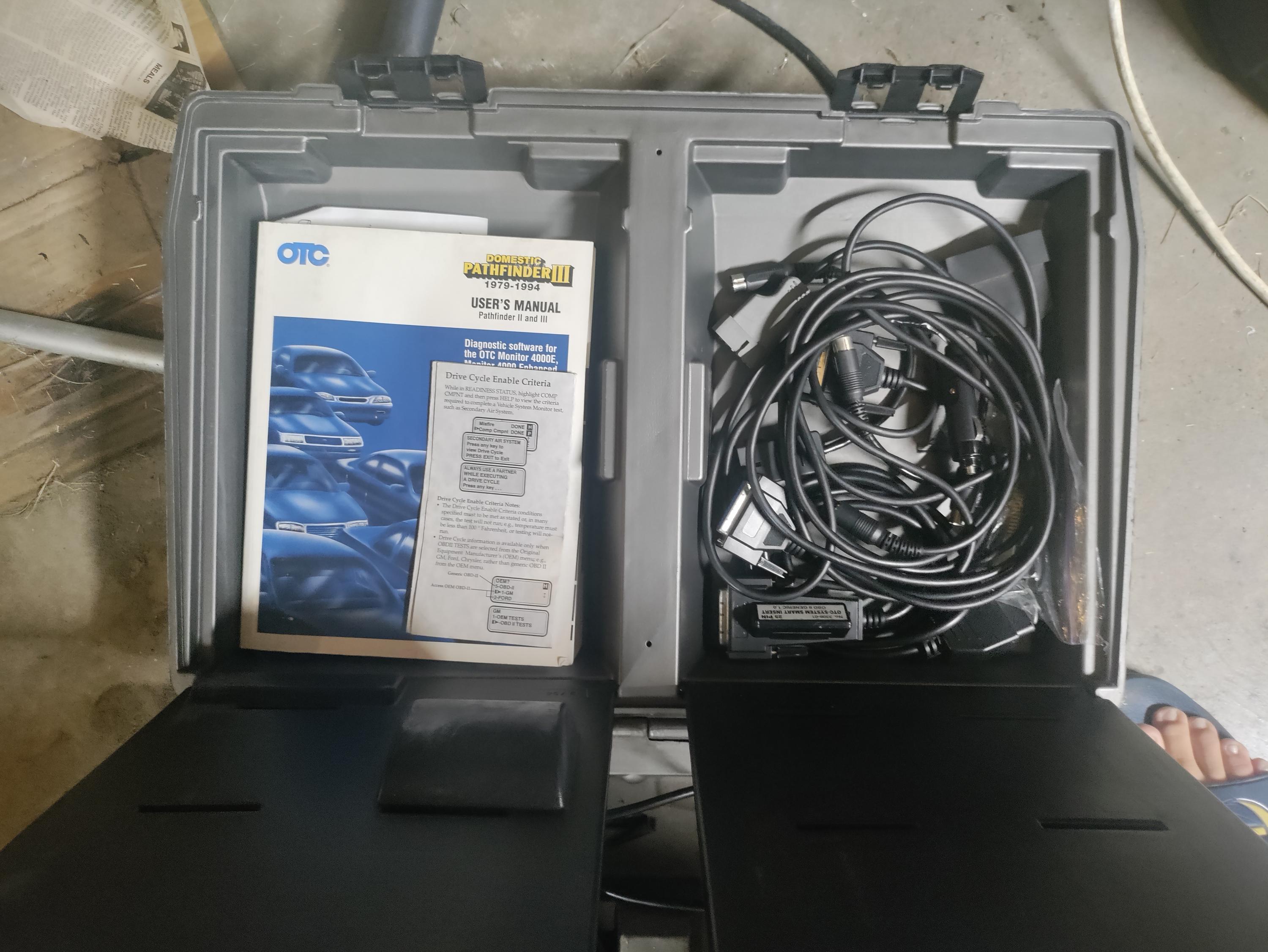

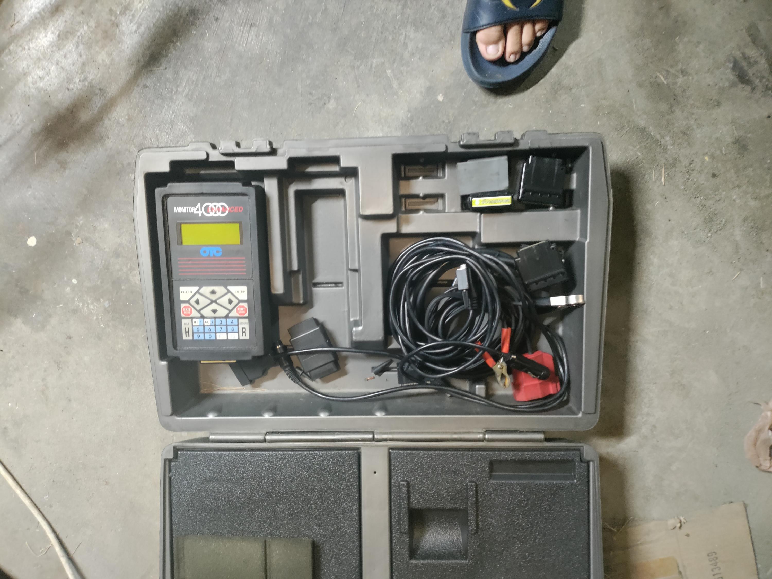

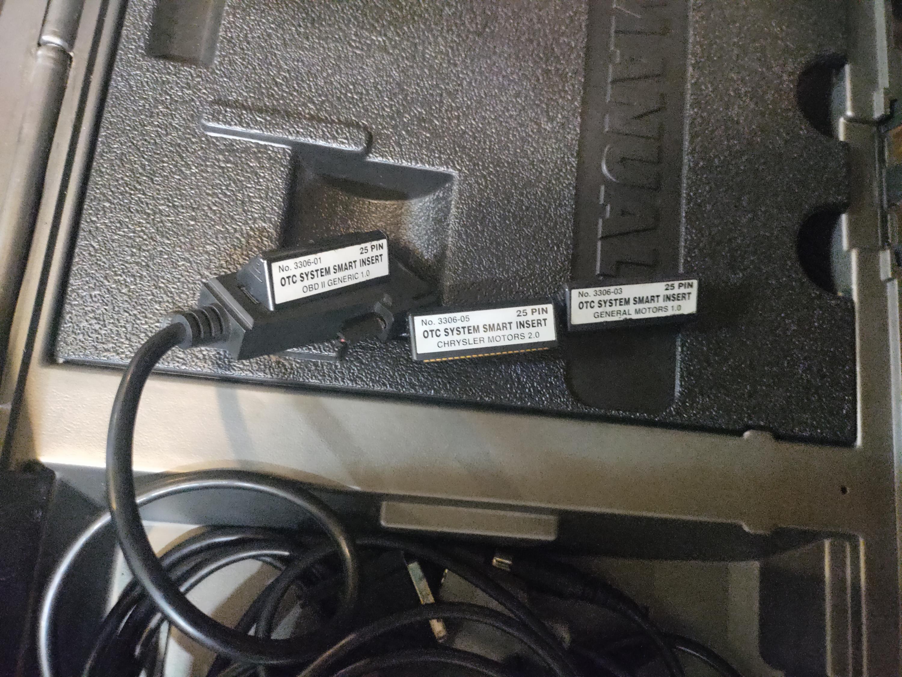

                                        for $10, an OTC Pathfinder scan tool set (OBD 1 and 2).
                                        Nice find!
                                        RIP to the mechanic and HVAC tech whose tools I was buying from... I will see they get put to good use!
