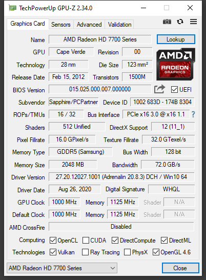

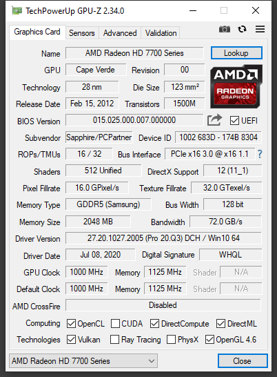

                        Some pics & screenshots of GPU-Z...
                        GPU-Z; says made by Sapphire....but detected as HD7700
                        Case:
                        Bottom with P/N tag:
                        Back of card. I didn't get a great shot of the label....but its pretty legible.
                        Back again, and pic of the other label....this one came out more clearly.
                        IO Panel.
                        If I run the PN on the bottom of the card (7120a001h1g), it comes back to a HD7700.
                        If I run the number on the back of the card (H88-3E243-101A8), it comes back to a HD8760
                        Now play 'name that card'!!

                          #4652
                          LOLLOLLOL.
                          So, based on the pics, I think we can rule out it being a counterfeit or cheapo China built.
                          PCB is marked "Advanced Micro Devices Inc. Model: c468", which is legit PCB for Radeon HD7770 series.
                          And apparently, Sapphire really must be making these for the OEM market, because there is a BIOS page on Techpowerup for your particular card:
                          https://www.techpowerup.com/vgabios/175872/175872
                          On the bottom of that page, the card is described as Sapphire HD8760, HD7700 series.
                          But here is where it gets interesting: both the HD8760 (Latte XL core) and HD7770 GHz Edition (Cape Verde XL core) are listed to have 640 unified shaders / cores, but yours has 512. This puts it on par with the HD7750 (Cape Verde Pro core):
                          https://www.techpowerup.com/gpu-spec...n-hd-7750.c309
                          BUT.... your card has a PCI-E power connector and has the same core and memory clocks of the HD8760 and HD7770, rather than the slower clock of the HD7750. So it's not quite a proper HD8760/7770 GHz edition, yet not quite the slower HD7750 either.
                          Side note: HD8760 OEM and 7770 GHz edition are rated at 80W TDP, whereas the 7750 is rated at 55W. Looking at the heatsink on your card, it looks the same as what was included on my HD5750 - also an 80-something-odd Watts card. The stock cooler was good for idle/browsing/office use, but quickly got toasty with load. It couldn't keep the core under 65C, and it ended up dead over time. So if you feel experimental, you can check the HD7750 BIOS to see what clocks and voltages it uses, then reduce yours to the same. It will make the card slower, but will likely run a lot cooler too.
                          Whichever the case, it's a Cape Verde card, so I suppose it doesn't really matter as which the drivers pick it up.
                          That said, I noticed the GPU-Z screenshots you included had a red-blue hue on the text, which I initially thought was the forum image inline resize/compression playing with my eyes. But zooming in shows the hue is still there. Perhaps this is a result of saving the file as JPG instead of PNG? If not, looks like there may be a drivers and/or hardware issue with the card.
                          I also noted you're using the Adrenalin drivers. Try the WHQL / workstation drivers instead... that is "Radeon Pro Software for Enterprise", as I see it's called now.
                          Here are the ones for the HD8760 OEM / HD7770 GHz Edition (Win10 64-bit)
                          https://drivers.amd.com/drivers/prog...0.q3-aug12.exe
                          (On that note, I think AMD includes the same driver package regardless of which card you pick, but for most high end ones, you get a choice of the regular Adrenalin drivers and the Enterprise ones.)
                            Probably a combination of saving as a JPG and using a VERY old program to capture the screenshot (painshop pro 8). This better? Captured from the same system, but saved as PNG:
                              https://www.badcaps.net/forum/attach...1&d=1599932351
                              That works!
                              Though, you do know if you click that camera button on GPU-Z in the upper-right corner, it automatically let's you save a screenshot just of the GPU-Z screen.
                              I think it is GIF format by default. GIF is nice and dandy, but IIRC, the forum attachment feature here automatically converts it into JPG, and that also adds image compression artifacts to the image. So what I do instead is I take the GIF screenshot saved by GPU-Z and open it in MS Paint, then save to PNG format. Then there is no compression artifacts or loss of quality.
                              The thing about PNG is that it doesn't like color pallets. So if you have Aero or something similar, the file can become considerably larger than JPG for the same size. On the other hand, if the image has mostly solid and just standard colors (like Windows classic interface with solid color title bar and Windows 10), the file can be smaller than JPG. In the above case, you can see your PNG is half the size of the JPG file. Saves a tiny bit of bandwidth... though I probably wasted more typing all this text.

                                For what it's worth with this weird card, here's the Pro drivers....still showing as a HD7700.....
                                Yea, I'm aware of the little camera thingy....I'm just old school I guess, and do things the old way, manually......

                                • brethin
                                  • Dec 2008
                                  • 1907
                                  #4656
                                  It's not fake its just a rebranded for OEMs 7700 card. HP Asus and a few others used it. Here is a HP system that offered it. I bet if you use the HP drivers it will show as a 8760. Here is a link to the HP system I know used it. https://support.hp.com/us-en/document/c03650812

                                    The fastest way to tell if it's AMD is they only use odd numbers in the last 2 digits of the card, aka like 7750 7770 7790 etc. If the last 2 digits are even numbers like 7740 7760 7780 it's a made for OEMs rebranded card.
                                      That definitely sheds some light on it...and thanks for taking the time to post that. Ironically enough, it was tested in a HP motherboard, which appears to be a rebranded Asus/Pegatron, LGA1366 Xeon. I'll probably just leave it in this system, its a better card than the Geforce 9800GT that was in it. I'll stick with the ATI pro drivers versus some elderly HP drivers, as performance-wise, the newer would probably be better and without the usual HP bloatware.
