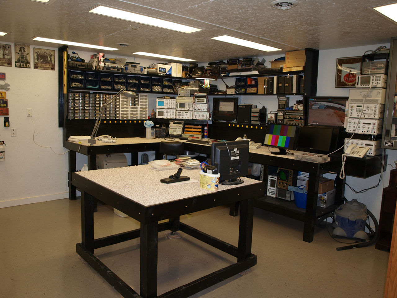

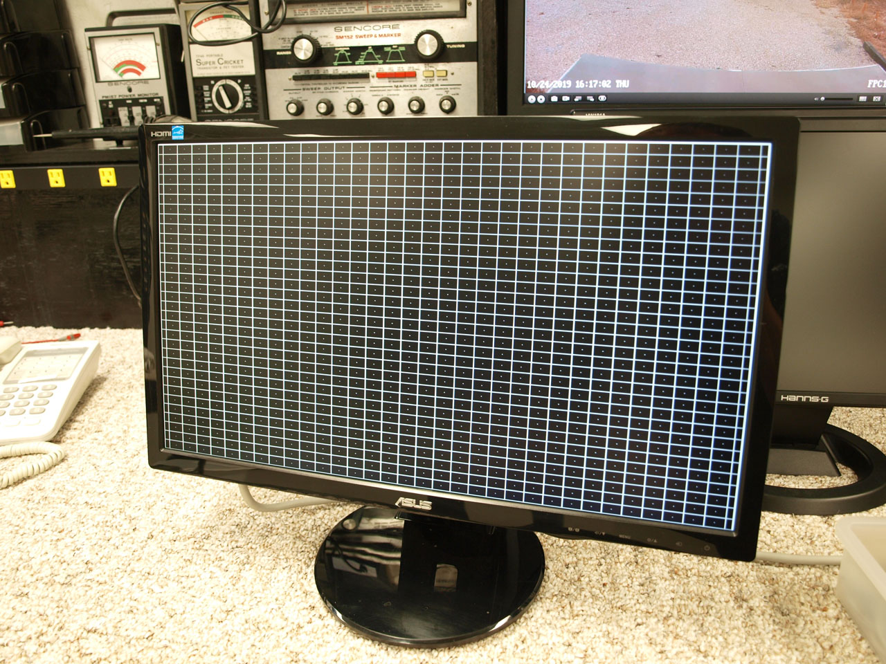

                                      Got an Asus 22" VE228 LED monitor from a local shop. I powered it up, tested, seems ok....but they wouldn't have given it to me for no reason.....so I opened it.... All the "usual suspects" seemed ok. Lousy brands (elite & lelon), but appeared ok. I recapped it anyway. Checking the old ones, they were in tolerance....albeit some close to the low side threshold.
                                      Thinking maybe its got a wonky LED strip when hot, I let the CM2250 run its burn-in pattern cycle for 6 hours, no issues. I guess chalk it up in the 'win' column...
                                      Still pluggin' away at the other projects.... Lots of subtle things in this pic if you know what you're looking for!

                                        #4039
                                        WAYYYYY too clean/uncluttered!
                                        And, look at all that EMPTY floor space!! What do you do, have DANCING LESSONS on Thursday nights?!
                                        • Topcat
                                          The Boss Stooge
                                          • Oct 2003
                                          • 16959
                                          #4040
                                          I can't stand clutter and absolute disarray.... I'm not the tidiest person around....but when I feel the walls are closing in on me from mess/junk, I go on a dumpster filling binge.
                                          The room is 17'x17' or so....and the fact I've got 2 left feet, no dancing around here. The open floorspace where the toolbox was won't be open for long....
