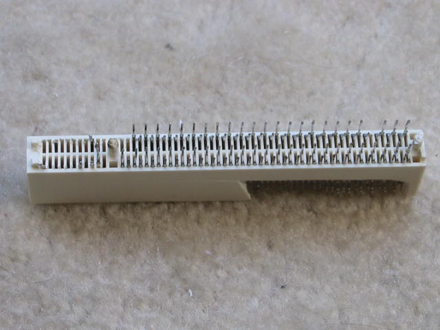

      Just sorted through the new pictures of the Gateway Select 650.
      For those of you not familiar with the Kadoka motherboard, here's a view or two:
      And here is that interesting CPU VRM up close that I was talking about:
      https://www.badcaps.net/forum/attach...1&d=1554953251
      As mentioned, there are no electrolytic capacitors here or anywhere else on the motherboard – just Tantalum caps and ceramic ones. CPU VRM is 4-phase, high-speed switching, and with soldered heatsinks close to the MOSFET's Drain tabs – now *that* is a GOOD cooling design.
      Next, chipset and LPC SIO:
      The whole motherboard cleaned up very easily as it wasn't that dusty. Shame about the broken PCI slot, though. Speaking of which, I just couldn't leave it there like that, so I removed it:
      I suppose loosing one PCI slot is not going to be a big deal, as this mobo had five total before. Four should still be enough for everything I need (audio, LAN, maybe USB2.0… we will see. ) Of course, I do also have a broken (literally, snapped in half) Dell OptiPlex GX260 motherboard that I can pull another PCI slot from. But on that note, does anyone have any tips how to remove slots easily and without damage? I removed the above slot on the Kadoka with my 40W Radio Shack bulb desoldering iron. It was OK on the data lines but struggled on a few of the ground and power lines. Thus, I ended up melting a big ball of solder on one side of the slot pins where that happened in hopes of pulling the slot when I melted the entire solder ball. Unfortunately, that didn't work so well. The solder fell through the vias instead, cooled, and then made it even harder to try to desolder. So that's why you can see the pins on the actual connector are pulled out on one side. Does anyone reckon if hot air / a massive bottom heater will work (without melting the slot)? I might try that with the broken OptiPlex GX260 mobo. I also would like to pull the AGP slot out of that one to try putting it on another Dell board that has the holes for it, but no slot… though, that's for another silly rainy day project.

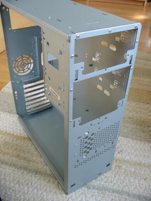

      Anyways, moving on… here is the bare case after I cleaned it:
      Finally a case that isn't rusty! It wasn't very dusty either. Nice heavy steel too, just the way I like it.

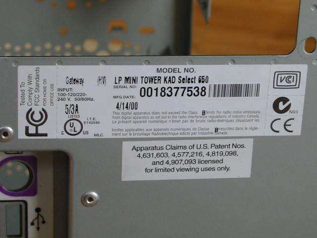

      Also, let's not forget the manufacturing / model sticker:
      Made in April 14 of 2000. Ha! Four more days before its 19th birthday!

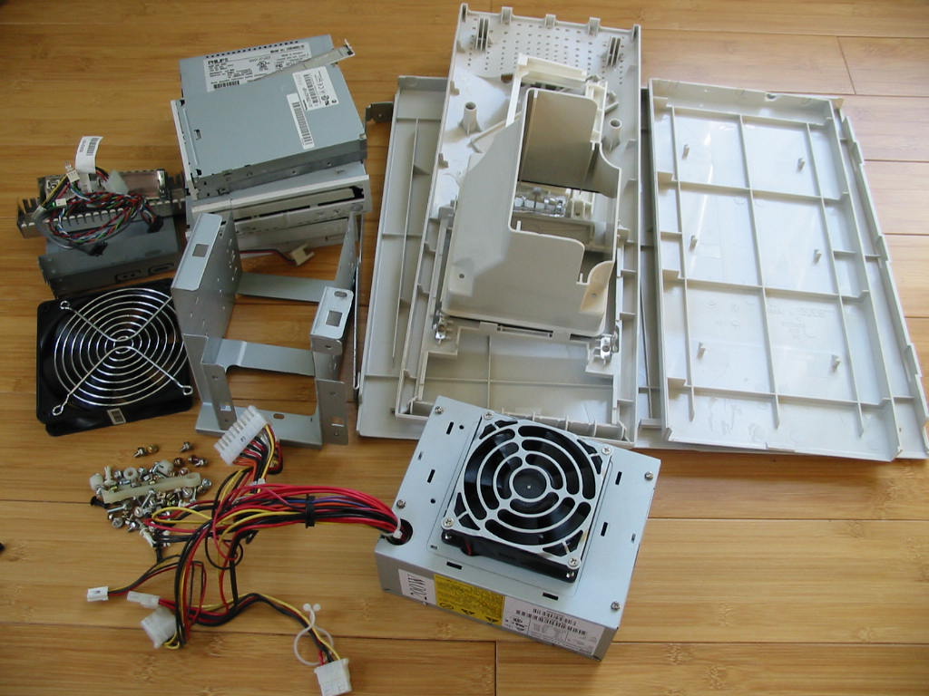

      All the parts that need to go back in the case:
      https://www.badcaps.net/forum/attach...1&d=1554953575
      But before that, I needed to fix a few things. First, the snapped supporting tabs on the top plastic piece:
      PVC glue works great on ABS plastic! It just cures a bit too slow. It's been over a week, and I can still leave an indent on the glue. In some cases, I've had it take almost a month to become fully hardened.
      This is why I often use hot glue in places where it will work fine. Speaking of which…

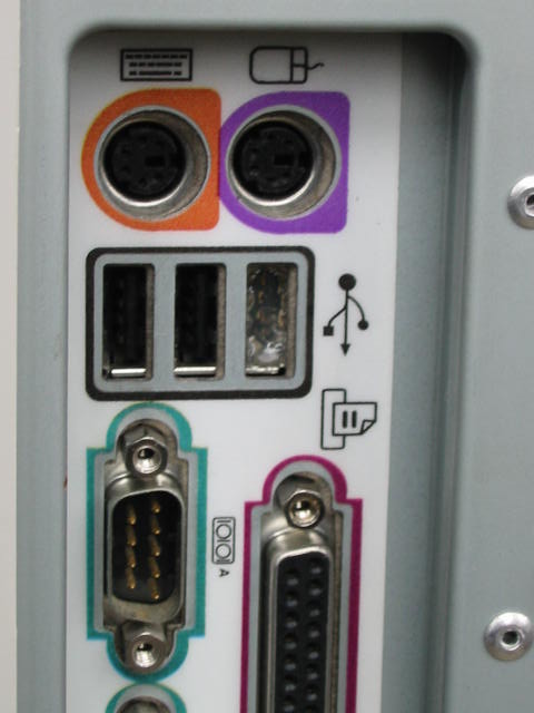

      Just before installing the motherboard in the case, I found that its 3rd USB port was broken and pins inside all mangled up. If it was a dual port, I could have tried replacing it with one from another motherboard. But because this was a single triple USB port, I just un-mangled the pins so that they are not shorting to each other (or the case) and filled it with hot glue. I suppose that is not that big of a loss either, as these are USB 1.1 ports.
      After all of this, it was time to put everything back together – and so I did

          wow, someone did a number on that PCI slot! Very nice rebuild though. anything old & beige always has a place in my heart. Are you going to replace that PCI slot or just leave it vacant?
                          They have indeed.
                          Like I said, I don't know how one can do so much damage. PCI slots tend to be quite tough in my experience.
                          That being said, I think the VooDoo3 graphics card is very likely FUBAR. What I thought was a small scratch on one of the RAM chips is actually a crack, I think. The way I checked: I used a screw driver to scratch the RAM chip in a direction perpendicular to the scratch, and I kept "feeling" the scratch no matter how deeper I went. If that's the case... only remedy would be to find some old SDRAM sticks with 16 Mbit chips... which I have NONE at all. Might put a post up in the "looking to buy" forum when I get to it and confirm if that RAM chips is bad or not. If it is, it's going to be a RAM chip replacement job + who knows what else. But for a VooDoo3 card, I think it's worthwhile.
                          *sigh* monkey technicians at their finest.
                          Will replace it if I can salvage one without damaging it. Already have a few donor boards too.

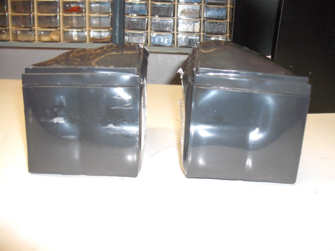

                                    Just about 1T of ECC DRAM sticks (16x32G, 64x4G, 16x8G). Time to take an inventory of currently installed memory to see which machines will benefit from this windfall...
                                    And, another Smart-UPS with the inevitable bad batteries. But, I really had to WORK on this one!
                                    [Cripes, you'd think they could sense when they're cooking the batteries like this and shutdown the charger!!!]
