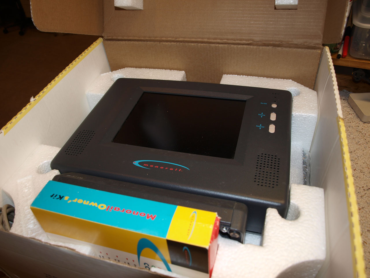

                                      I got a call this morning from a friend of mine that owns storage lockers, he always calls when there's computer stuff in one he takes possession of. He says there's some parts, an old server, and some 'kiosk thingy', and if I want it come get it....or it'll be in the trash.
                                      The boxes of loose parts contained nothing really note-worthy....some IDE HDD's, worthless PCI & AGP GPU's, some dialup modems, etc....but there were 2 items that made this a good haul!
                                      Item 1, which got me all excited when I saw the box:
                                      Awesome, some supercool supermicro server!!
                                      Well poo...no system, empty case....but a new-in-box beige eATX case with a 665w PSU.
                                      Item 2; Now for the really cool gadget, which he called the 'kiosk thingy'.....well it's a "Monorail model 133", the first ever pentium-class AIO with an LCD panel.
                                      In its original box:
                                      These specs are accurate.
                                      What was in the box:
                                      All accessories included.
                                      After some work to get it to boot, someone upgraded it to win98se
                                      It has 16mb RAM hard mounted on the motherboard, and 2x empty SIMM slots....I stuck 2x 64mb modules I had on hand in it....it saw them, so 16+128 gave it 144mb.
                                      I remember seeing these advertised once in the 'Computer Shopper Guide' for ~$1200-ish (for those of you that remember that massive monthly "tech bible" from back in the 90's)...but I never saw one in person. A quick google of this, they're pretty rare, especially in this condition...so a restoration project is born! This would be a great runner for NT4, and of course after tinkering with CPU & memory upgrades. It has no NIC, but does have a single ISA expansion slot. A dedicated thread coming soon!
