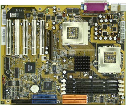

                you missed my point. first, your stock fan vs mine are 2 different models- you have the tulatin fan i have the coppermine fan
                it looks like the rosewill is too big becase i would be crushing memory chips due to the overhang of the heatsink. i hade a few foxconns that had thumblatches on the clip that wouldnt fit without removing a chip effectivly ruining the point of buying the board in the first place. and finding a decent 92mm fan is a bitch because they all have sleeve bearings or cost an arm and a leg (for a fan). also, you can only put an 80mm on that one due to the odd fan hole position.
                if you can fit a 92mm fan on it and you really think i can get away with 4 memory chips, then i might get it (assuming my mom doesnt tell me to forget it since she thinks i spend too much).

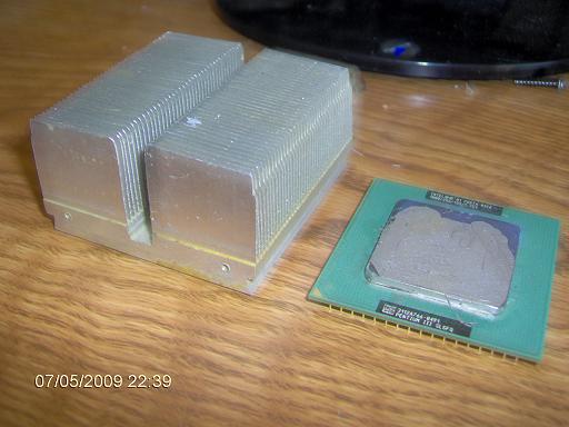

                    That p3 is a coppermine, not a tulatin.
                    I have no tulatins
                    I ran those rosewill heatsinks on my VP6 no problem, no crushing ram, no overhang. The holes for the fan ARE FOR A 80MM. The fan that is on it is a custom rosewill 92mm with 80mm holes.
                    The heatsink I showed in that pic compared to the p3 is the same as the dynatron you want to get. It is the stock AMD socket A cooler. It has terrible airflow because the fins are extremely close together, I used it on a 1600+ and it was junk because it ran about 60C idle and shut off the motherboard at about 1/2 load because it would overheat. (that was with a delta 60mm 35cfm screamer pulling air through)

                      Re: advice on heatsinks
                      then what do i have? medocino cooler? i got jipped by accident.
                      beside, i thought micro fins were a good thing (more surface area)

                        and, 370- did you actually check the mobo pic i posted? the clip area has VERY tight clearances. alot of asus p3 boards are like this.
