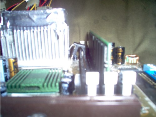

                  wrong! anything with a decent thumbtab will block or touch a chip. here i have the masscool with a foxconn clip on, on a similar asus board with identical clearances:
                  see how the clip obstructs the first slot. luckily, the thumbtab can be removed so i get the slot back

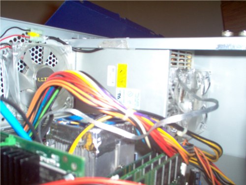

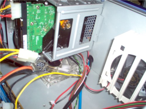

                  i also took pictures of my fan arrangement:
                  see the fan on back panel and the front panel
                  see the back fan and additional fan attached to psu?
                  there is also a fan on the side panel, but you dont need a pic for that as it simply blows out.

                      Reason the hard drive is overheating is that your case fans is bypassing this hard drive's vents at the front. And not to mention the noise!
                      What u need to do is remove both fans at front. Let the air do their job. Also you need to remove that fan that pushes air into PSU. Not needed. Let one case fan extract the air out of case at back and PSU's fan as well. This will make case slightly warmer but more controllable and less noise.
                      Here do get hot as well but my PC works fine with this method.
