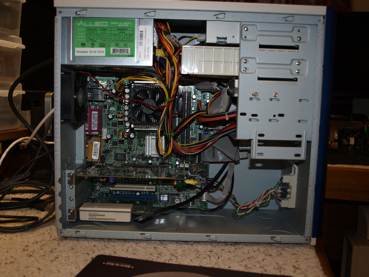

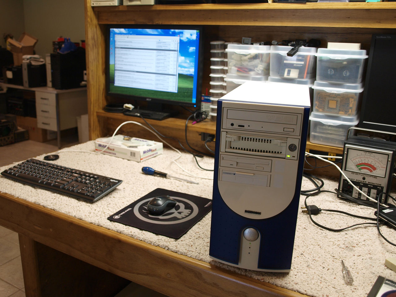

          Here's another goofy one....this is that beige Medion P4 system that was given to me ages ago. I did my yellowing removal on it last year, and it brightened up a lot, but wasn't perfect.... I just couldn't decide what to put in it, so I just did a full restoration of it's original hardware. It had some unusual features for its time, inspite of it only being a 400FSB P4. Mainly the GeForce 3 Ti GPU and its goofy v.92 56K modem & firewire combo card. Anyway, after replacing the missing PSU and recapping the motherboard, it's alive. It supports 2gb RAM with 2 SDRAM slots....but it doesn't like ECC modules, and I don't have any 1gb non-ECC modules on hand, so it only has 1GB ram in the form of 2x 512mb DIMM's at the moment. I also upgraded the CPU to the almost fastest 400fsb Northwood I could find, which is a 2.8GHz. There was a 3GHz 400FSB, but lots of luck ever finding one...so 2.8GHz it is.
          I added a few external extras, replacing the non-working mitsumi cdrom with a DVDRW drive and a Lian Li mobile rack for the HDD.
          The PSU and HDD were missing when I got it, so I tossed in a rebuilt Allied I had on hand. HDD is a 30gb 7200 RPM Maxtor.
          Up & running:
          All buttoned up.
          Of course this post created from it running XP SP3. I'll keep my eyes peeled for some 1gb non-ECC SDRAM modules for it....They're out there but ~$30ea. I don't think this relic is worth $60 for the modules, so I'll wait for some less expensive ones to turn up....but otherwise, this one is done....and added to this useless build thread.

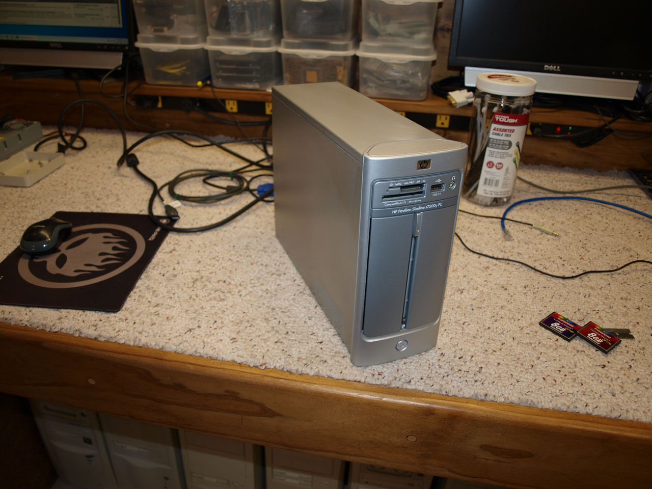

                    I was given a HP 500-C60 midtower PC from a local shop. Mid tower with an external power brick, no expansion slots, and weighs less than a happy meal. The shop said the motherboard was bad; wouldn't power up. The brick wasn't included, so I couldn't test theirs....but I plugged one of mine and it was fine. No issues with the motherboard.....but it's embarrassing on the inside.... an ITX motherboard in this crappy/flimsy midtower case....but that just makes it fun for me!
                    It's a Quad core AMD A6-5200 w/ 16gb RAM and Radeon HD 8400 R3 GPU. This would make a fantastic little web browsing, emailing, facebooking, homeworking, letter typer....but in this big clumsy case....meh...so lets hear it for Topcat's last goofy build of 2020!
                    The old case after being stripped out.

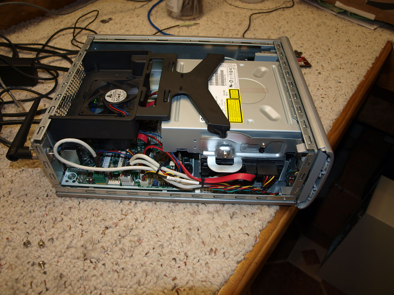

                    Enter in a useless old HP slimline 7500-series with a single core pentium-m and 2gb ram....
                    Gutted!

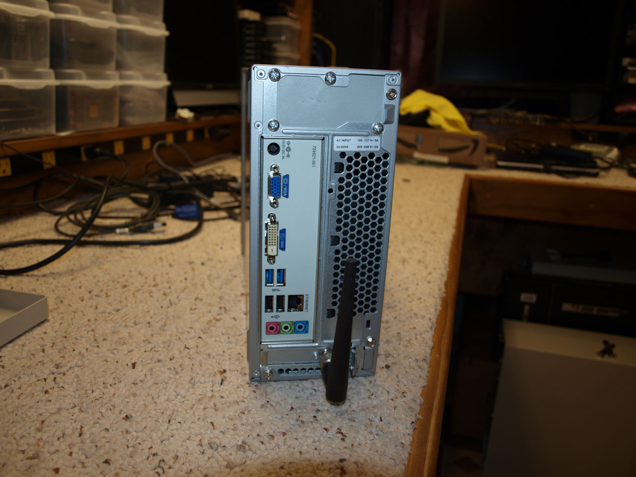

                    This left some minor modifications after debadging the case. For one, a blockoff plate had to be made for where the PSU once was.
                    Then a mod for a wifi antenna. The wifi antenna in the original case was a junk internal one, which typically isn't worth a shit for reception...so I scrapped a bricked cisco access point of one of it's antennas. I then drilled out the expansion slot blank to fit the bulkhead antenna fitting into.
                    Easy Peasy!
                    Fits like a glove!!
                    It originally came with Windows 8.1 on a spinning 1tb HDD. I replaced the HDD with a 240gb SSD, and installed win10....which activated no problem....and another weird one spared from the scrap pile & landfill. The original case will end up at the steel recycler, so it won't be wasted either.
                    If time is money, it probably wasn't worth the effort.....but I'm one of those that doesn't care....its not headed for the landfill and with the tiny case rework it's far more appealing, so rehoming it won't be hard.

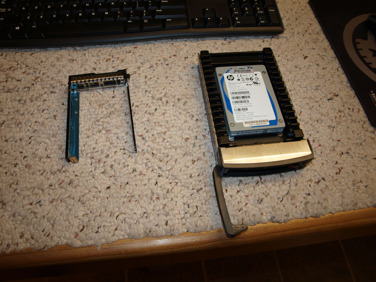

                              Now for the reason of this post....which is not really about a weird system, but rather a benchmark of a 6G 400GB HP Enterprise SAS SSD hard drive in new condition....I was told it was going to be tossed in a scrap bin!! I won't reveal where I got it, but if that person chooses to wave his hand, it's fine by me.
                              I've heard/read of a lot of Enterprise SSD's being pitched because of the 520 cluster sizes and custom firmwares that make them not compatible with Windows (net app uses), which indeed would make them paperweights for anything practical except...umm net app uses....
                              So....I finally got around to testing it and was wondering if that's what I had here... I researched the numbers, it indicated no such issue with this drive or it's firmware. I also discovered that these are rebadged Sandisk "Lightning" drives, which have stellar reviews.
                              So here we go! This is one of my Supermicro workstations with a X8DAI, spec'd as follows:
                              The drive removed from the HP caddy and placed into a Western Digital 'Ice Tray', which supports SAS and makes it 3.5" compatible....and then slipped into a SM caddy.
                              ...and here's what CrystalDisk had to say:
                              It's running as a single drive / JBOD config on a LSI/Avago 9260-8i 6G SAS RAID controller. The BBU battery isn't up to par, which disables write caching....so I don't think the write speeds are up to par....but overall, not too shabby! It has a good feel and load times are super! I've just never had a SAS SSD, so it was something new for me.

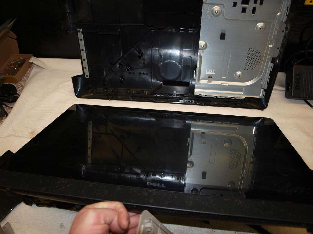

                                    This one is a Dell 24" AIO; model 3464.... Generation 7 I3, 16gb DDR4, and a 1tb spinner. Problem is, cockroaches & animal piss (or so it smells) all over the base...
                                    This is new & large enough that it's well worth fixing...but it needs some love.
                                    Inside the canse isn't bad....openings were too small for the critters to get in.
                                    First things first, see if it even works....the brick was missing, so I used the bench supply.
                                    Success, it comes on, screen is good....and since its bitching about a non-genuine power supply, I'll ASSume the motherboard is good.
                                    Now for the worst part, the horribly corroded stand.... When I have to break out drills, prybars, hammer, and easy-outs just to get it apart; you know it's going to be bad!!
                                    Drilled out 3 screws to separate the bottom from the counterweight.
                                    The remains of the screws. Some did come out....but most didn't.
                                    Had to tap with a hammer to break the corrosion loose from the base plate and the vertical portion of the stand.
                                    ...and here we are...
                                    I'll disassemble everything and clean it. The corroded metal parts in the stand will get wire wheeled and likely painted. That will clean and then make it look good....not to mention get rid of the smell.
                                    To be continued. I did order a new & genuine Dell power brick for it for $18.00. I will also get rid of the 5400RPM HDD and replace it with a SSD. This one will sell easily for a nice profit when I'm done.

                                        Well, disaster struck.... I was getting close to the end of the physical refurbishing when I was wiping down the front and noticed the digitizer had cracked. There was a deep scratch out of the screen's viewing area....I guess it scored deep enough that when I applied a little pressure to clean it, it cracked.
                                        You can see the scratch with the little 'flea bite' where the crack originates.
                                        Kind of a shame......
                                        I was cruising right along before the crack....
                                        The base counterweight wire wheeled & painted with rust inhibiting paint.
                                        The rest is aluminum that was corroded. I wire wheeled it and cleaned it up. I also cleaned up the back plastics and other accessories.
                                        All that was left was the front and the system itself...
                                        ...and right after that the digitzer cracked... I looked around and they're nowhere to be found. I'm going to remove it from the bezel and see what I can do with it, just to save the system.....but there went the resale.... It'll get delegated to the garage or something....
