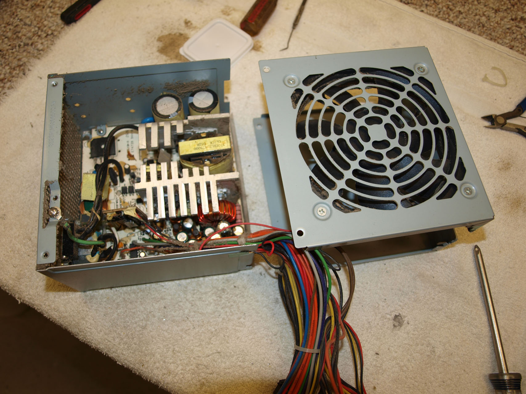

                  Next up is the power supply.
                  On top of the bad caps, I wasn't real dazzled with the build quality for its rating of 400W.
                  Apart.
                  Time to replace the melted cable end.
                  A replacement scavenged from some junk PSU.
                  Junk one removed.
                  Recapped.
                  Cleaned and back in the case.

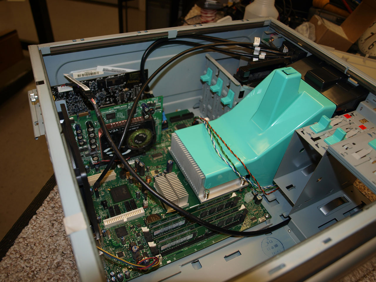

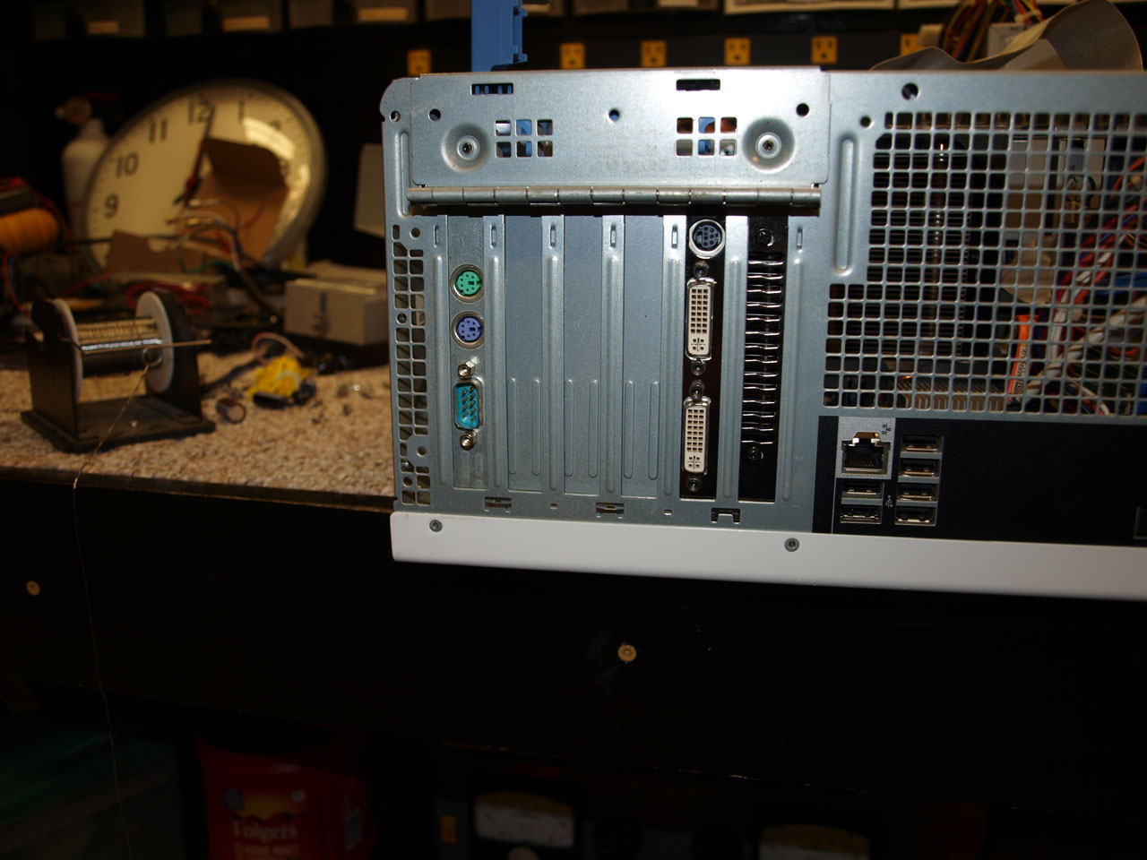

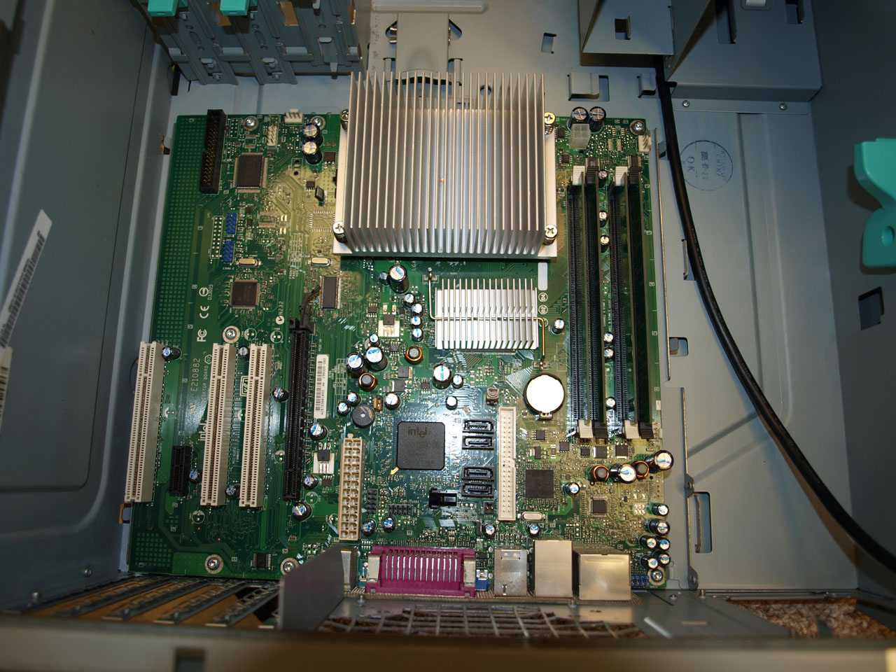

                      We're doing a quick revisit of the Dell XPS 410 build that had the mishap with the rear PS/2 header ribbon:
                      Originally posted by Topcat View Post

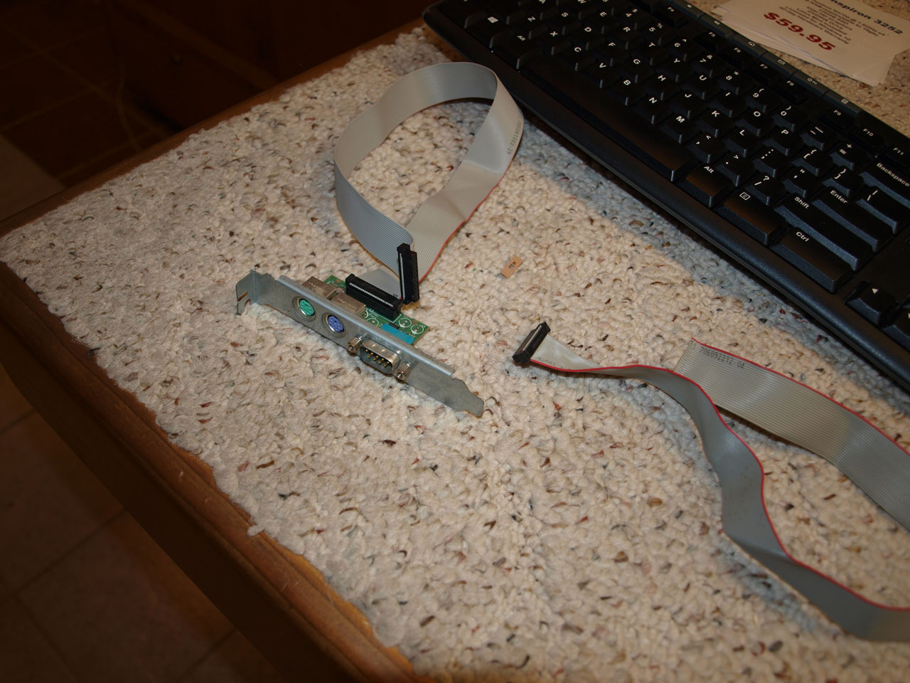

                      Butt shot... I deleted the rear header for the PS2 & serial ports, as I accidentially tore the ribbon that connected it to the mainboard. It wouldn't release from the plug and the ribbon pulled out of the plug. Oops....ohh well, I always use USB anyway.
                      Originally posted by momaka View Post
                      Noooooo!!!!! I love PS/2 and it is always my first choice for KB/MS if the mobo has the ports. I wish my E520 & E5150 came with a PS/2 header/bracket, but they didn't When I went to look for one on ebay (some years back), $15-20 just seemed silly to spend on cable for a junk low-end C2D CPU.
                      Since Momaka seemed annoyed by my blunder of tearing the ribbon (it aggravated me too), I hung onto the header....I just stuck it in the case, it was floating around loose on the case floor.....
                      Well I was scrapping computers today that were trash and there was a GX620 SFF slimline that was all beat to hell, PSU was bad and of course the motherboard had bad caps. Not fixing this....and as I'm taking it apart, I notice it has a PS/2 low profile rear header, which won't work in mine....but I also noticed that the ribbon is the same as the one I tore.
                      Hot dog!! Same part number and same connector configuration!
                      Good cable swapped over.
                      Installing....
                      Buttoned up.
                      Perfect!
                      Much better!!

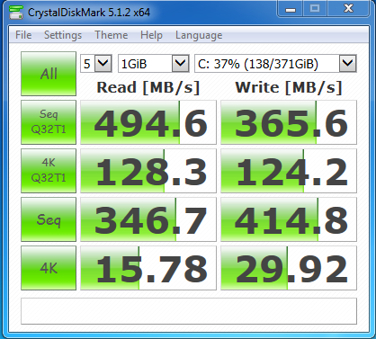

                              Crystaldisk of the 2x Lightnings in a RAID-0. Not bad at all for hardware of the era.
                                It's OK.
                                Probably a 2-transistor forward design. Output inductor seems a bit on the small size, though maybe it's from the image I can't tell. If it's a T106... yeah, way too small for 400W, even if it is a -52 core material (light green with blue on one side).
                                Wrong image?

                                This is the first modern AIO I've seen that had PS2 keyboard & mouse ports though!
                                Not too surprised, though. Most Optiplexes from the 2nd, 3rd, and 4th gen Intel i-series have PS/2 and Serial ports. An interesting comeback for sure, as the socket 775 era Optiplexes didn't have them (at least PS/2 ports), unless ordered with a special bracket card.
                                https://www.badcaps.net/forum/attach...1&d=1698289608
                                Installing....
                                Buttoned up.
                                Perfect!
                                Much better!!
                                I hope you didn't do all of this work just to make me shut up
                                I do like it, though.
                                Let me know if you run into any more of these by the end of the month and you don't want them (even the low-profile ones.) I have two more Optiplex mini towers and one Dimension that could use 'em. I know they can be had on eBay, but spending $45 for three of them for what is worthless PCs seems ridiculous. I'd rather buy scrap motherboards with PS/2 connectors or KVM PS/2 extenders and make my own.

                                Here's to another one I couldn't bring myself to scrap. This one came with a bunch of other pretty worthless things from the estate of a deceased local surveyor. This one is literally 'the elephant in the room' just because of its sheer size. It's an absolute beast of a system! Build quality is stellar; very heavy iron workstation....I almost called it 'old world workstation'...but it's got a little more aging to do before it earns that title.....but time will take care of that.... Modern Dell 'workstations' are thin, light, and flimsy like everything else these days.
                                ...and the mystery system is a Precision T7400 Workstation... Datestamp on the case says May 2009; which fits the era for the CPU that is in it and DDR2 FB...and lets say hello!
                                Nice save!
                                I bought a T7400 off of Craigslist about 2 years ago for literally just a little more than scrap money ($30). Guy said HDD was bad. Turns out PSU is bad and the 5V rail drops to 3-4V when ANY load is connected to the 5V rail. Still haven't figured out what's wrong with the PSU, as the other rails are fine. It's a 1 KW Delta/Newton PSU, IIRC. No bad caps. 5V rail is mag-amp regulated rather than the 3.3V, which is a very strange design. If I don't figure it out, I'll probably just kludge it and add a 2nd PSU in that system to feed 5V back into the 1 KW PSU. The 1 KW PSU is modular & not too easy to find a replacement for.
                                I did some research on the chipset; which is the Intel 5400 Seaburg; a chipset I'm already familiar with. It was the only one for the LGA771 & Harpertown platform that supports 1600FSB....hmmmm...and look what's in the bin! A pair of E5472's @ 3GHz / 1600FSB.
                                That did indeed cure it. Put an E5472 CPU0 socket and it POST'd right up....so now for the virgin CPU socket! I don't have the heatsink....I found one on ebay for $18, so one is on the way....but for testing purposes, this will do.
                                Nice!
                                Makes me wonder what CPU model mine has. When I booted it (without an HDD so the 5V rail won't drop... and even when it did, the system still POSTed fine), it said there were 2x 3GHz quad core CPUs in both sockets. Considering the original CPU heatsinks were also included, I think that alone was totally worth the $30 I paid for it. Nice heavy metal system!
