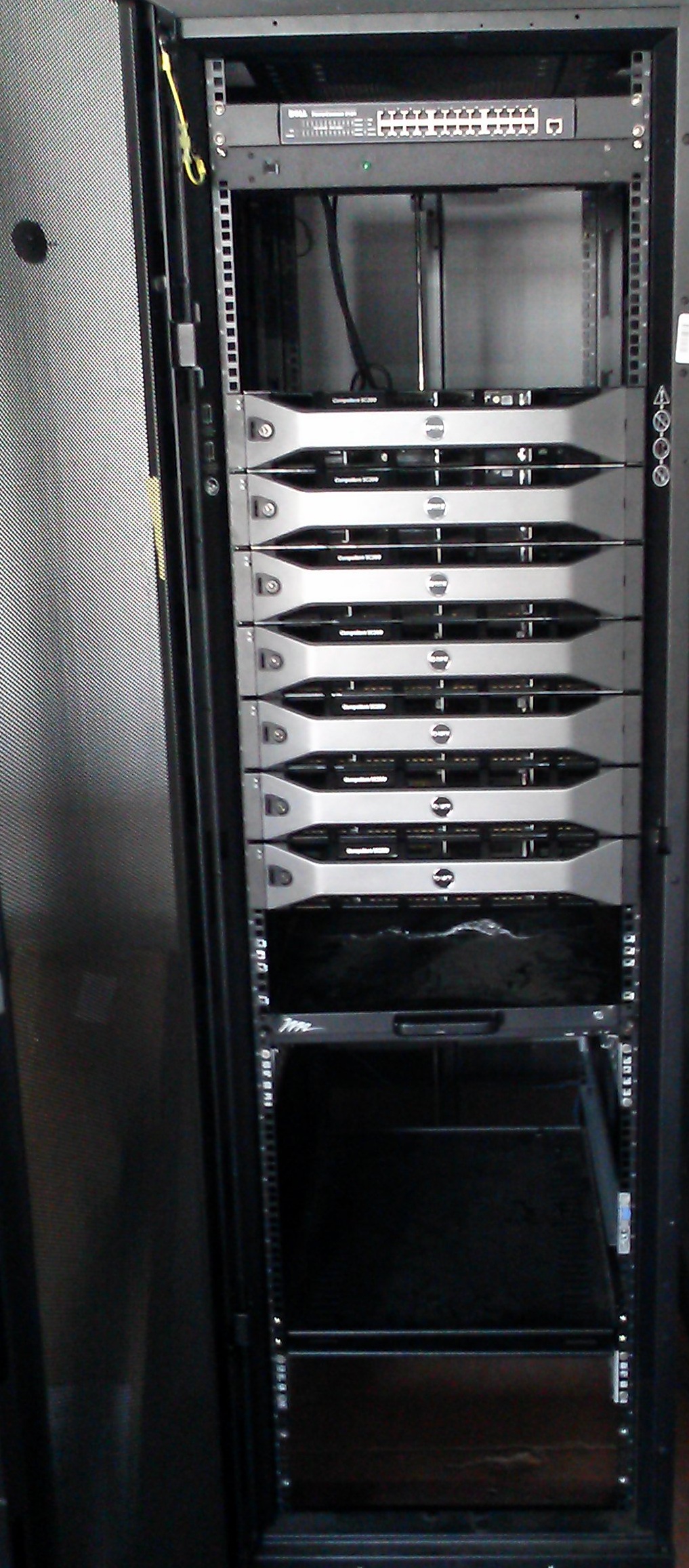

        Finally assembling the hardware for this. Installed 7 disk shelfs, today (5 to wipe and 2 for RDBMS). Plus keyboard/monitor and a small switch.
        Still to add: two servers (one to wipe disks, the other for the RDBMS), a pair of rack-mountable UPSs and firewall appliance. And, a "smart" PDU.
