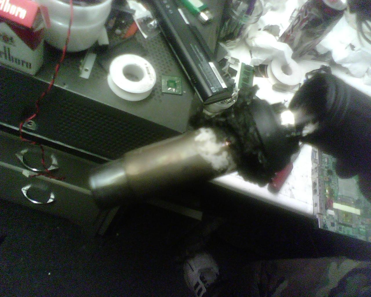

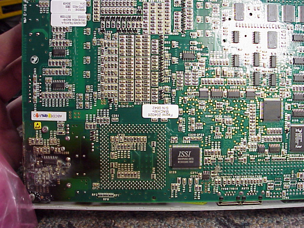

all fans failed.this is what happened.salvagnini sbc
  • kc8adu
    • Nov 2003
    • 8832
    • U.S.A!
    salvagnini sbc from a metal forming machine.
    fire!
    used the good parts from this one to fix another that was trashed the same way but did not flame out.

    Re: all fans failed.this is what happened.salvagnini sbc
    What happened to the fan on that, did it melt off or did you take it off?
    Must have gotten hot to vent those Panasonics.

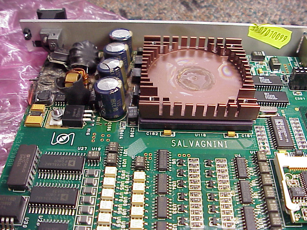

        >>What happened to the fan on that, did it melt off or did you take it off?<<
        That fan is a little "caged" style that just screws into heatsink. Notice the shiny screw thread spots, ala P1 style.
        >>Must have gotten hot to vent those Panasonics.<<
        I draw your attention to the incinerated corner of the board to the left of the Panny's...
        Toast(ed)
          the fan was off in a bag.it crumbled when i inspected it.its leads crumbled too.took it awhile to bake like this.cpu,a k6-2 450 was toast on both boards.
          surprised it ran as long as it did!
              mmm... char-grilled silicon with a hint of baked solder
                Totally stupid design, no fail safe at all on that production board to cut out on overtemp!? With all the expense spared, the maker of this board should have been have over-temp monitor circuit built in to protect investment. Plus K6-2 is hot CPU to boot. With this heatsink, sufficient for DX2 66 but that's barely capable for cooling a 11W CPU (Pentium 100) but with K6-2 450 that requires different heatsink (this is about 30W if K6-2 is a 2.4V version, otherwise 19W for 2.2V).
                Head shaking at this...sigh.
                  yup- cheap heatsinks= short cpu life
                    to add further insult the burnt board went 6 months ago.the one i fixed was the replacement.i think the customer said it was about $5k.
