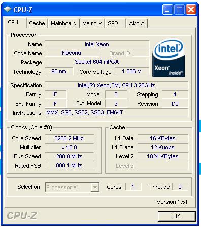

    Which should I run my drive at? It seems like I can't run games on as high of settings with my supermicro that I could with my ECS.
    My ECS had the same 8600gt 512mb thats in this computer, and a 3200+, and 2gigs of ram. This has a 3.2ghz xeon and 2 gigs of ram, along with the video card.
    It acts choppy every time the hard drive starts reading in games like cod4, and badly in fallout3. My ECS never had this problem, and it had the same WD 80gb 7200rpm 8mb cache IDE hard drive.

                  The processor has the EM64T instructions for 64bit,

                    Those are Nocona cores,,, right? - If so those should be 64-bit.
