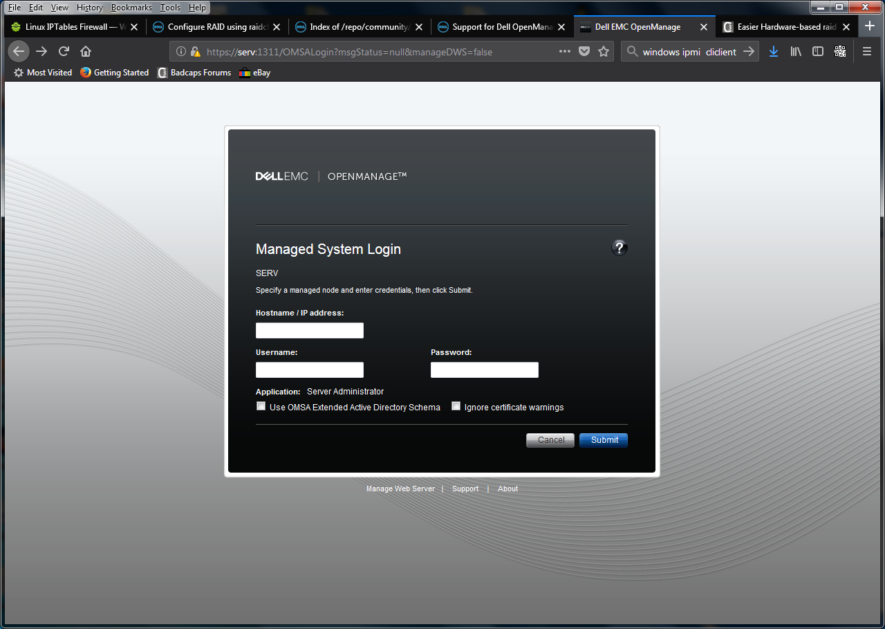

                    Re: Easier Hardware-based raid management
                    I have a perc5 in my parents' server... It runs Debian. Openmanage works fine- just add the custom repository and install. Easy.
                    I did! Dell has a (technically unsupported) ubuntu openmanage for 16.04.4. I already found that in my searching days ago but had no luck with 18.04
                    so I put the card in and installed 16 on raid 1 and it added fine. I can't login though. I can if I use "Manage webserver". I'm curious, the manage webserver says something about no browser JRE, is that required? I just tried to install JRE 8 and even though it's in IE, it still says no JRE, and still will not login
                    it dosen't say "wrong password" (it's obviously correct since I can use it the manage webserver). It just loads the login page again
                      ^ No idea. I never did get that part to work. I just SSH'd in and used the CLI. It's a cop out, but it got the job done. Bonus part is since you have a dell server, now you have all the hardware sensors too. Nice stuff.
                      Edit- it's an old repo, worked fine for debian jessie at least. For a server I don't want bleeding edge... too much breakage and other BS.

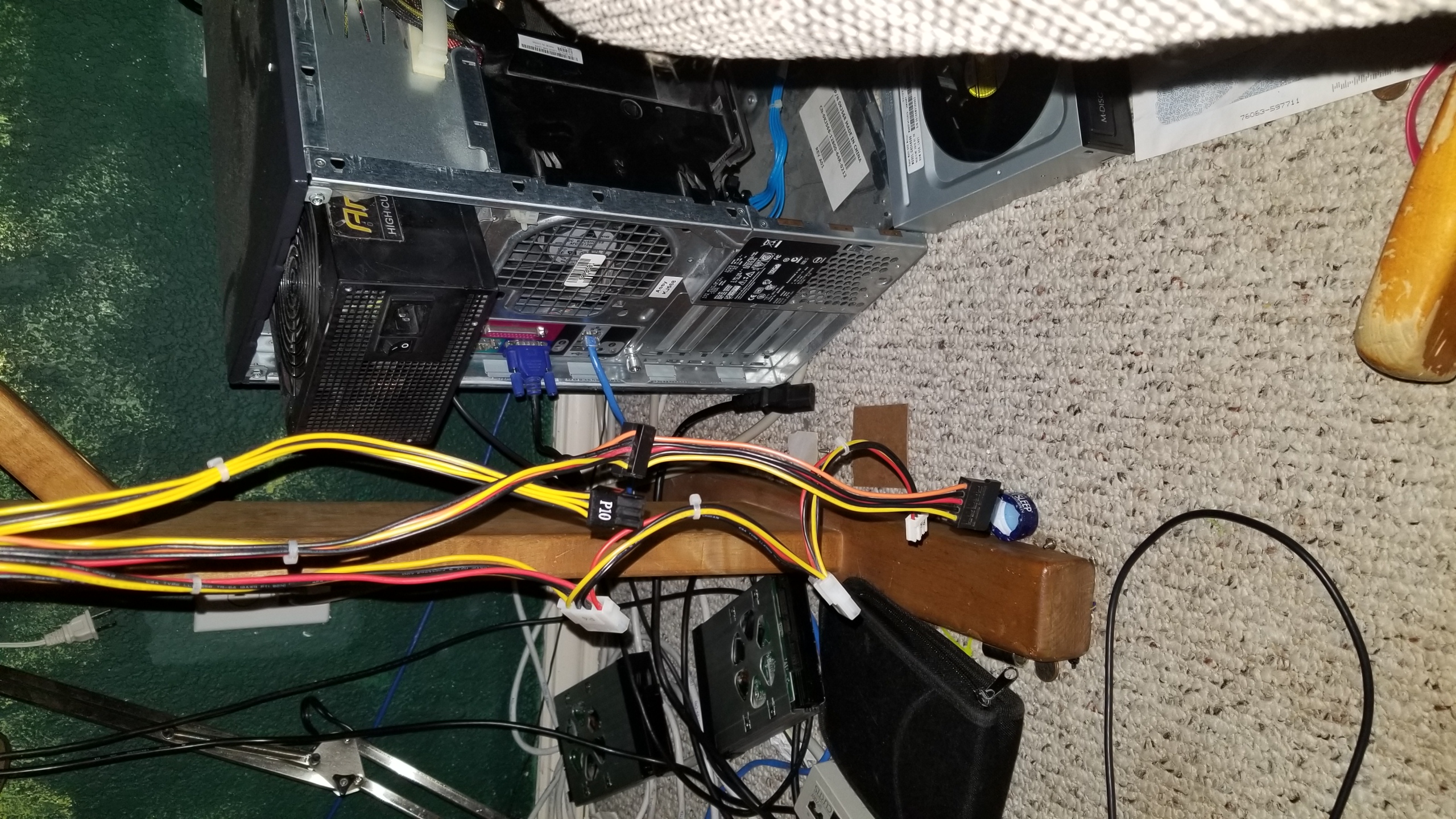

                        I guess, the best thing I can do now to prevent any raid failure without linux raid is get a UPS. Under linux raid, it got power outages all the time, but mostly idle, only streaming a dlna music stream to my roku 1. They never did a recheck, but i'm sure the hardware raid would (although I read this card apparently has 512M cache, but it's disabled). I think i'm going to keep it disabled since it only has one user, and dosen't have any intensive work load. Only real load is EXT compression writing, and thats nothing
                        ok, it used to have two 675W dell PSUs's till both died on me. Now it has a Corsair 750W (80 Gold efficiency rating)
                        Two Irwindale 3ghz cpu's are 110W each. Two WD black drives. This was built for having 5 SCSI 15k drives.
                        Think 400w UPS is enough?
                          Note that Marketese for UPSs is to publish their VA ratings, nor "power" ratings. E.g., a "400W capable" UPS will probably be sold as a "750 (VA)".
                          Regardless, it can't hurt to measure the actual load. Or, use a UPS that has that capability available (either via front panel display or network interface).
                            How did it go with the data, where you able to recover it?
                            As for the UPS please read this: http://www.apc.com/us/en/faqs/FA158939/
                            The problem with PFC supplies is that they can draw their full rated power when charging the main capacitor.
                            So for that reason it is best to dimension the UPS with that in mind.
