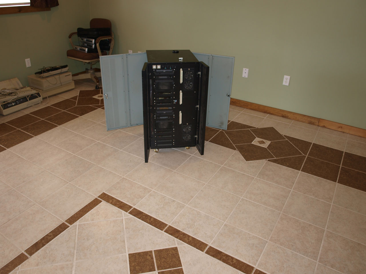

    Fedex just delivered it via freight truck:
    Cut out of the packaging and wheeled inside. The lock cylinder on the front door is broken, but present....I'll have to see if a locksmith can repair it. It came with the original keys, but ironically enough, I still had a key for it.
    They added a NIC to each system and up'd each system's memory to 6gb. One of the heatsink fans are broken...
    That was as I remembered...
    They cycled some HDD's, there's now a pair of 300gb SCSI drives for each system. Not sure how they're configured.
    I haven't any idea what I'll actually do with this yet, haven't even tried firing it up....but after 9 years, a long-lost friend & Badcaps.net's original server has come home!!

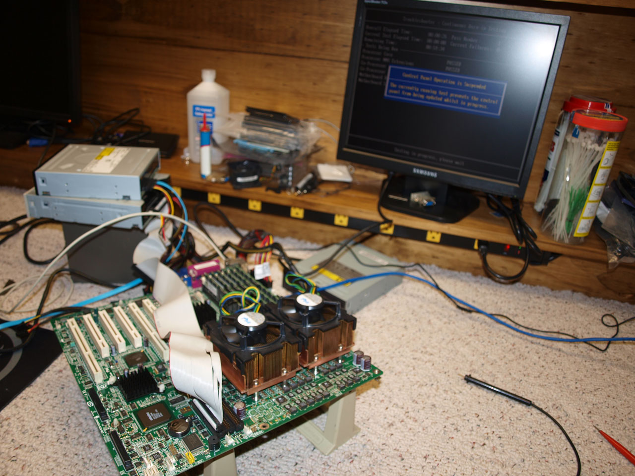

      I took it out to the garage and blasted it with the air hose, brought it back in and fired it up.
      System 1 posted, one HDD clicked, the other HDD is dead.
      System 2 posted, booted up to some version of Debian.
      As I promised, I DOD wiped the drives that were accessible. I ran memtest and other diagnostics, the system cores appear stable. That's as far as I got with it.

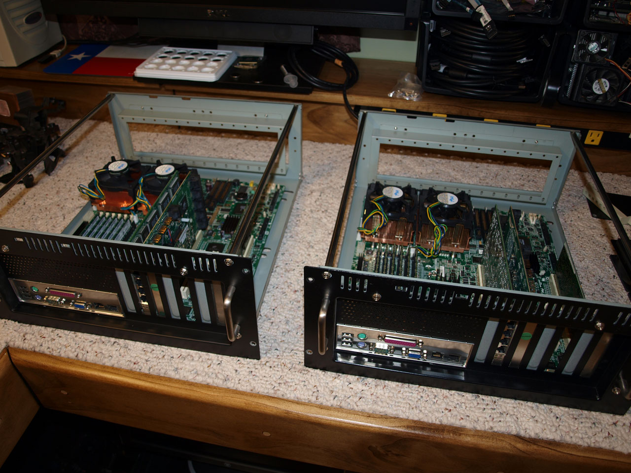

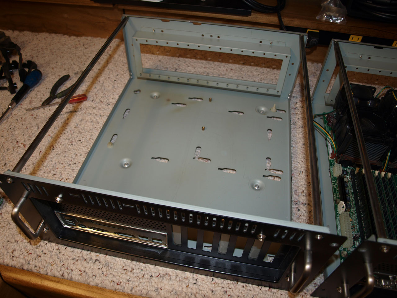

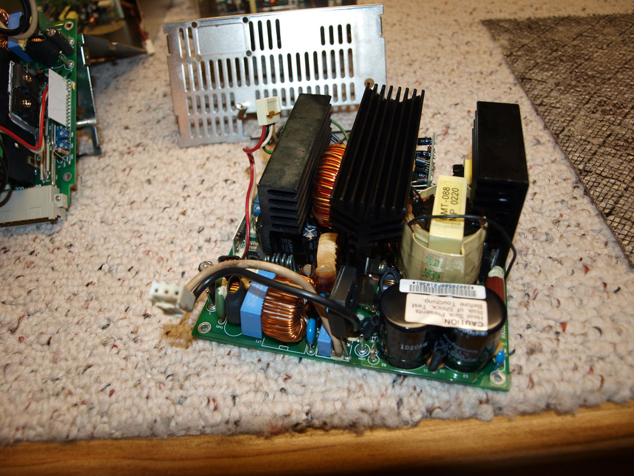

                                I started disassembling this case today. When it first got here, I noticed there was an extra power supply module inside the HDD side of the case....I wondered why, and then curiosity got the better of me and I contacted my inside source at the company that I sold this system to. He told me that around 2010 or so one of the modules had incinerated itself. They had such a hard time locating a replacement that when they did, they ordered a spare, just incase....and I'll get back to this subject in a few minutes.
                                So anyway....the case apart.
                                I replaced the heatsinks & fans. The fans were very out of balance, worn, and noisy! I scored NOS 4x OEM Intel full copper on fleabay.
                                The removable trays. These trays are on ball bearing drawer tracks in the case, which allow them to open like a drawer or be removed...great design IMO. Modern tool boxes don't even have drawers of this good quality!
                                Testing afterward, just to make sure I didn't kill it.
                                Trays reassembled.

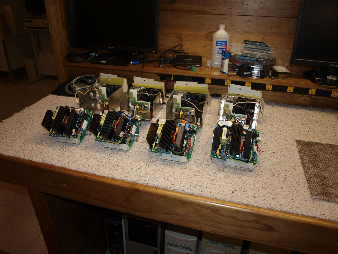

                                Now for the PSU story! Three of them were flunky ass dirty, one was moderately dirty, and one was new in box.
                                PSU module disassembled.
                                These are so nasty that I bathed them in the sink with simple green and then blasted them with the air hose to chase the water out.
                                Then I see it.....the modules from SYS-B loaded with CapXon.....none of them appeared bad in the two modules from SYS-B.
                                ...but then I get to SYS-A's modules, the system that had the one self destruct back in 2010....the surviving module, low & behold, bloated CrapXons...so its obvious what caused the destruction of the other module, even though I didn't get to autopsy it....its pretty self-explanatory.
                                This is the replacement module, they wised up and used UCC KZH instead of those shitty CrapXon's....
                                So here's the stopping point for now.... The hotwash cleaned PSU's are ready for recapping...atleast 3 of them anyway...
