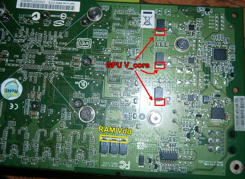

      By the way, I have a curious question about your GeForce 8800 GTS: what resistance do you get for the GPU V_core to ground and RAM Vdd/Vddq to ground? (Also, what is the lowest resistance your multimeter can measure?)
      I am getting 0.2 Ohms for GPU V_Core and around 24 Ohms for RAM Vdd/Vddq supply. Just checking, because I reflowed my 8800 GTS twice now, and it's still dead as a rock. Can't even post the PC with a PCI/AGP card to view the 8800 GTS' BIOS.

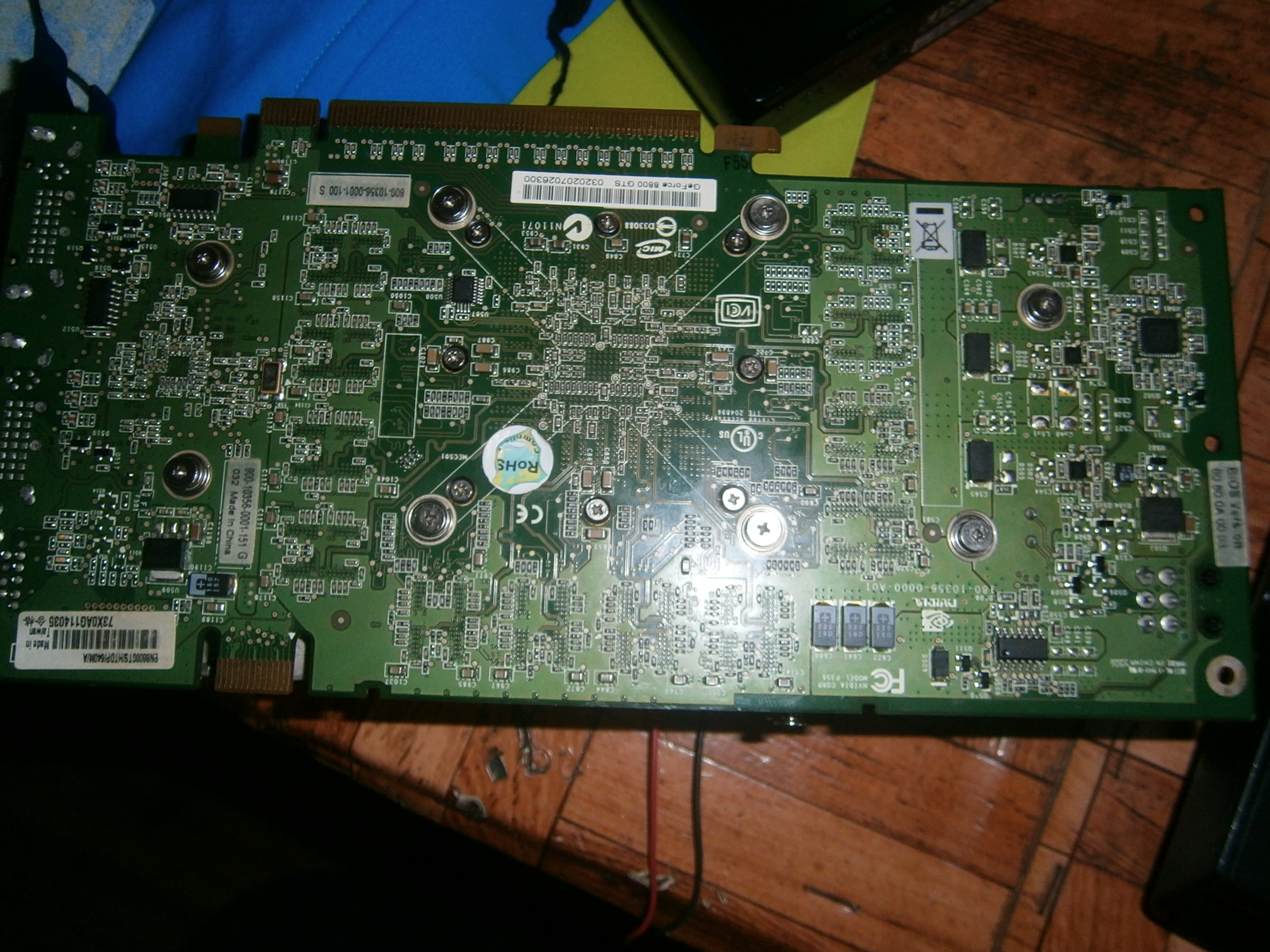

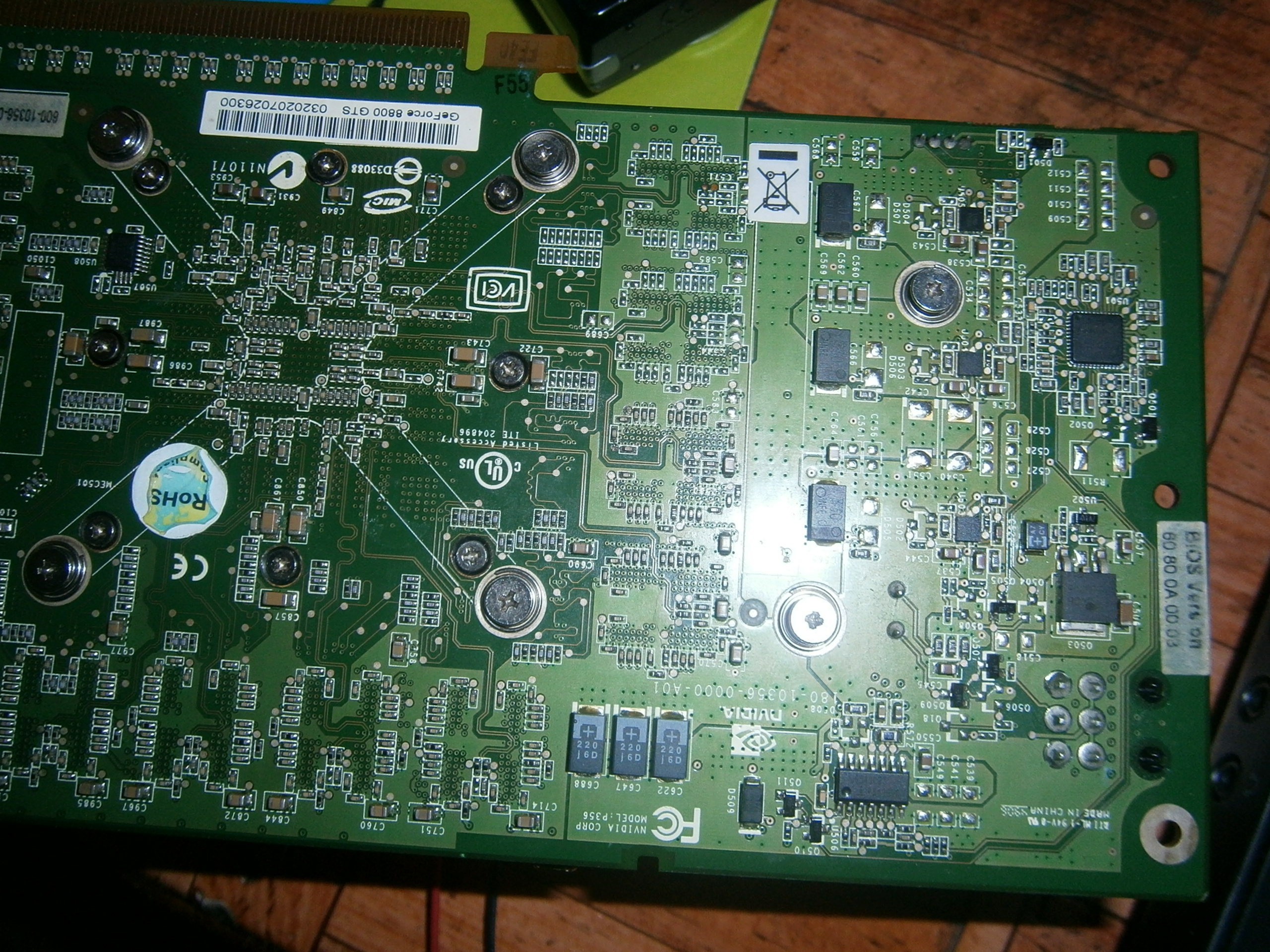

      I've tried twice to reflow the 4870 and it did'nt change, still boots but with garbage on the screen.
      You ask in the right time about the 8800 because it died yesterday and I'm going to reflow it tomorrow I can measure what you need today and tomorrow after the reflow.
      but like I said I'm not so good at electronics and I didn't find where I should measure what you need.
      I attach two photos of my card.
        I had one 4850 do that. Eventually, I got it going, though. But it still artifacted a little bit afterwards under high stress with game benchmarks. So I think a reball may be the next thing I try on it. I haven't done reballing in a very long time, so I think of this as a good opportunity to try it again.
        Anyways, you can try reflowing yours again at a slightly higher temperature. And keep reflowing until it dies if it doesn't work. After all, a video card with artifacts is hardly any better than a dead one, so if it dies from reflowing, I don't think it would be a big loss.
        Ah, my bad luck must have gotten to your 8800 GTS too.
        Below in my post is a revised image of your pictures that shows where you can find the RAM Vdd and GPU V_core. You can measure the resistance there (when the video card is not powered) and voltages (the the video card is powered).

          I've reflowed it today and it's still alive, V_core to ground 1.3-1.4 omhs and V_ram to ground 25-26 omhs, the same before and after the reflow. V_core 1.27 and V_ram 1.89.
            Thanks.
            I'm getting very similar readings for the resistances (1.2-1.4 Ohms for the GPU and around 28 Ohms for the RAM), so at least that's good. If I remember correctly, the RAM was showing correct voltage too (around 1.9-2.0V) as was the GPU, though I don't remember what. Still dead as a rock, though. I'm wondering if I should reball it or if that's just beating a dead horse.
            (Plus, I don't have any stencils, so putting the new balls on there is going to be fun for sure. )
