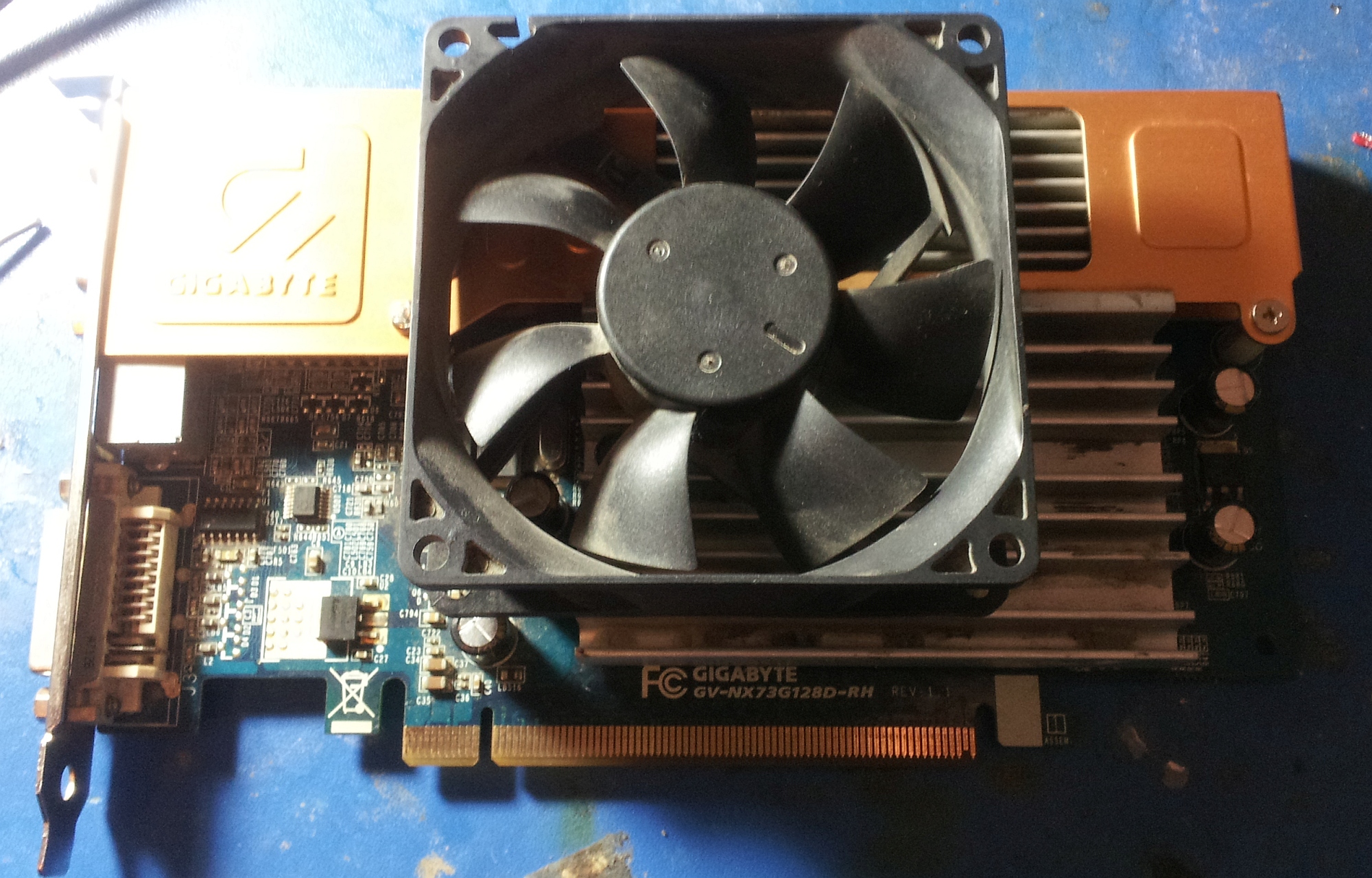

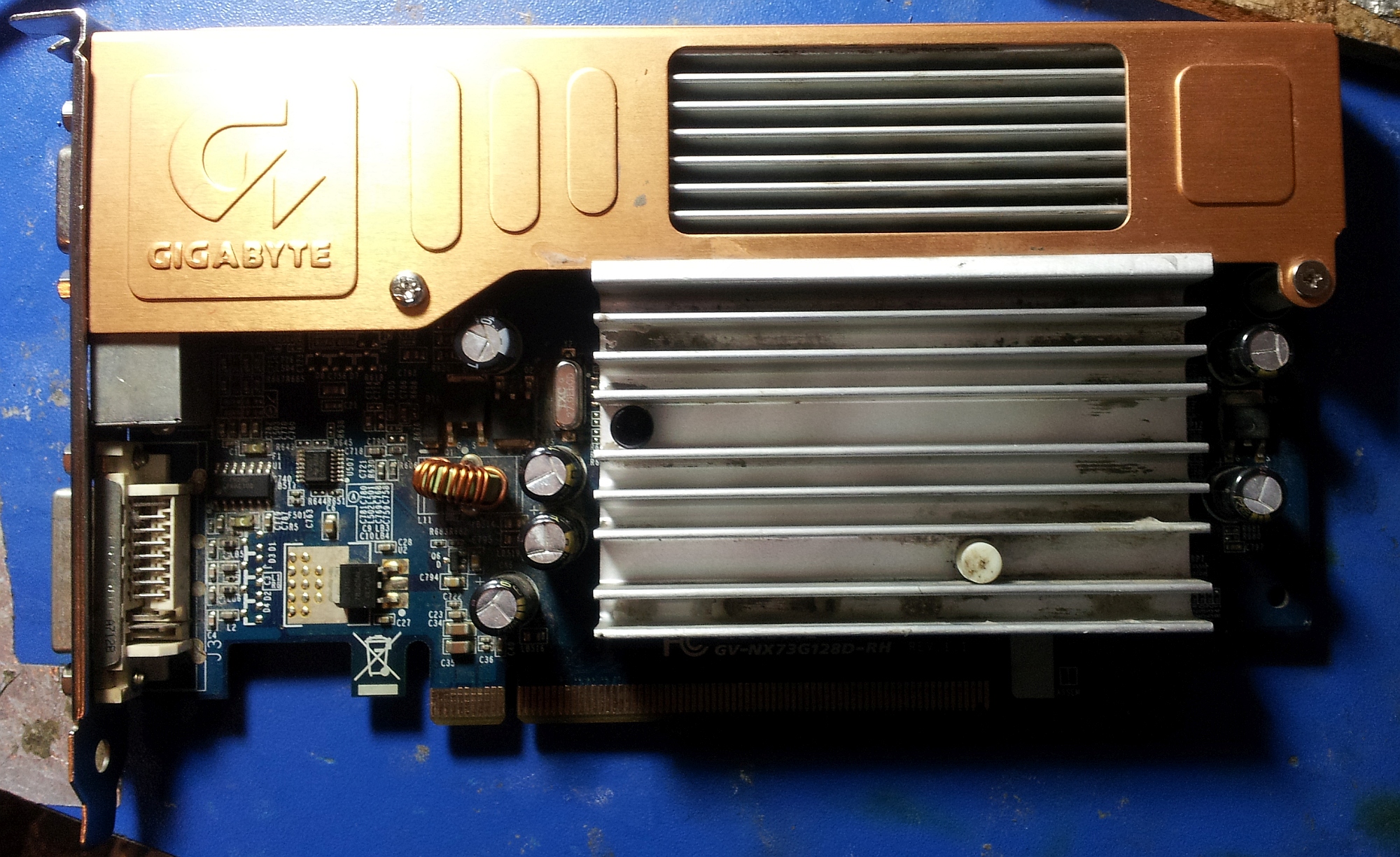

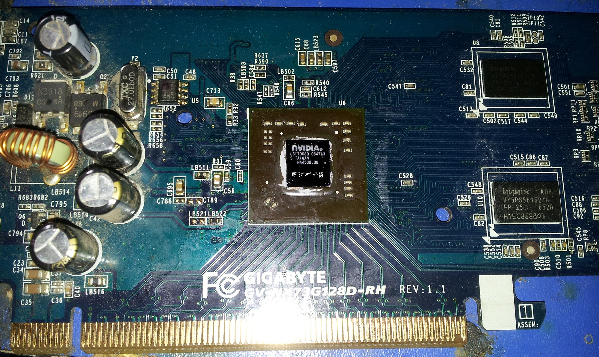

    Another oldie special here. I'll put up the pics and temperatures in a couple hours.

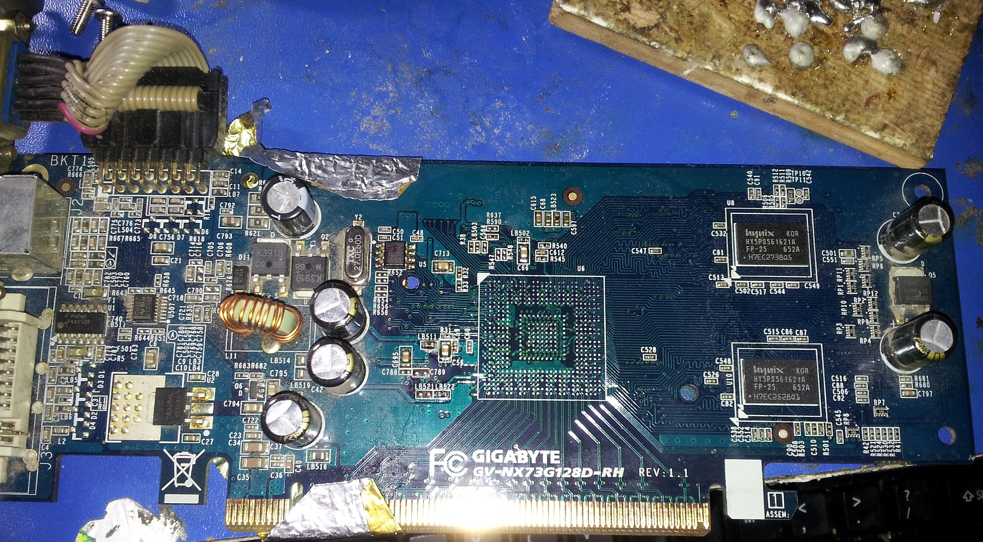

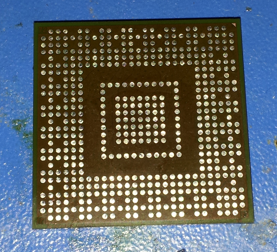

    Picked this card up for free on Sunday, it was lying in a neighbors' yard. I reflowed it and added a fan some time back, but due to the messy state of their computer and the kids always playing GTA San Andreas on it, the fan got clogged up and the card died again.

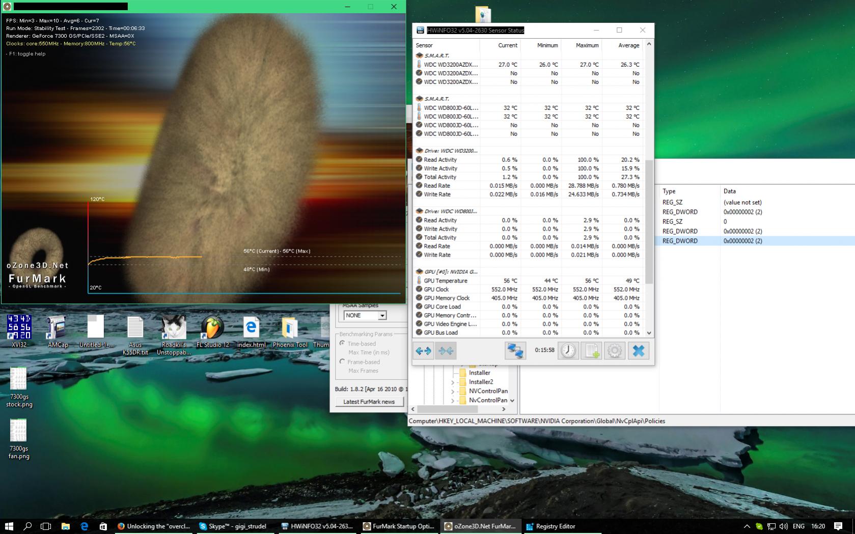

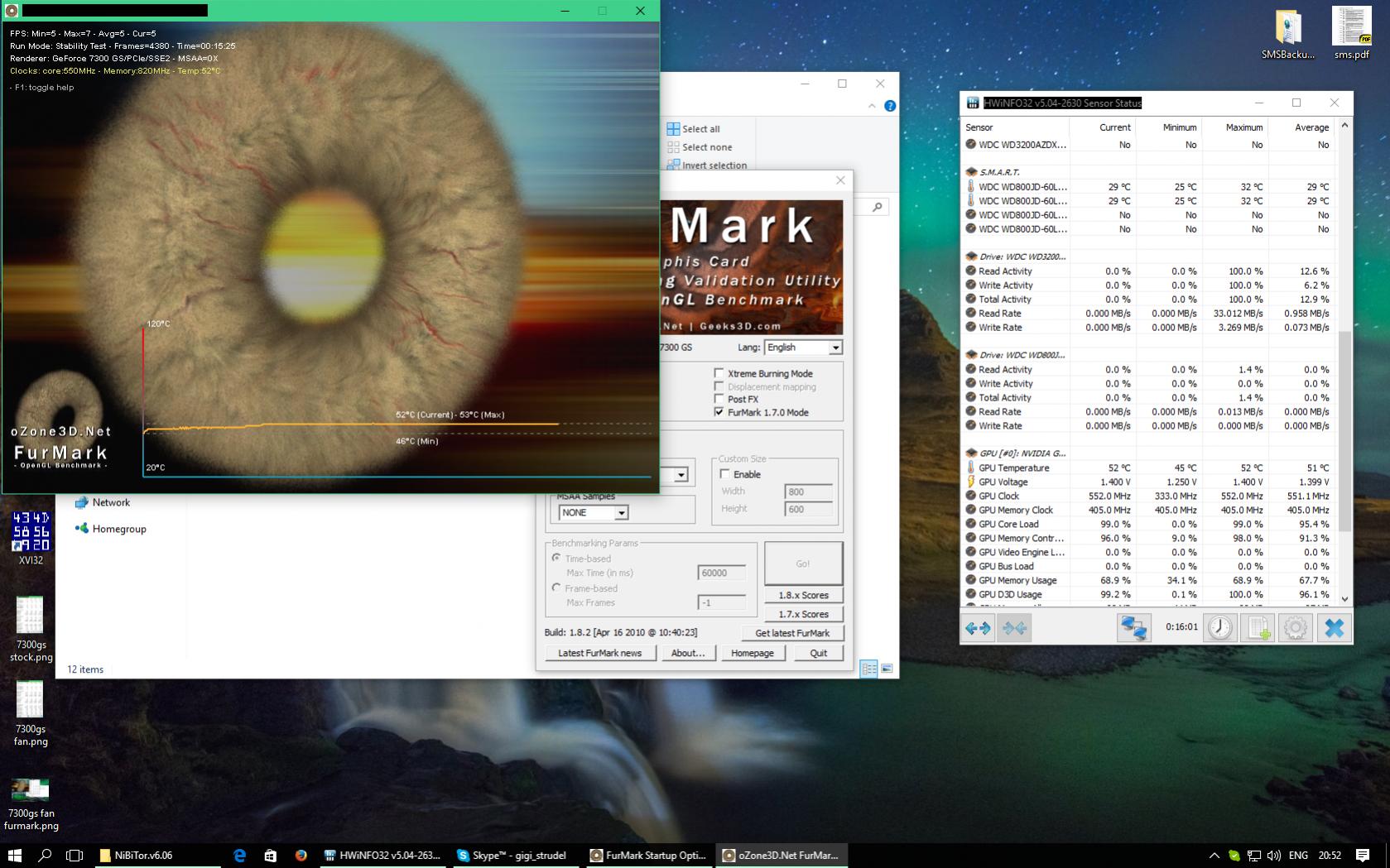

    So, after reballing, adding a fan and undervolting it, i get 52C full load (FurMark) with a single spike at 53C. So even with the bumpgate defect, i will be tossing this card in the bin long before it dies again. I wanted to just reflow but i nudged it too far when checking that solder is fully liquid so i had to take the chip off.
    Still works in Windows 10, and does 720p on youtube with MS Edge and IE. Firefox doesn't pick it up tho, same happens with my AMD APU laptop so i just use Edge for youtube. 48C when viewing youtube and 45-46 at the desktop.
    It's an old crappy card, but 1) it was free and 2) it's still better than the GMA 950 my work computer had onboard and i can watch teardowns on youtube without opening the links in an external media player. The computer is a HP Compaq dc7800 with a 2.8GHz Pentium D.

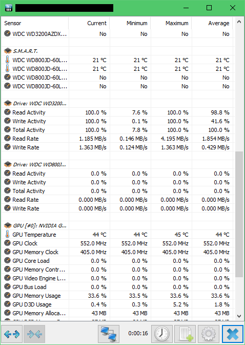

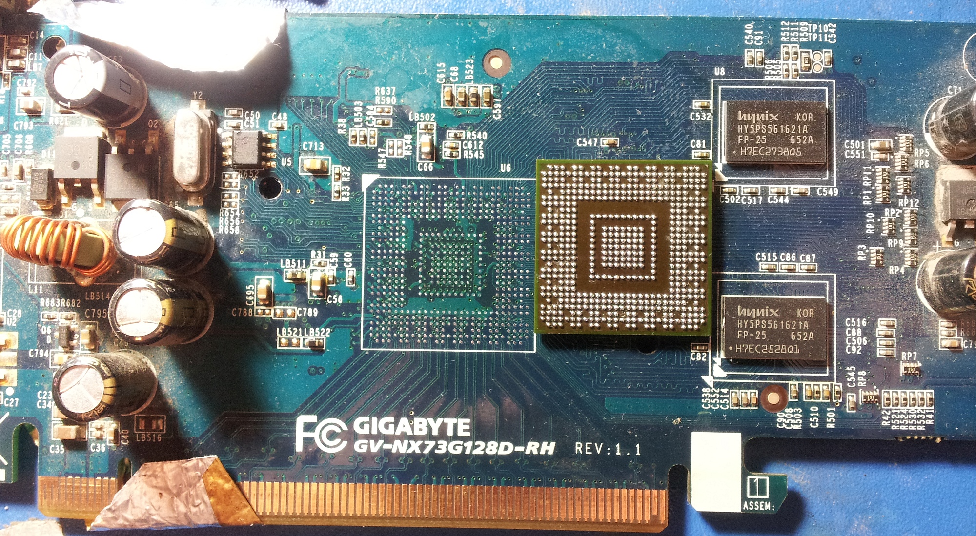

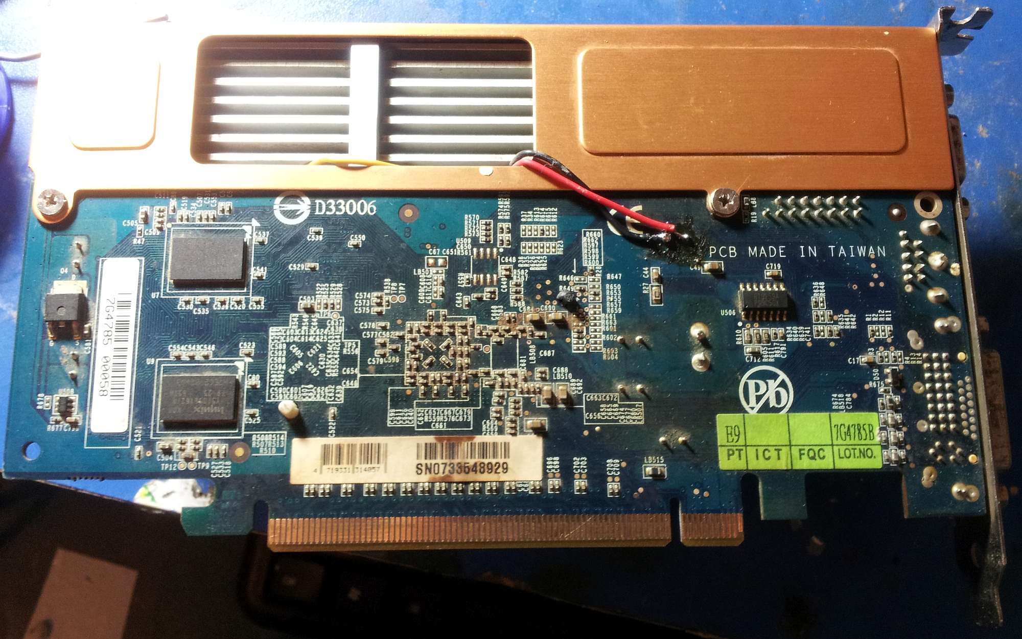

    Re: Gigabyte 7300GS complete overhaul and modding

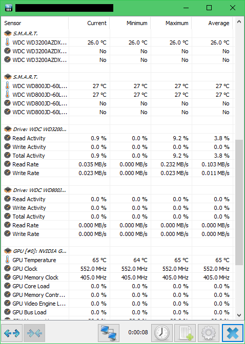

    Here are the pics. Btw, the voltage reading in hwinfo is wrong. Stock voltage was somewhere around 1.33v, i managed to get it stable at 1.135. I tried 1.05 but it was not stable in any 3D application, booted to desktop tho.
    If you want me to elaborate more on the voltage modification points, please ask.
      I'm curious, do you have a stencil or how do you position the new solder balls?
      • Th3_uN1Qu3
        Believe in
        • Jul 2010
        • 6031
        • Romania
        I do this for a living so of course i have stencils for everything.
              Nice!
              At what room/case temperature was that, though? I imagine it's a bit cooler now at this time of the year in Romania. Here, my house is already dropping below 21°C/70°F now. In the summer, though, my room can get as high as 29°C/84°F - now that allows for some real stress tests .
              Most of my CPUs and GPUs run around 55°C under load then.
              Wow, so you went "all the way" with this one.

              Not sure if your 7300 GS looks a little toasty on the bottom due to hot regulators or your reflowing it (or perhaps the kids really playing too much GTA SA ), but I though I'd suggest the gas stove/burner anyways.
                It is cold but we have central heating at work, and i'm either going to be soldering something or reworking BGAs, so it can get quite warm even in the winter.
                  So I would guess that would be about 24-25°C max then. Not bad at all for the GPU temperatures you were getting.

                      i see from the pics, the video card has hynix vram chips, my fav video memory brand. undervolting the video memory is only necessary if u got infineon/qimonda video memory chips which dont like voltage. in fact, stock memory voltage causes it to artifact and undervolting is required to get rid of the artifacts.
                      memory only has a tdp of a few watts or so. undervolting the memory wont actually save much power. momaka also told me before NOT to get too aggressive with power saving as that can shorten the life of the hardware instead of prolonging its lifespan as it subjects the bga to too large of a temperature change during idle->load->idle transients which is bad for the bga.

                        There is 900MHz DDR2 from Hynix as well, but this is rated for 800 and it seems that's all it will do.

                                      Actually, nVidia cards have stopped failing for the most part (except for the GTX 400 series which actually had the same underfill as the bumpgate era chips), but we do plenty of ATI/AMD ones nowadays.
                                      The older chips up to HD 5000 series hold up well after reballing, newer ones just quit working altogether and reflowing or reballing accomplishes nothing, they need to be replaced with new ones. It generally happens on low-end laptops or those with design flaws, it is always due to thermal issues.
                                      Cool thanks for sharing that! I was just about to buy an HD5770 with no video the other day and a GeForce 440, lol.
                                      Also, looks like the R7 cards have MOSFETs failing as a common problem too, considering what I've seen in threads here and other symptom descriptions online.
                                      Yes, I can confirm that at least the Radeon HD4850 cards have a really high success rate of working again after either reflow/reball. Got 3.5 out of 4 fixed already (5 more awaiting). They also seem to drop like flies, though. The way ATI designed the stock/reference cooler is retarded. I don't understand how you can put a single-slot cooler on a 110 Watt TDP card and think it will last. - It won't! But I'll save my rants for another thread.
