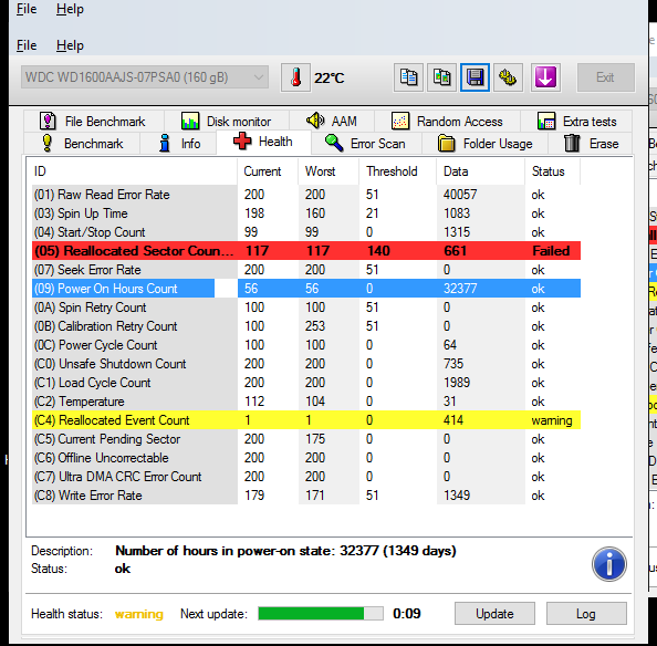

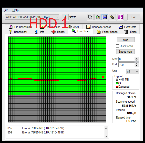

    Well, after 3 and a half years of 24/7 operation, my RAID 5 array has failed due to 2 drives crapping out in a similar way. Ran a 25 pass zero fill and it writes at 6.30MB/s. its done 5 passes and the reallocated sectors havnt increased, these drives have been reliable. They have run 2 virtual machines, a minecraft server and a website for 3 years 24/7 and didnt fail until now, planning on upgrading to 4x 2tb seagates. 3 and a half years is good for 24/7 use of a consumer HDD i think so 10/10 for WD reliability.

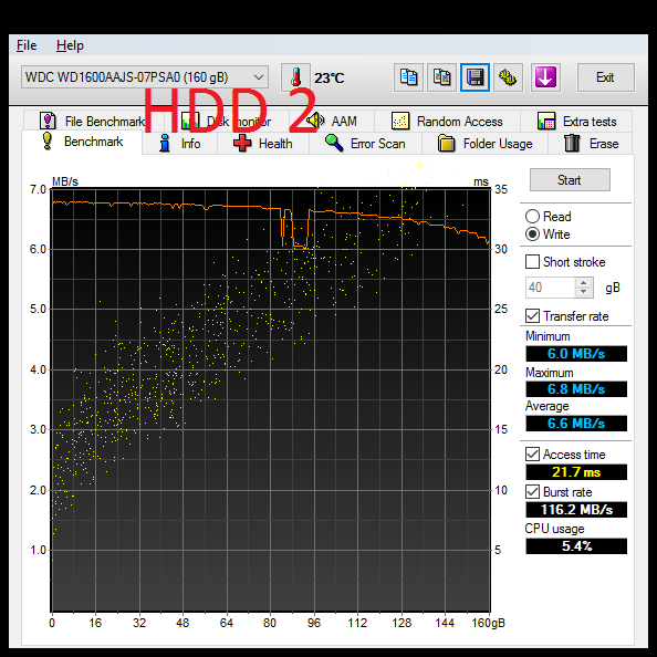

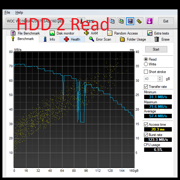

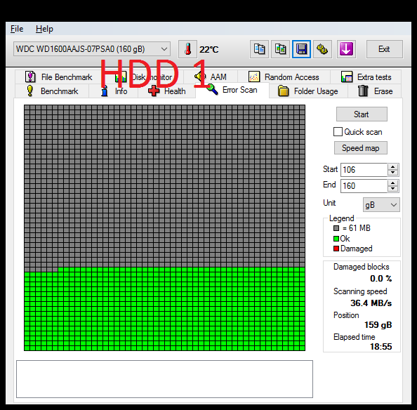

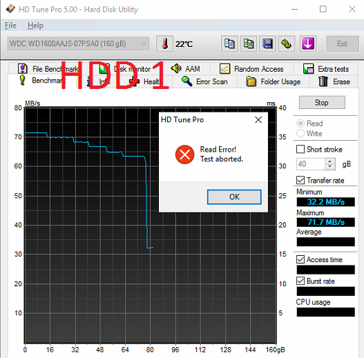

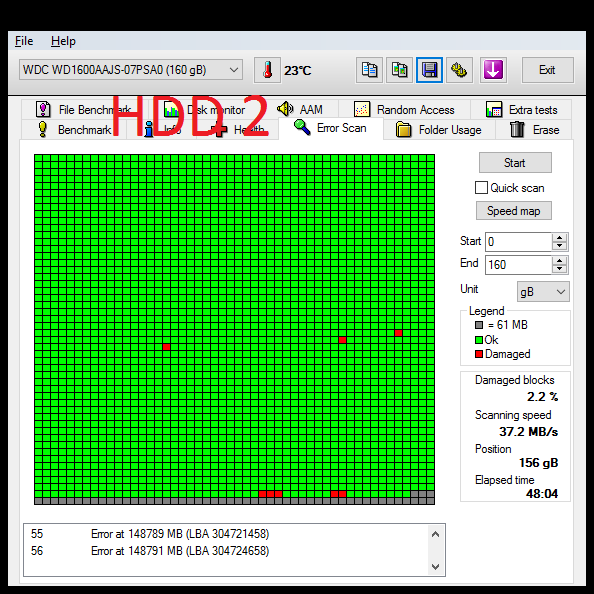

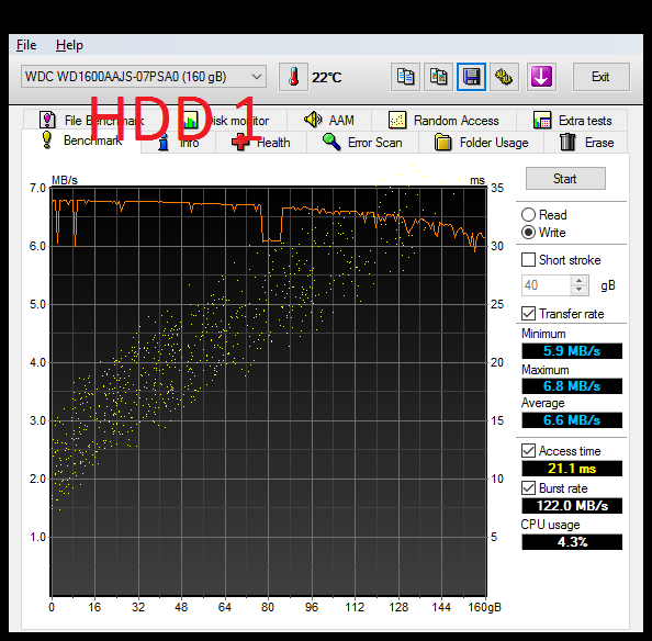

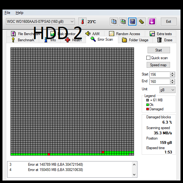

    on my first post the 2nd image is "HDD 1" and 3rd image is "HDD 2" heres the error scan results from HDD 2 (HDD 1 is still scanning due to bad sectors). I will post the images from the HDD 1 error scan when it completes, assuming the drive doesnt fail by then
    EDIT: HDD 1's error scan stopped at 106GB (hdtune bug?), added image 1.. and 2.. and read/write benchmarks

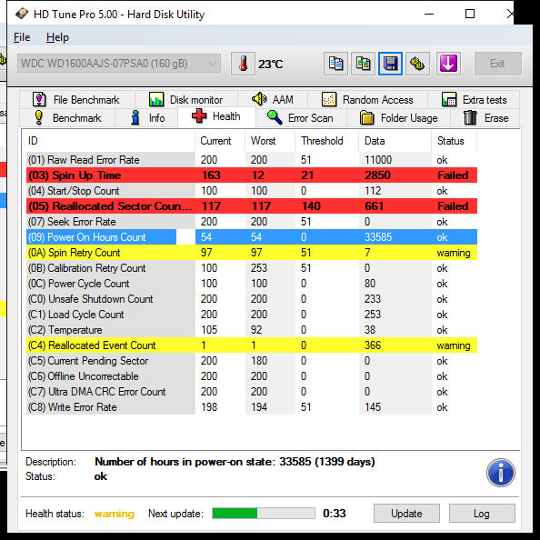

            It's strange how the two drives have exactly the same number of reallocated sectors (661).
            Another thing I notice is that the normalised value of the Power On Hours attribute appears to reflect the life in months.
            For example, one drive has a POH count of 56 (= 100 - 44). The hours count of 32377 corresponds to 44.35 months. The other drive has recorded 33585 hours and a value of 54 (= 100 - 46). Once again the hours count corresponds to 46.01 months.
            So it would seem that each additional month of life decrements the normalised value by 1. In other words, the drive is rated for 100 months.

              The drives are caviar SE, not WD blue. Wonder what causes the very low write speed though
