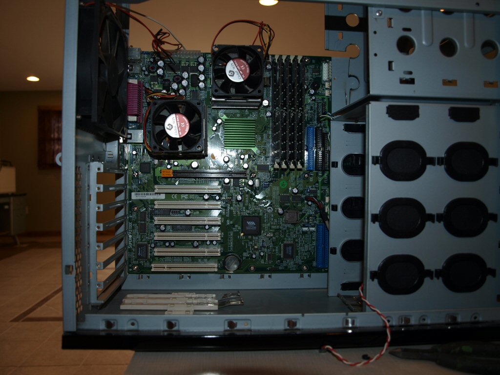

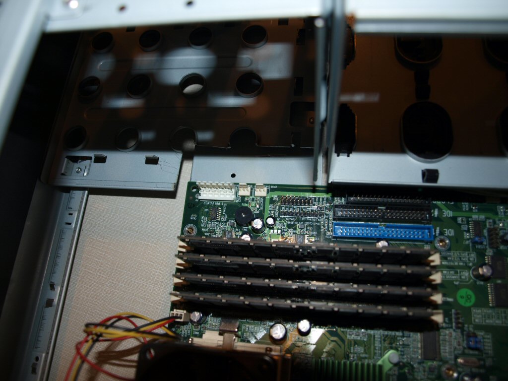

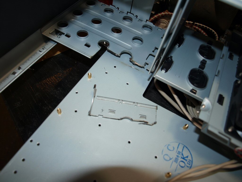

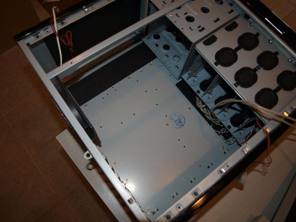

                                        ...and here we go... The icing on the retro system thread... The case, maybe not so retro, but its guts are, so close enough.
                                        System Specs:
                                        2x 1.4GHz P3 Tualatin-S's
                                        4GB RAM
                                        ATI HD4650 1GB AGP
                                        Adaptec 2100S SCSI RAID Controller
                                        Audigy2
                                        2x 147gb Seagate 15k RPM U160 HDD's in a RAID1

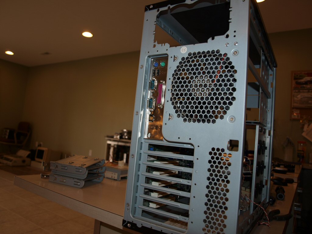

                                        It wouldn't be a good build unless there was a case mod involved.
                                        The corner of the 5.25 cage was too close for the motherboard to clear, since it was a trifle too long for the case. Its not an eATX board, but its longer than the standard ATX, and it interfered with the cage.
                                        Nothing the die grinder couldn't cure!!
                                        Now we're cookin'!!

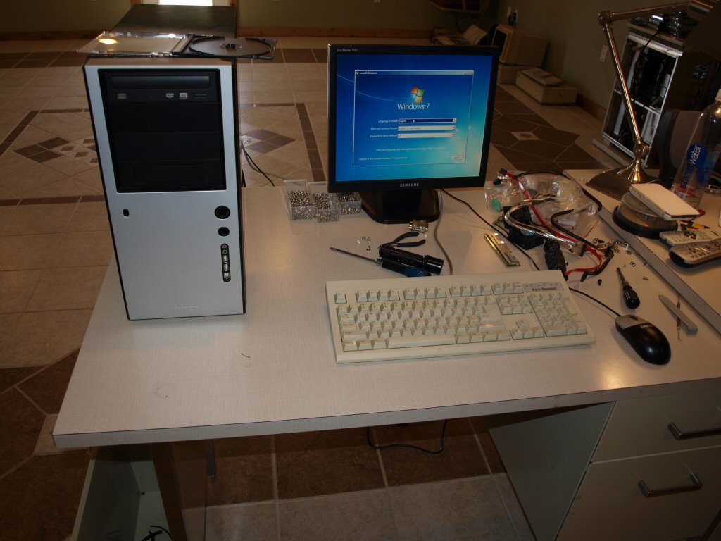

                                        All put together.
                                        Win7 on the way.
                                        Up & running.
                                        This is the oldest core hardware I've ever put win7 on, runs surprisingly well.
