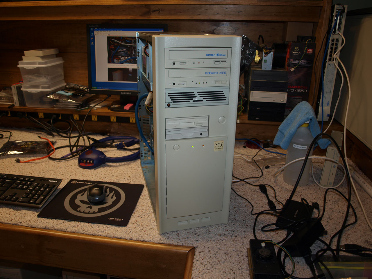

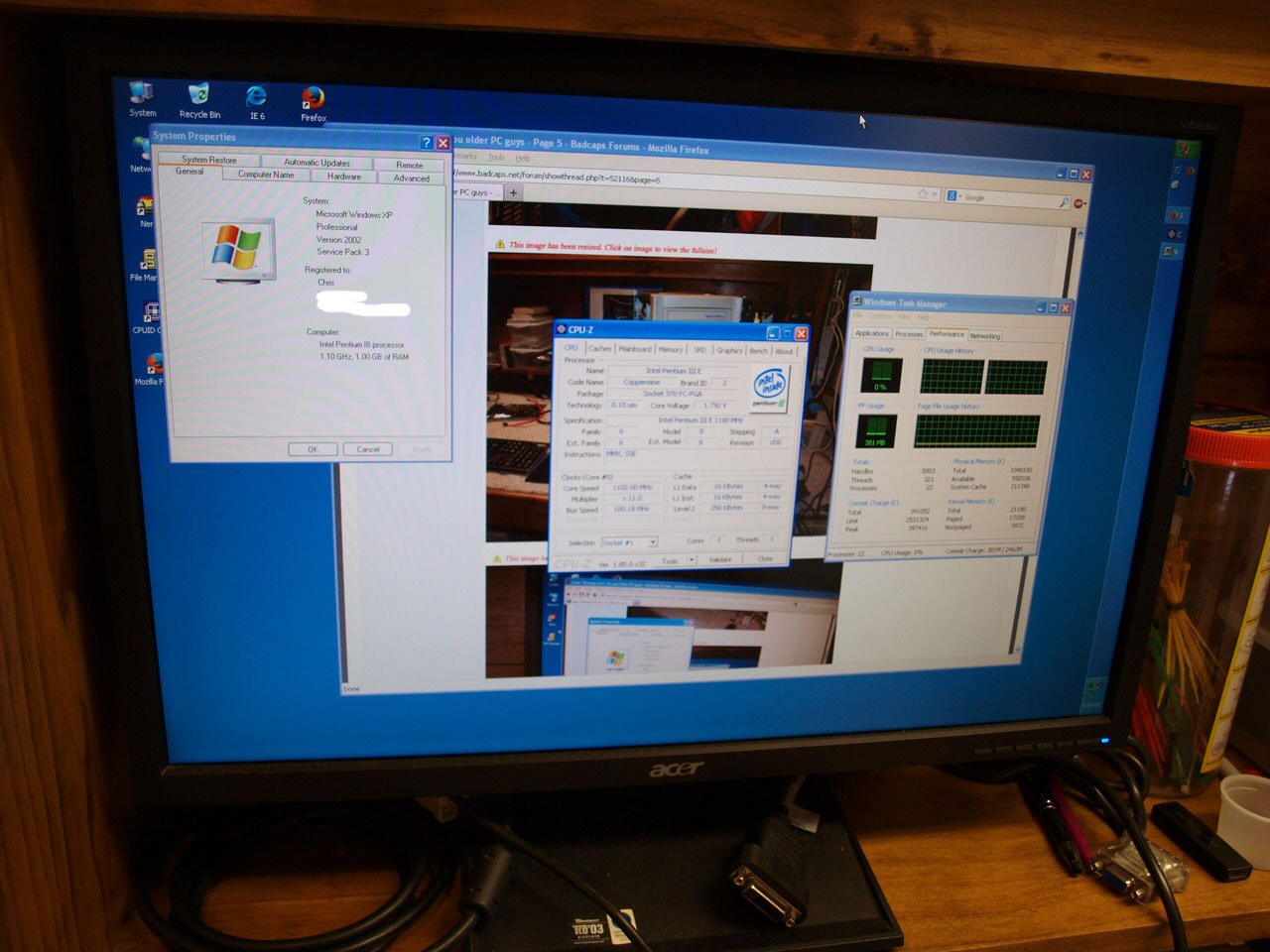

              Just an update to this relic... Many moons ago, I was given a goodie box that happened to contain an Upgradeware Slot-T Tualatin adapter. I have a couple 1.26 Tualatin-S CPU's in the junk drawer....and curiosity got the better of me....
              It worked without issue. Now the problem, I need to find another one in order to run them dual.....that's easier said than done apparently....not a single one on ebay or amazon.
              ...but hey, how cool is this!!
              Yea, I've changed a few things around on this system...I removed one of the opticals and replaced it with a bay cooler for the 15K RPM cheetah that's in it. If I can find another Upgradeware Slot-T adapter, I'll grab a pair of 1.4GHz Tualatin-S processors, as those are plentiful & cheap....and will officially have this machine maxed out. Of course this message was posted from it.

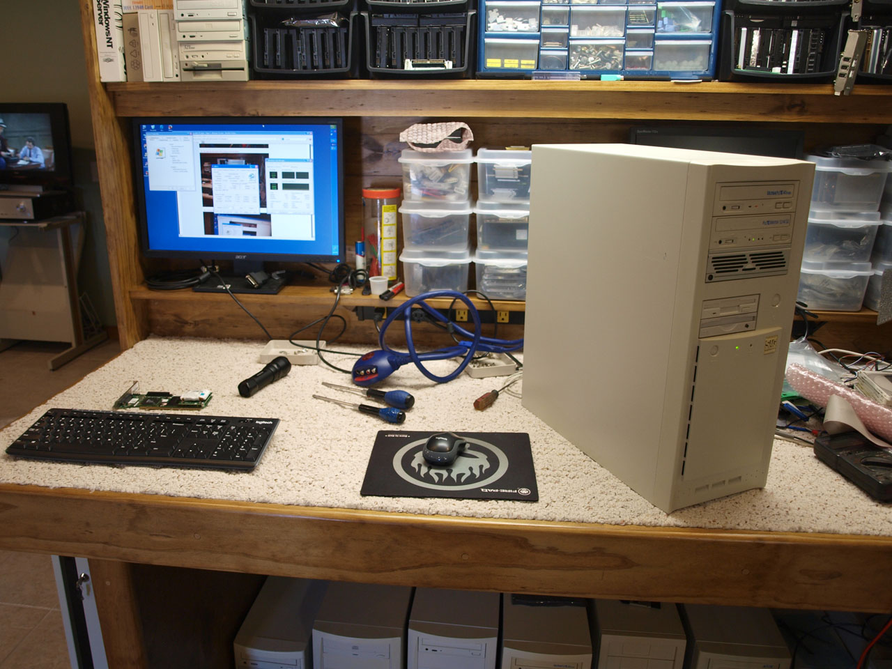

                A few changes in this one.... I picked up a couple 1100/100 CPU's (SL5QW) and a couple Abit Slotket 3's (not easy to find). This creature is how running dual 1.1GHz. I never was able to keep it stable @ 133FSB, which isn't uncommon with the BX chipset. Now its maxed out. I'll snap some pics when I get a chance to install these CPU's..

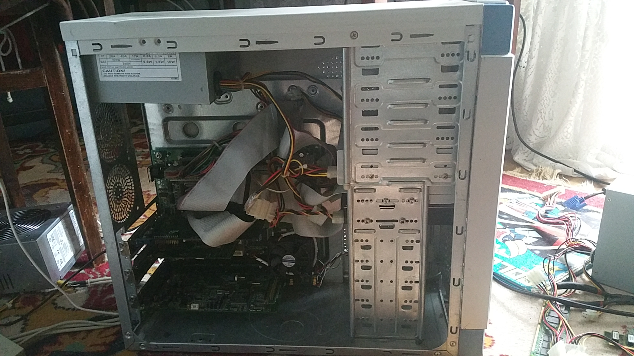

                  Although it's in a ATX case (I used whatever I had around), here's a AMD K6-2 500MHz for you guys

                    You should have asked me. I have 4 new in box slockets in my junk drawer. IIRC 3 are MSI and one is ASUS.

                      I've got dozens of various/random slotkets (epox, msi, asus, and some other generics)....it seems very few support coppermines. I've been through a lot of them testing this. The Abit ones are quite rare it seems. The really rare one are the upgradeware slot-t slotket, which supports coppermines & Tualatins, and it did work in the P2B-D....but finding a mate to it seemed to be impossible. The one I've got came in a goodie box a few years ago. The only other I've found for sale is some moron on amazon wanting $130....umm, no. They don't turn up on ebay, I check regularly.

                        Is that a rare bird? (the CPU being located at the bottom right on a K6-2-supporting motherboard)
                        (I only saw the CPU on the bottom right with Pentium I motherboards, for the P54s and likely P55s)
                        And my K6-2, rated at 450 Mhz, couldn't even OC to 500 Mhz, without crashing more than an airplane, FFS!
                        And also had stability issues, in a warm room, even when not OC'ing, FFS!
                        With that bullshit, I now wonder if I should have left it underclocked to 300 or 350 Mhz...

                            YMMV, but most MVP3 boards I've seen have it placed in the bottom right.
                            Then again, some have it placed differently.

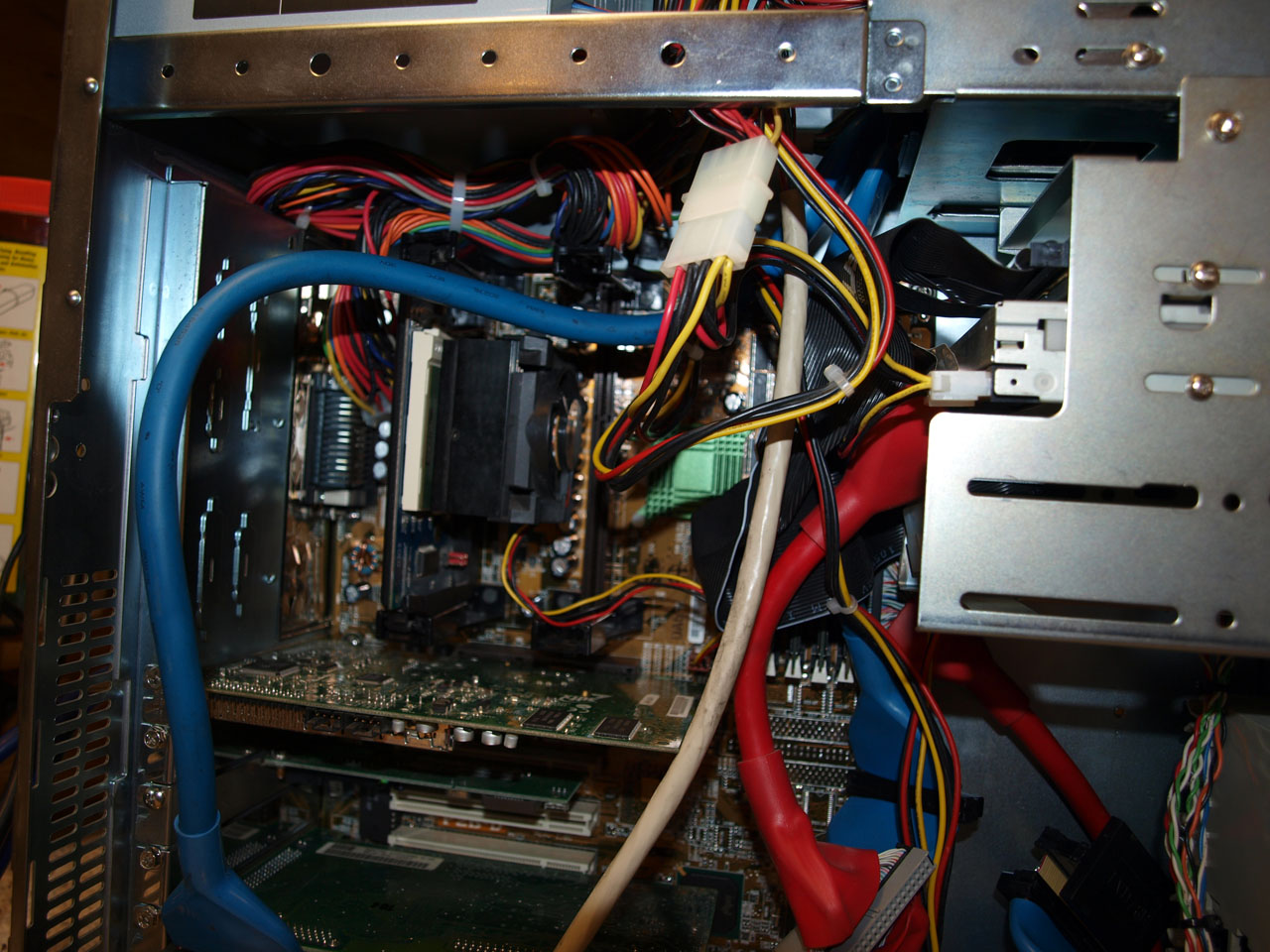

                                  I had a little free time this morning, so I put the finishing touches on this system's internals, and installed the 2x 1.1GHz (1100/100) SL5QW CPU's. These CPU's are very difficult to find. I got one in a junk box, but it took over 6 months to find the mate to it. Hardware-wise, this one is maxed out, and nothing is overclocked.
                                  This has been one of my favorite retro builds, for personal reasons....I had a P2B (housed in a case that I still own) when they first came out (celeron 266 @ 400 and then a 300a @ 450), but I was too poor for the P2B-D, let alone 2x real P2 CPU's. I've considered transferring this build into that original case...

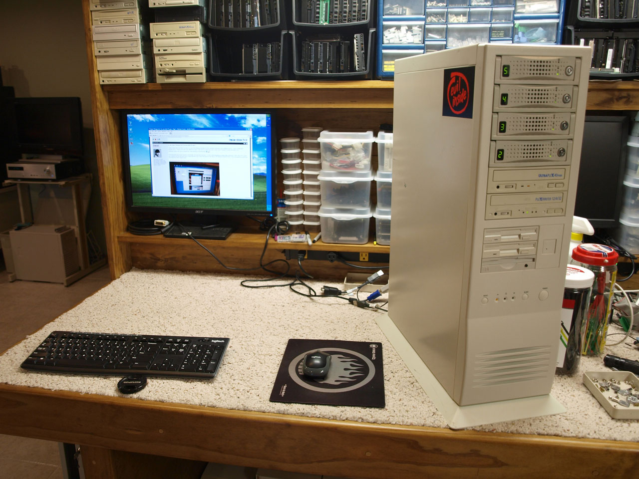

                                      my oh my....again!
                                      The P2B-D system went back into one of the best vintage cases I have.... It also got a RAID upgrade, a BRAND NEW AAA-131U2. I hated to cut the film off the retail box and open it....but its even more blasphemous to have a neat old controller like that, having never been used....I'm sure it was sad & lonely....but not now! A couple of the HDD's came from a hot dry place in the southwest, a couple were some I had on hand. This machine is orgasmic @ powerup, it sounds like a jet engine spinning up!
                                      The final specs:
                                      Asus P2B-D v1.06
                                      2x Very Rare 1.1GHz 100FSB P3 FCPGA (SL5QW)
                                      2x Abit Slotket III Adapters
                                      1gb PC-100 CAS2 memory
                                      3DFX Voodoo3500 GPU AGP
                                      Sound Blaster AWE64 audio
                                      SMC NIC
                                      Adaptec AAA-131U2 U2 SCSI RAID
                                      2x 36gb 15k RPM SCA HDDs in a mirror (OS)
                                      2x 146gb 15k RPM SCA HDDs in a mirror (storage)
                                      Plextor 40x 50-pin cdrom
                                      Plextor 12x4x 32 CDRW
                                      Iomega zip250
                                      Antec 430w PSU
                                      All the SCA HDD's are housed in icydock solid aluminum hot swap racks. These were new old stock I bought probably 15 years ago, and never used.....as SCSI was dying off back then, and I went with sata. This system is a small piece of personal history....definitely one of the finer pieces in the collection!

                                        It'd be awesome to have this rare beast, but I just don't have the money. Argh.

                                          That.... really puts my Soyo SY-6BA+IV to shame.
