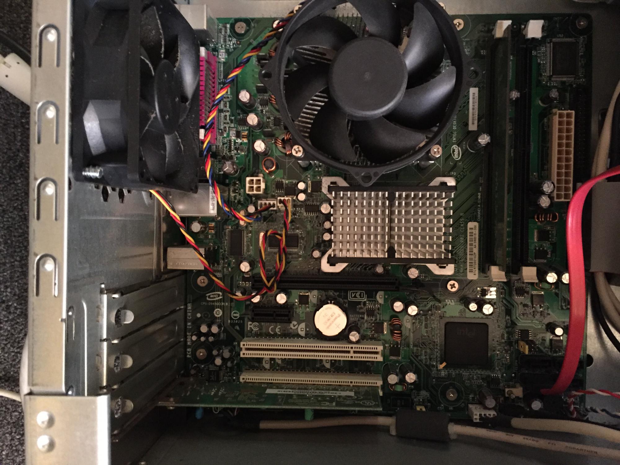

                                  • caphair
                                    • Nov 2011
                                    • 1249
                                    Re: Emachines T5088 - CMOS/checksum random errors
                                    Here's a general over view of the board. Let me know if you need closer pics of a specific area. No caps look bulged and noticed there are two types used KZG and Rubycon.
                                    Also note, if the power cable is disconnected that's when it gives the cmos error, but if I set the date/time and leave it plugged in, it'll boot fine without the error.
                                    Do pcs only use the cmos battery when it's completely disconnected from power? Thought the cmos was in use even when it's been shut down.
                                        The only Bestec PSU that has a problem with high 5VSB is the ATX-250 12E. Another one (possibly) is the Delta DPS-300AB-15B - I haven't dug deeper into that one yet, though.
                                        (Anyways, if you have any such PSU and you don't want to fix them, send a PM to everell - he does like to fix the Bestecs. Or if you are in NoVA, Southern MD, or near Wash DC, let me know. I'll take an OEM unit and recap it any day over those cheap junk found in the stores).
                                        The other Bestecs (ATX-250 12Z, ATX-300 12E, and ATX-300 12Z) are well-designed PSUs. However, they do often still have bad caps in them which can make the PC do bizarre things or not work at all.
                                        However, it is not only Bestec that has problems. Delta/Newton and LiteON also often have bad cap brands inside them. So it doesn't matter what you have - just open it and check the caps. Those OEM units are actually really good in terms of built quality, sans the caps. Whatever you do, don't go buying a cheap sub-$20 PSU on eBay/newegg/Fry's... etc. The cheap PSUs can sometimes perform worse than the used OEM units, despite being brand new.
                                        Now to address some of your issues...
                                        KZG are absolutely terrible caps and they can often fail without showing any visible signs. I just had a motherboard pop one KZG cap after sitting in storage for a year without any power applied. That's how bad KZG is - they can go bad all on their own!
                                        Other than that, I don't see anything else wrong with the board.
                                        Yes, only when PSU is unplugged from wall.
                                        You said you tried a new battery and CMOS still resets. In that case, also check battery socket joints. Bad caps likely won't cause this issue, because the battery power probably doesn't go through any electrolytic caps at all.
