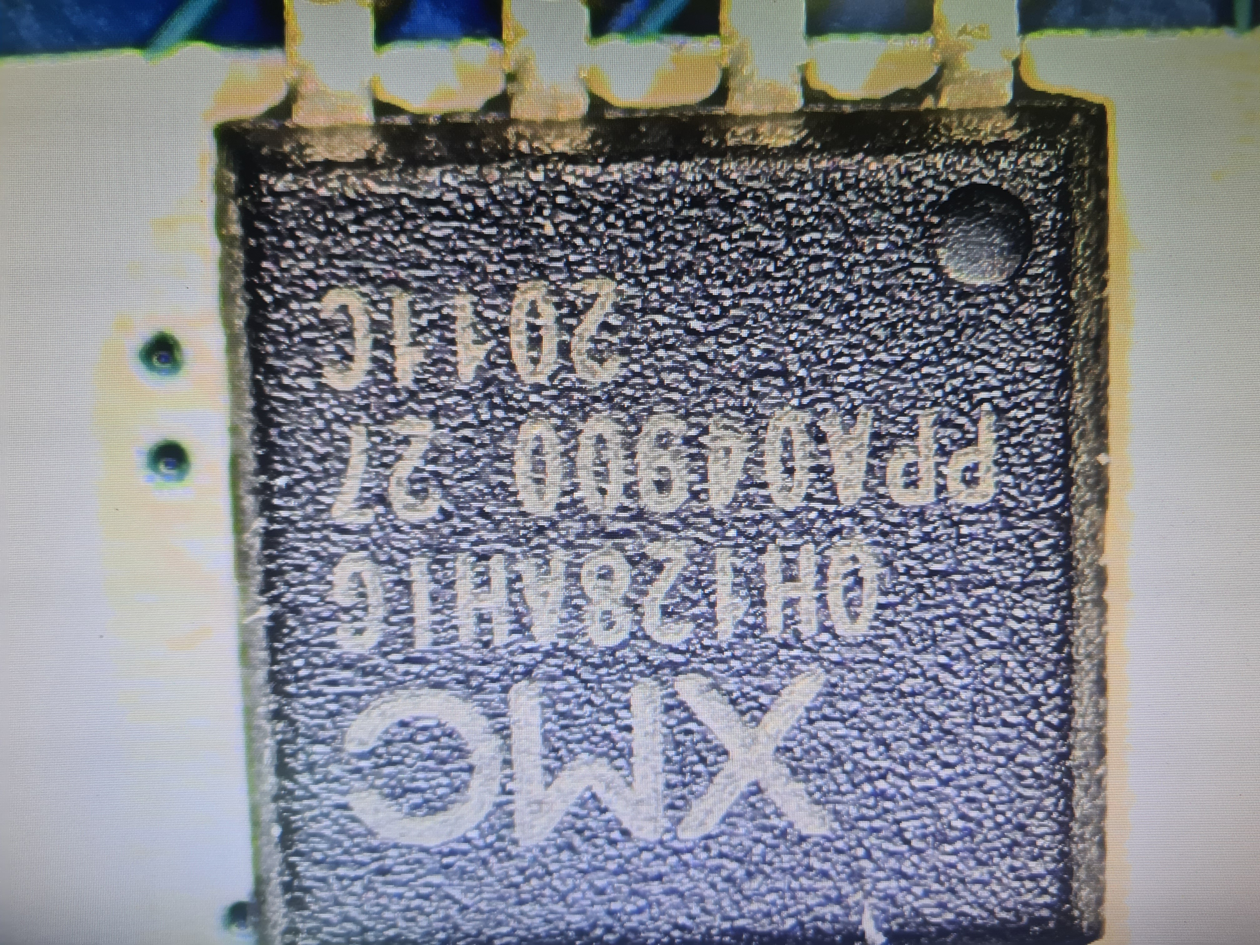

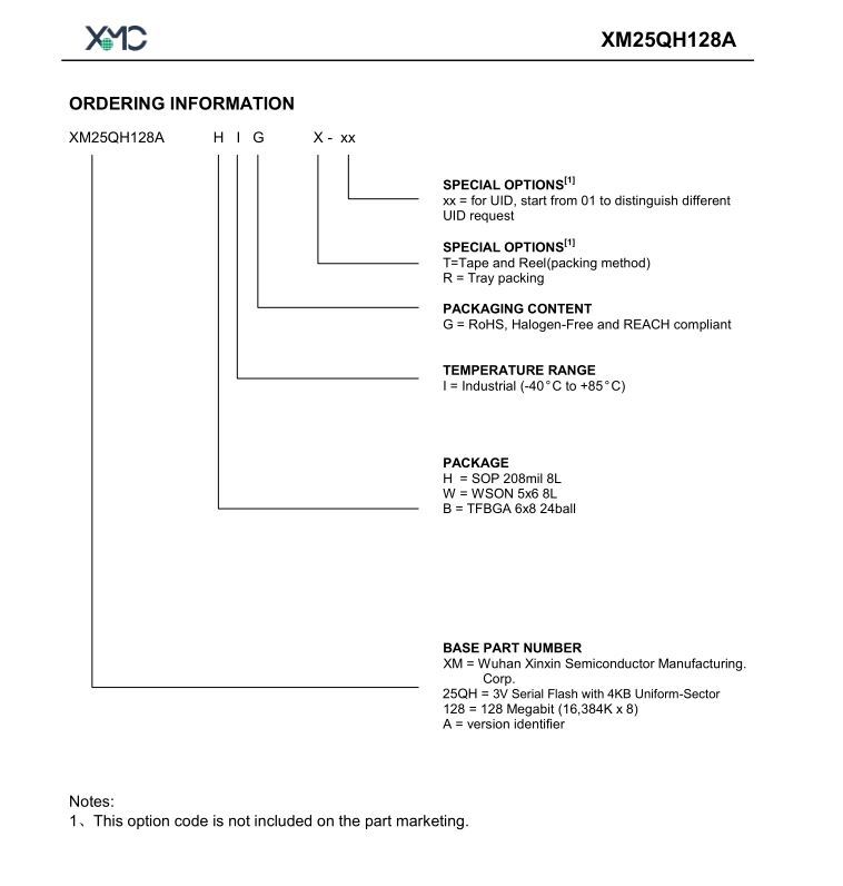

          Hey guys,
          could someone please tell me the name of the bios ic and maybe explain to me how to read the marking and find the name myself? Googling the marking led to nothing useful. Thx
          Beste regards
            • 21907
            Originally posted by Hw31
            Hey guys,
            Beste regards
            QH128AHIG Datasheet https://www.badcaps.net/forum/troubl...95#post1594795
