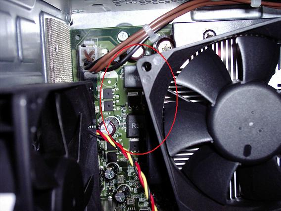

    Just an update here.
    I rolled up a sheet of paper, put it to my ear, and tried to pinpoint exactly where the noise is coming from.
    It appears to be coming from these black box things. When the paper is the area highlighted, I can plainly hear a noise that sounds like static.
    What are these things?

      Re: Odd noise, apparently from motherboard.
      Looks like a fan to me.
      Actually, I think what your hearing is the inductors. Tricky to tell from the photo, but I'm guessing that's what the black blocks are next to the Mosfet's.
      Its fairly normal for them to make a high pitched squeak/white noise type of sounds. Just be aware that it could be a sign that the capacitors are starting to age (if it starts to make that noise but never had before), but they can also make that noise normally, and it often varies depending on the CPU load.
      My ASUS P5N32-SLI makes just such a noise, and always has from the day I got it. Once you put the case cover on its almost inaudible, but you can occasionally here it when the CPU is being thrashed.
        Oops, sorry about the lousy photo
        Yeah, this is more like a white noise as opposed to a whine. When I listen through the paper tube it almost sounds like a bowl of rice crispies, so I suppose it could be a capacitor sizzling too. But it definitely seems to be coming from the black blocks.
        The odd thing is that it does it almost constantly when the CPU is throttled. Whenever the CPU revs up it stops.
          yup, that's an inductor that hasn't been properly potted.
          i'm not sure if it's fixable - that depends on the core.
          alternative: return it and have the whole board exchanged. probably the best option if it's a new system.
                You say you've monitored the core voltages - how much do they vary? Does the 12V vary in sync with the VCore or is it flopping all over the place?
                  i just had 2 optiplex 520 sff boxes in with bad power supplies.
                  they hissed a bit but it went away after a recap.
                  caps on +12 were bad.
                  hiss came from vrm section.
                  unit was quiet and stable after the repair.
                  vcore clean and all caps i could see were mcz.
                    Well, I'm not quite sure exactly what I should be looking at, but in all the monitoring programs I've used the +12V varies between 12.03 - 11.97. VCore1 varies between 1.14 - 1.28 and VCore2 seems to stay steady at 3.06.
                    VCore1 varies the most. There also seems to be a slight difference between the monitoring programs.
                      This looks like more than 10% Vcore voltage fluctuation. Fluctuation can be because of failing capacitors. On my motherbaord (3 phase power Athlon) after recapping fluctuation was reduced to within 2% Vcore.
                      Aswell as using speedfan voltage monitor, look in BIOS aswell and record minimum and maximums you see.
                      It's preferable that atleast in BIOS you see no more fluctuation on Vcore than 5%, prefeably under 3%, I would have thought modern quad phase and higher power systems could achieve this. If the fluctuation range increases over time then it's surely indicative of imminent failure.
