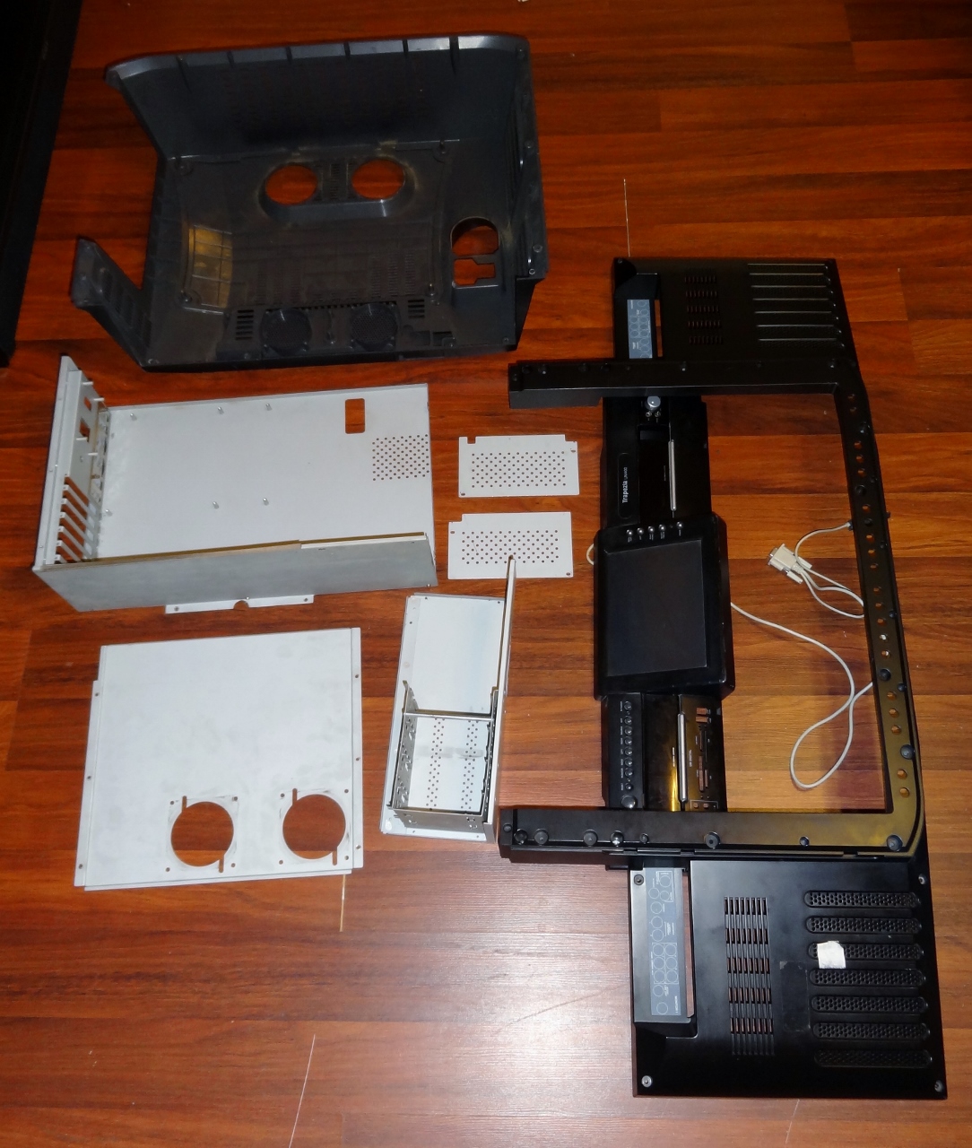

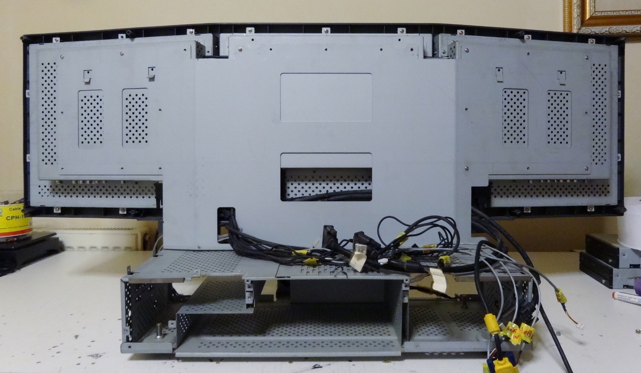

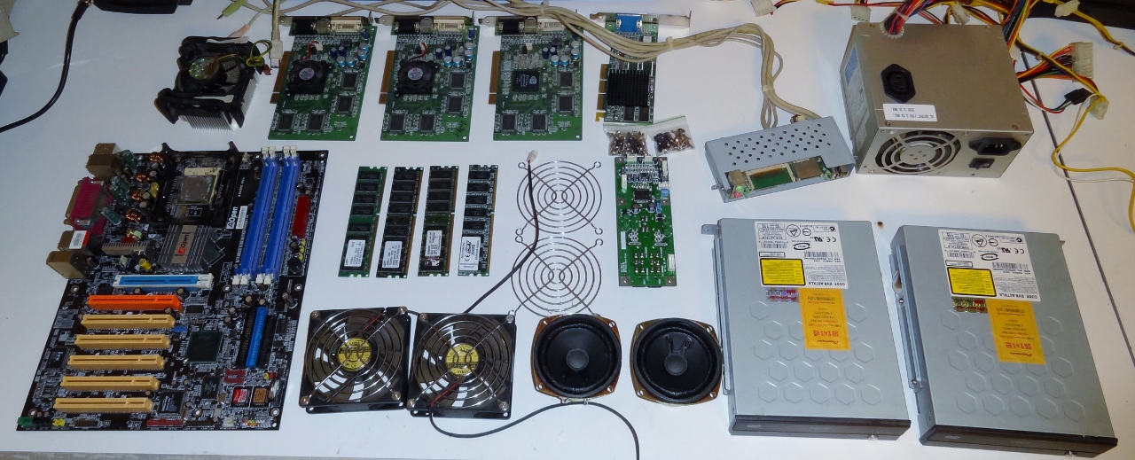

    Re: Restoration UM400 - 4 Screen PC
    Good it all stripped, gonna stick all non electric stuff in bath to give it all a good clean
    Thank god I bug sprayed it, found 10+ dead spiders in the thing, quickly hovered up.

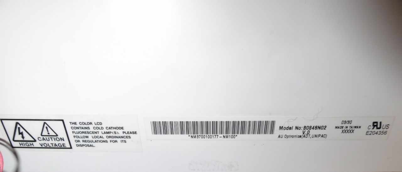

        Originally posted by stj
        be interesting to find what touchscreen controller it uses.
        Touch screen glass needs sticking back down as most of it was very brittle. Taken apart, cleaned old glue and ordered some adhesive tape used on modern phones / tablets
        b0848n02

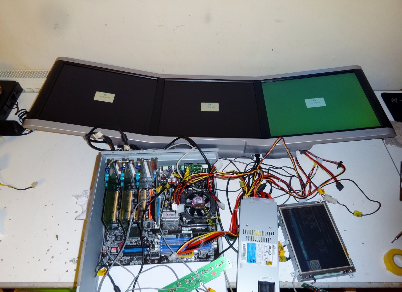

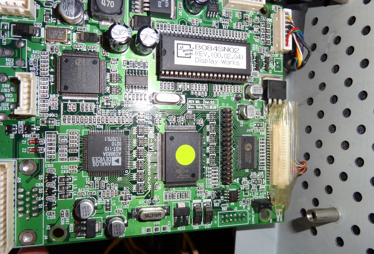

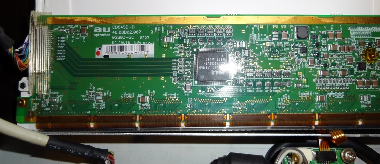

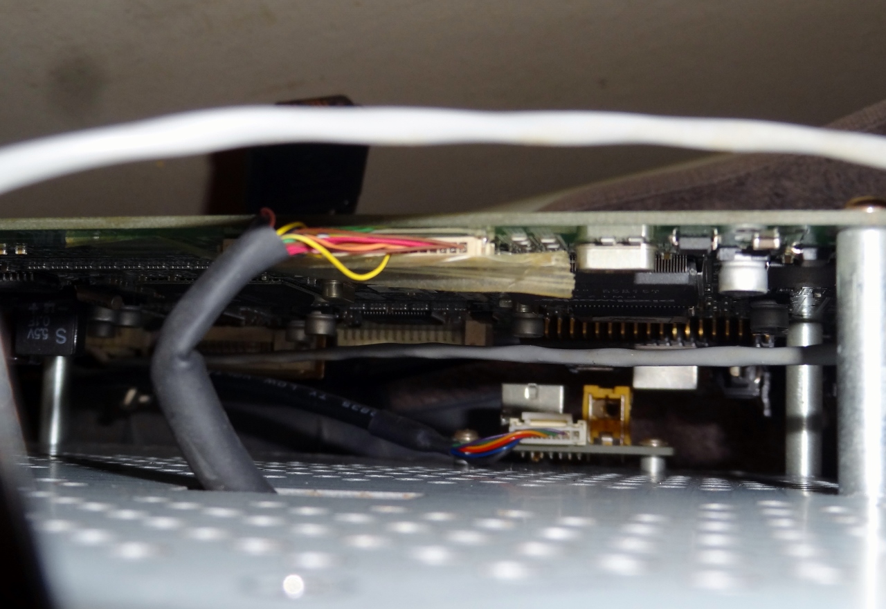

          Alright guys, got it up and running but have a small problem.
          The screen on the right is green and has a line running down it, luckily though it just seems to be a loose / wobbly connector. So if I jiggle it a bit the monitor works fine, no line or green screen.
          What's the best way to sort this as of coarse cant be having to jiggle it all the time.
          Should I remove, clean and then reseat it and put some hot glue over it?
          It looks like it originally had some tape across it which over time one end has peeled away.
            Kapton tape or a blob of hot glue each side.

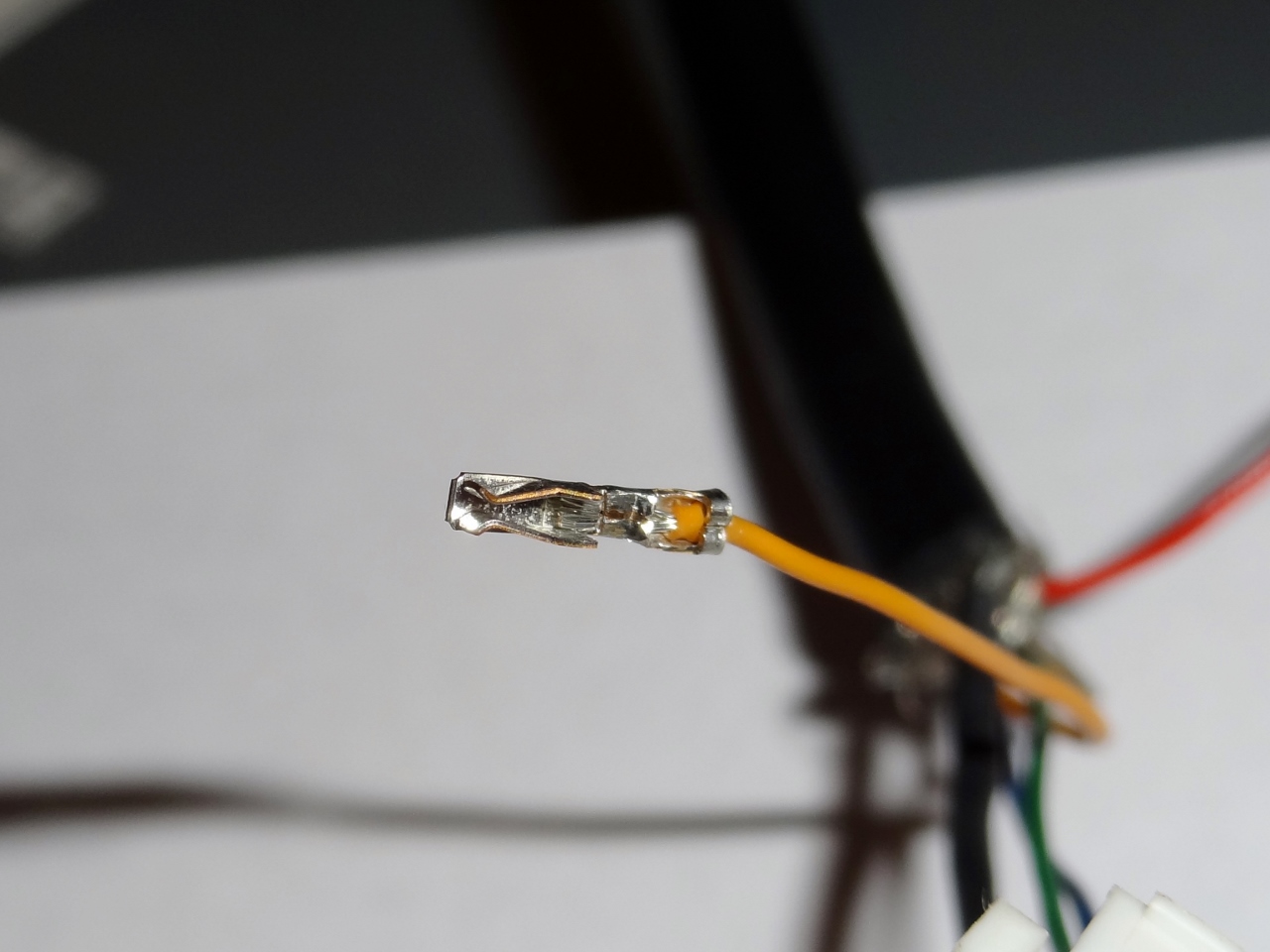

              Bit of hot glue and a cleaning of contacts has sorted.

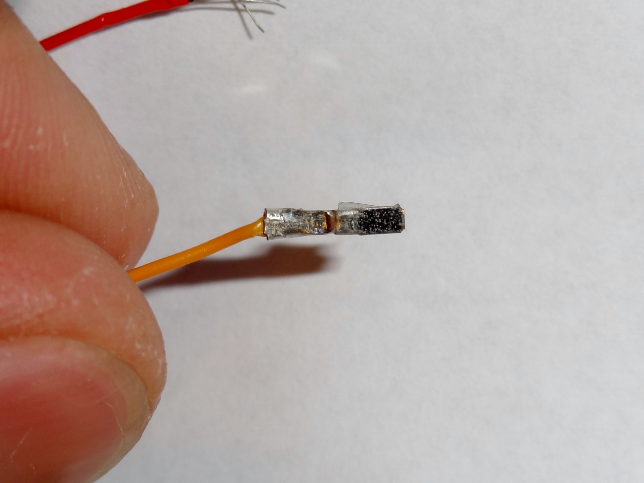

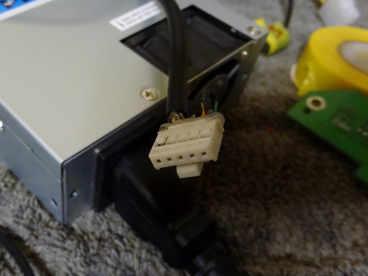

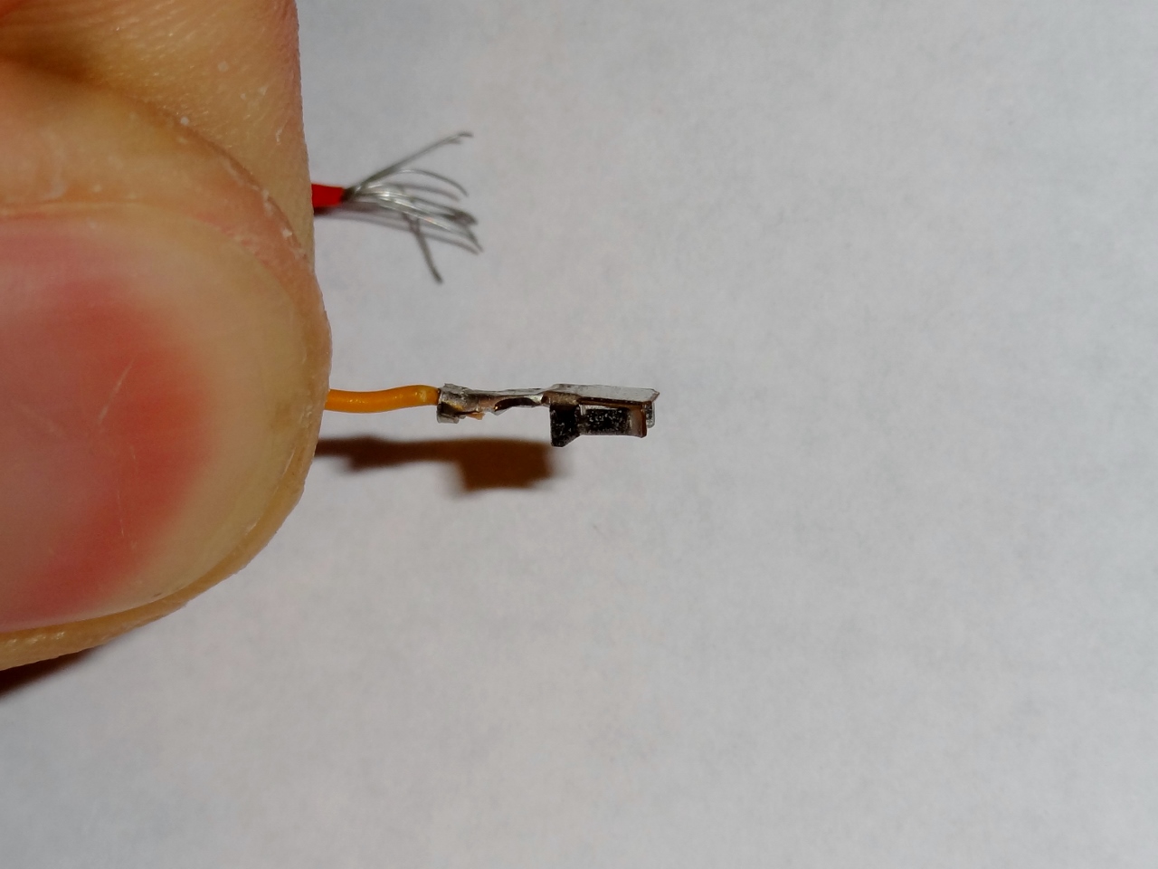

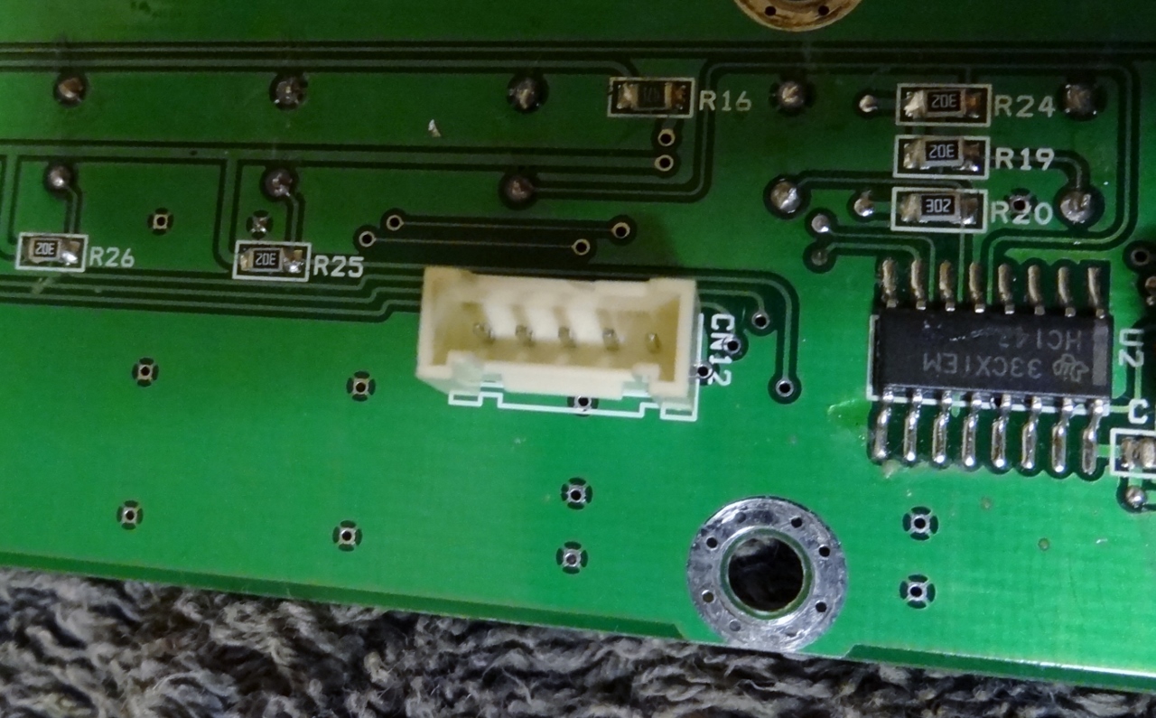

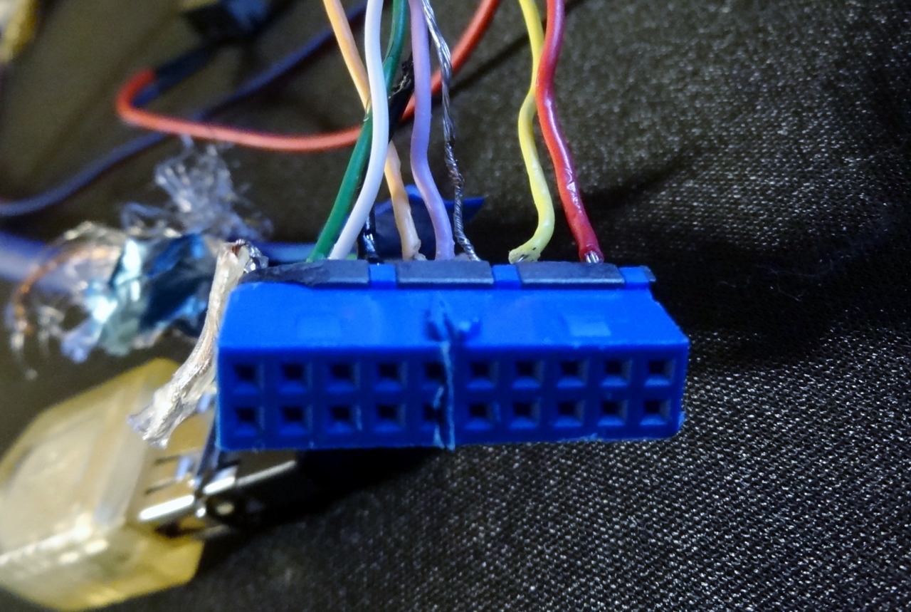

              Unfortunately ran into a second problem of my own making. Broke a pin crimp thing connecting front panel board by pulling too vigorously.
              Can anyone identify the crimp? Will see if I can pick up at maplins.
              7mm Long
                • 31301
                show the shell it fits in.
                • mikay786
                  • Aug 2014
                  • 765
                  After a bit of googling seems to be a JST PHD Series terminal / crimp, problem being the tool to crimp it is few and far between and will cost me a bit to much.
                  http://uk.farnell.com/jst-japan-sold...awg/dp/1830725
                  Ive tried soldering it to the pin but is very wonky. Now trying to mod the header side of a USB 3.0 connector as the pitch looks about right plus has solder points on the pins so will have a good joint.
                    • 31301
                    #29
                    i crimp using long-nose pliers.
                    if you need jst stuff, rapid has a fair amount, and farnell does too.
                    • mikay786
                      • Aug 2014
                      • 765
                      #30
                      USB mod has worked a treat, soldered the wires to the cut down usb header, hot glued and taped it up and is solid.

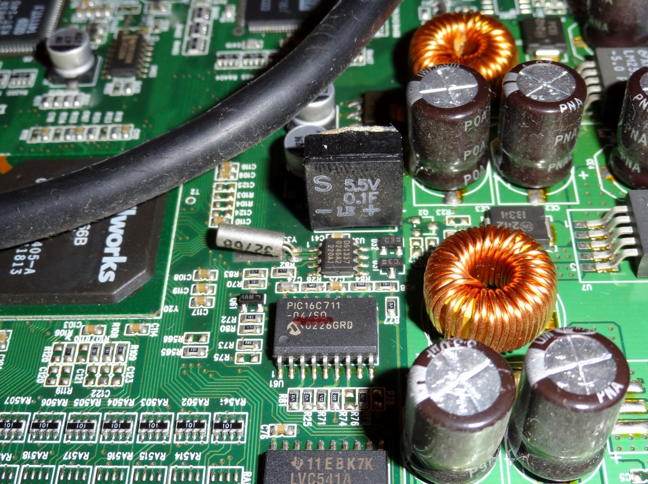

                        • 765

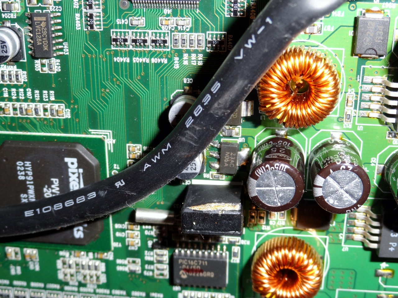

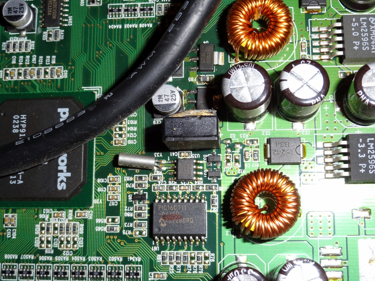

                        #31

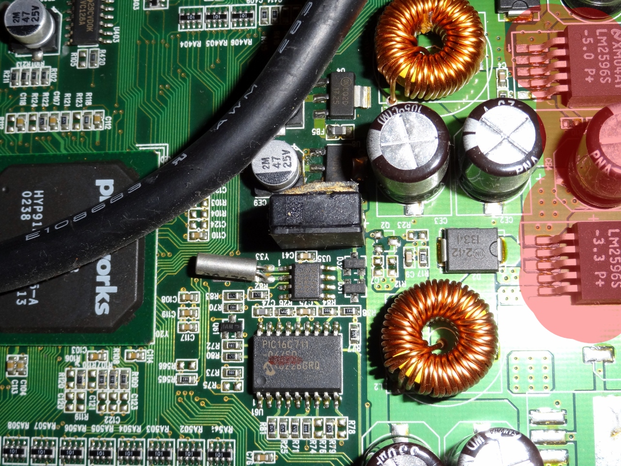

                        oh no found a bust cap, a box shaped one
                        5.5v
                        0.1F
                        S LE
                        Appropriate replacement?
                          • 31301
                          #32
                          that's a supercap, used for memory backup.
                          you can get them anywhere, sometimes called silver caps or double insulated caps.
                          • mikay786

                            • mikay786
                              • Aug 2014
                              • 765
                              #34
                              would something like this do?
                              http://www.maplin.co.uk/p/01f-55v-do...apacitor-n99cn
                                • 31301
                                #35
                                that's the type, just check the lead spacing on the old one because you cant bend the leads on them.
                                  Thanks for the heads up regarding free delivery. Ordered these two, just in case I have fitment issues with one.
                                  http://uk.farnell.com/kemet/fg0h104z...rad/dp/2362054
                                  http://uk.farnell.com/panasonic-elec...rad/dp/9692703
                                    • 31301
                                    #37
                                    i dont know how high above the backplate the board is mounted,
                                    but an old trick if it wont fit between the other parts, is to solder it on the other side!
                                    DONT do it util you know you can put the board back!
                                    • mikay786
                                      • Aug 2014
                                      • 765
                                      #38
                                      No room below but loads above. Could I just leave the legs long?
                                        • 31301
                                        #39
                                        you can, but some arent too long to begin with.
                                        it's acting as a rechargeable battery btw,
                                        looks like a clock
                                        http://www.maximintegrated.com/en/pr...ks/DS1337.html
                                          • 31301
                                          #40
                                          btw, this bullshit is seriously bad design, putting a cap between a pair of linear regulators!!
