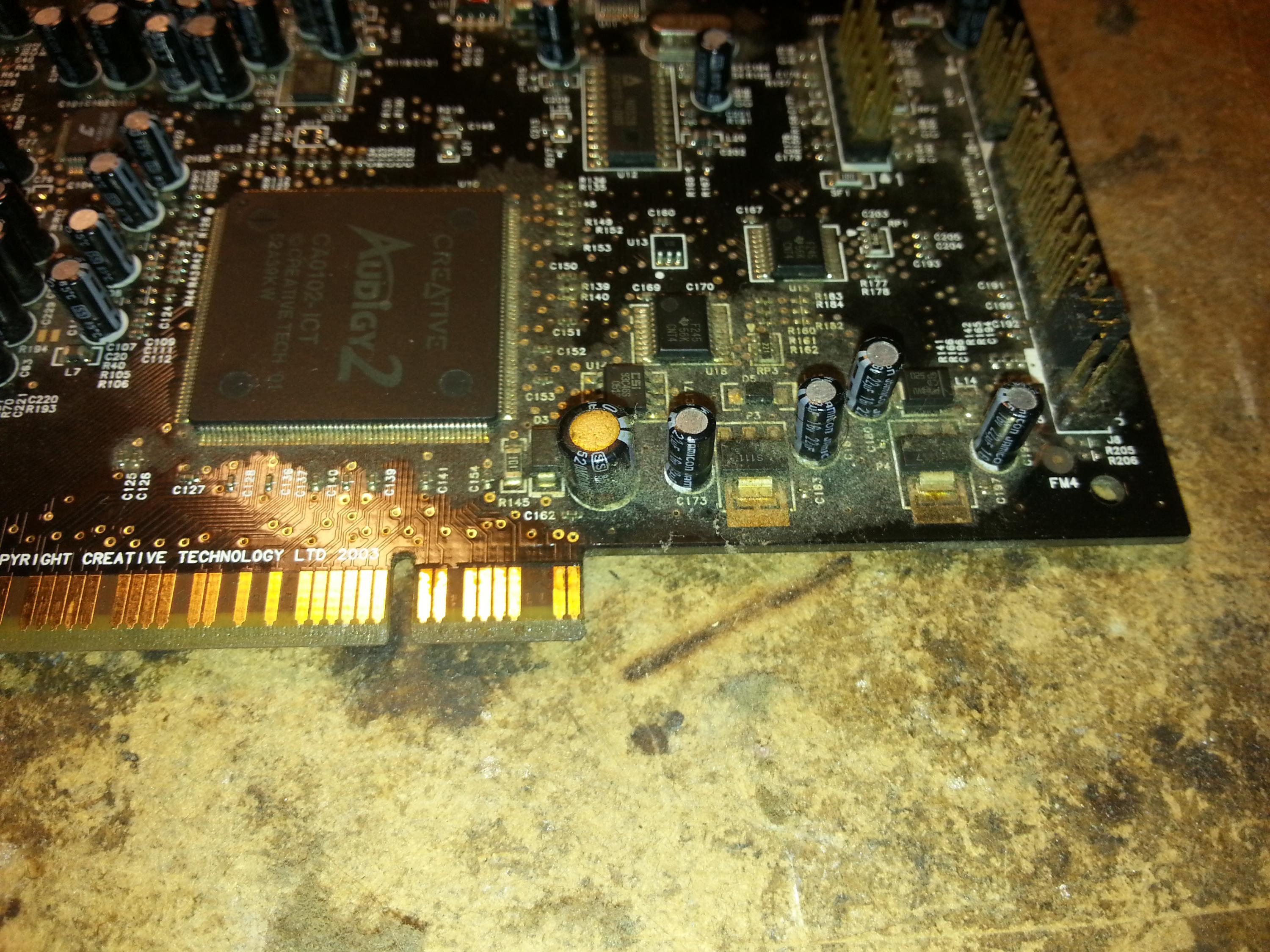

    My sounds been crackling in all 5 channels for a while now. It only does it when the house is warm. It gets worse as the temperature goes up. I first thought it was a transistor in my 5.1 speaker system but it's quiet when the computers not running. So I assume it's the sound card. I bought it used in 2006 off of e-bay. It's worked fine with my old system until now. Bad caps? Have you heard of this problem? What can you recommend for an Asus P5Q-E with windows 7? Thanks.

    I have exactly the same card and have experienced crackling occasionally. Recently i deiced I'd had enough and gave my computer a bit of a clean.
    i found residue on my sound card around a cap. I could not determine if it was the cap that had leaked or something has got spilled on my PC. I replaced the cap and I've had no crackling since.
    I'll dig out the photo i took.

      pull the card out, clean the contacts and put it back.
      and pull the jacks out, and clean the sockets with ipa on a cotton-bud.
      the socket contacts tarnish.
        The Asus Xonar DG is a good quality reasonably priced sound card available in PCI and PCI-E.
        shit design, putting caps between regulators to get cooked.
        if i owned one of those, i would replace those 22uf caps with tantalums.

                Temperature dependent sure sounds capacitor related...
                Did you see this thread?
                https://www.badcaps.net/forum/showthread.php?t=3543

                  Interesting, there's a lot in there. Mine doesn't pop when it's around 70 in the house. Pops a little at 75. Pops so much you can hardly hear anything when it gets up to 80 in here. Nothing was changed when it started, so I would blame hardware and not software.

                      i doubt it's caps related.
                      caps actually work a bit better when warm.
                      i would strip the machine down, clean out all the dust and rebuild it.
                      i had a 24/7 tower case that used to get unstable after 4-6months if i didnt do that every 3 months.
                      it got a lot better after i fitted a bank of fans to create positive air pressure and put filters on the fans btw.

                        I cleaned everything and no change. It all looks good so I would blame caps or solder. I put a Soundblaster Zrx in my new build so I ordered a Soundblaster Z for this old system. Works great with windows 7. I never could get the Audigy 2 Zs to work right with 7. I threw away the microphone that came with it. It sounds great and even in a hot house no pops. I can enjoy my music again. Thanks for the advise everybody.
