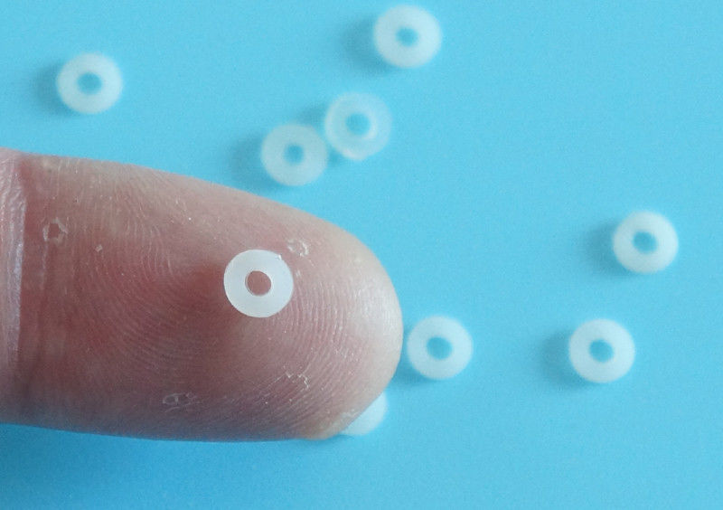

        I keep re-greasing more and more sleeve bearing fans... Lately I've gone even a bit further. While cleaning and re-greasing a Topfan 90mm variant, I broke the nylon snap ring. Now if any of you have taken apart fans, you know what I'm talking about. Problem is, these are impossible to purchase. So what I did was I used a 2.5mm (inner diameter) x 5mm x 1mm washer like this:

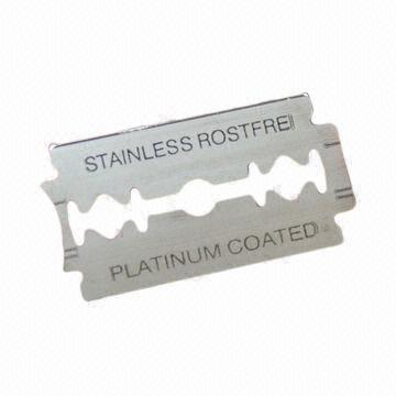

        The problem is, these washers are too thick to fit into the groove on the shaft. The trick is to glue the washer to some hard surface (Use rubber cement because it peels off easily afterwards), and then thin it out with a dremel. The best way to make the split in the washer is to use an old fashioned razor blade:
        What you do is heat up the sharp side until it's red hot (I used a lighter torch for this), and then slice through. It needs to be done this way because the cut has to be a slit, and using cutters would warp the surrounding nylon.

              ... While cleaning and re-greasing a Topfan 90mm variant, I broke the nylon snap ring. Now if any of you have taken apart fans, you know what I'm talking about. Problem is, these are impossible to purchase.
              I have a simpler method - cut a piece from a regular staple used for paper and bend the piece into a C shape. And that's it.
              I also have two fans where I didn't install nylon c-clip (due to loosing it or it breaking due to heat generated when the fan seized). In both cases, the fans had strong magnets to hold the rotor in place and the fan was not to be oriented with the rotor facing down.
