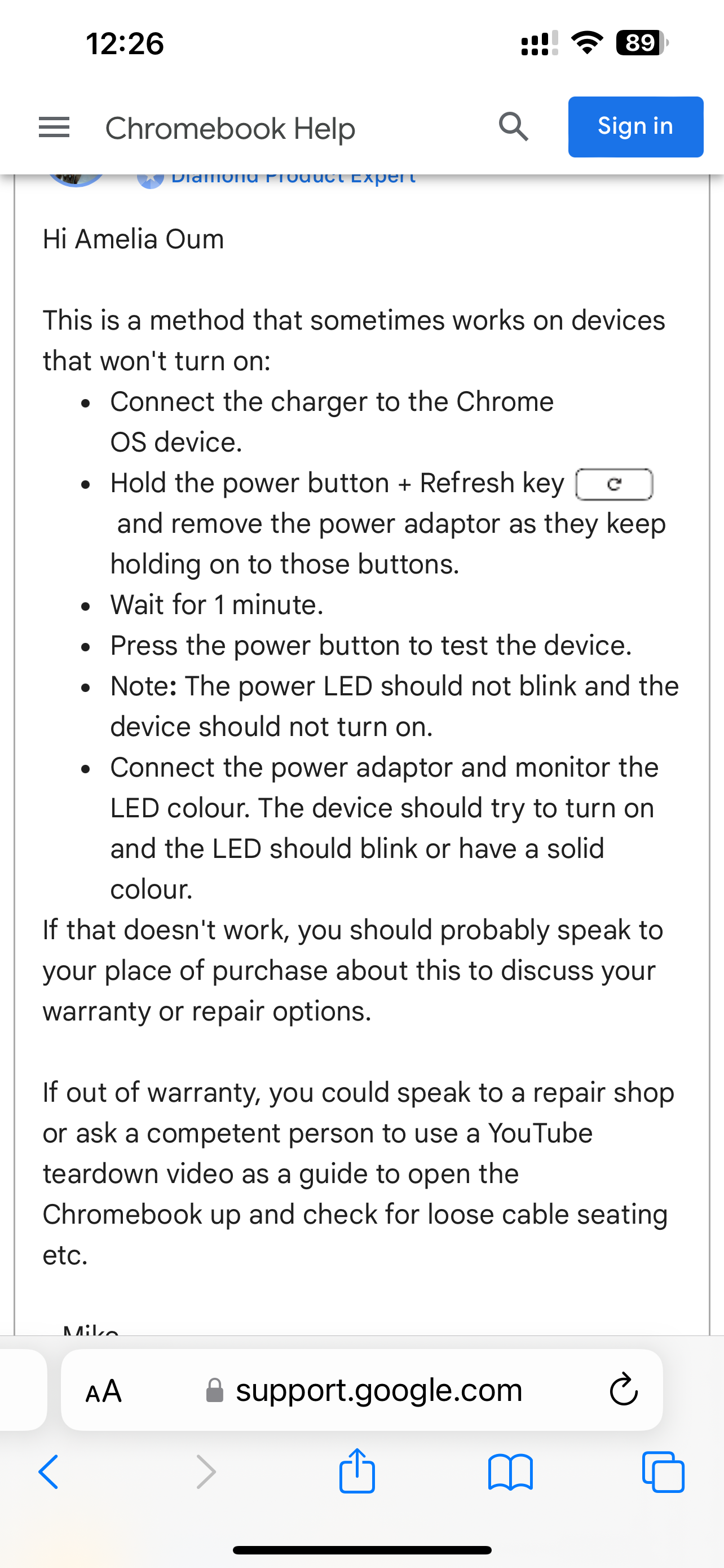

        try this i will try tomarrow let me know if this work

          Thanks man! I'll try and let you know
