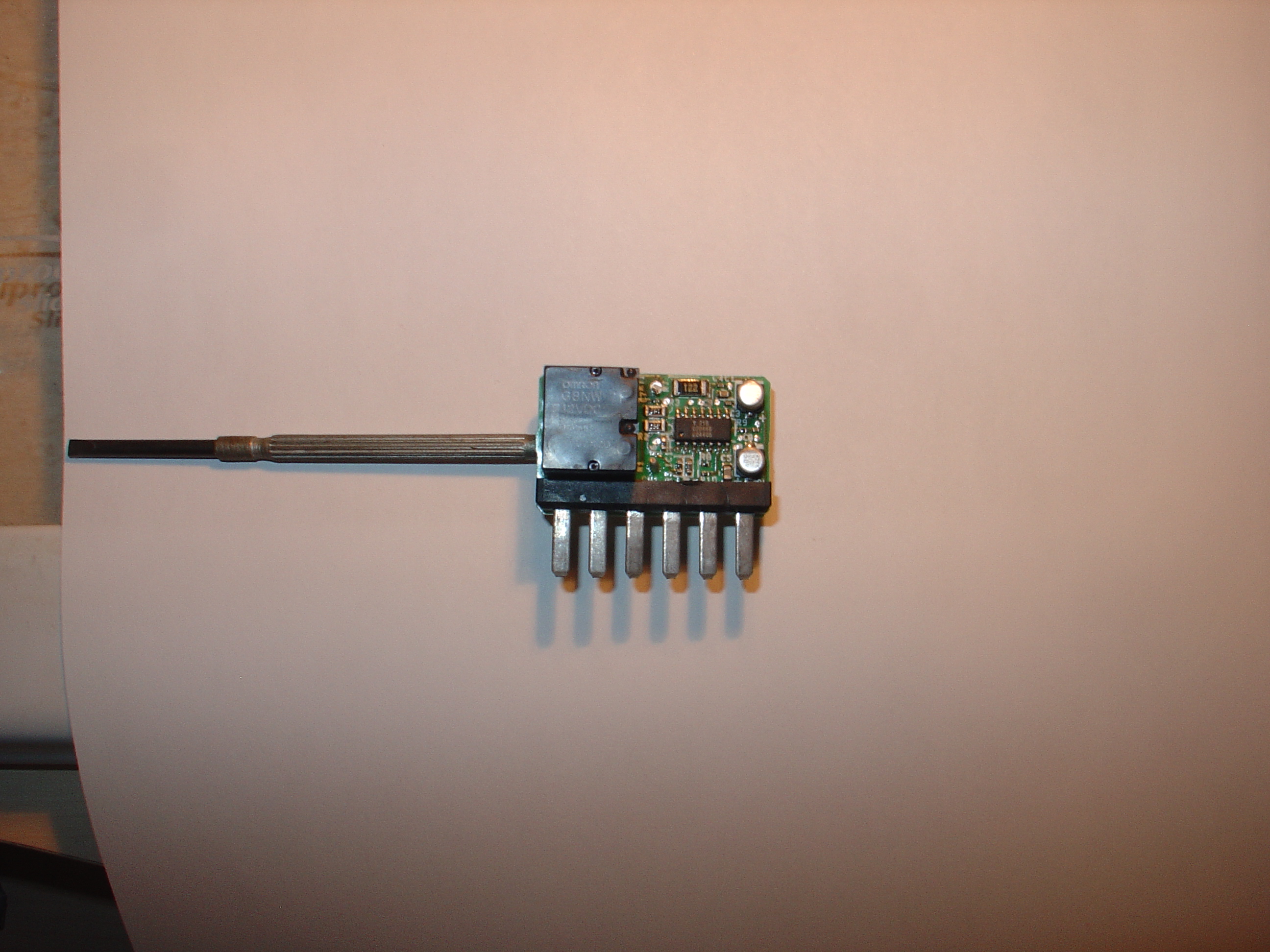

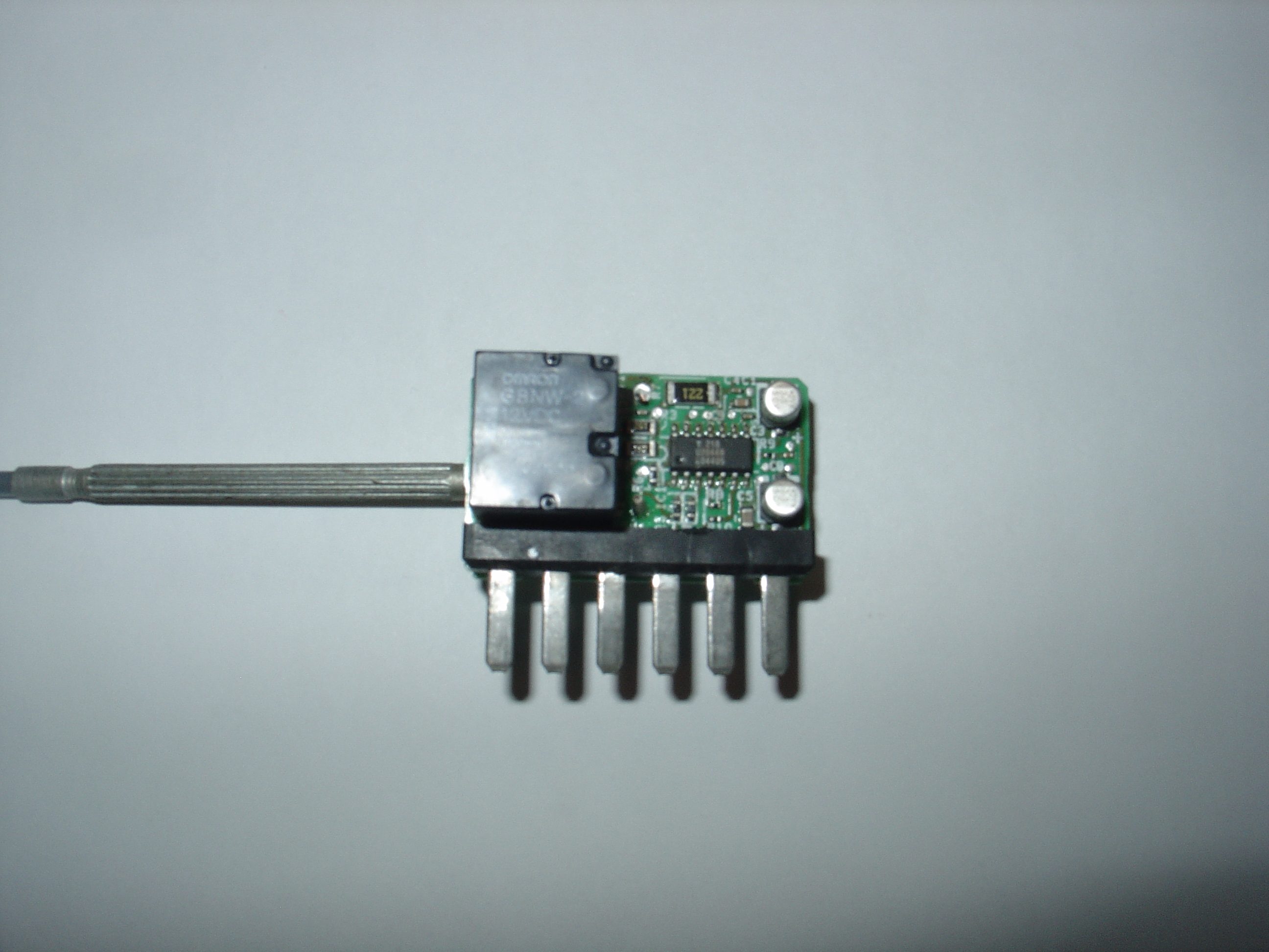

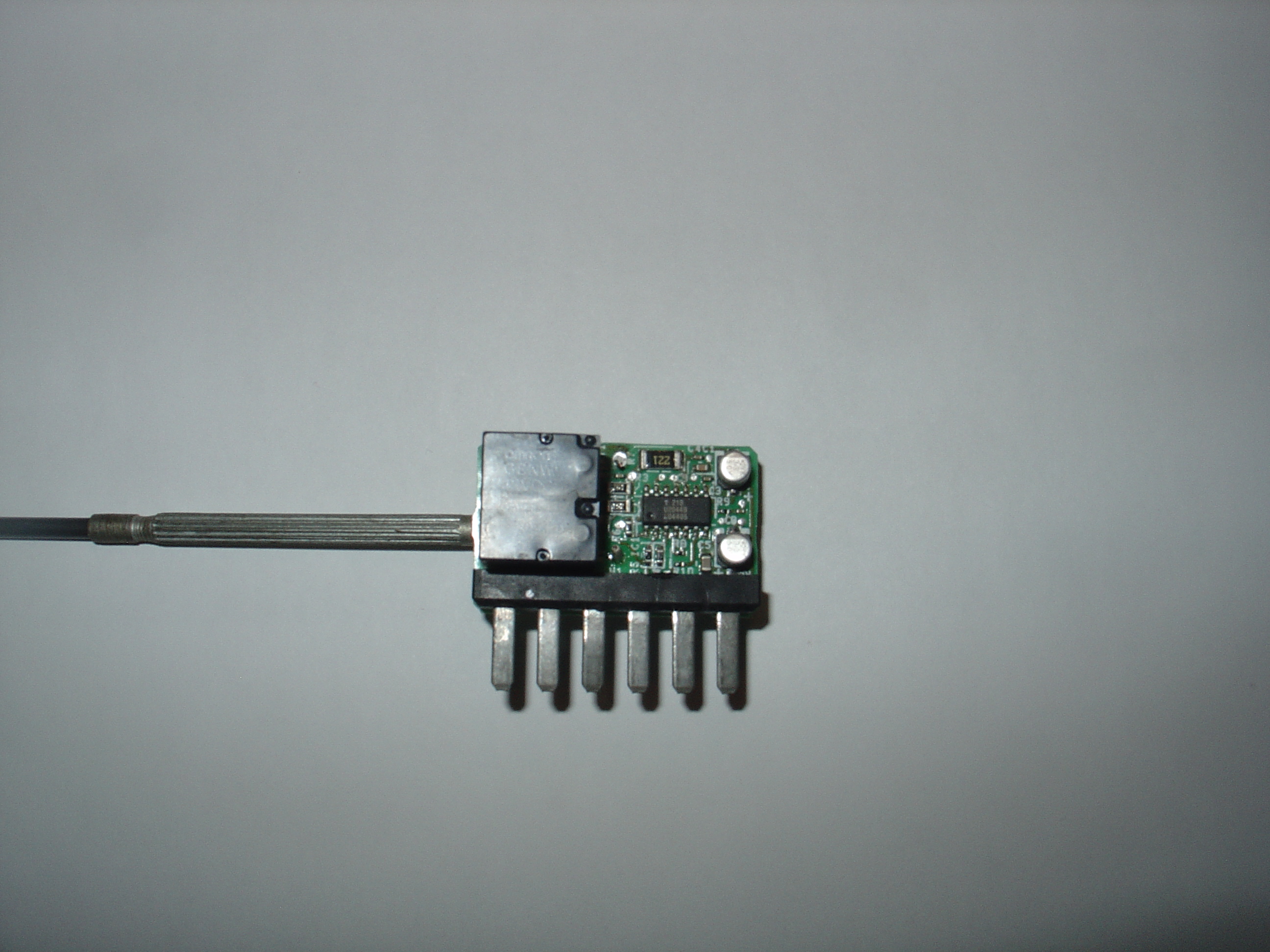

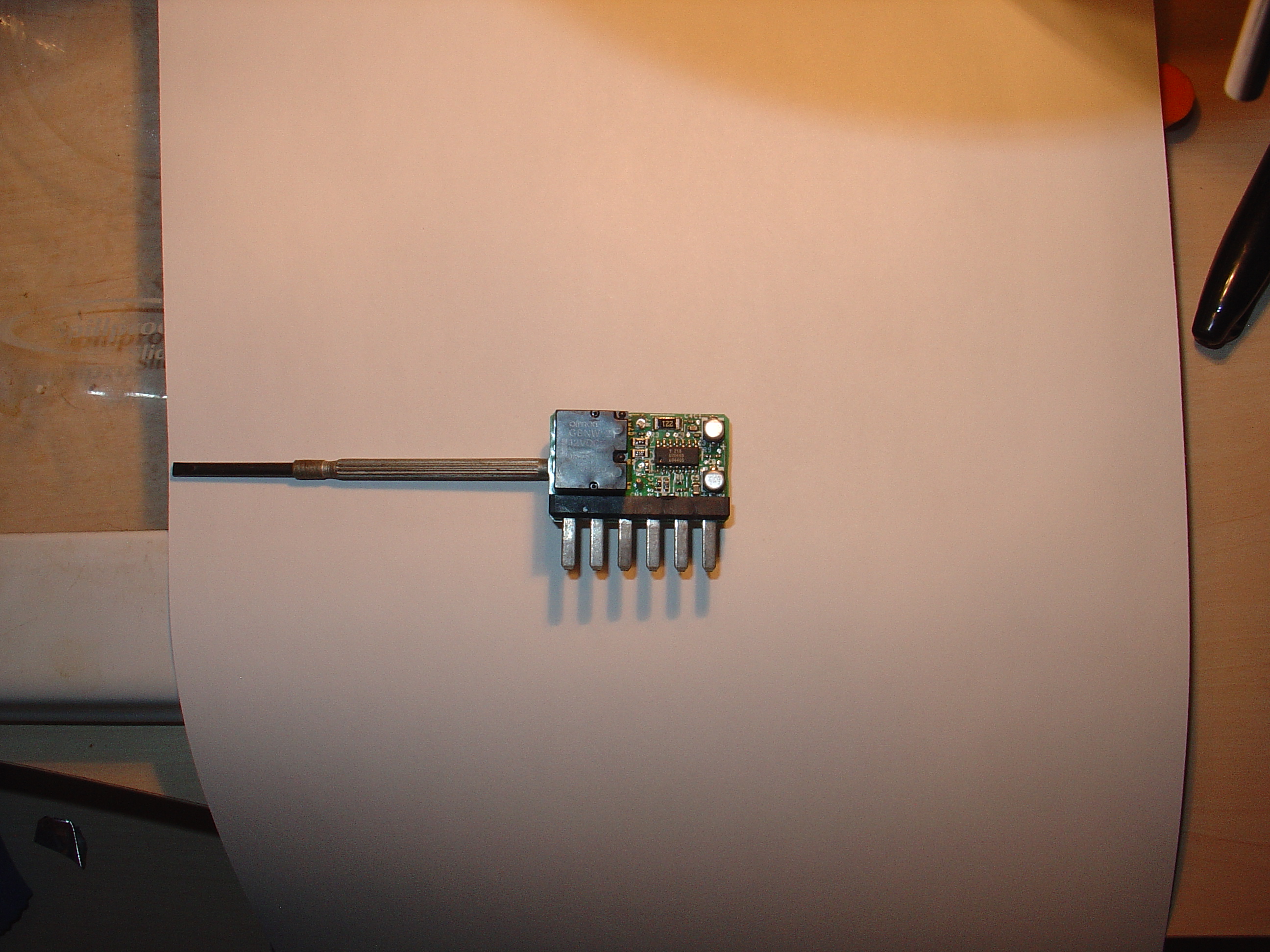

burnt resistor in flasher relay
    Re: burnt resistor in flasher relay
    best four pics of the front

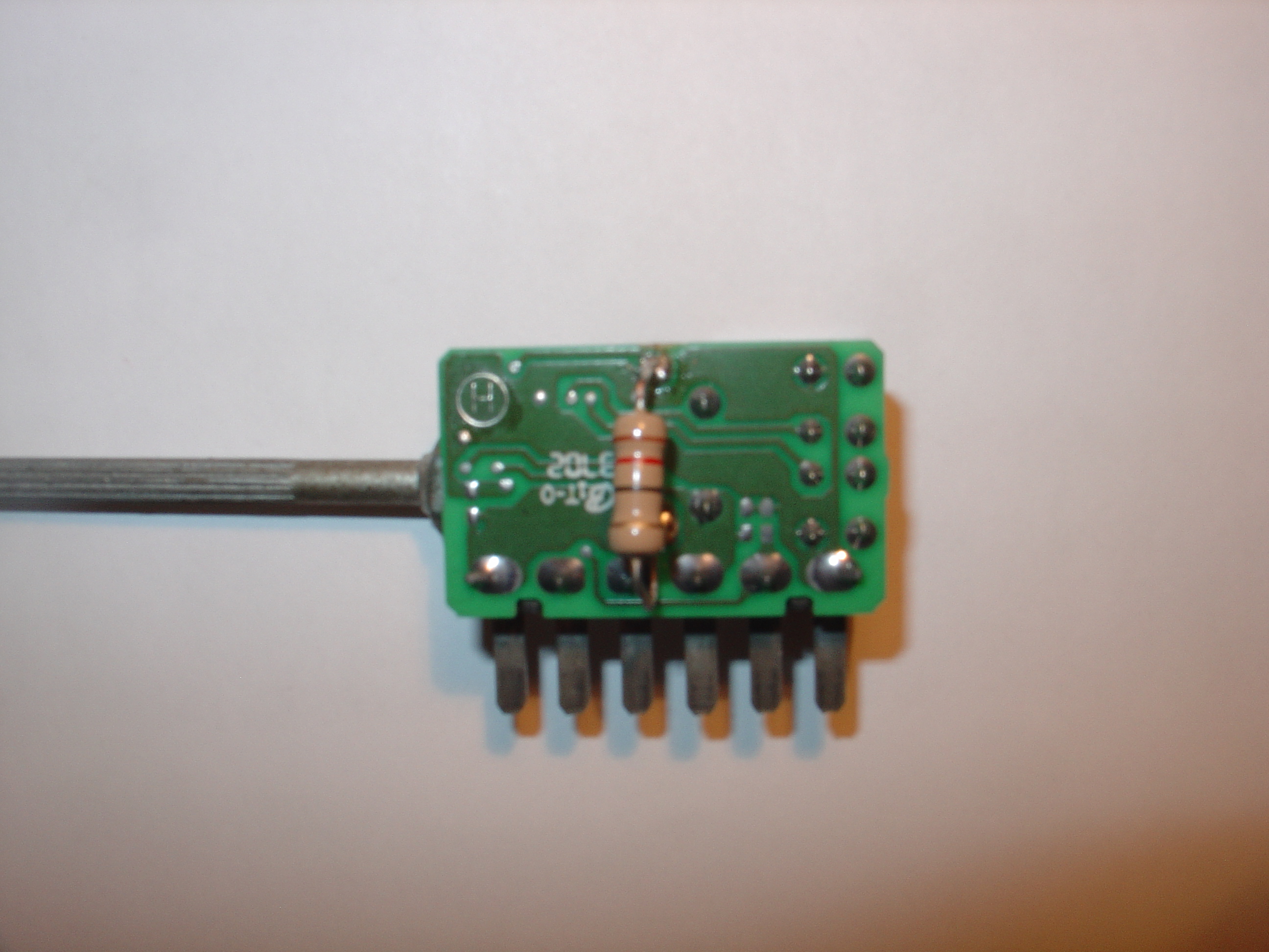

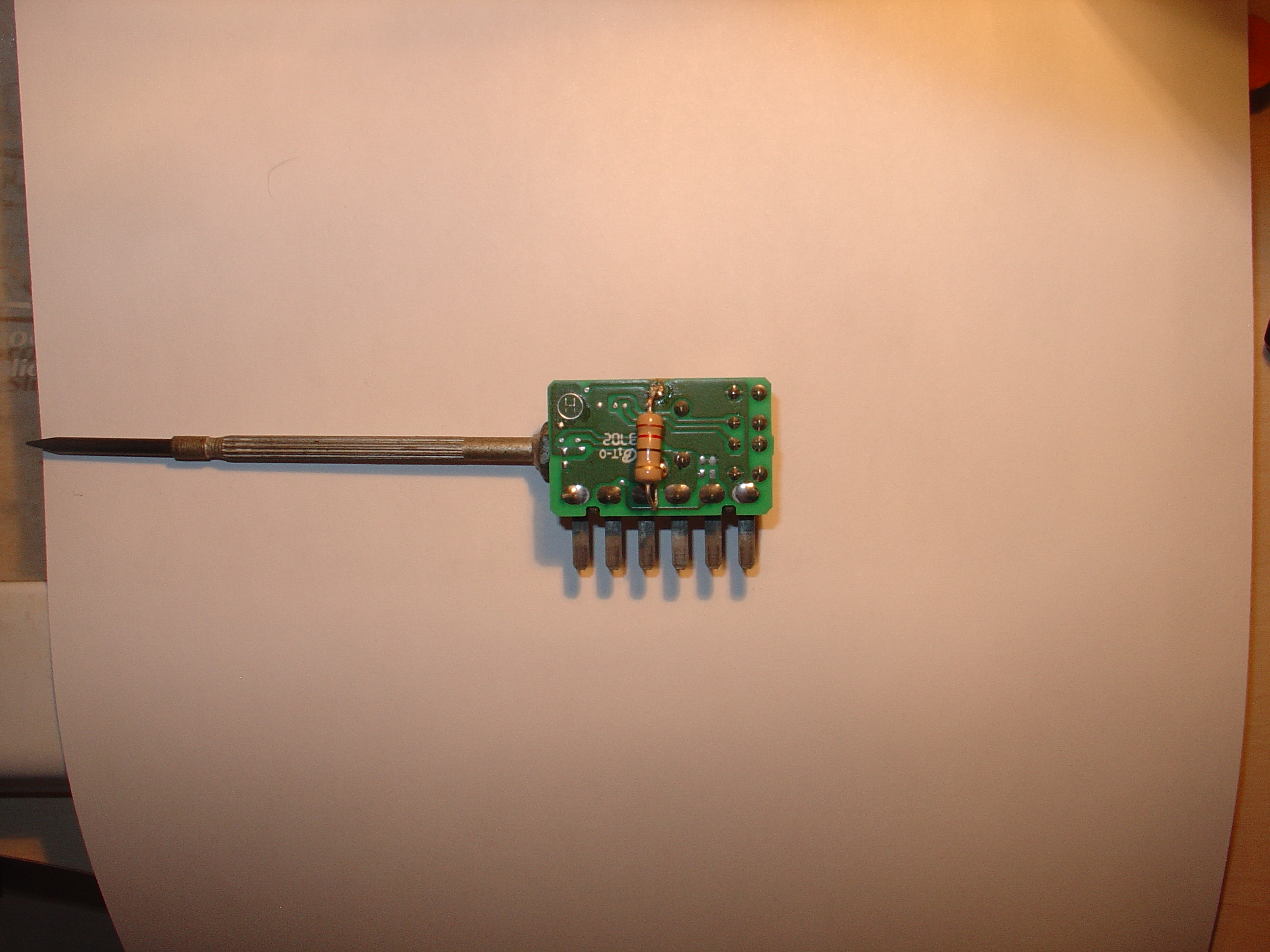

      2 rear pics
        Originally posted by GR3Y5H3ART View Post
        you are right, i got 12ACCT-ND when it should be 0.12ACCT-ND
        not sure why i disregarded that Zero
        spoke with a Digi-Key rep. and OHM might not be as important as the 1W?
        i think the Install Guide was made when 1 LED was way brighter than Regular Bulbs
        per our conversation, decided on maybe trying this Resistor:
        http://www.digikey.com/product-detai...RCT-ND/1166585

              So beside installing the 12 Ohms (instead of 0.12 Ohms) sensing resistor on the board, you also modified the wiring?
              As you can see from the spec sheet of the IC, the resistor is in series with the load (lamps), so if you modify the wiring then you should find out if some thing has shorted out.
              What happen if you put things back to original condition to get it to function before you change to the LEDs to see if it will work as before, the change the resistor to 0.12 Ohms and install your LED lights to see if it will work.
              i have not touched any of the wiring
              i got a ECU replacement and thought i should check if just the wiring from the MCU to the ECU is all that would need to be changed and if i had the wiring diagram correct before splicing anything
                "spoke with a Digi-Key rep. and OHM might not be as important as the 1W?" Does Digikey know how this resistor being used and know what kind of load and the resistance of the load being connected in series with resistor?
                @12V and 12 Ohms, max current draw if load is 0 Ohm will be 1A with power dissipation of 12W, but since we are not feeding into 0 Ohm load.
                Lamp Outage Detection (Pin 8)
                The lamp current is monitored via an external shunt resistor, RShunt and an internal comparator, K1, with its reference voltage of
                typically 81mV (VS = 12V). The outage of one lamp out of two lamps is detected according to the following calculation:
                Nominal current of 1 lamp: 21W/(VS = 12V): Ilamp = 1.75A
                Nominal current of 2 lamps: 2 x 21W/(VS = 12V): Ilamp = 3.5A
                We recommend setting the detection threshold in the middle of the current range: Ioutage ≈ 2.7A
                Thus the shunt resistor is calculated as:
                RShunt = VT (K1)/Ioutage
                RShunt = 81mV/2.7 A = 30 mΩ
                Comparator K1's reference voltage is matched to the characteristics of filament lamps (see section “Control Signal Threshold”).
                The combination of the shunt resistor and the resistance of the wire harness prevents pin 8 from a too high voltage in the case
                of shorted lamps.
