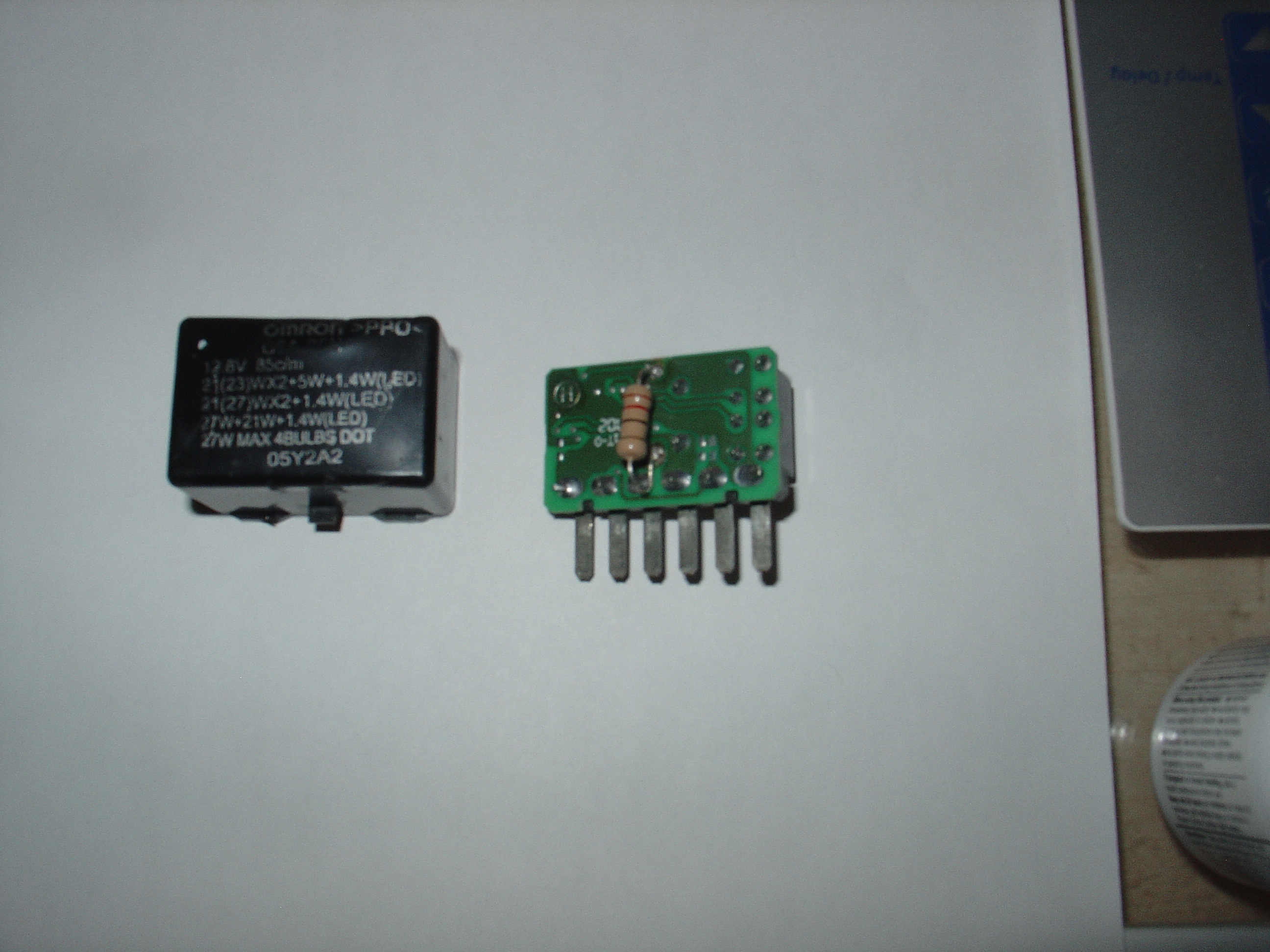

          Re: burnt resistor in flasher relay

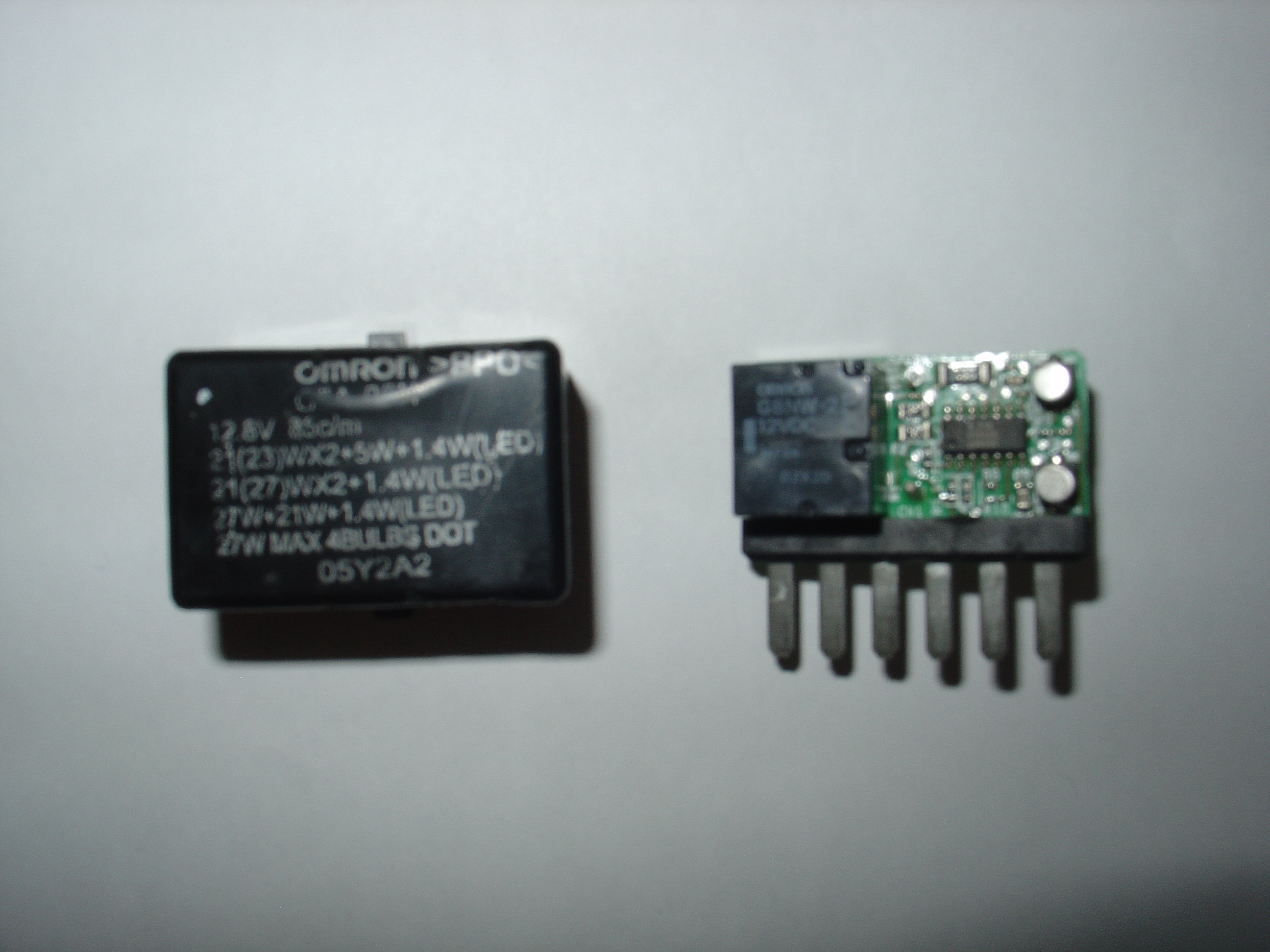

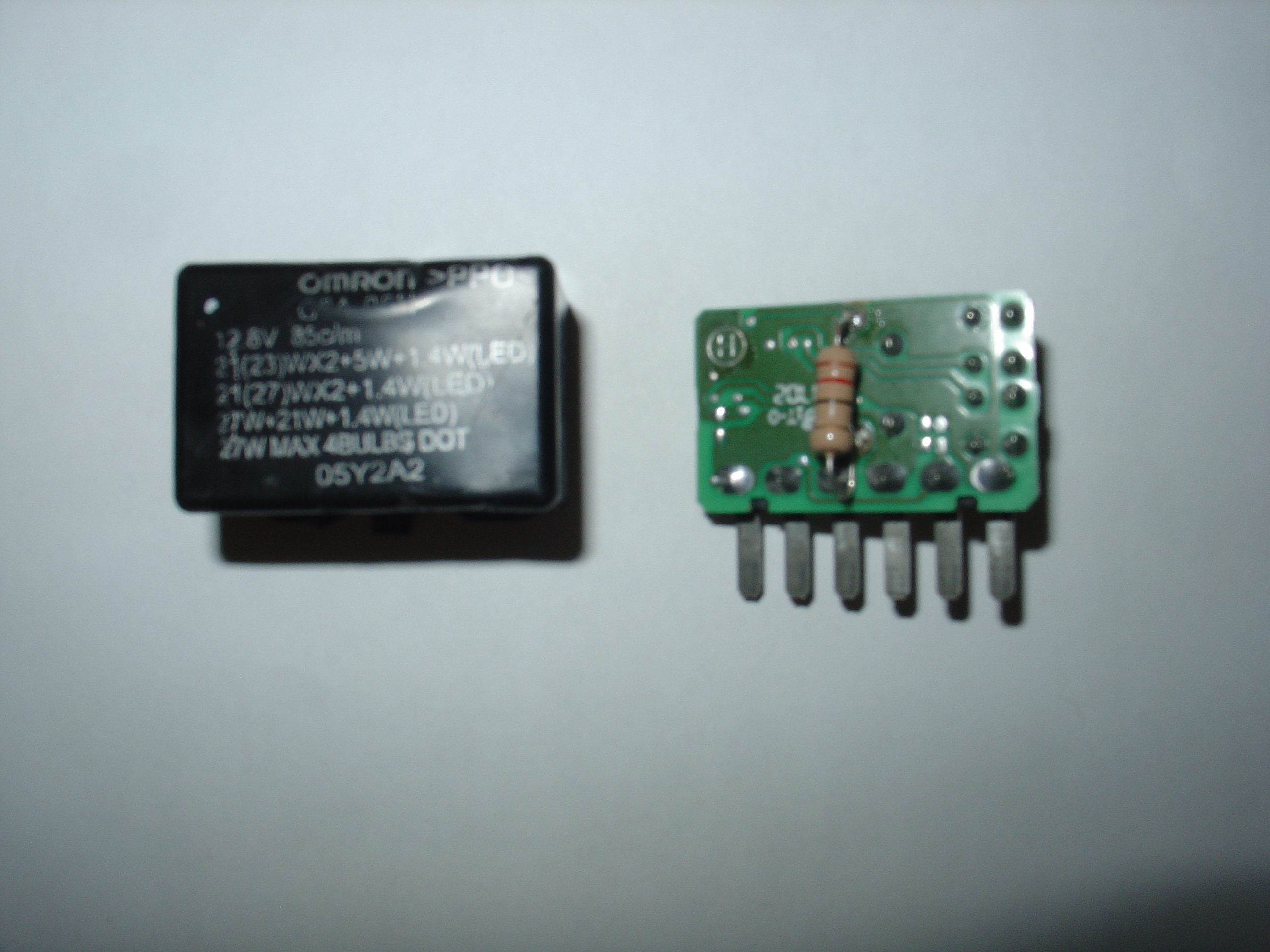

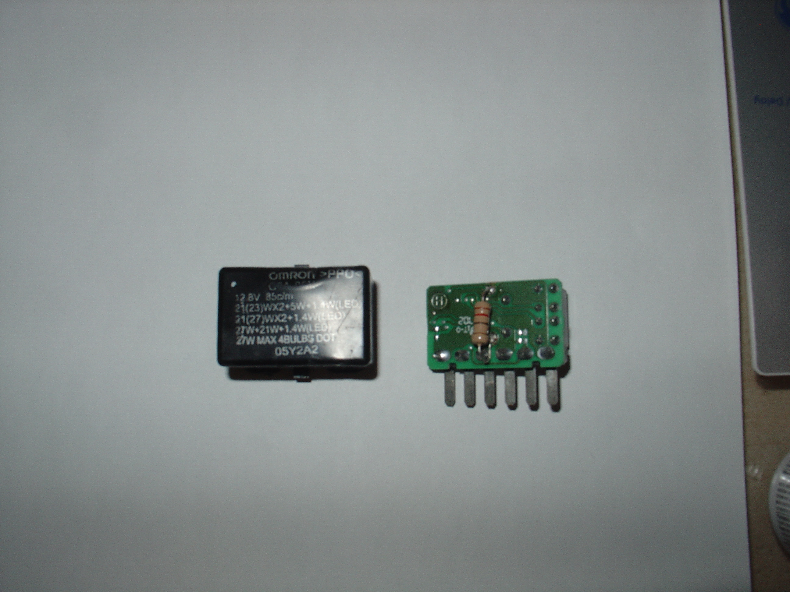

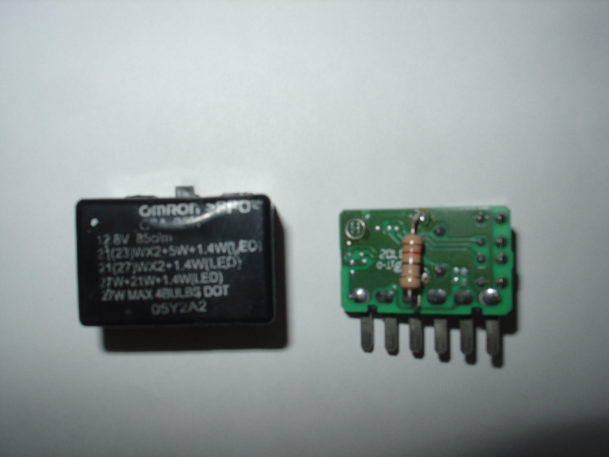

          hopefully these pictures will be good enough. it was my 1st time soldering something like this but already unsoldered the old one

                  Yeah it looks like a 1 Watt resistor, but I'm not surprised it doesn't work.
                  What you've used is a 12 Ohm resistor, and the tutorial you linked to specified an 0.12 Ohm resistor. You're using a resistor which is 100x higher resistance than specified.
                  Have a look at this: http://www.digikey.co.nz/en/resource...or-code-4-band
                  -David VanHorn

                    Looking at the board lay out, that current sensing resistor is in series with the load, so if it burnt up that means the wattage raring of the resistor is too low, or the load is shorted or too low of the resistance.
                    • Agent24
                      I see dead caps
                      • Oct 2007
                      • 4979
                      • New Zealand
                      Perhaps a different resistor on the board burnt? He didn't show the other side clear enough, but the one in his photos looks rather unscathed.
                        The resistor is the wrong value (12 ohm) and one leg looks like it is bent and shorting to the connector pin. Also, the module has power all the time, so best to disconnect your battery or the fuse when messing with it.
                        The flasher IC is an Atmel U2044B (datasheet)
                        Lamp outage (double-fast blink) gets activated below:
                        0.03 ohm = 2.7A / 32.4W
                        0.12 ohm = 0.68A / 8.1W
                        0.22 ohm = 0.37A / 4.4W
                        0.47 ohm = 0.17A / 2.1W
                        12 ohm = smoke
                        Power rating of 1/4W to 1/2W for the sense-resistor is fine.

                          The original resistor in the Video is also installed on the component side of the board, you guy have good eyes, the pictures are way out of focus for me.

                            I'm guessing the IC part number came from the photos in the original link.

                              lifting pin5 on the chip may do what your after.
                              *after you repair it.
                                the Resistor arrived from DigiKey
                                Part #: 12ACCT-ND
                                RES 12 OHM 1W 5% Axial
                                i dont think the Resistor is causing the problem since it might be the wiring so based on the wiring diagram, is there a way to fix it before having to shell out for a new ECU? (already located one at a good price)

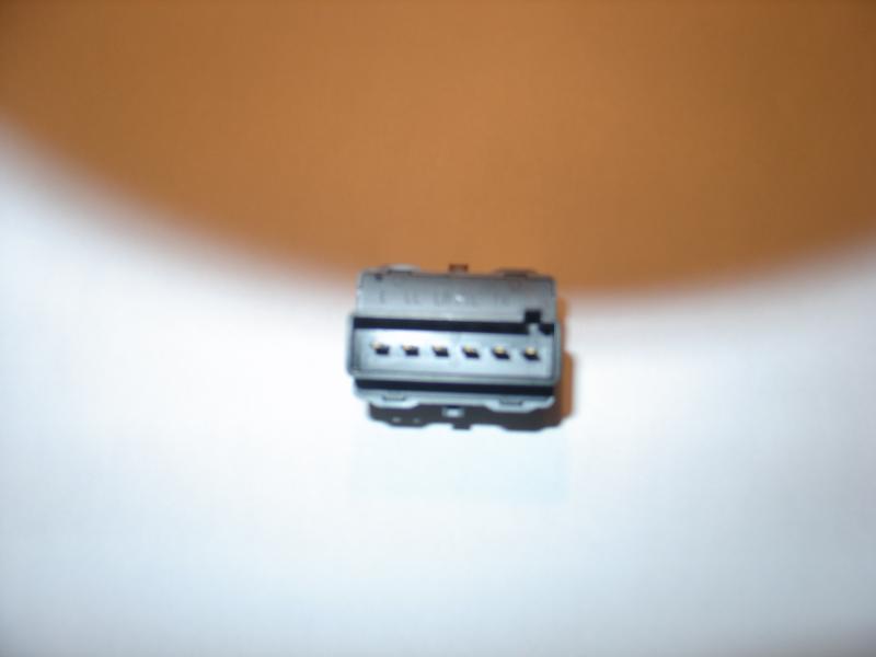

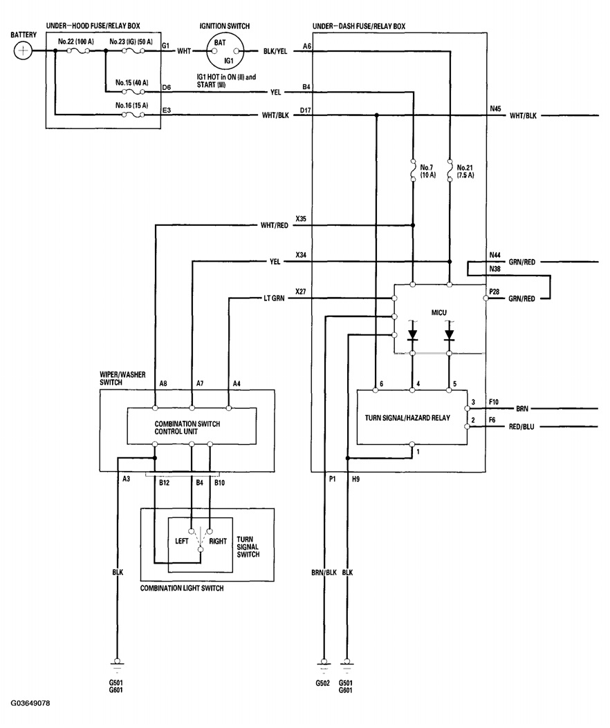

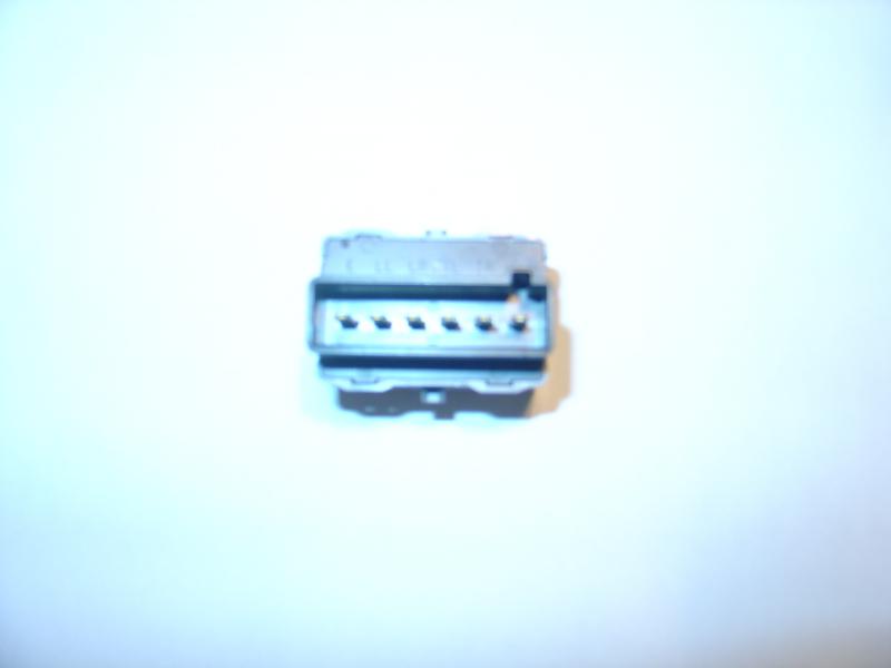

                                here's the best pics i could take of the OEM Relay
                                6 Pins
                                1 - E
                                2 - LL
                                3 - LR
                                4 - TL
                                5 - TR
                                6 - B
                                and 3rd pic, based on Haynes this should be the pic for the pins
                                    based on this pic, and going Left to Right
                                    E, LL, LR, TL, TR, B
                                    then
                                    2 RED/BLU & 3 (BRN) should be the wires i should check and hopefully redoing them will fix the signal going to the MCU or Main Control Unit?
                                    • GR3Y5H3ART
                                      • Jan 2011
                                      • 146
                                      Originally posted by Agent24
                                      I'm confused now. Why are you buying 12 Ohm resistors when the guide says to use 12 Milliohm resistors?
                                      The guide says to use this one: http://www.digikey.co.nz/product-det...CCT-ND/2059055
                                      you are right, i got 12ACCT-ND when it should be 0.12ACCT-ND
                                      not sure why i disregarded that Zero

                                        can you take some decent well-lit foto's of the board - specially around the chip.
                                        there is some shadowing on the original foto's that could be a flash-mark.
                                        and then lifting pin5 on the chip instead of fitting a resistor would be worth a try.
