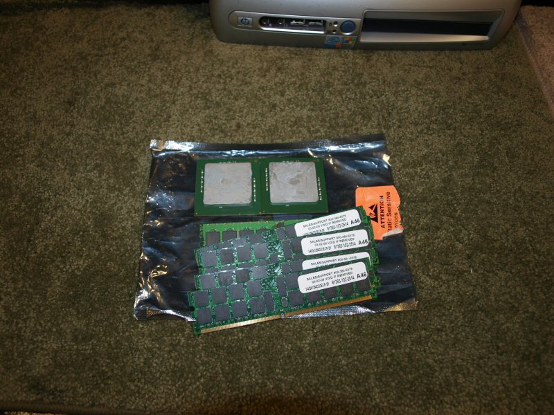

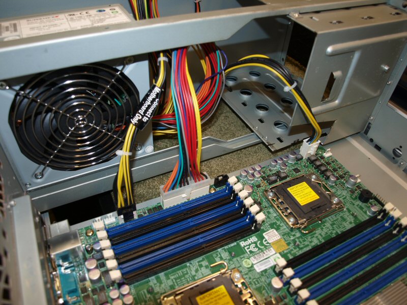

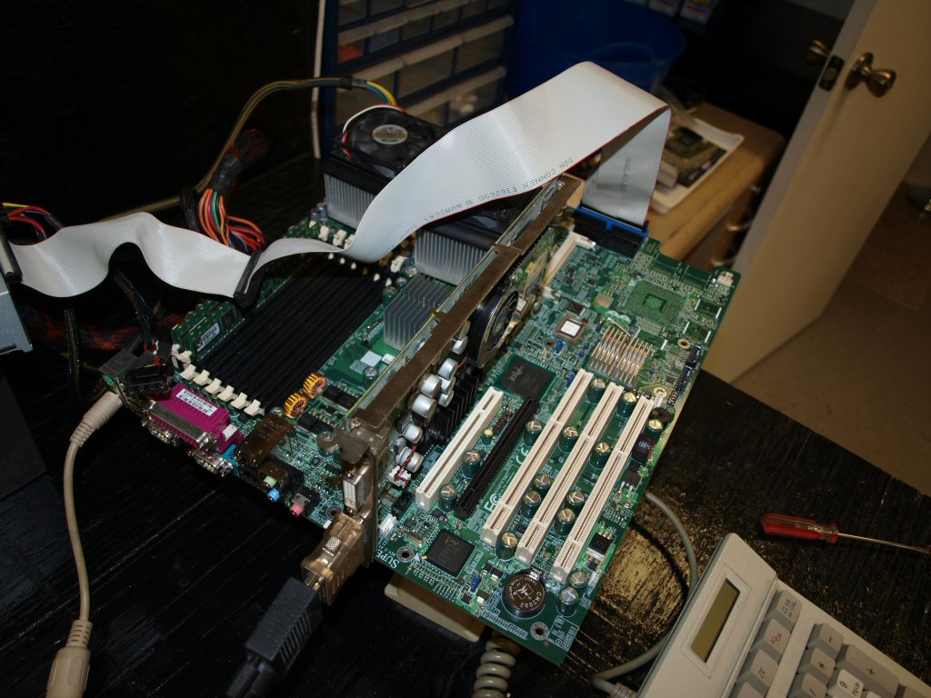

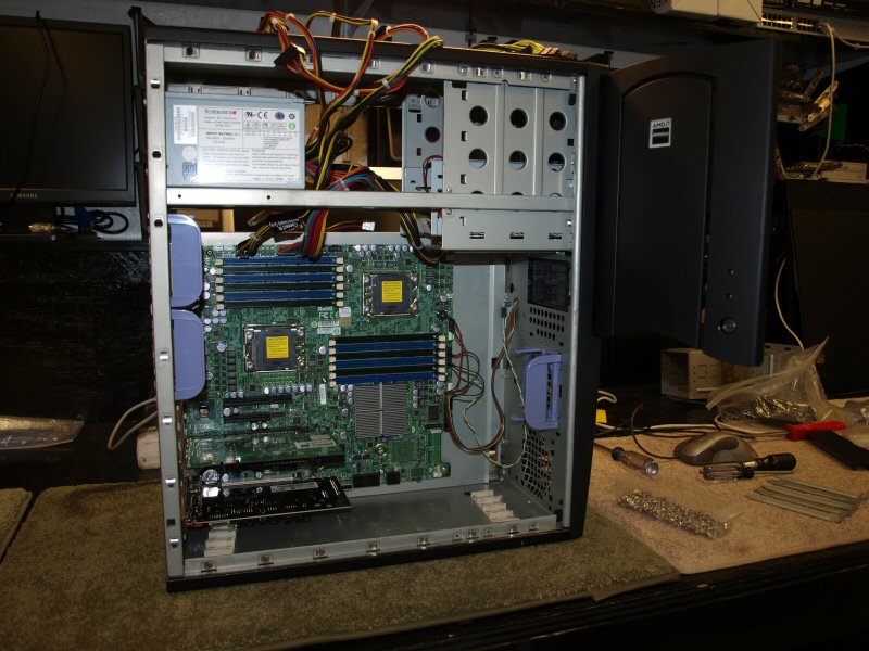

        Ok, may have to add a third tower to this.....but for now, I'll just give the cliffs notes, as I'm still in the parts collecting stage and preparation.
        The reason for the possible 3rd case....pair of paxville's and 12gb RAM...

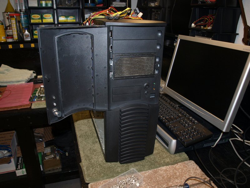

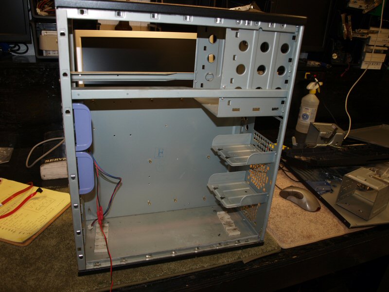

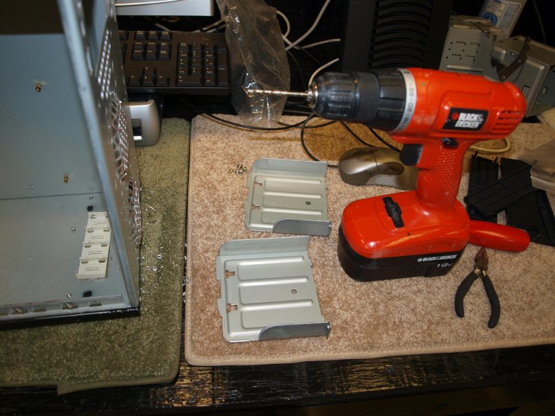

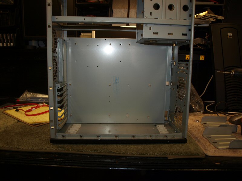

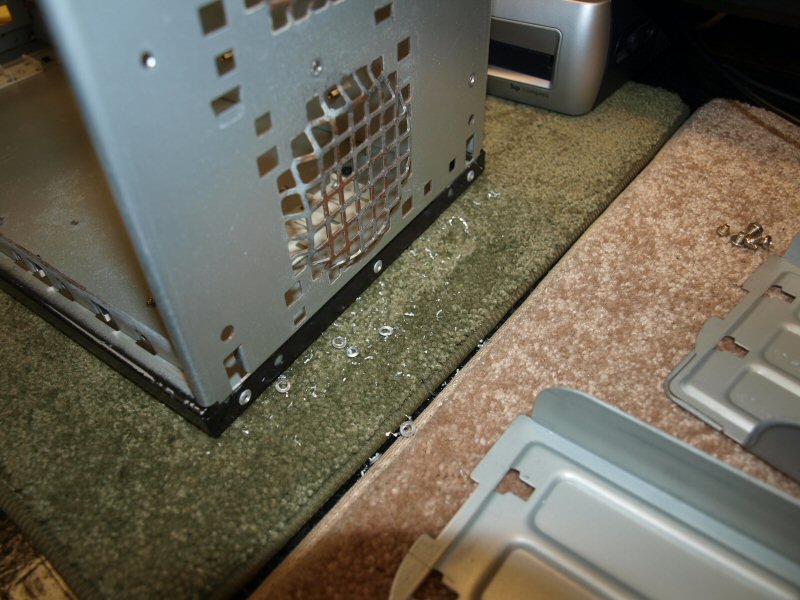

        I'll just give the cliff's notes on the case modding...this is mod 1, as this case was bought from a member here about 10 years ago, its a 90's chenming case back when everyone thought that if you didn't have 8 HDD's in your system that your system sucked....well that isn't needed today.... The cages didn't interfere with the motherboard, but they did get in the way...
        The trays in question that the cages latch into...
        Pop rivets drilled out:
        Trays removed... If I ever needed to replace the trays, I could simply pop rivet them back in. Nothing was permanently altered with this mod.
        ...and trays gone, and case washed.
        For a HDD, I'm probably doing a single SSD, as this system will be a workstation. All critical data will be stored on a server elsewhere on the network, so it will be mounted in a 5.25" bay holder with a fan.

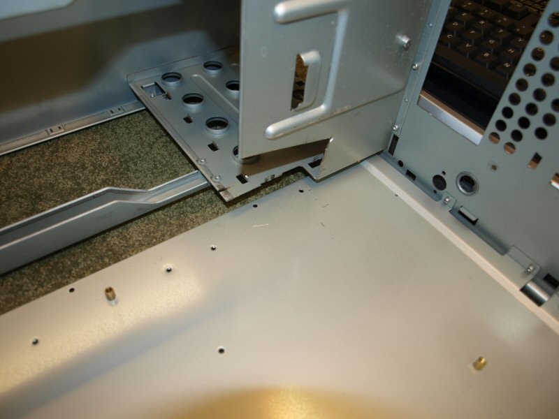

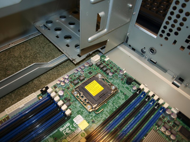

        Ok, now for mod 2. I've had e-ATX boards in this case before, but this one didn't want to line up right, as the 8-pin ATX connecter was hitting the case, making the standoff's unalign to the board by about 1/16"
        This was a bit much for a dremel, this case is very thick gauge steel, it'd have eaten wheels like crazy, so I used my pneumatic angle grinder with a man size cutoff wheel in it.
        Section cut out.
        Test Fit:
        Connecting the PSU (A special thanks to Ratdude for this PSU)
        Motherboard fitment perfection!
        More to come later....

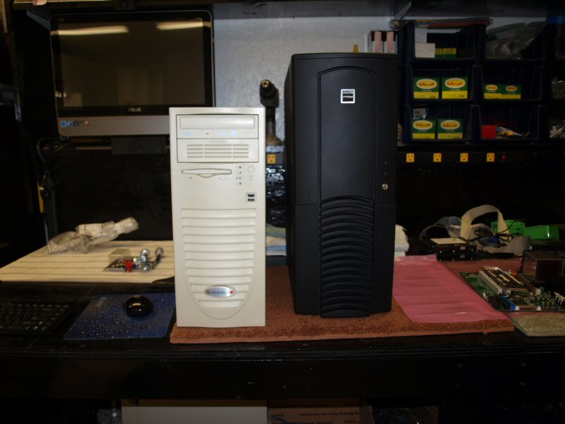

          You're welcome... I had NO use for the PSU so I'm glad you have a use for it.
          I've cut that thick steel with a dremel, that much properly done would take one thick wheel at most. But an angle grinder works too.
          I have a near clone of one of those cases, but she's beat to hell and IMHO since mine has a fan vent behind the HDD caddy this mod wouldn't have worked nearly as well.

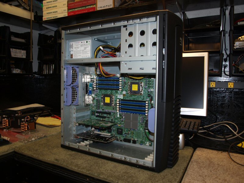

              Today's setback...scored a pair of X5660 6-core Xeons....one was bad... Second bad Xeon I've ever seen in 20+ years in the field. Bummer. Ohh well, only about a week or so setback, I'm sure they'll warranty it.

                the bad CPU was replaced for the X8 and I scored 32gb of FB memory for the X7 for 75 bucks shipped!! I put the 32gb in my office machine (same motherboard), and took its 16gb for use in this one. Still need to grab some DDR3....

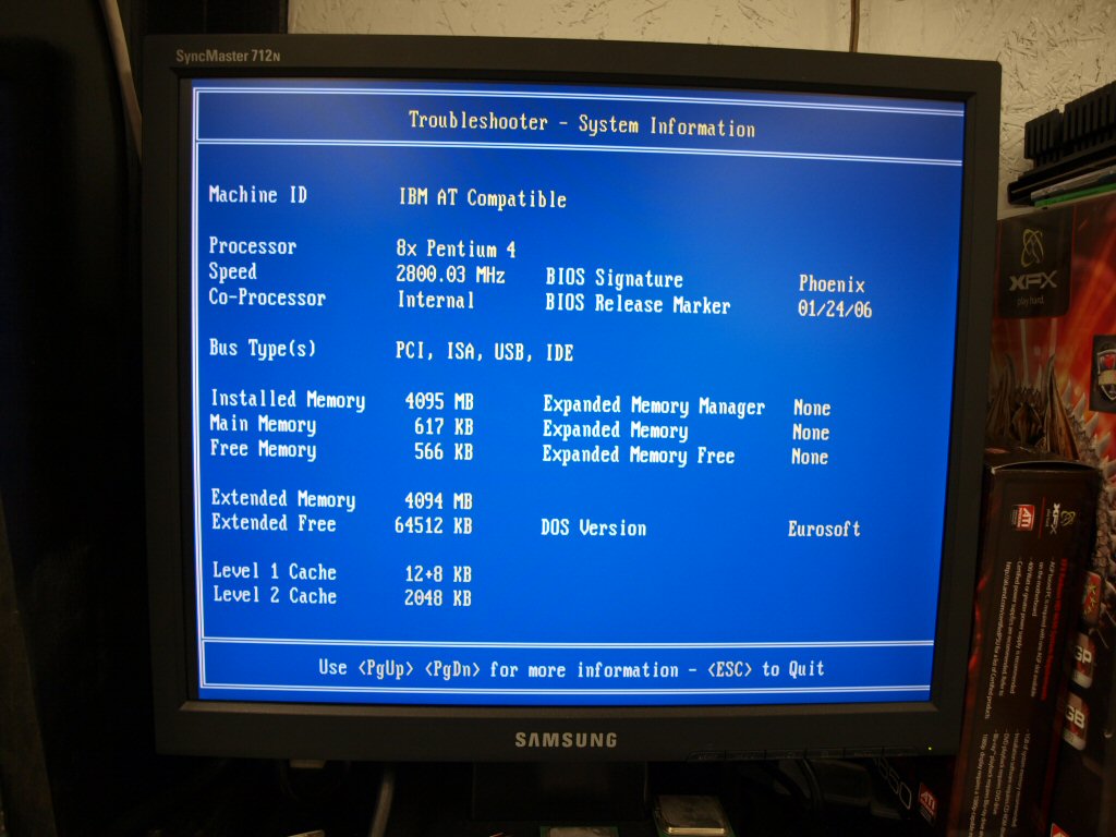

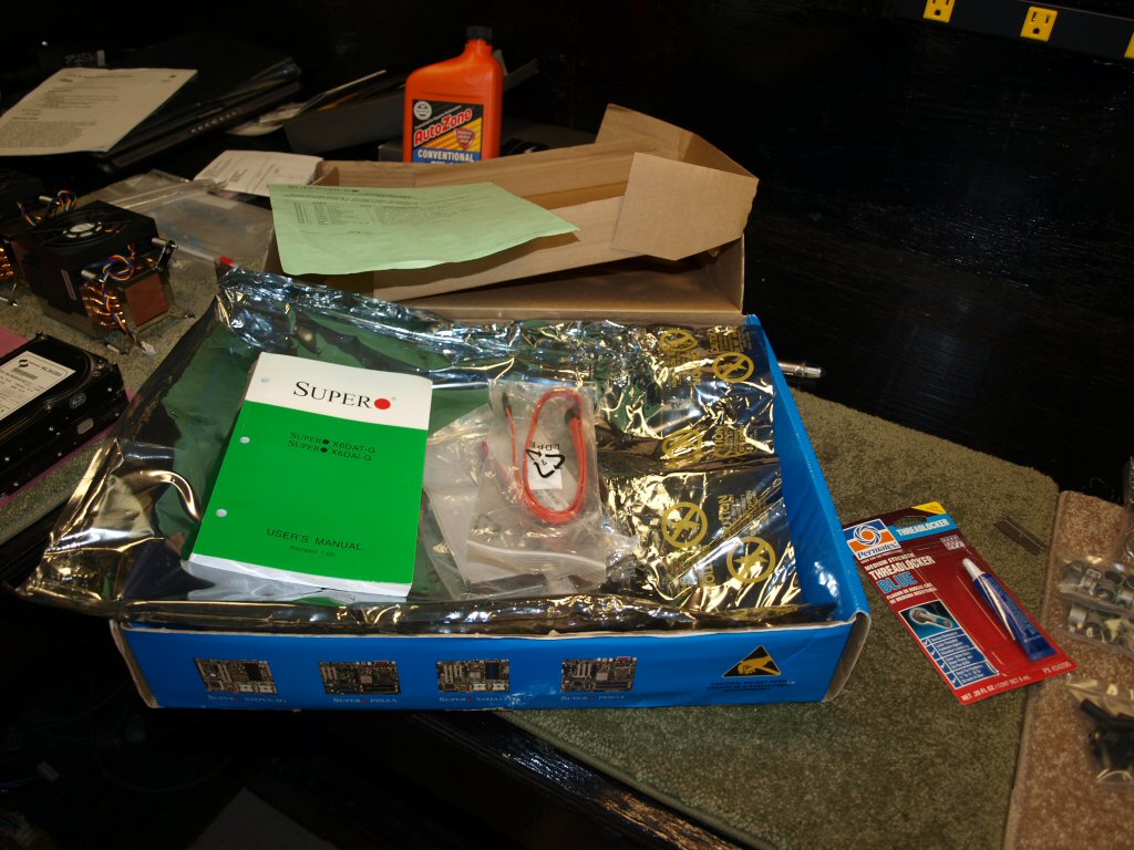

                        A strange box showed up from Germany today, containing a Supermicro X6DAI-G2 in new condition. After the currency conversion, the board cost me about $65 shipped....which was a MEGA steal!! They're near impossible to find, and to score one that cheap in new condition, yea!! Thanks Larry!! I tested it, it does work. I also scored 16gb of 2-rank 4gb sticks for it for $44 shipped (I LOVE how cheap FB/ECC/REG memory is these days). The 4gb DIMM size is 'unofficially' supported for this chipset, but I've seen lots of guys do it in their precision 470/670's (same intel 7525 chipset) with no issue. This chipset can only run 8 ranks of memory no matter what, how you populate it is up to you....but anything more than 8 ranks will not be seen.
                        I ordered some Dynatron copper heatsink/fans for these, as the Dell ones are typical proprietary sillyness. I gave RD my aluminum ones, as I don't think they'd be adequate with dual core processors.
                        Anyway, this project continues...
                        Shows 8 CPU's, thats 4 cores + HT.
                        More later.
