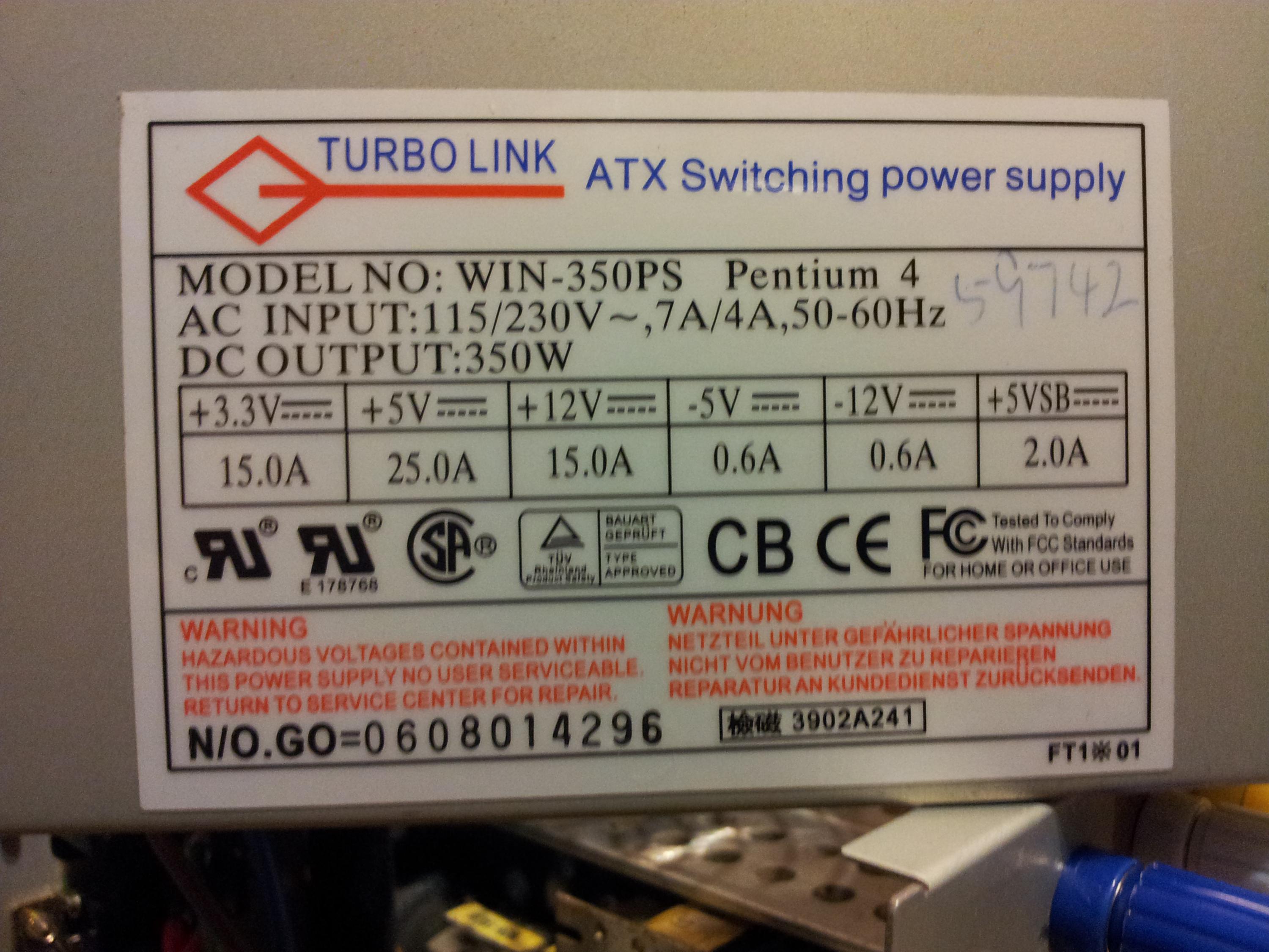

    I have converted a Turbo Link ATX Switching Power Supply with 20 pin connector, Model No: WIN-350PS with AC INPUT 115/230V & DC OUTPUT: 350W to a lab power supply. I joined wires black gnd red +5v white -5v yellow +12v blue -12v orange +3v. Installed green wire to switch to gnd. Placed 10w 10o on red & black wires to use up power as per online instructions. I also wired in LED grey to black with resister.
    When I start it up we get 1-2 fan and LED lit then everything goes into safe mode until I switch it off for a few minutes. The only time I can get it to run continuous is buy hooking up an old floppy drive first.
    Absolutely stumped on how to fix this properly. Have tried different wiring arrangements and nothing seems to work.
    Any ideas or help would be much appreciated.
    Jeff

        Can you post a picture of the inside of the power supply?
        Reason I ask is because I also have two TurboLink/Cyberlink power supplies (both are low-end CWT-made units) and they have no problem powering on without ANY load attached.
        If your Turbolink came from a heavily-used computer, the caps in it might have started to go (or are) bad.

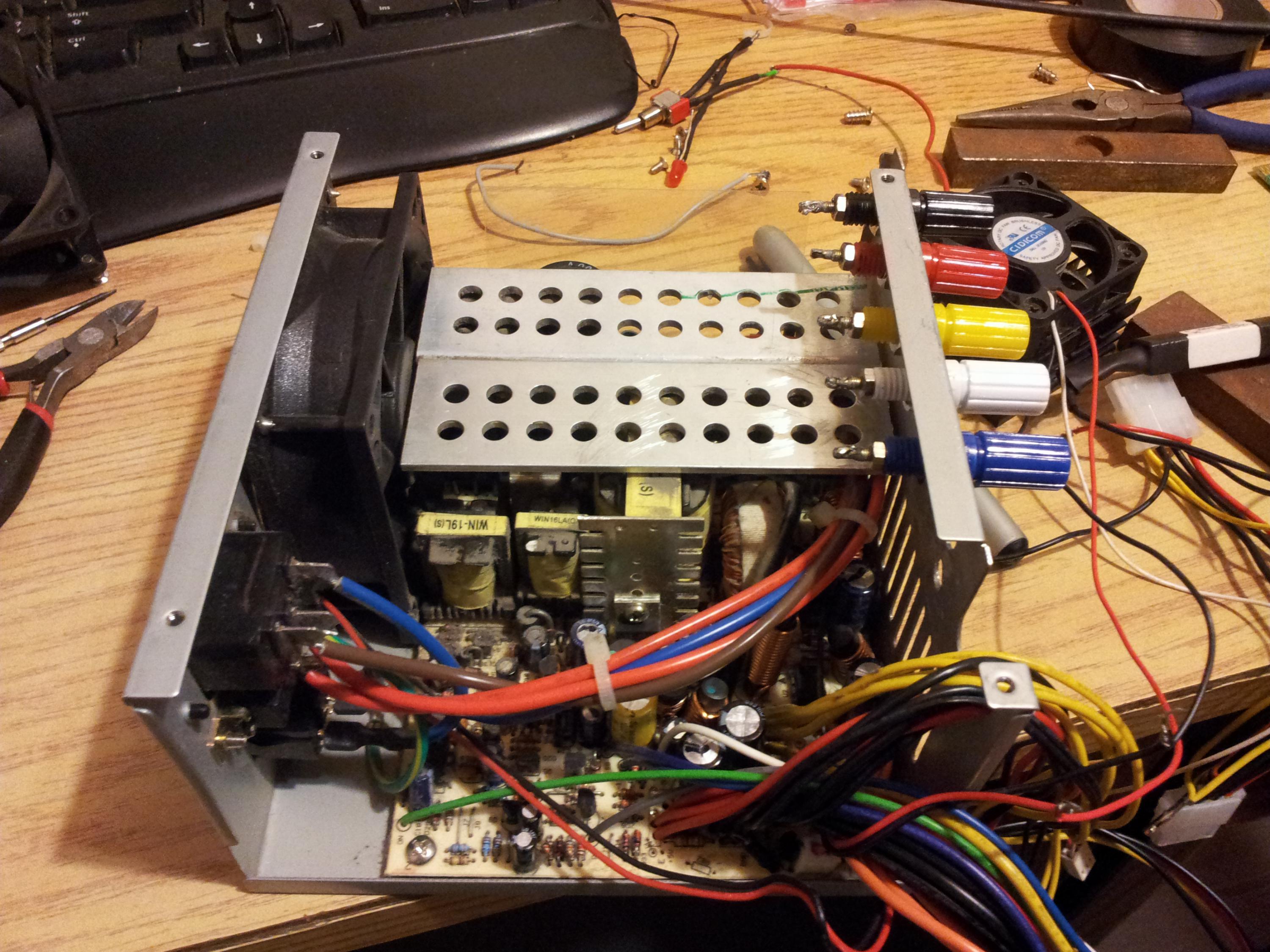

                  Have a look at your second picture. There's one cap under a white wire (lower center of the photo). I'm not sure if that's just from the picture or not, but to me that cap appears a bit bulged. Look at it carefully and let me know what you find.
                  If it's not, then you just need a proper load as mariushm mentioned. I would discourage using load resistors only because large ones rated for over 5W can get expensive and may be hard to find locally. In my experience 12V halogen incandescent lamps (like the ones sold in Ikea for track lights) have worked fine. Or you can also go to an auto parts store and get some headlight / taillight / dome lights.
                  If you go with the 12V halogen lamps, 20W to 30W should be fine (easy to find too). Put one on each of the main rails - that is, have one lamp on 12V rail, one on 5V rail, and one on 3.3V rail.
                  Or if you get headlight / taillight / dome lights, something around 5 to 10W should be okay. Again, put one on each of the main rails.
                  As mariushm mentioned, you would probably have to have those mounted outside of the case because they do generate some heat.
                  And oh yes, I forgot to mention, but your Turbolink appears different from mine. I think yours is made by Wintech.

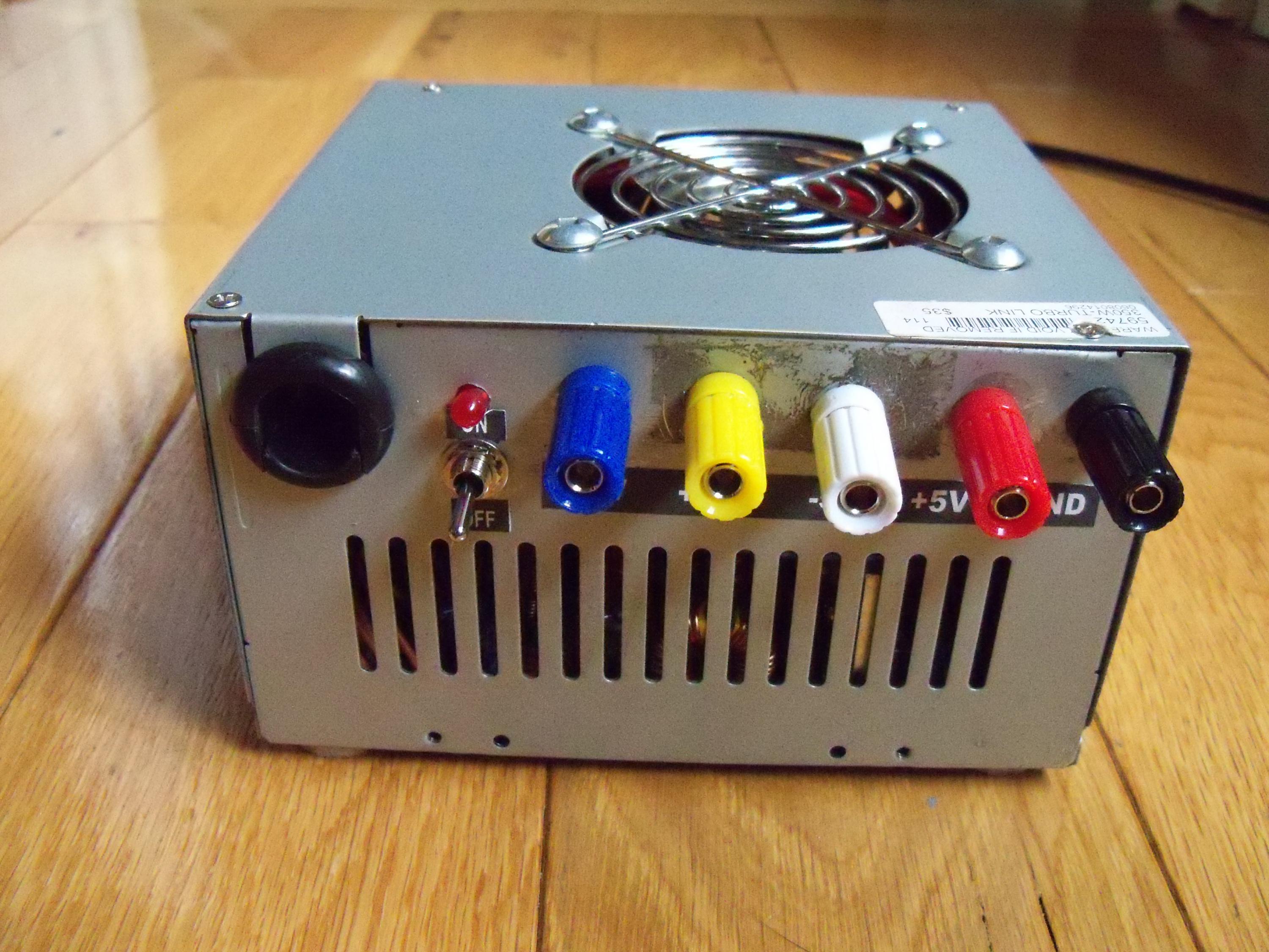

                        If I use my 10w 10ohm resister on the +5v rail and a 200ohm resister on the +12v rail, do u think this will give continuous power to allow circuit testing on the 3 way posts for +5v -5v +12v & -12v ? And if this will work will these resisters have too much heat inside the case even with the PS fan functioning. Should I just go with 200ohm 3w on both +5v & +12v rails? +3v rail with be unused should not need a load (I hope).
                        The PS lid has grill covered opening for 2nd fan (but no room for 2nd fan & mods).
                        Jeff

                          Yes a bulge in a cap would spell the end of that cap. The cap your looking at in the pic with the white wire above it is fine. If you zoom in to the photo the cap looks perfectly fine.
                          But I do appreciate the heads up. If the cap were blown I would scrap the PS and just use another one from my stock pile of old PC's.

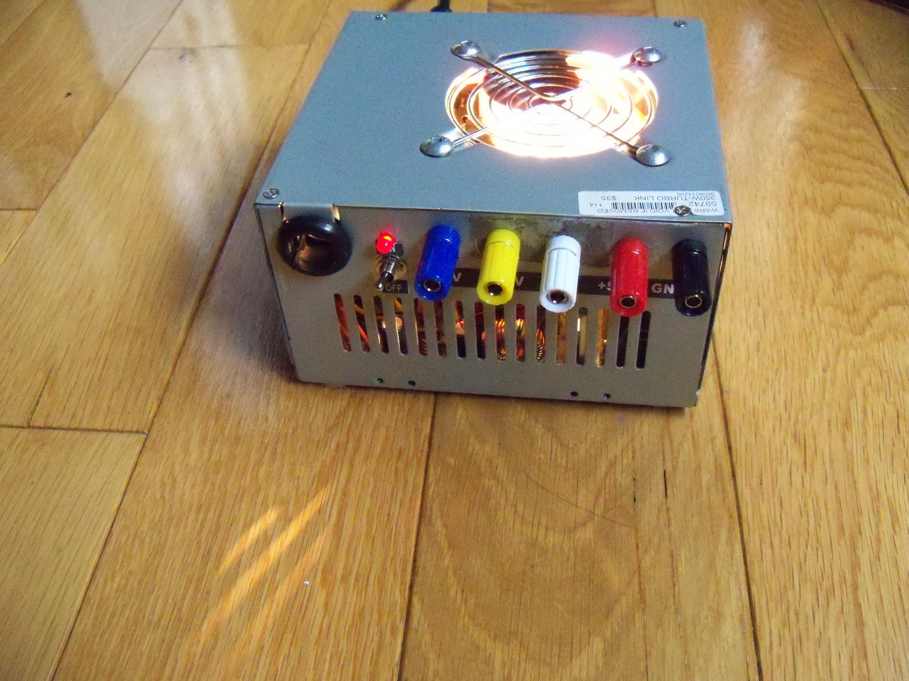

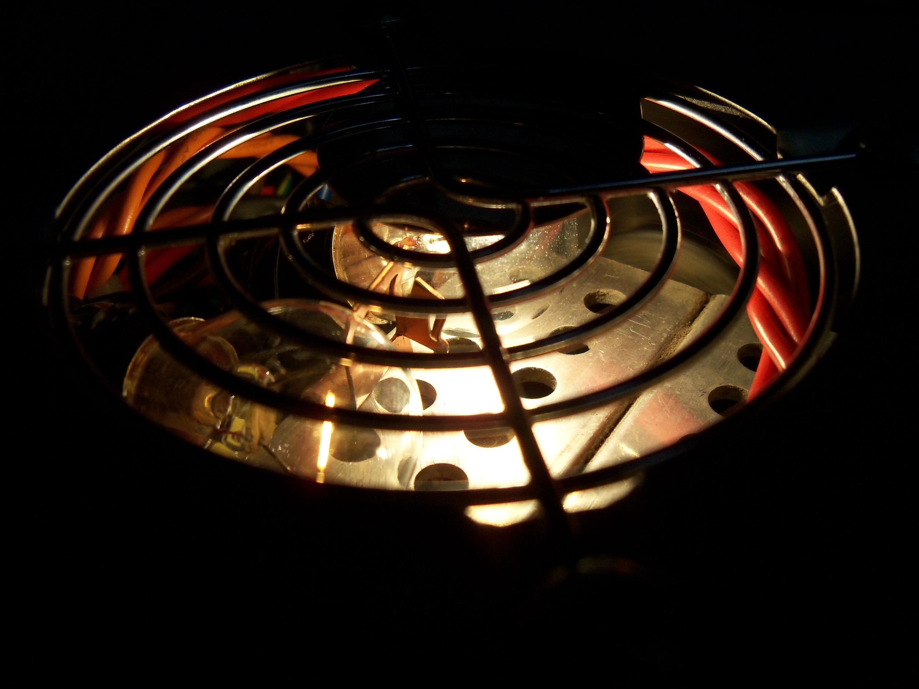

                            Update..... I was finally able to get the power supply working without the floppy drive hookup. I tested several 12V car bulbs until I had 2 that would keep the power on. First single element bulb was soldered to the 12V rail & 2nd single element car bulb was soldered to the 5V rail. I did not intend to use the 3V rail & did not need to attach any resister to it.
                            Thanks for all your ideas to a Newby...... mission accomplished!
                            Here is the finished result.

                              Looks good, but have you tried measuring the output voltages?
                              The fact that the PSU is picky about the bulbs tells me something is not right with its feedback circuit or the caps (even though they look good).
                              Also, just because you're not going to use 3.3V rail doesn't mean you shouldn't put some load on it. The PSU looks at the voltage on all rails, and if one is way too high, it will lower the power output, thus causing the voltage to be lowered on other rails too.
                              Also, 3.3V is actually useful to have. It's close to the voltage of 2 AA batteries in series. So if your son decides to test a device that otherwise uses 2 AA batteries in series, he can use the PSU.

                                  This site has amazed me with the help I have received for my son's PC PSU to Lab PSU. As I do not possess the knowledge of electronics nor the formulas to understand what actually works, I instead went with the "lets see what does work" theme.
                                  Momaka, I did measure the output leads. 5V rail were very close on both + & - The -12V rail was sitting around -11.45 -11.6 The +12V rail was a little high +13.5 13.87 The reason I did not hook up the +3V rail was due to my son not needing it in his testing. I can still drill a hole and hook it up if his requirements change.
                                  I did however use insulated wire to wire the bulbs to the main cap heat sink to allow faster heat dissipation of 12V rail, bulb. I also used a metal shield to partially obscure the bulb from blinding anyone when in operation. (bulbs shines thru top grilled opening).

                                    Little high is an understatement - it's well outside of ATX spec (which only allows 11.4 to 12.6V). Good thing that PSU is no longer in a computer. Even without load, the 12V rail voltage shouldn't got that high.

                                      yeah. it should not be those high.. negative rails has a 10% tolerance, positive rails has a 5% tolerance of the voltages.
                                      it should better if you can attach the bulb on the outside of PSU, because the bulb produces heat, not same as led produces a very small heat.
                                        But it looks cooler on the inside! Maybe he should have used blue light bulbs though.
