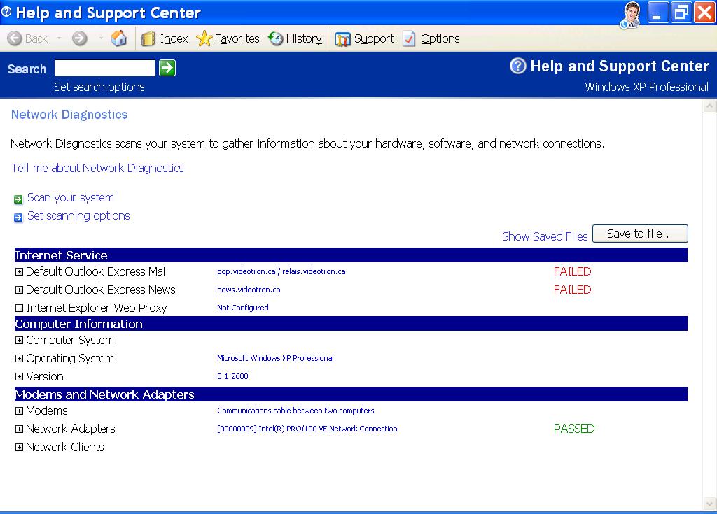

                                    I think
                                    Mojo515
                                    Are you using wireless or cable connection?
                                    Did you run IPconfig?
                                    Also try "Start" "run" type in MSCONFIG
                                    Click on Services check DCOM and DHCP are running
                                    If they are try clicking on Tools and run Network diagnostics - take a screenprint and post the results.
                                    But you just ignored it last time?
                                    • Mojo515
                                      • Mar 2013
                                      • 35
                                      Re: Windows XP computer no connection???
                                      Originally posted by selldoor
                                      I think
                                      Mojo515
                                      this help any?
                                      im using a wired connection to my desktop, n after my connection started working i didnt think about it anymore
                                      • Mojo515
                                        • Mar 2013
                                        • 35
                                        and according to my internet provider they can tell that my internet works fine, could be the modem, too bad i dont have another computer to try it on, but i plugged the internet chord into my laptop which should grant internet, if i need to get a new modem wtv ill get one but i need to know that the modem is in fact the problem, why im unsure is because i reset my modem a few times n then it worked, but now its not
