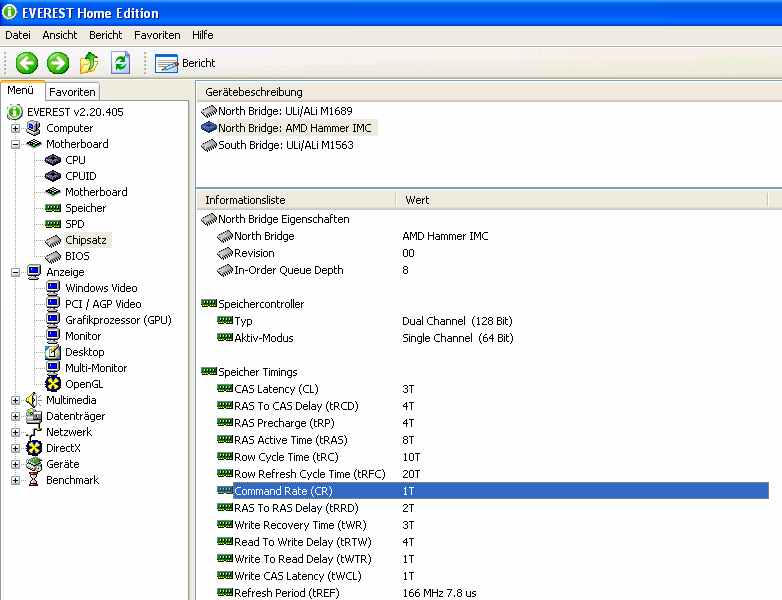

            BTW: what is your memory Comad rate? lock at the BIOS setup and change it to 2 if possibly. This option is known for giving some trouble.
              Sorry don't understand that. Took a look at the BIOS but couldn't see anything like it.

                  I doubth that yu will find anything on your board, besides it is equiped with Nichicons HM (N). Well 57 °c isn`t a tempertature i would leave my HDD for long, but this is only because of longtime impact ( the MTBF time will certaily degrade at any temp above the usuall 46°c) but as your rig is not that old it should not be the problem yet.
                  The comand rate is a speciall mmory option, availiabl in most BIOS Setups. You can chekt this with the programm Everest, lock at the picture i provided. Lock at your manual, there are variouse names for that option. Higher (2) is a little slower in some synthetic benchmarkes, but not in real world.
                  Don`t be to harsh with those technican, no company will pay his time for locking after some intermitant problems like that, wich can easily immaginated by ususall user...... There are no magic tools out to diagnose this. I know sutch problems from the other perspective.

                    Have Everest Home Edition so will take a look.
