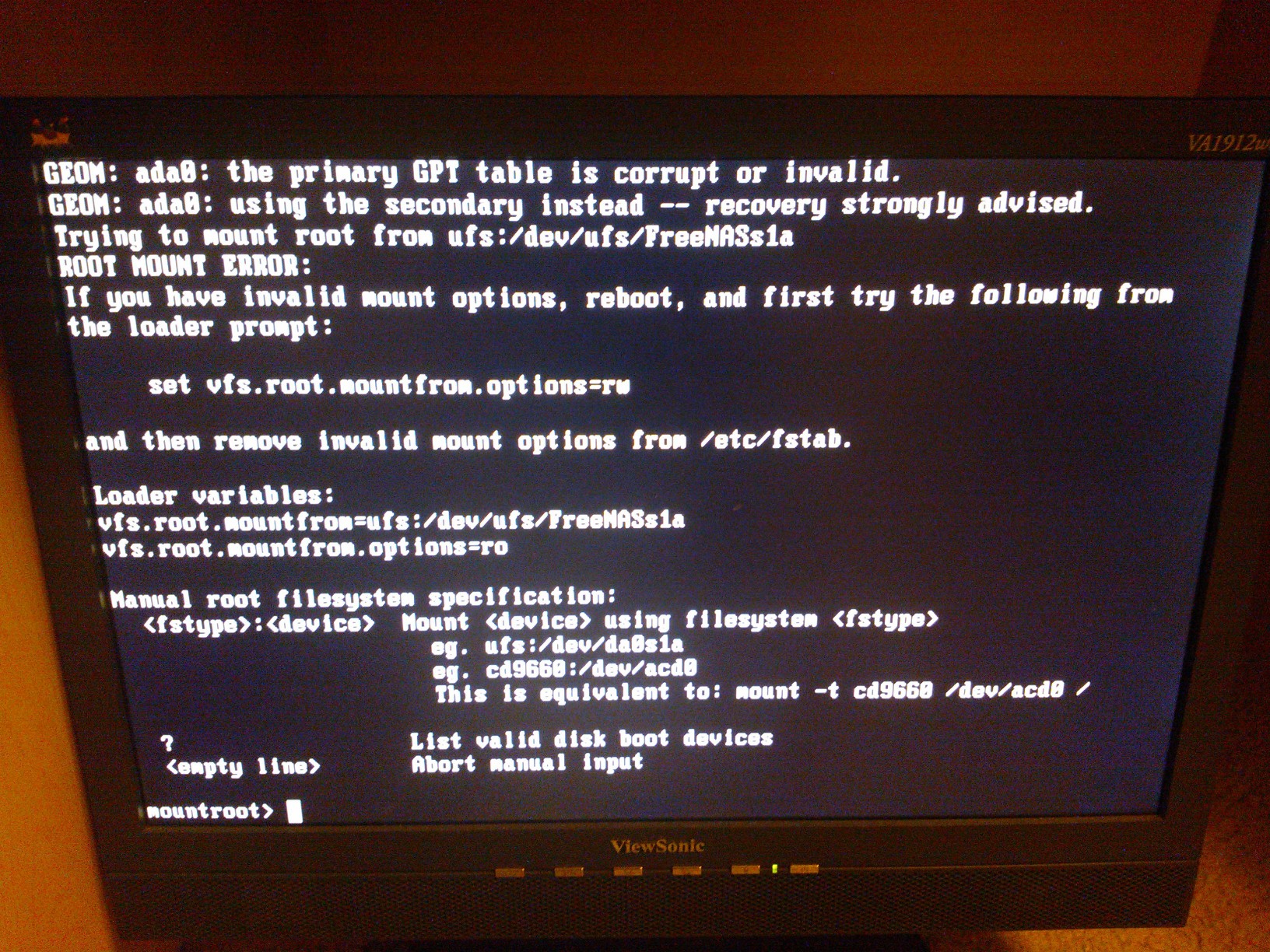

    Sorry, I'm not real knowledgable about disks.
    Could somebody please explain to me how to fix this?
    I just installed FreeNAS for the first time. It's a dell vostro 200 with 2gb of ram dual core intel cpu and a single 750gb hdd.
    Should I put in a lousy old 40gb sata disk i have to install freenas on then use th 750gb for storage only?
    thanks

    Did you just install freenas or was this a running setup with an unexpected oops?
    Looks like it can't find the disk or you have a bad install or it's missing the driver for sata chipset, or worst case you have a bad hard-drive.

      Is the drive recognised in the bios?

          It may be a BIOS setting:
          I'm having trouble booting after upgrading/installing FreeNASβ„’ and get the error:
          Trying to mount root from ufs:/dev/ufs/FreeNASs1a
          mount: /dev/ufs/FreeNASs3 : No such file or directory
          User @beyondbuxton found this worked, while other users said it didn't:
          Enter BIOS. Select Advanced, IDE Configuration. ATA/IDE config had been set to "Enhanced". I set it to "Compatible", hit F10, and watched FreeNASβ„’ 8.0.1-REL boot.
          It may be worth verifying that "Legacy IDE" is set to "PATA PRI, SATA SEC".
          Found here:
          http://forums.freenas.org/faq.php?faq=general_freenas

            It is already set to IDE - my two options are "IDE" and "RAID"
            It certainly detects the drive because it boots from it that far and it was detected in the installer.

                It is complaining that it can't locate root. It is looking for it in this location:
                /dev/ufs/FreeNASs1a
                I don't know what kind of command options are available to you in that terminal. But can you confirm that the location even exists? I am thinking using simple Linux/Unix commands, like 'cd' to the /dev/ufs directory and use 'ls' to list the contents of the directory.
                EDIT: It does say to enter '?' to list valid boot devices. Worth a try to see what it thinks are valid boot devices.

                  OK it's working now.
                  I installed it on a 40GB drive so the 750GB is purely storage
