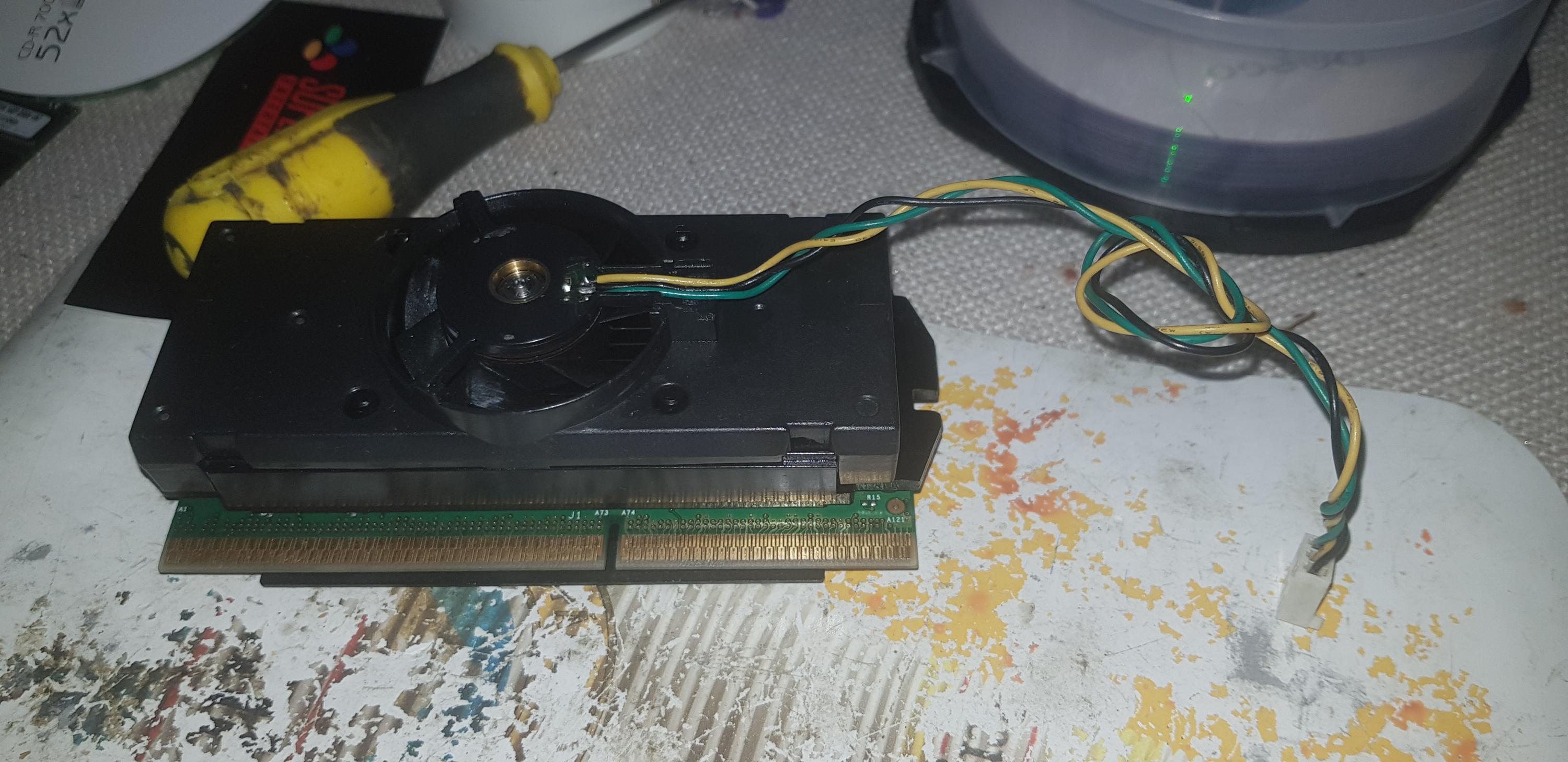

    Not sure if it counts as a ghetto mod, but had to solder a missing fan cable on a Pentium 3 450MHz.

      Looks too professional to be a ghetto mod.
        Hey, at least you used a proper fan cable. I'm always short on those (seems that I've been finding one too many stripped fans over the years and not enough 3-pin cables), so a few times I've used less-than-orthodox cables.
        Also, funny you changed the topic specifically to slot CPUs. I was just working on something in that area the other day and have something to post on this topic. Stay tuned (perhaps later tonight or tomorrow??)

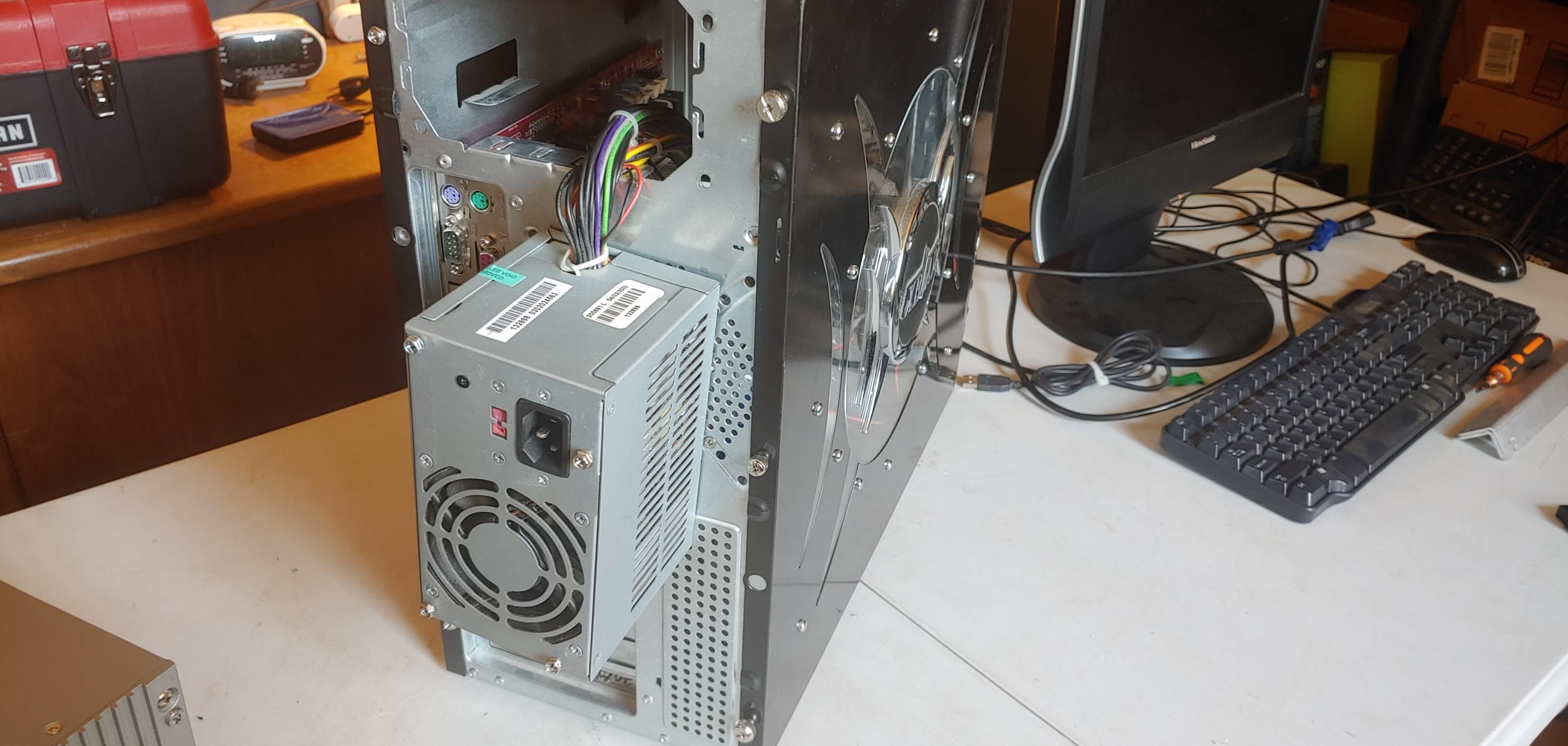

                  PSU in my firewall system died, had to bodge in this HP one. Had to dangle it out the back because the wiring comes out on the wrong side.

                    LOL that sucks I thought that ATX had a standard on where the wire emerges from the PSU case. Then again I have another "ATX" PSU that doesn't seem to match any existing bolt patterns so it doesn't fit anything. Shame too, it seems like a well constructed 200W unit. Might be the same issue.
                      The HiPro "tank" is dead?!
                      Time to open it and post pics.
                      If yes, I suspect bad caps, as ChaosLegionnaire suggested might happen when you run these systems 24/7.
                      Oh I have a similar Bestec PSU. I think these were meant for "side-saddle" cases (where the PSU is mounted on the side of the case, typically above the CPU heatsink or the PCI slots.)

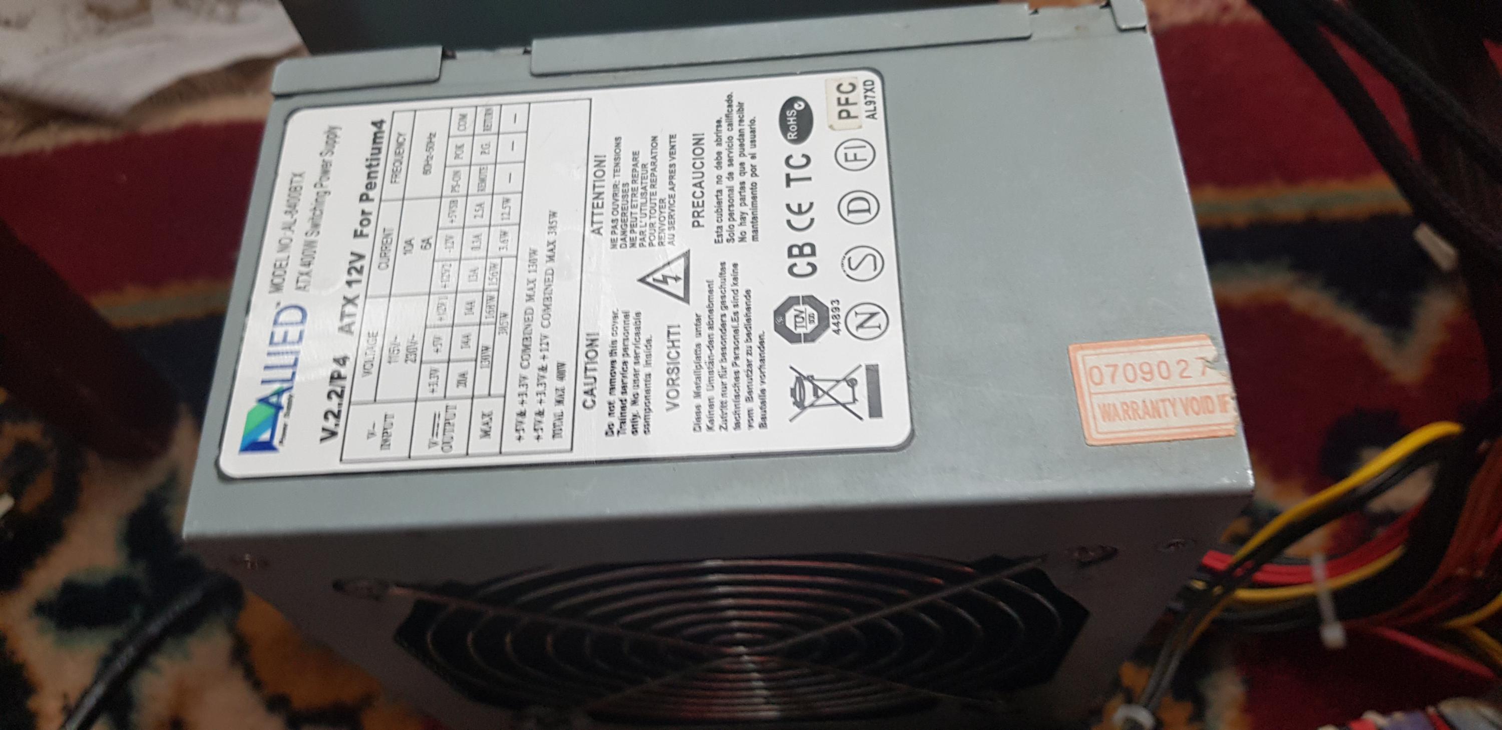

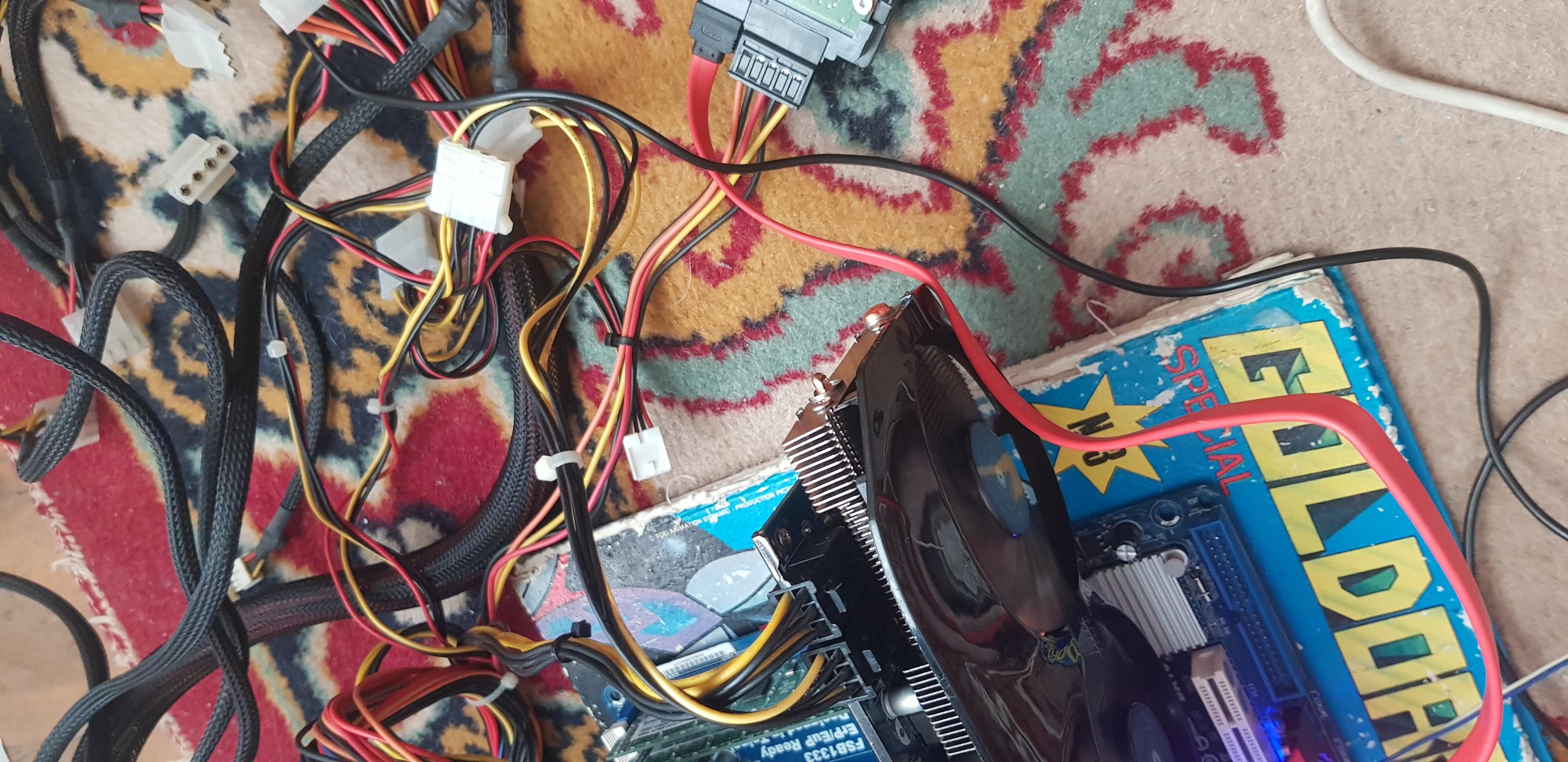

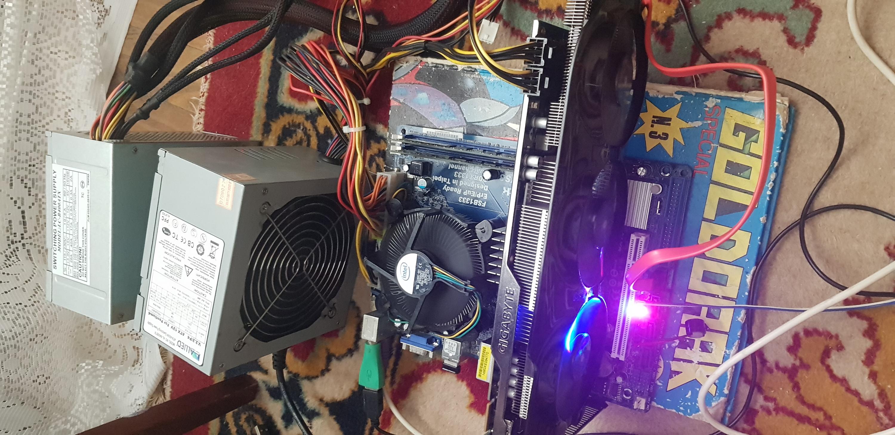

                        Again, not sure if ghetto, but this is how I am currently testing a 7870. Didn't want to work on it untested (has few bodge-job MLCCs by me which I'd like to rectify as much as I can on the backside) so I threw in a testbench using a old Q6600 combo I had. Will also test it on a UEFI board since it was showing artefacts and I suspect it being from some of the MLCCs going bad.
                        Specs:
                        Allied AL-8400BTX (modified)
                        Intel Core 2 Quad Q6600
                        3GB DDR3
                        250GB Seagate HDD from an external enclosure (which shows up as healthy in HDSentinel)
                          You kiddin'?!
                          Using 2 PSUs to power a beefy GPU always counts as ghetto!
                          Also, I think you deserve bonus points for having one of the 6-pin PCI-E power connectors being plugged straight into the 12V of two Molex drive connectors, lol. High-current draw from a questionable connection is always a sure way to make a smoke show.... errr... I mean, to have a fun time!
                          Sadly, I suspect you'll find it probably isn't the MLCCs causing the artifacts - not unless you have bad MLCCs on a data line to RAM and not V_dd / V_core filters. One way to tell is how the artifacts look like - if they move around or change colors, it's probably just a dud GPU chip... which is very common for HD7k, IME.

                            Originally posted by momaka
                            You kiddin'?!
                            Oh no no no. I wasn't using the other one. Just the Allied, and the PCI-E was connected to the Allied PSU only. I took care to take one of the units that I modified and know well that I have a real ERL-35 main transformer, as well as upgraded sillicon. Still worried trusting it with anything higher than a HD 4850 or anything in the mid range of 5000 (e.g 5770) when it comes to using PCI-E cables. Especially with a Q6600 alongside no less.
                            No flashy colors or anything. Missing characters, and I already found three missing MLCCs on the back before. While two were probably not that important (near the HDMI/miniDP ports) the last one was around one of the RAM chips so definitely had to do with the missing characters. Those were about the only ones missing, and I figure that at least fixing the RAM cap should make it work.

                              Yes using two PSUs when one doesn't have a single 1KW PSU on hand...
                              I'm surprised, there's always a risk when doing this, hence this is why it's ghetto. Depending on the circuit, if you don't power them up at the right time...

                                It's only the Allied that was plugged in. The no-name Deer PSU above it (which I rebuilt, upgraded sillicon, recapped as well as replaced the snipped wires it had using cables from a dead Thermaltake TR2-420NP) was used to test a older mobo (Jetway J-7BXAN). The Allied used here DOES have the PCI-E contraption still attached to it but it's been put to storage for quite a period now.
                                  That sounds about where I would be drawing the line too.
                                  Q6600, OC-ed or not, can peak up to 130-140 Watts probably. HD4850 and mid-range HD5k (i.e. HD5770) are also another 100-110 Watts. So that's roughly 240-250 Watts on the 12V (at max load) already, which comes out to about 20 Amps... and probably the maximum the output (5V/12V coupled) inductor can handle safely on those Deer/L&C/Allied/Solytech PSUs.
                                  Well, I do hope that you turn out to be right. But from what I've seen, missing characters is related to BGA failure (typically between GPU die and substrate PCB.) So I don't think that one cap will be the problem especially if it's just a V_dd filter for the RAM. One way to tell: if the spot for that missing cap shows same resistance to ground as the RAM V_dd rail, then it's on the V_dd rail, and it missing shouldn't be a big enough deal to cause those failures.
                                  It actually shouldn't be that much of a big deal... though it does depend on the video card's VRM a little.
                                  If the 2nd PSU (for the GPU) powers On and is ready before the PSU used for the system, then the video card will just sit, waiting for an enable signal from the motherboard via PCI-E or AGP bus... and will power On, once the mobo boots and that comes up.
                                  Now, if the 2nd PSU (for the GPU) takes a little longer to reach proper voltages before the PSU for the system, there is a chance the GPU may not see full and/or proper voltage for the GPU VRM... which may or may not be a problem. But in most cases, most GPUs are overbuilt enough that either the VRM won't start if the voltage is too low, or it will start and cope with the slightly lower voltage now-turning-normal as the 2nd PSU comes up properly.
                                  So it really isn't that much of a risk. Just tie the PS-ON signal on both PSUs together, that is usually enough. For those who want a more elaborate ghetto solution (that's a funny oxymoron, isn't it? ), it would also be a good idea to come up with an AND circuit that takes the PG signal from both PSUs and feeds it to the motherboard as one signal. That way, if one PSU looses regulation or shuts off, motherboard PG signal will be lost and mobo will signal hardware to shut down.
