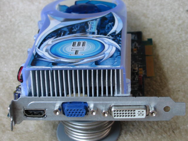

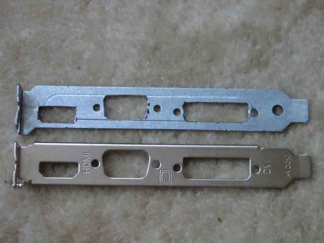

              Re: The ghetto mod thread - HIS Radeon HD4670 AGP IO bracket
              Video card from this post:
              https://www.badcaps.net/forum/showpo...postcount=4586
              It needed an IO bracket, so I made one.
              Yeah, she ain't going to win any beauty contests, but the IO bracket fits pretty well otherwise.
              Not sure why the VGA port cutout came out so large. I copied the IO bracket from a Gigabyte GeForce 240 GT (shown above) and also the IO bracket from a PCI-E version of the same HIS Radeon HD4670.
              So now I'm trying to decide if I should paint the IO bracket (probably white or silver), so that hopefully it blends in a little better. Maybe?

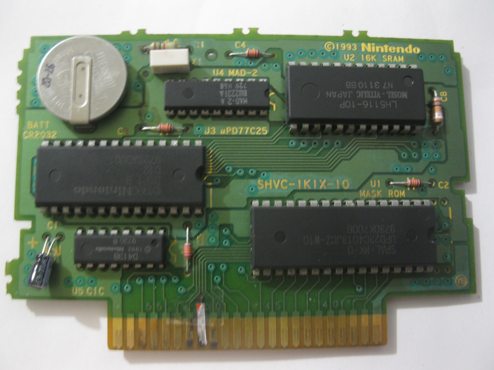

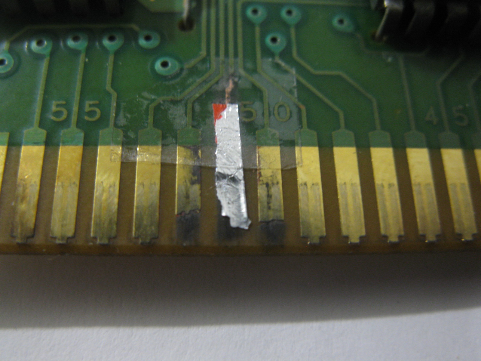

                                    I picked up a dead Super Mario Kart SNES cartridge on eBay for next to nothing just before Easter. The seller said it didn't do anything at all even after being cleaned. I plonked it into my Super Nintendo, and sure enough, nothing but a black screen, even though the pins were clean. Last night I had a look at the cartridge after leaving it sitting for over a week.
                                    Turned out that the cartridge had been wet at one stage (luckily the water mixing with a live battery didn't do anything to the chips) which had caused corrosion on pins 50, 51 and 52 as well as on most of the chip legs. On top of that, pin 51 had been ripped clean off, and 50 and 52 were also damaged but still long enough to connect to the console, as shown by the uniform dark marks on all of the pins. The trace going to pin 51 also had the smallest pinhole-sized gap (caused by corrosion) just above the pin causing the connector pin itself to be electrically dead.
                                    My ghetto fix, after checking every single chip pin with a multimeter to make sure they weren't damaged, involved scraping some of the varnish from the PCB to get at the broken trace, using a lead pencil to paint over the broken trace and to make some edge connector pins, and finally some silver foil, explained later.
                                    While patching the trace with the pencil worked (I have done this with several cartridges and even an NES console before), making pins out of carbon did absolutely nothing, there was probably too much of a "step" between the pin and the bare circuit board so it was still open circuit.
                                    By pure coincidence, I still had some Easter eggs lying around that I hadn't eaten - two minutes later I had made a tiny pin out of a foil Easter egg wrapper, folded it with the print on the inside, and simply taped it over the lead pencil trace I had made. I put the cartridge back together without the screws, and flicked the switch on the Super Nintendo expecting the same all nothing but a black screen, only to be greeted with the Nintendo logo, the coin jingle, and finally the Super Mario Kart theme!
                                    Unfortunately I didn't take any before pics, but there was a lot of white and blue crud on the PCB from the water hitting the chip legs and components (resistors etc.). The original CR2032 battery from survived but is a bit low at 2.6V, but still has no trouble keeping the game's save data alive.
                                    The only down side is that the foil is very flimsy and probably won't last brushing against the cartridge slot contacts more than a few times, but for a five minute ghetto mod it's pretty good for now.

                                      still a very nice trace repair and goldfinger repair tho! thumbs up! try to see if u can get some gold metal polish to clean up and remove the corrosion on the other goldfingers too! corrosion can spread so u must remove the corrosion or u'll be repeating the repair on the other goldfingers as well in some years to come!!

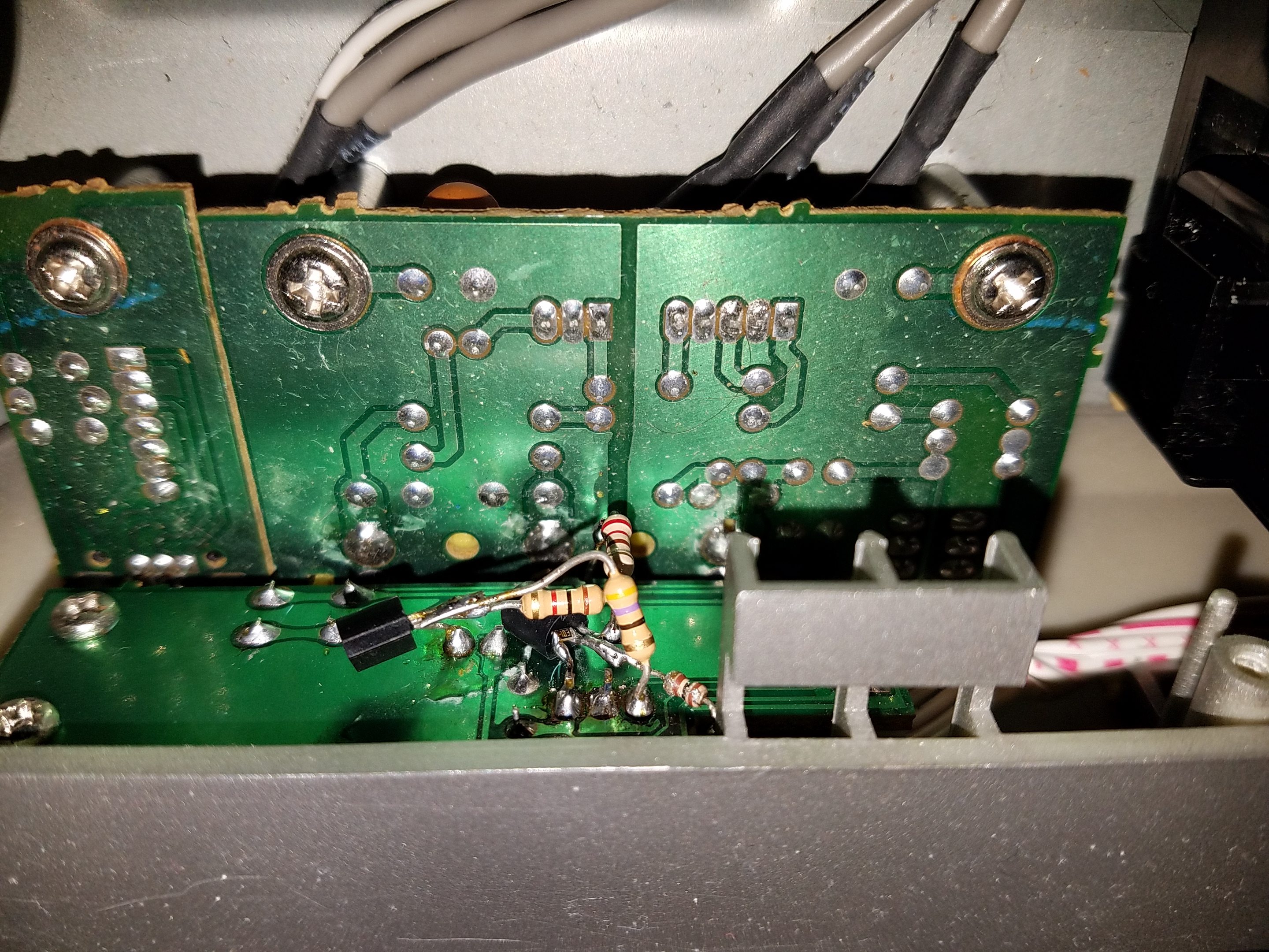

                                        Here's how I "fixed" the IR receiver on a crappy off-brand DVD recorder. Replacing the receiver got the remote working, but then I measured a ridiculous pull-up current from the part that it connected to (almost 50mA - probably a blown input). The original receiver worked with a more sane pull-up, so I wired up this buffer.
                                        I was going to try passing video from a VCR through it, but both composite and S-Video outputs suddenly started clipping dark colors to black. I need to figure that out now.
                                          Nice ghetto fix there and really cool to see one of these brought back to life!
                                          Also, I think you may eventually get Galvanic corrosion due to dissimilarity of properties between Aluminum and Gold (gold plating.) But indeed for a quick go/no-go test, this was a brilliant fix.
                                          Graphite, drawn on a thin layer like that, will have a pretty high impedance over the length of the entire trace, so even if it did make contact, there's still a chance it may not be able to carry enough signal current between the cartridge and the board for the two to communicate. So that's probably why it didn't work. Otherwise, imagine if you could just draw traces with a pencil - you could create prototype circuits board right on paper! Actually, I think someone already tried such an invention and it did work - but obviously still only for low-power signal stuff.
                                          Cool point-to-point wiring job. The small SMD resistors on the leads of the transistors is a nice touch too.
                                          Interesting. I wonder what would cause that.
