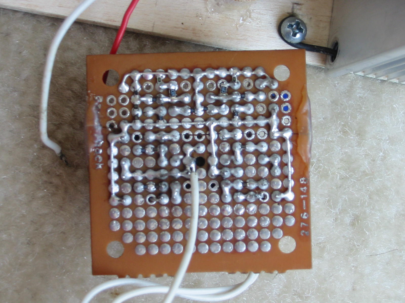

    It was not a complicated design, but I needed to connect a connector with many pins... on the edge of the board... and having the PTHs would short everything.
    Is there a grid between the (tiny) pads? What is the point of that?

      Re: The ghetto mod thread
      beats the heck out of me, perhaps to let people to choose using the grid horizontal or vertical. Of course now someone needs to cut all in the orthogonal direction...

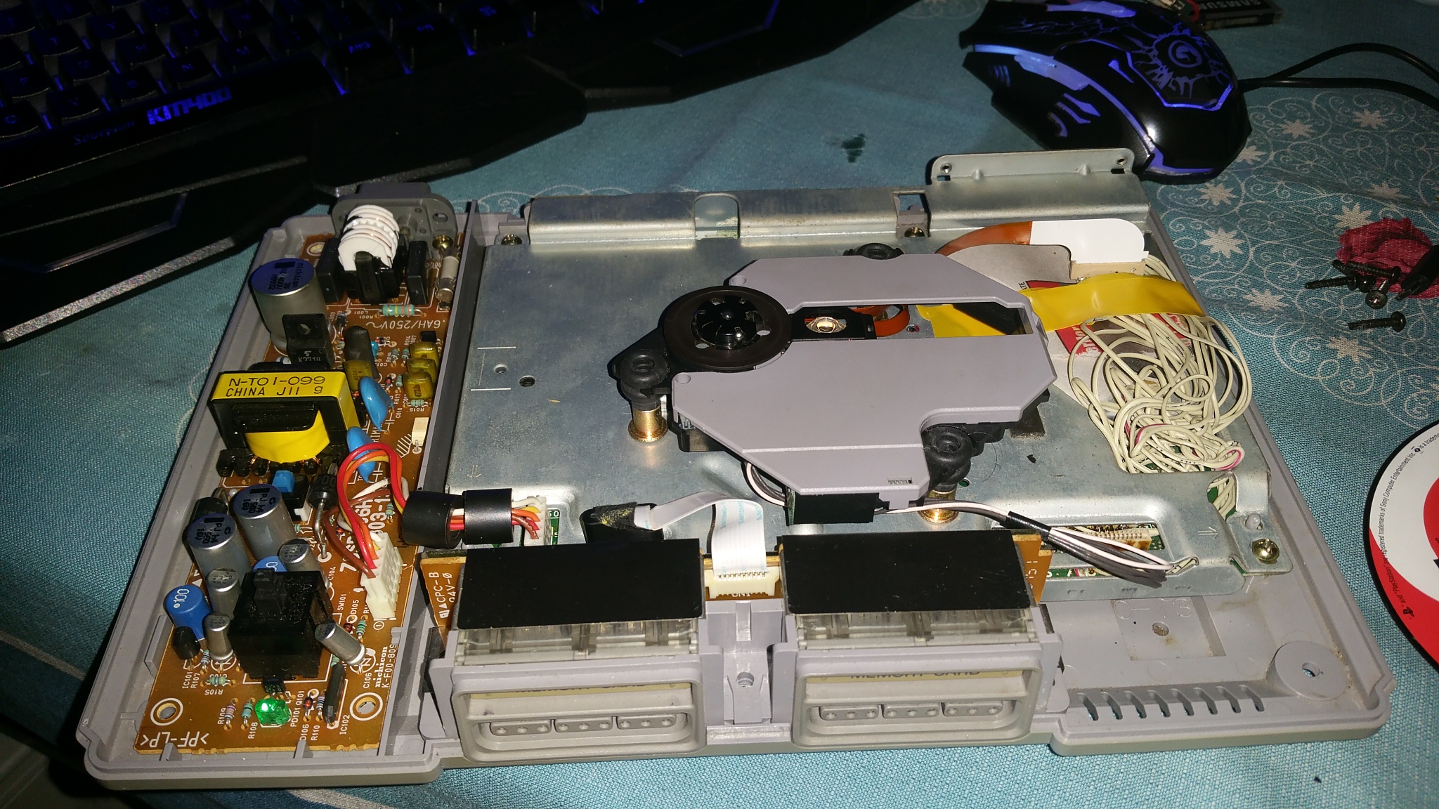

        Do I win the award for the most ghetto thing? hehe
        Anyways, this is one of my PS1s I fixed a few days ago.
        Extended the laser ribbon cable because the drive I had wasn't for the model I had to fix.
        It's a SCPH-5552, about the only ones beside the 7002s to require a long laser ribbon cable. My other two, a 1002 and a 9002, use normal cables. (the 1002 has a slim PS1 laser for example, and these have the right size ribbon)

          holy bell wire!

            Looks like a spaghetti monster is lurking in there
            I want to see how ghetto the eye pattern from the laser pickup is with all that!
              It actually works fine
              I tested Gran Turismo 2 and Brian Lara Cricket on it and both loaded fine.

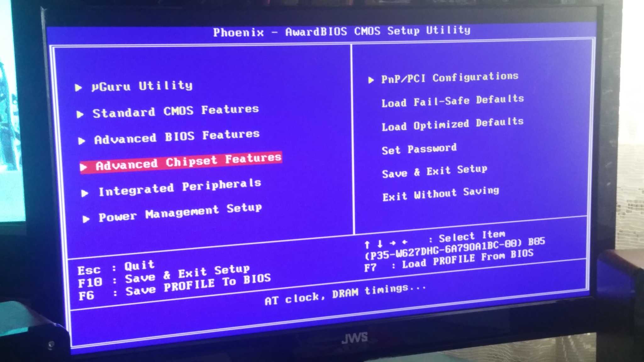

                  Strikin' again with another ghetto mod.
                  abit IP35 Pro mobo - replaced one Winbond chip that was bad near the RAM slots. This however didn't change the fact that it would still give error 8.4 and not POST.
                  You can see the mod here Now it works fine (although that area gets really hot, but that's a design flaw, my older IP35-E had the same hotness issue) although I keep getting 0x7E on Windows discs, but that's another story.
                    BIOS UI reminds me of socket 462, LOL. (And early-2010s' Gigabyte AM3)

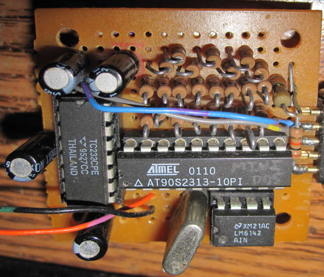

                                  More nasty handywork... just because I didn't have a case for the DB9...
                                    • 31161
                                    #497
                                    lol
                                    so whats in it, a max202 or similar?
                                          LOL, yes MUCU5 chip!
                                          Actually no ICs, just two NPN transistors, three resistors, and some wire.
                                          stj probably already got the answer because he saw a LOT of clues scattered everywhere, but the bonus question is: what is it used for (exactly).
                                          Hint is that it doesn't need any additional power source...
                                          In any case, perhaps I need to go over it one more time with a heat gun to smooth out the plastic...
