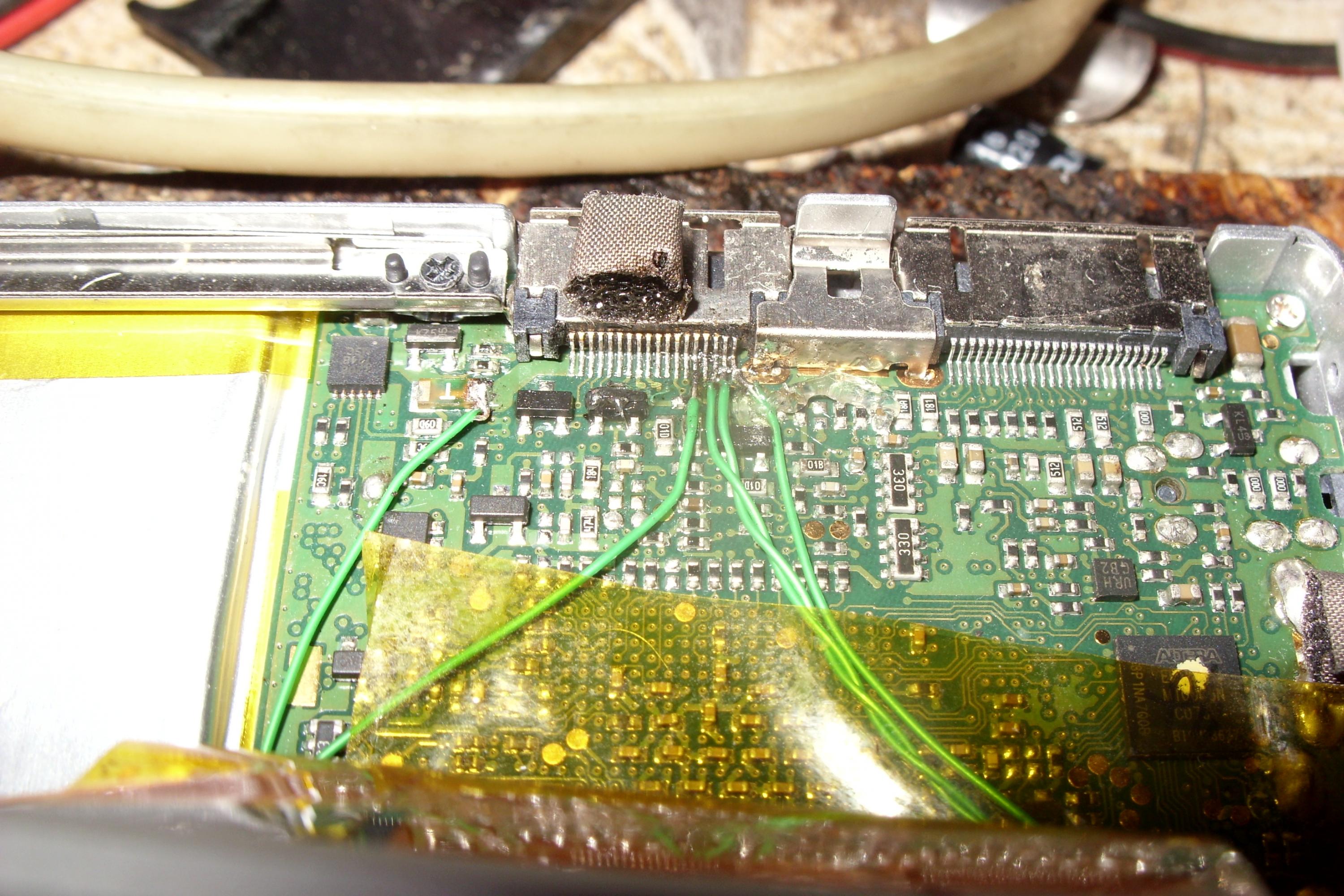

    A neighbor of mine dropped this off for me to take a look at. Archos asks you to pay 30 euros to unlock the web browser on it, which is actually Opera Mini (free). Similarly if you want more apps or plugins, you have to pay. Fortunately it can be jailbroken in a similar fashion to Apple devices, but you need PC connectivity for that, and he doesn't have a PC cable for it, it has a stupid proprietary connector.
    It'll charge with a Samsung charger but won't connect with a Samsung data cable, so the pinouts for the data lines must be different.
    I popped the thing open, and it's pretty lax inside. I can put a microUSB port in a convenient location. Finding the pinout of the proprietary dock connector took A LOT of digging, but here it is:

    I'll go ahead and perform the mod tomorrow, and then unlock the software and all will be well.

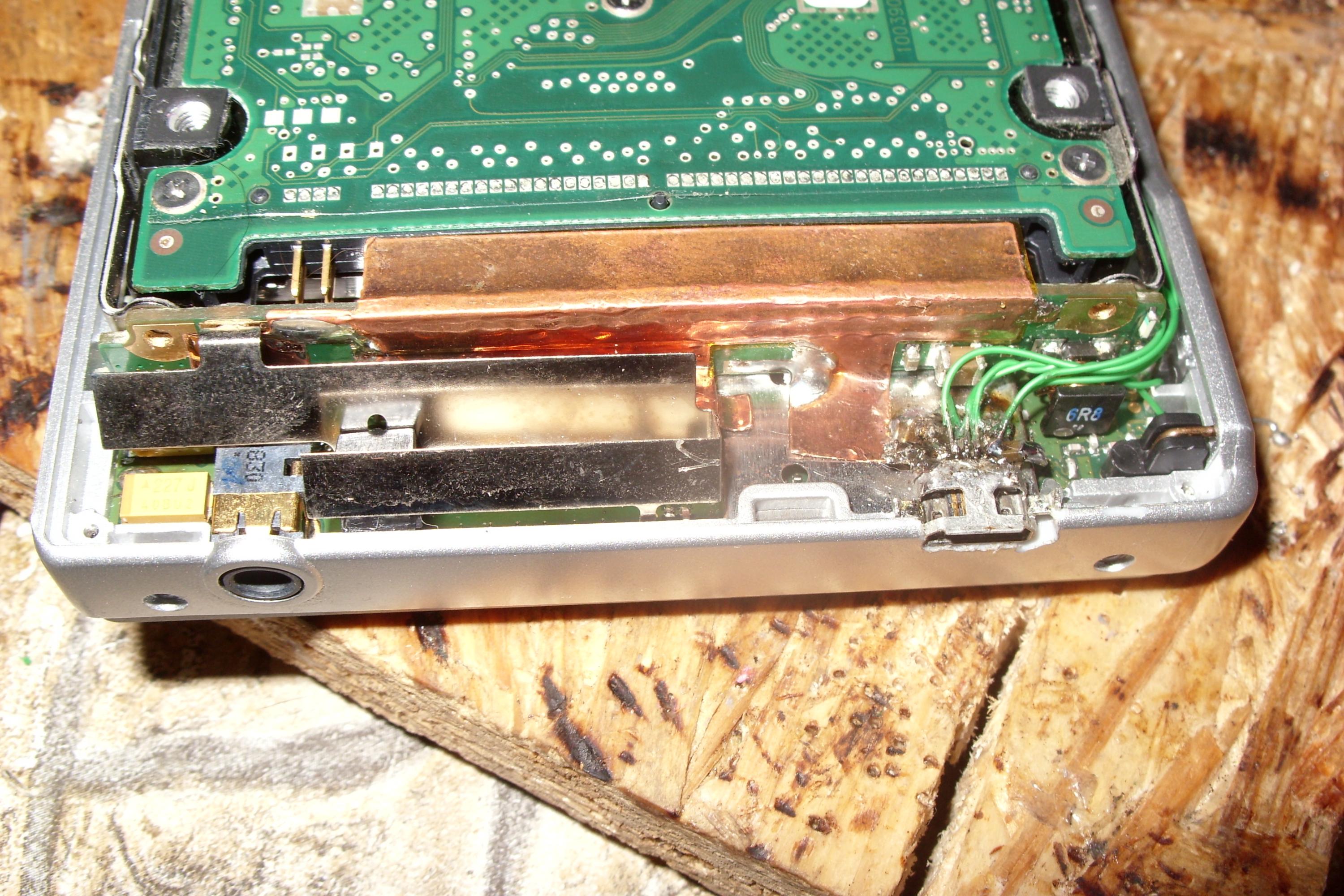

              Anyway. Finally got it done today. It was a royal pain in the behind at first - it worked first time, and then i hot glued the wires so they don't come loose, and it would restart just as the removable drive was about to appear in Windows, each and every time. It also turned on/off by itself randomly, as if the power button were pushed. It drove me nuts, so i let it sit for a few days. Seems like hot glue had enough parasitic capacitance to mess things up...
              Cleaned up all the hot glue a few days ago, and today i bought new tips for my Gordak station as the one on it was pretty badly oxidized. Thanks to that wiring was a breeze this time even with the ridiculously fine pin pitch of the connector on the Archos. I soldered the wires directly to the connector, it has a lot of test points but simple continuity checking revealed that the signals i wanted weren't there.
              This time i also took some extra measures: I twisted the USB D+ and D- wires together. And it seems to have worked, removable drive showed up first time and STAYED there. It did shut down on me a few times, but that was because the battery was flat - the hard drive uses quite a bit of power, and USB charging alone isn't enough to keep it running if the battery's very low. I left it alone for half an hour and it behaves now. Put about 10GB of music on it, no hiccups, got around 12-13MB/sec write speed.
              Now for the fun part - jailbreaking it. From what i've read it requires to be run from a Linux OS (as it's a Linux device), so i won't do it today.
              Pics to follow tomorrow, as i've yet to close the case.

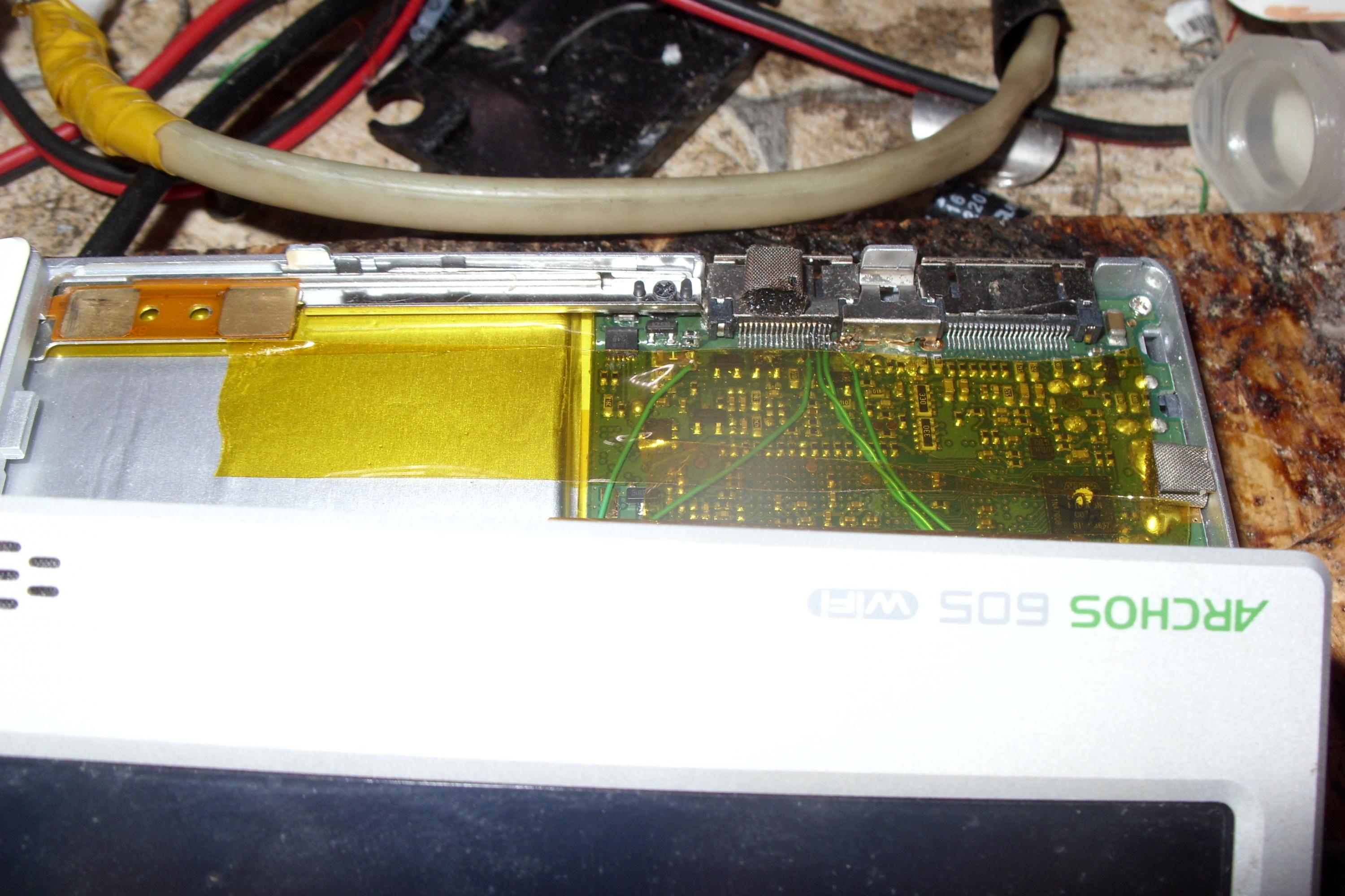

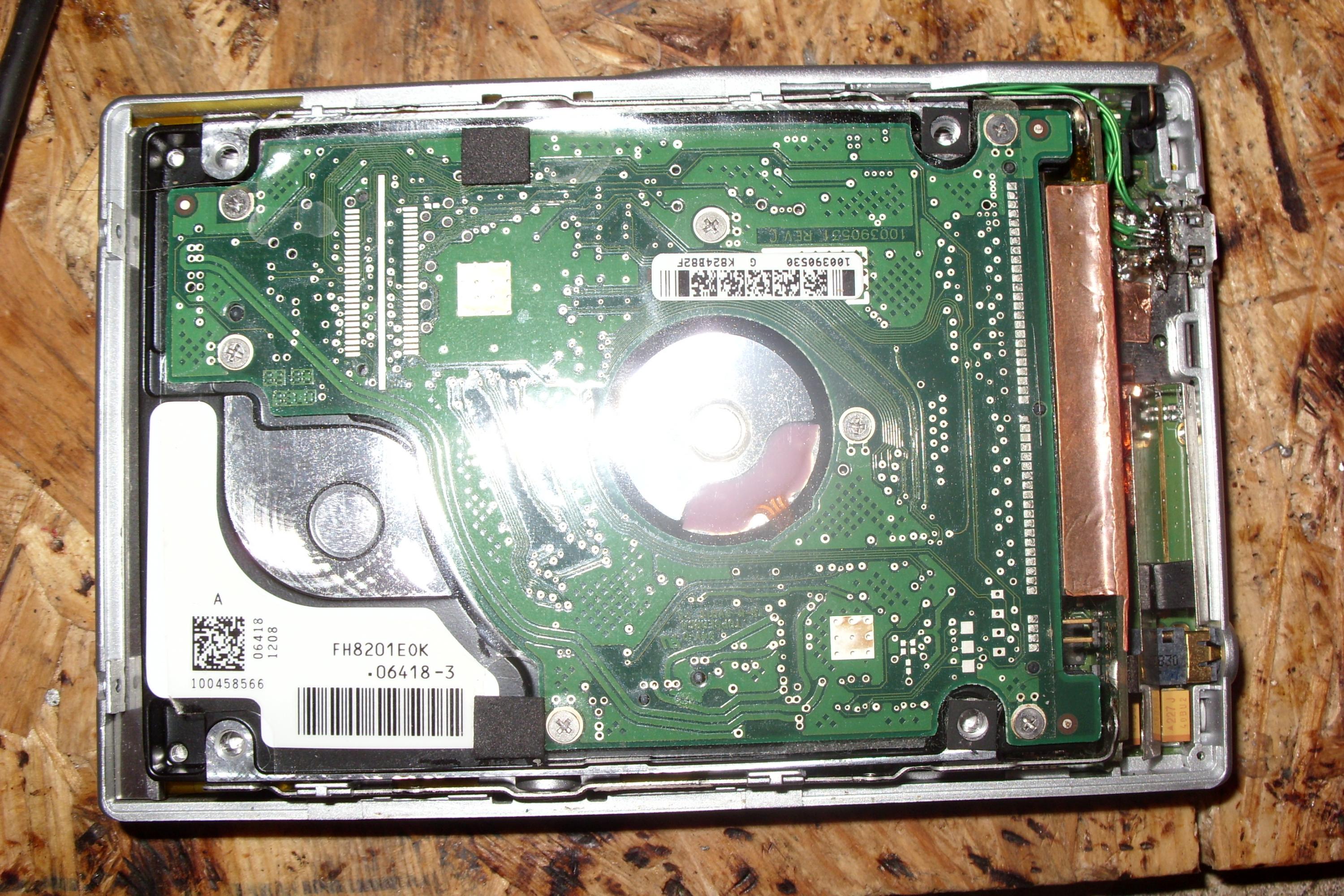

                All fixed up and back to the owner. Forgot the pics, haven't i? Here.
