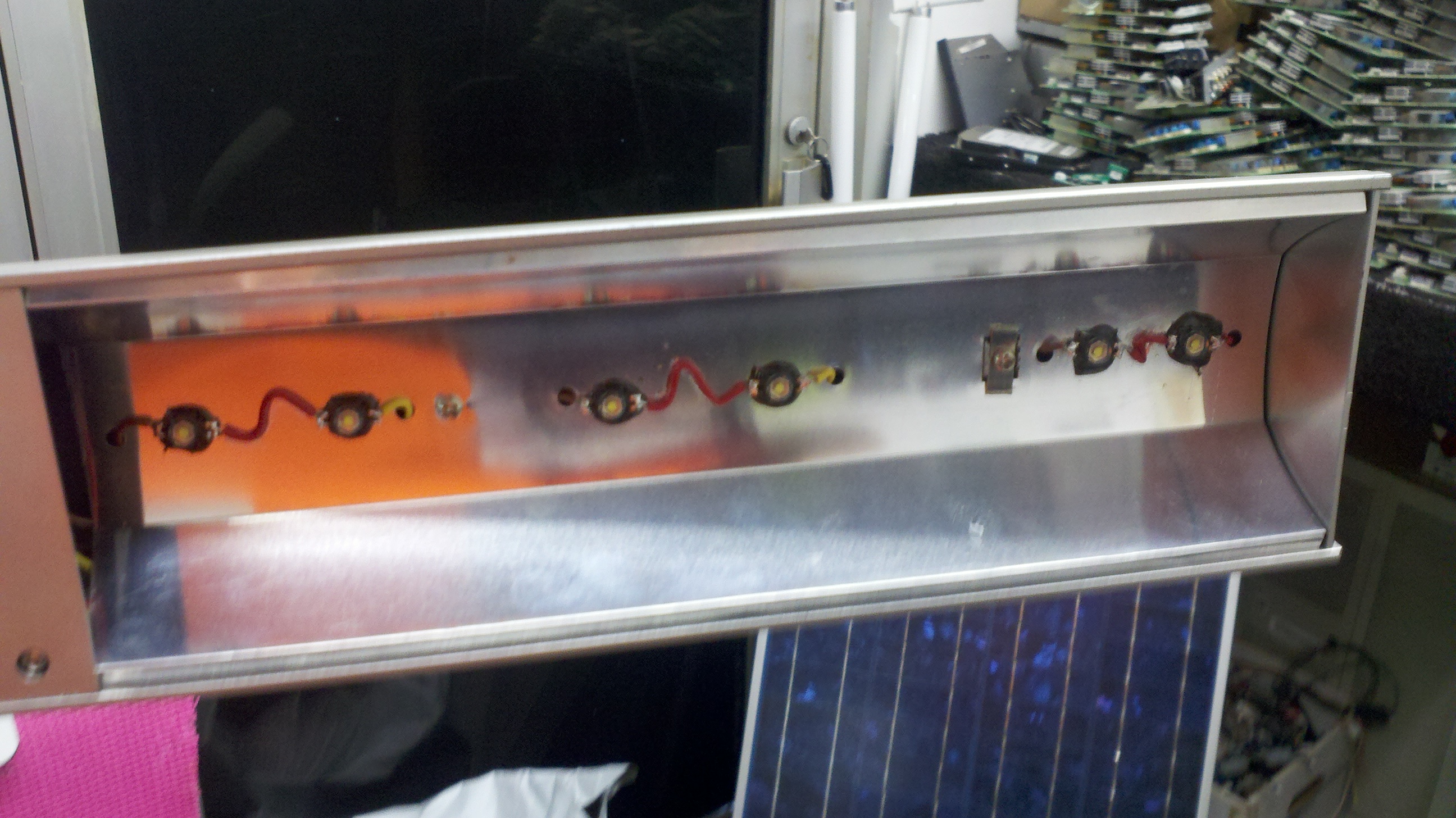

    got this free.
    takes a wierd bulb that costs $25+ delivered.
    hmmm aluminum reflector?

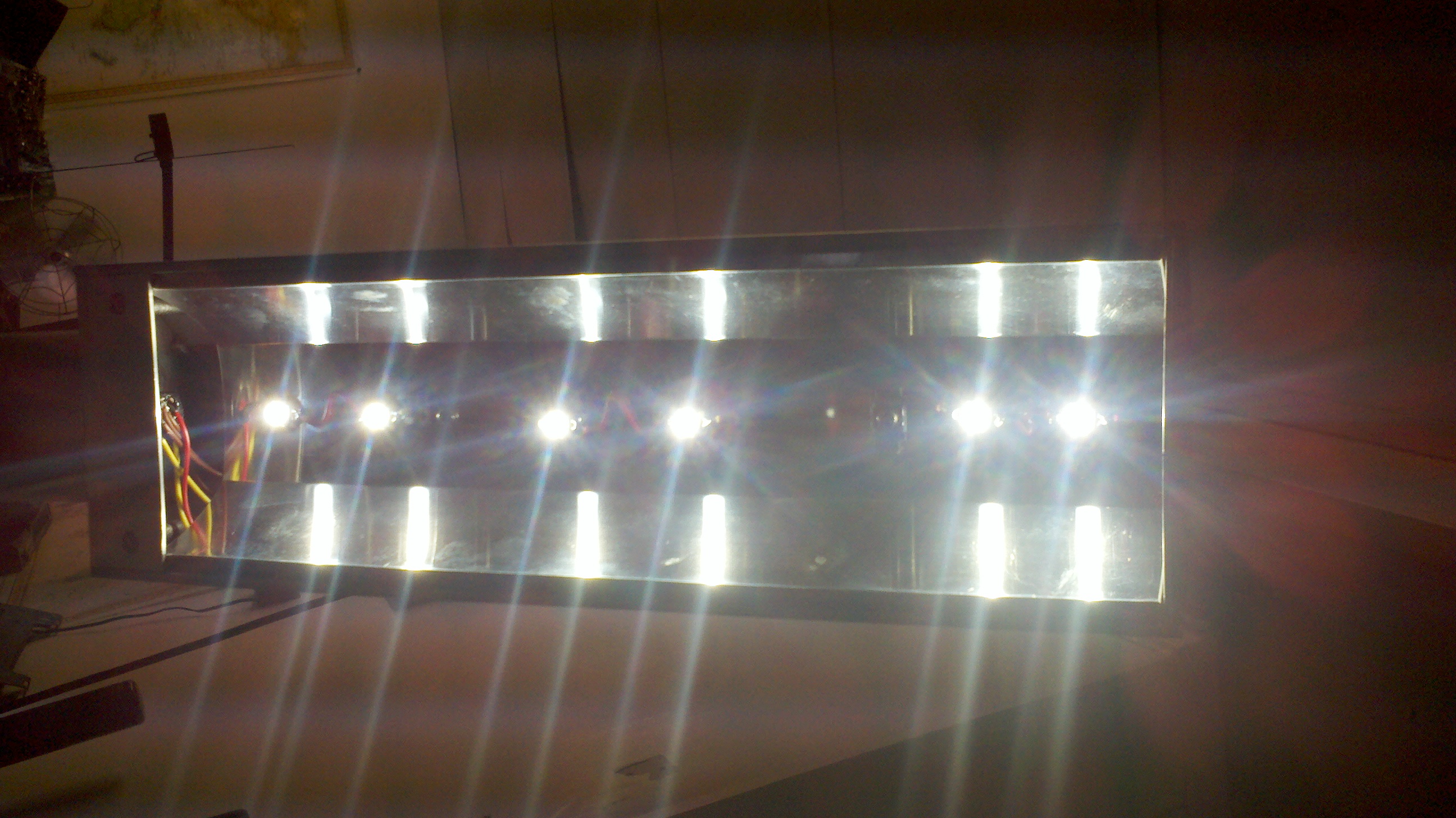

    perfect heatsink for 6 luxeon k2 led's.

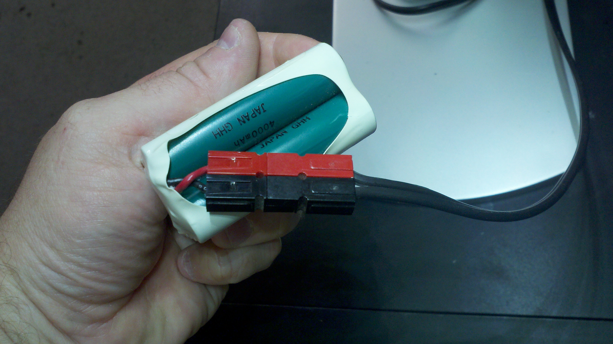

    they are set up in 3 pairs of 2 with 10 ohm 2w resistor in series with each pair.runs from 12v now so useful for power right off +12 in the pc or off my solar setup.even runs several hours off a 4ah pack i use with my ft-817.

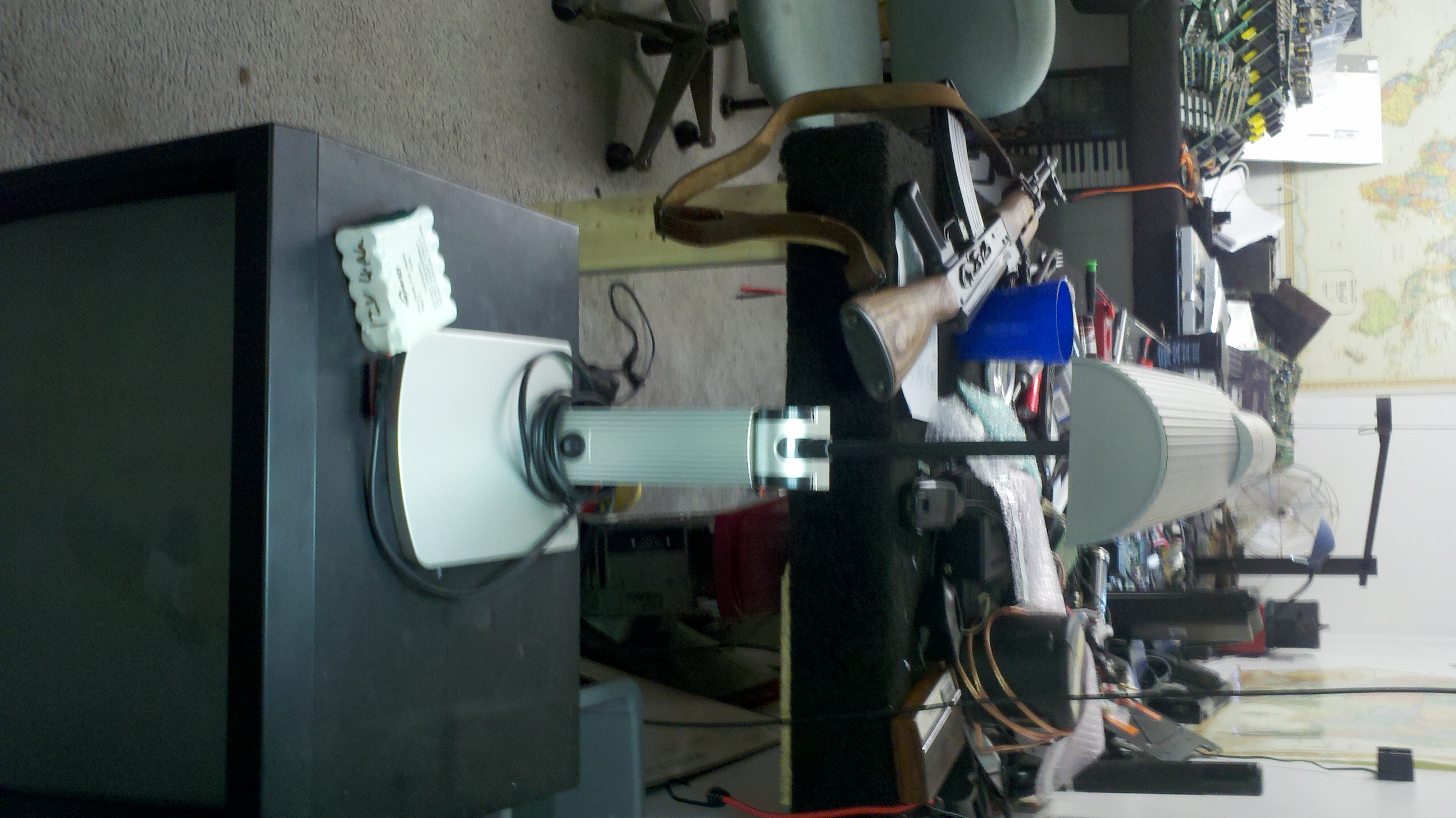

    What's with the AK 47? Modding it?

      Re: lamp with expensive bulb go out?dont toss it mod it!
      yes.
      it was in the shop for the gamer kids to take their avatar pics with.they are trying to look mean.
      ak needs a trigger kit to fix kickback.
            the guy that donated it came back and saw what i did.he is also studying to get his ham ticket.and has a modded 12v ups with a powerpole panel in it.he wanted it back so he got it for about what the parts cost.got 2 of the small ones with the little halogen bulb in them.they get modded next.
