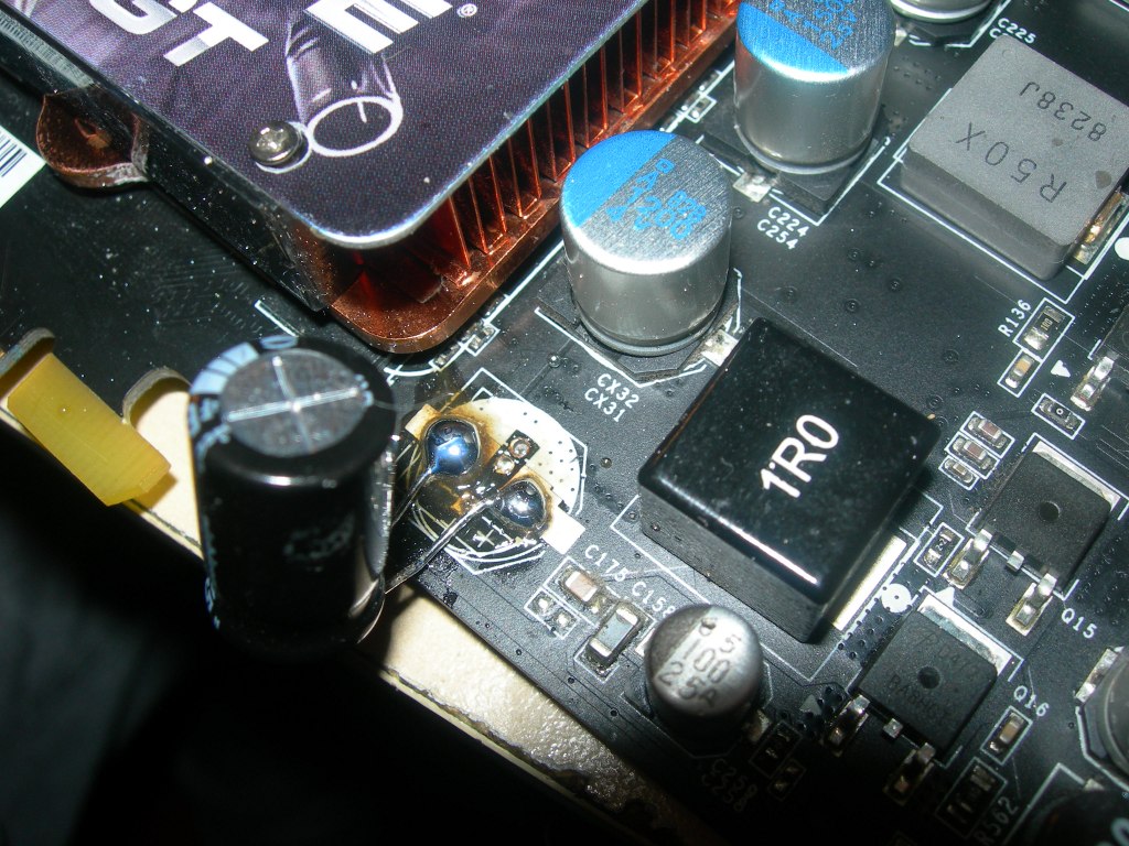

    Turns out FP's ESR is much too high, 0.08 ohms vs. 0.025 ohms. But I can't find anything to replace the FJ with. It is well any truly ruined. Last I tested it, measures 11 ohms with the lead inserted back in, I guess permanent damage has been done. Maybe a polymer would be good. Never poly-modded before, there's a chance to learn something in the process. So I would use an ~820uF poly (halve capacitance?)
      half capacitance doesn't work with such low ESRs. I'd try to find a poly with enough voltage and a similar ESR... In a VRM, ESR counts much more than capacitance.

        Well, I probably should have checked my caps box first. Found my pack of Nichicon HM, 1500uF 6.3V has 25 mohm ESR, which is the same as the FJ. It's through hole, but there's nothing stopping an ugly bodge job now... I am not going to pull the caps off this board, it is too much work and too much can go wrong.

          So, I tried pulling the caps off the board, no dice. I ruined one FJ cap in the process - pulled the lead out of the cap, although I did get it off eventually. I am using a temperature regulated soldering iron and the same method I've always used for though hole caps, but that only works on single layer and *maybe* two layer boards, not 8-10 multilayer beasts...
          Perhaps you didn't use enough heat. We have nice regulated soldering irons at work, and normally I keep it 270-300C for soldering. If the board is thick, I use 350C. For removing caps, I max it out - 400C to 450C. This actually does the least amount of damage vs. having the iron at lower temperature and holding in on the board for a longer period of time.
          I supposed this is why my cheap RS iron works so well - it's unregulated and probably tops out at ~400C when I let it heat up for 5 to 10 minutes.
          Judging by the capacitance of tom66's cap, it's most likely on a VRM (probably RAM). Pretty much all modern, high-power cards have at least 2 VRMs (1 for RAM and 1 for GPU VCC). If you see MOSFETs connected to toroidal coils, it's a VRM.

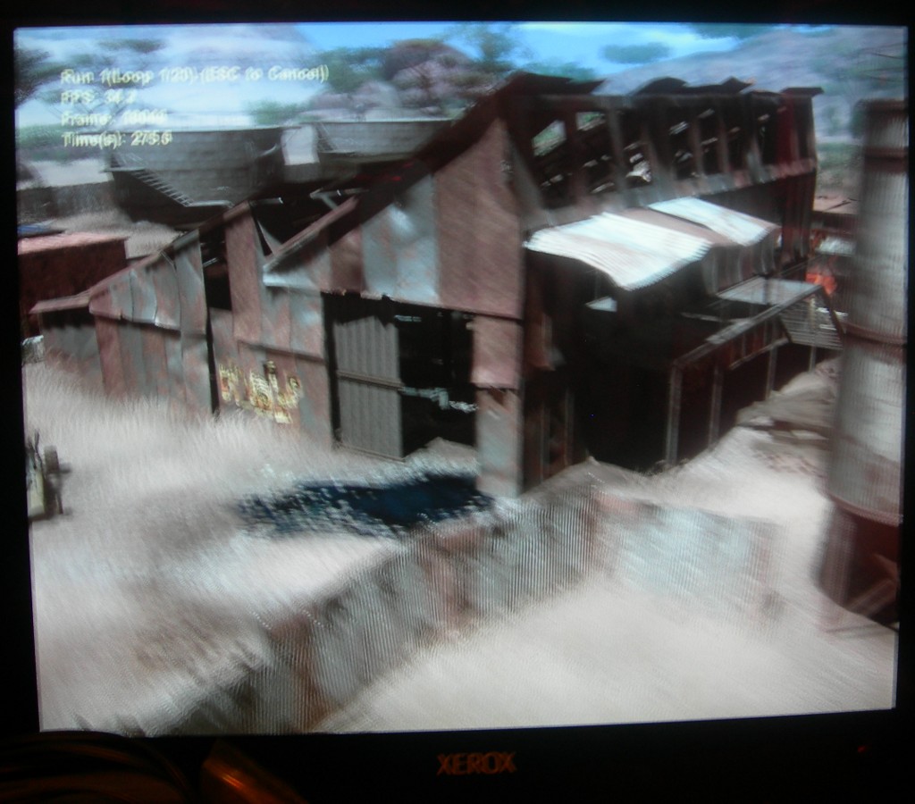

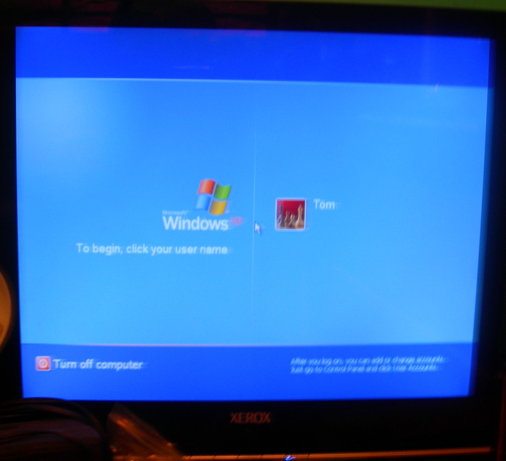

                Anyway, I'm happy to report the operation was a success, at least, I think. No more lines. Yet to run anything powerful on it. I think the Nvidia drivers don't like the new card so I may have to reinstall them as it's stuck in 640x480, but absolutely no lines appeared through the boot process unlike how they did on my dad's PC.
                Now how did I fix the cap...? I'm sort of ashamed to post the picture... but it works, just about. I need to glue it down.
                Unfortunately I got my motherboards confused, my media PC (some Asus board, forget which) has dual PCI-E x16 but this Abit KN9 Ultra motherboard only has one 16x slot. The only reason the media PC is dual PCI-E is because I was given the motherboard with the single core AMD FX64 processor on it already, and didn't feel like swapping the CPUs and keeping the dual PCI-E dual core FX64 to myself. (I don't even know if the processors are cross compatible. It's chance that I've got two similar processors, I'd take a free Intel or AMD any day.) Anyhow, graphics performance is very good with one card, and I hope to get the 24" monitor working soon for some epic-ness. The 24" has essentially the same vertical height as my current 19", but it is much wider.
                  Re: Freebie Nvidia XFX 9800GT - Lines on screen
                  It seems to work on Far Cry 2 Benchmark - I am letting it run for a while and seeing if anything goes wrong. So far so good. Excuse the blurry picture...
