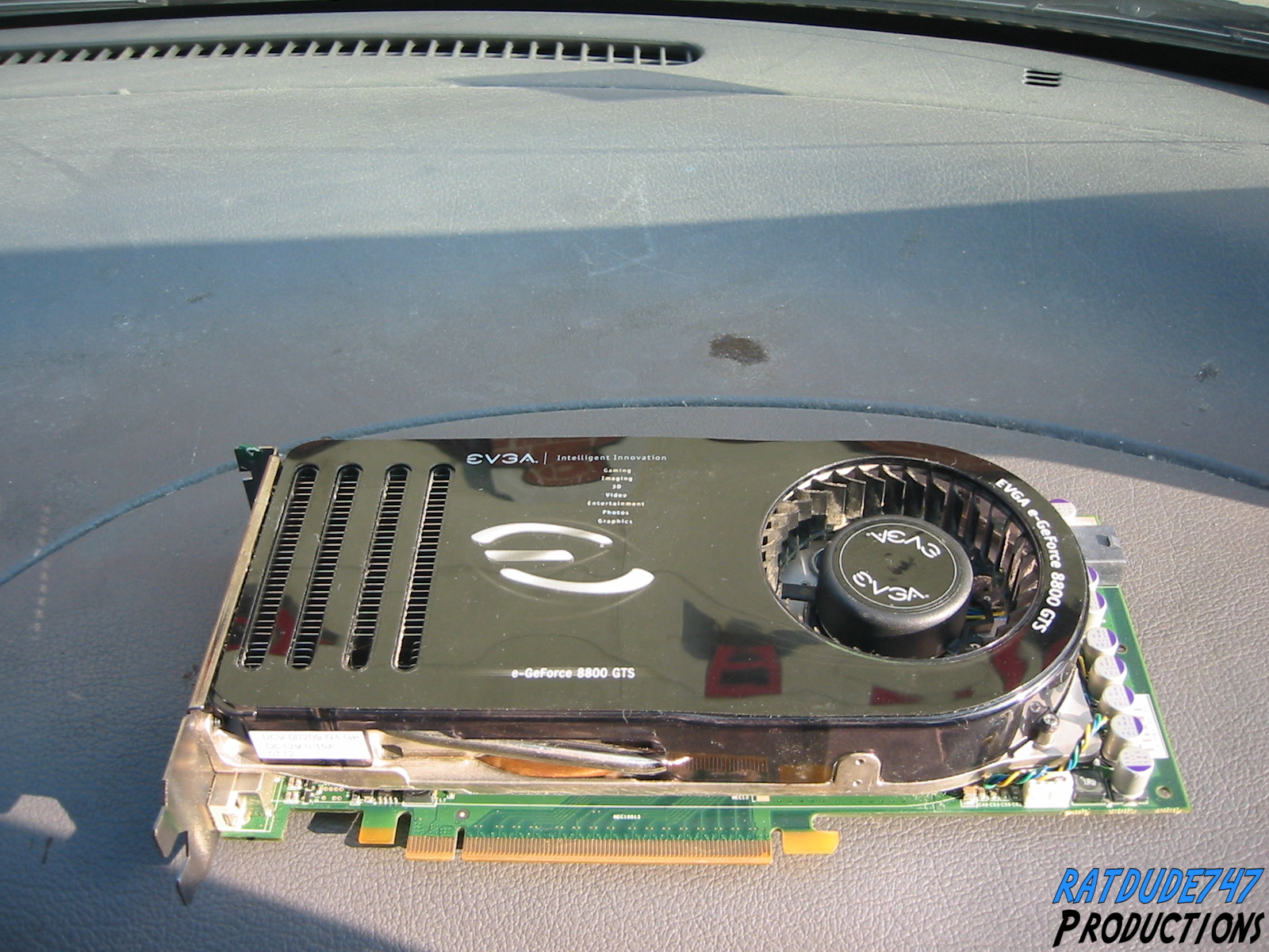

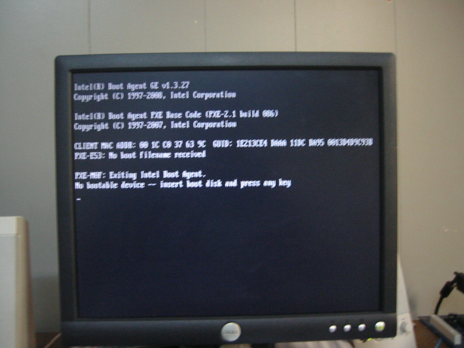

    Made a score today:
    The price:

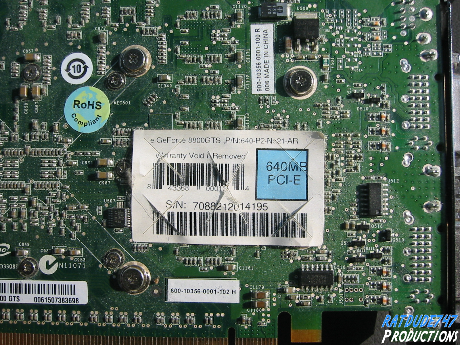

    A sticker included:
    ... which is not quite accurate:
    The card's specs:

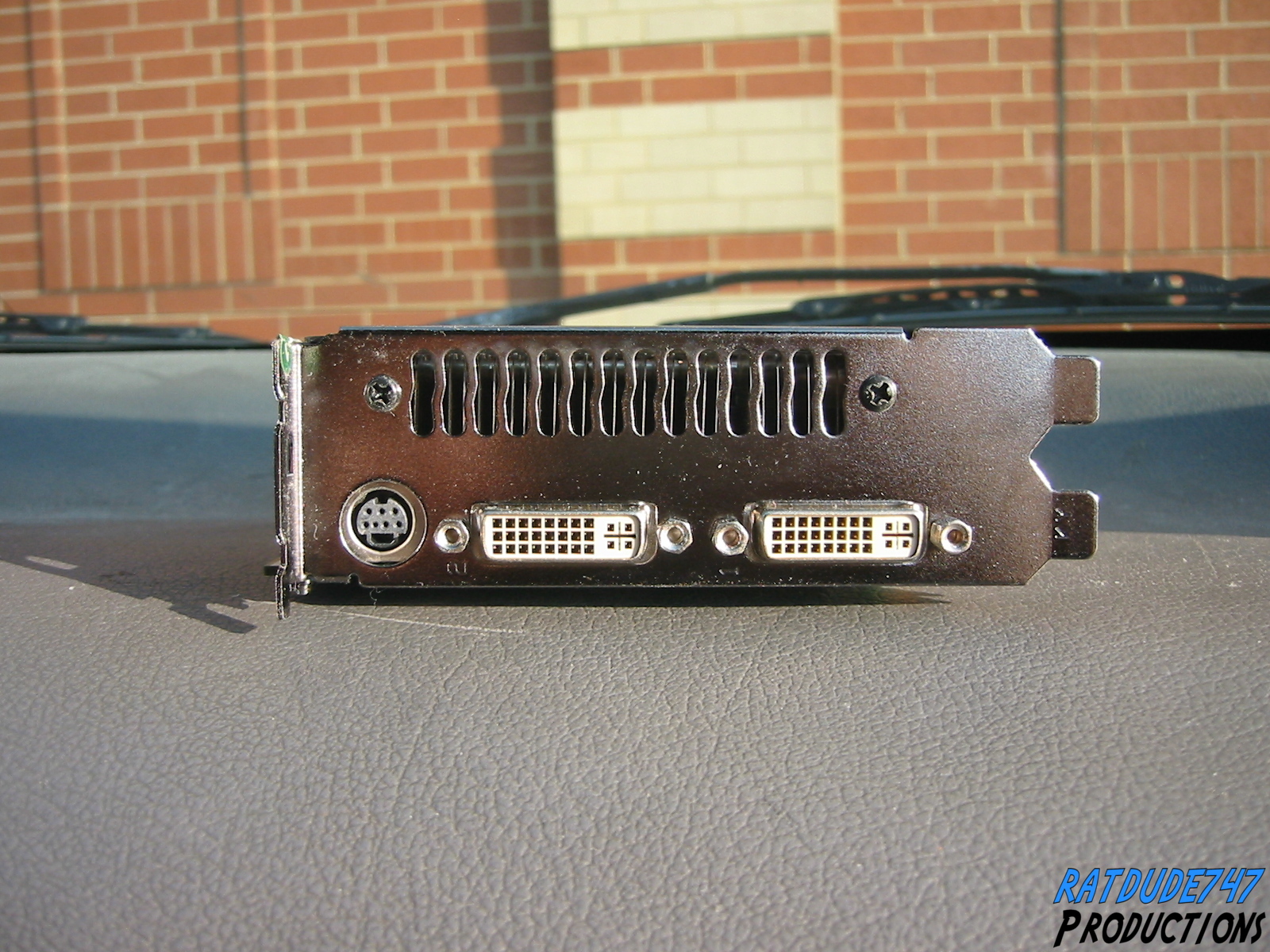

    The ports:

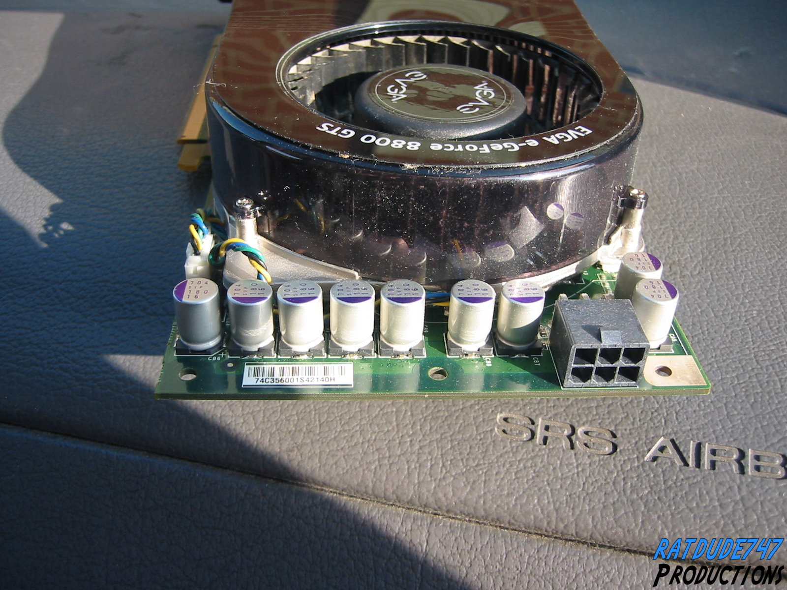

    Yay! All Poly caps:

    I have not had a chance to test it... But I will soon. Comments?

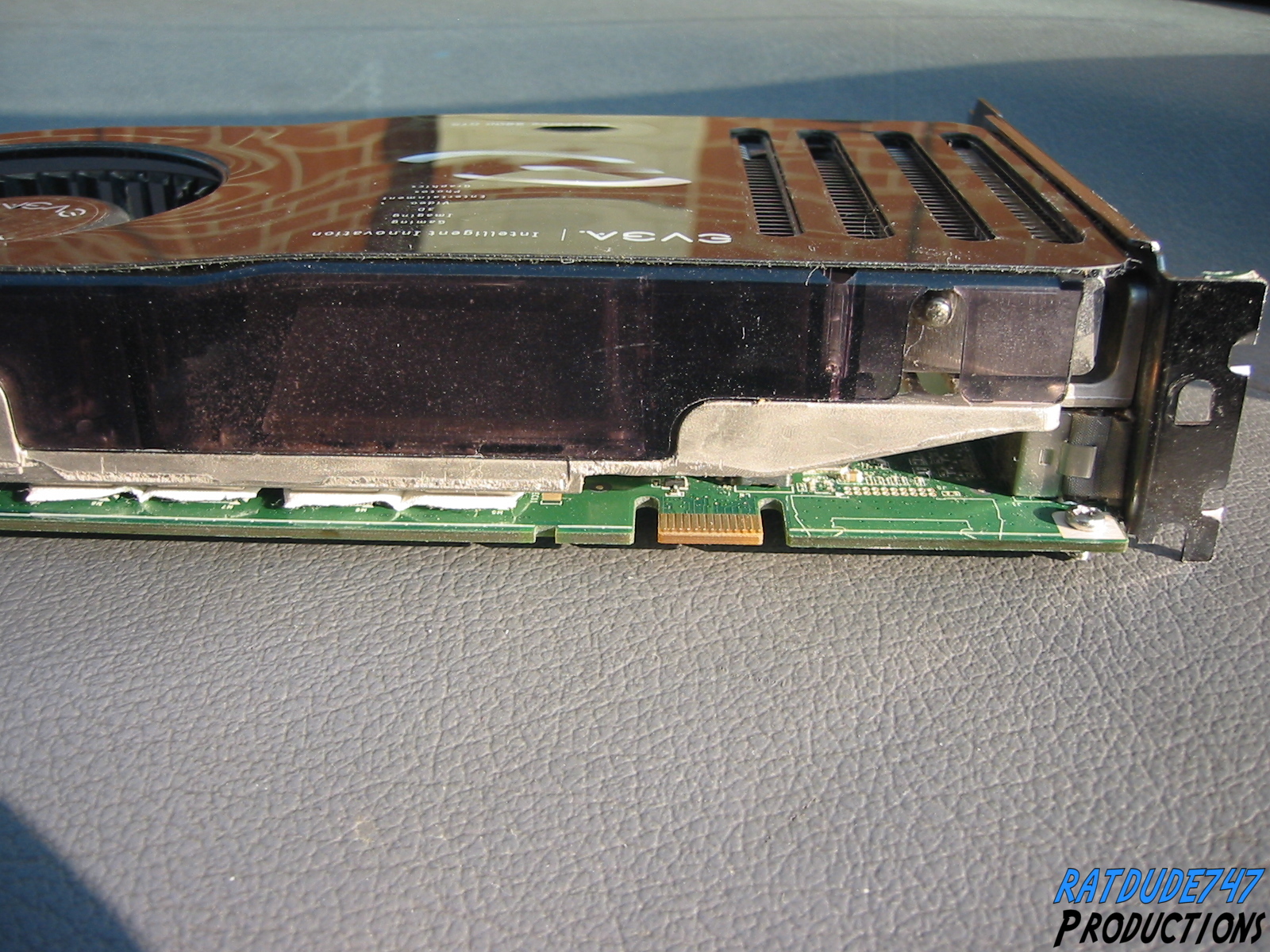

      Good card and damn good deal if it works, but make a 110% sure the heatsink is clean and get new thermal pads for the RAM (the rubber-like type).
      These cards have a design flaw (no.. not that it's a nvidia :P) where the thermal "pads" (whatever material the originals are) shrink over time, causing almost no heatsink contact for the RAM which can fry it.
      I still have my Leadtek PX8800GTS 320MB (little brother of your card) somewhere. Damn good performer for its time, but the G80 does run HOT!

        Will do on the pads... I have a couple sheets of pad that I can cut from... I also have one of these:
        http://www.newegg.com/Product/Produc...82E16835118001
        (never mind, I think it may be missing 2 of the 4 tie down bolts... it and the RAM heatsinks were pulled of a fried ATI card)

            I know. luckily it has a massive heatsink.
            I replaced the pads and thermal compound... for the pads, I used T-Pli 250 cut with an exato knife, as that's what I had a couple sheets of. There were pads for the RAM (12 chips), daughter BGA chip of some sort, and VRM silicon (4 pads, 12 Mosfets). Once I cranked down the bolts, it all came together nicely... everything has good solid contact, including the GPU.
            The heatsink was pretty clean; not much to do there.

              i assume it worked when tested?

                The GPU? It was untested... It's goodwill.
                it was from a ritzy rich area goodwill... I think somebody put that gtx 460 card in thier box as an upgrade and chose to donate the old card and the sticker they didn't use...

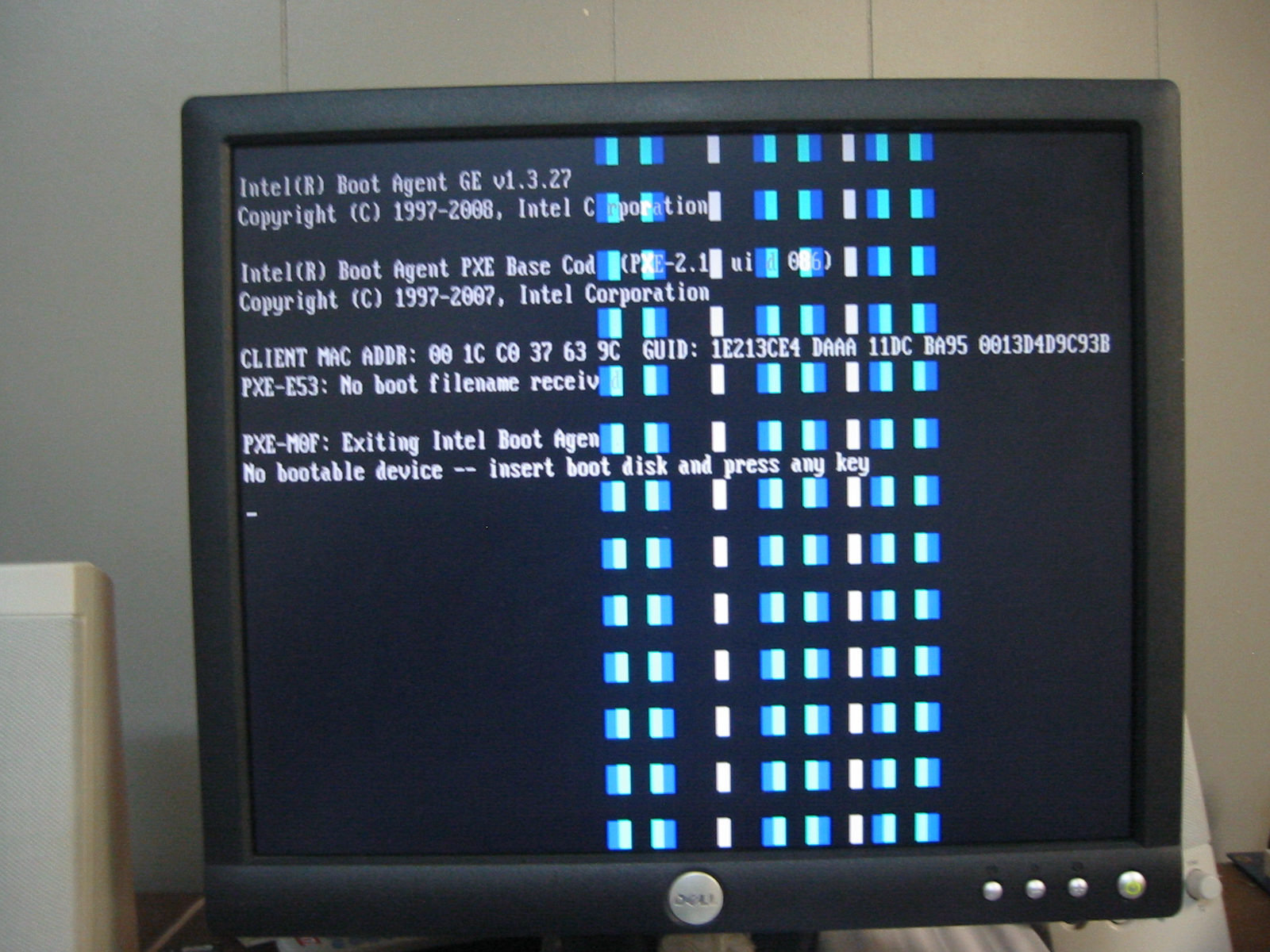

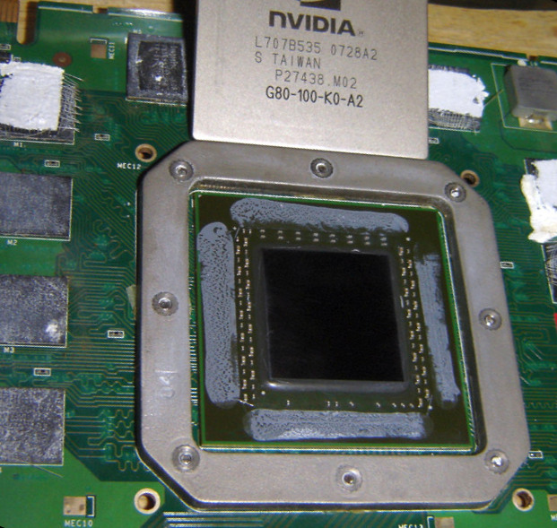

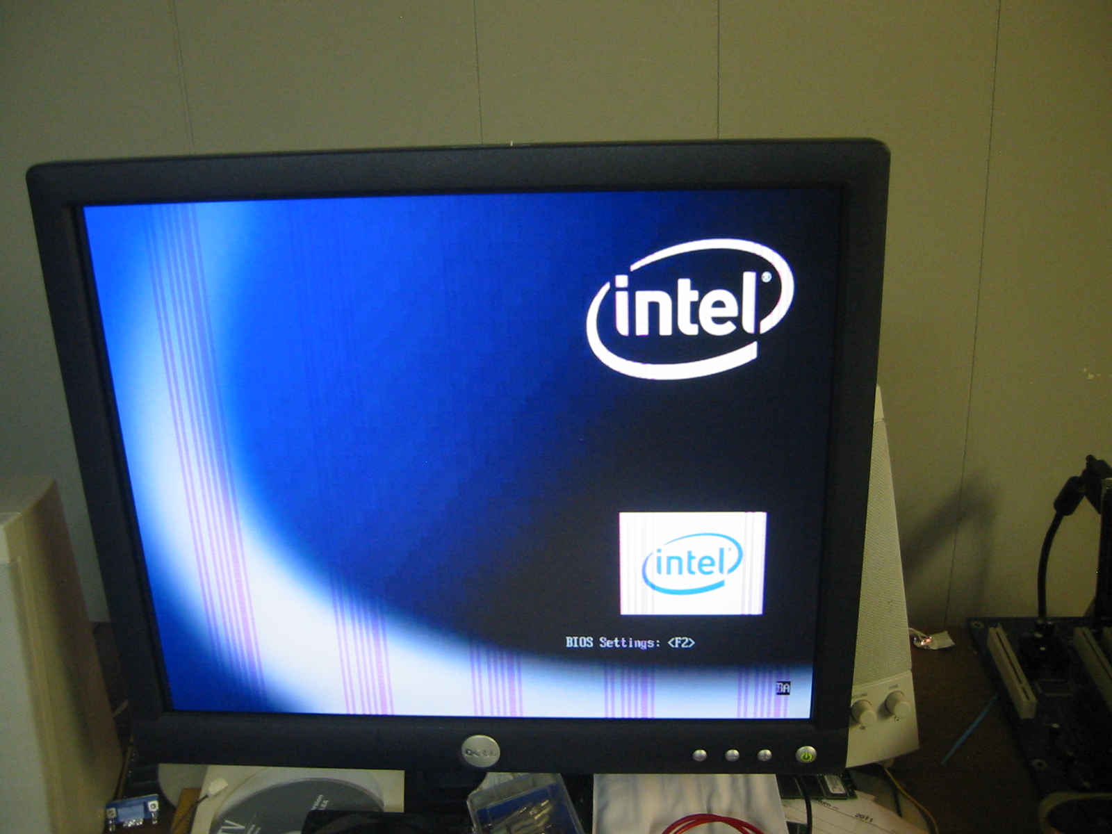

                  The GPU might be toast.
                  attached are pictures of what I saw... IIRC that means that underfill in the GPU is roasted (ie it couldn't be saved by a reball).
                  comments?

                    Damn, thats too bad....it's toast for sure. It was worth a 5-dollar gamble to find out though. I've bought hardware cheap a lot of times and gambled that it was good....You win some you lose some....you will win more than not though....so keep your eyes peeled!
                      comments?
                      Oven method (as there's nothing to lose at this point).
                      The G80 core based cards (8800GTS 320/640, 8800GTX, 8800 Ultra) don't really have the bump/underfill problems. The bump/underfill problems are on the later G86 and G84 based cards, i.e. anything Geforce 8400 to 8600, which were (unfortunately) very common in laptops.
                      G80 cards either have BGA issues (card flexing ; heavy heatsink) or fried RAM (the thermal pad problem I mentioned before). Or they generally overheat due to asswipes never cleaning the heatsink, making them fail much faster.
                      I've revived four G80 based cards (two 8800GTX, two 8800GTS 320MB) with the controversial oven method so far. All of them showed artifacts like in your photos and most of the time, slightly pushing on the card or squeezing it with your thumb and index finger where the GPU sits varied the amount of lines or weird blocks on the screen. Those revived cards worked fine for months in various PCs till I sold them on ebay.
                      On the other hand, I've never been able to get any good results trying to "oven reflow" any GF8400-8600 so far. On some of them, the symptoms didn't change at all, while on others the oven reflow made it worse or ended up killing the GPU for good (no image at all).
                      Oh and btw.. The G80 is HUGE! The GPU package is about the size of a 486, which doesn't really help when the board is flexing in the slot because of the heavy heatsink. The metal frame around the GPU (which isn't part of the heatsink) doesn't really seem to help much in the long run either..

                        yeah, It's a biggie.
                        Ive never done a reflow... Don't I need to get some needled flux and a heat gun?
                        but the RAM- I think the pads were still making contact when the heatsinkw as pulled.
                        Last, the GPU got HOT fast during the tests...
                        I was given an ATI card that starts good but as one loads it it goes to hell... similar problem?

                                If it displays a picture, it's far from toast. Artifacts can be caused both by bad BGA joints on the RAM and the GPU, so you should reflow both.
                                Any flux will do - both paste and liquid work in my experience. Since your video card is lead-free, reflowing without flux opens the possibility of tin wiskers forming between the BGA joints and bridging them. So using flux is highly recommended. Don't go overboard, though (i.e. don't do like most people show on YouTube, where they drown whatever they are reflowing with flux - that's bad).
                                As far as oven vs. heatgun:
                                - if using the heatgun, heat the card from underneath first (i.e. don't heat the chip directly from top as most people show) and heat the whole card slowly on low setting. Heating/cooling quickly puts a lot of stress on the board. When the flux starts bubbling and you can see the solder on the top side of the video card is shiny, proceed to heating the GPU chip from top. Don't heat to more than 250C either.
                                - if using the oven for the reflow, make sure to cover all plastic parts with Aluminum foil and don't wrap it too tightly around them. Also remove any electrolytic caps (polymers can stay). Then put card in the oven (with flux under the GPU), set to 220-230C, and let it reflow. Once the oven temperature hits 220-230C, let the video card sit in there for about a minute, then turn off the oven and carefully open the oven door. Do NOT move the card or the oven - let it cool down well before handling.
