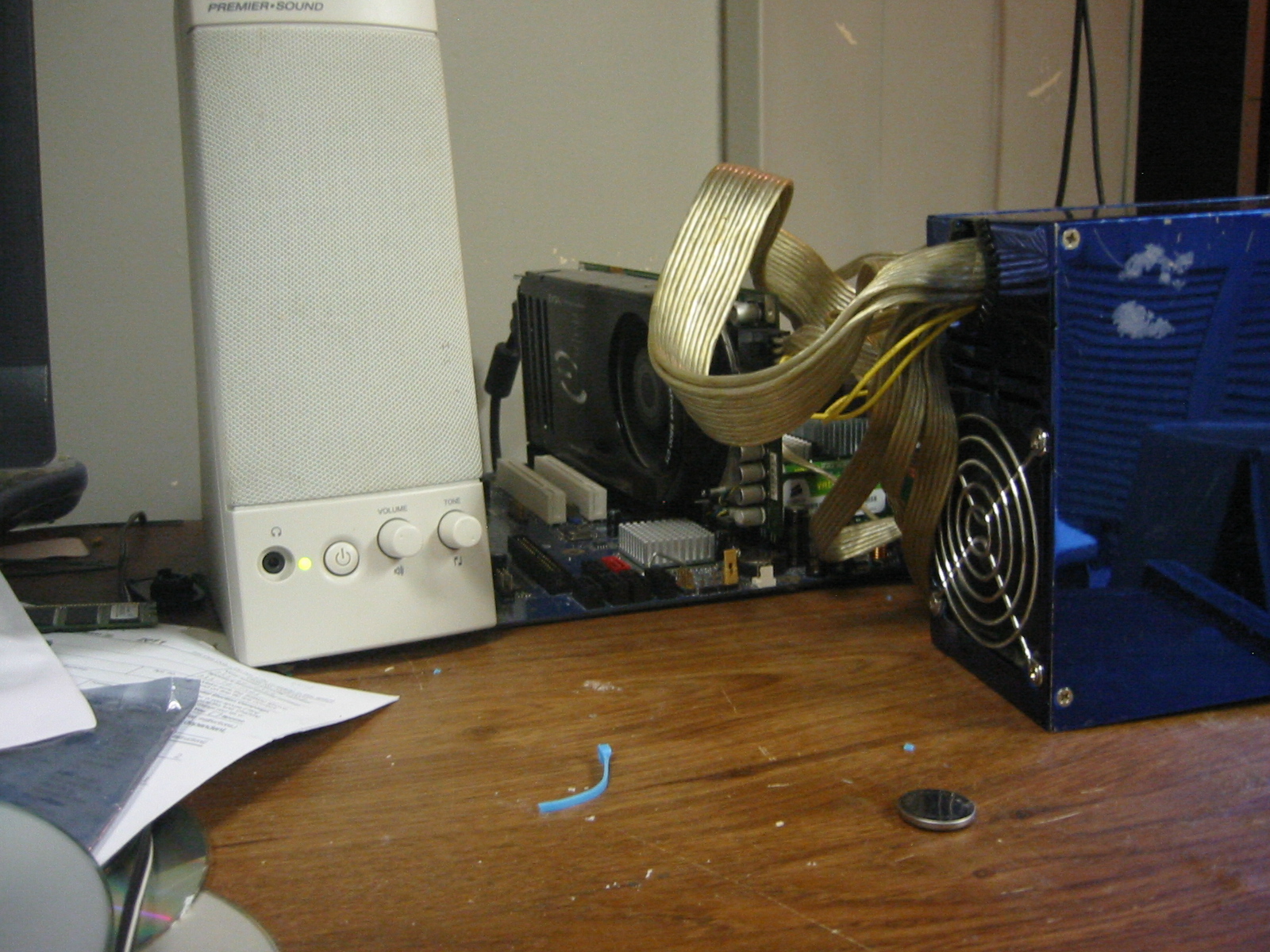

      I bought some Paste flux in a syringe at Fry's Today. I oven reflowed it tonight.
      So far, It looks to have been a success:
      The setup:

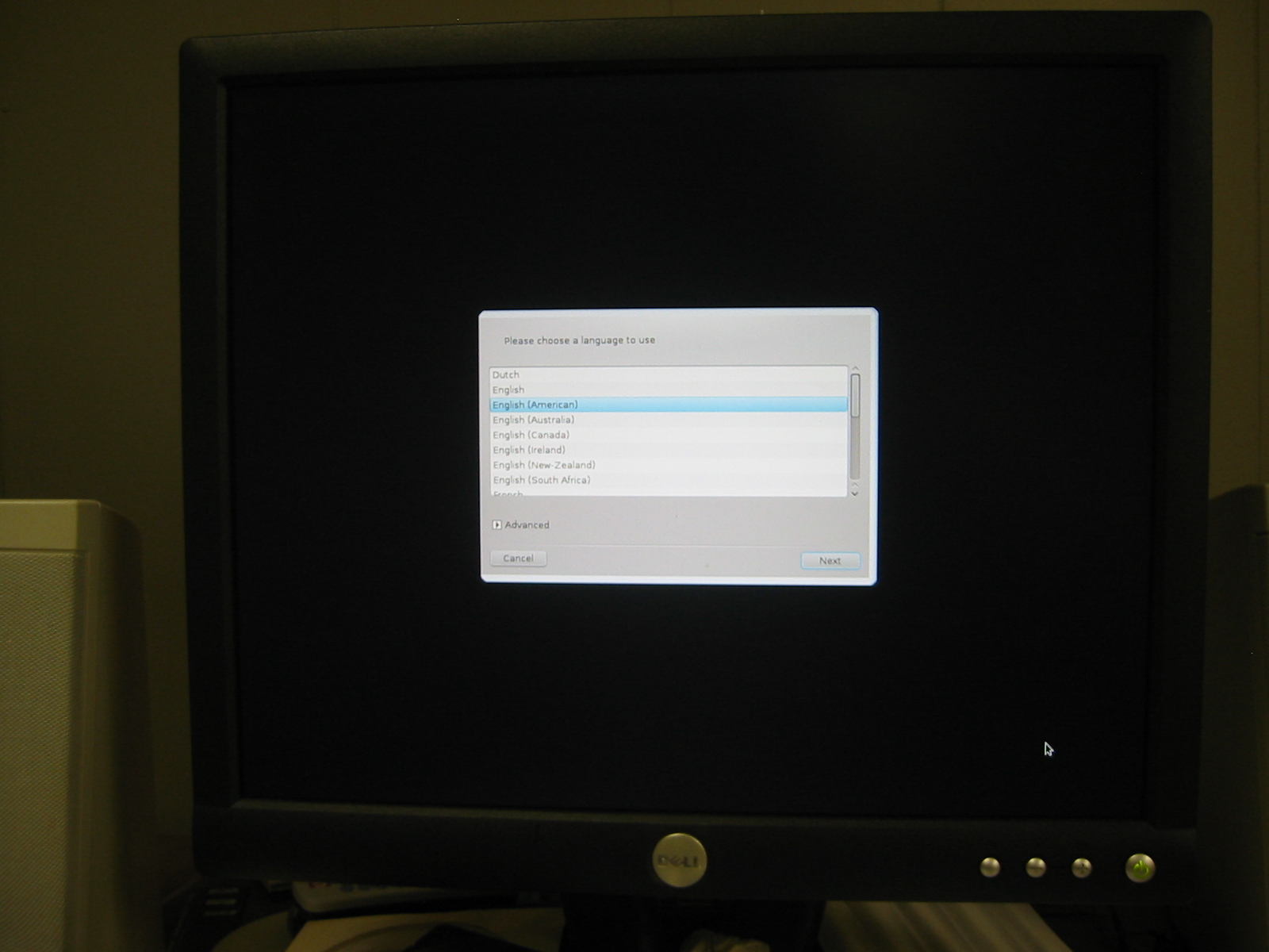

      A shot while booting Mageia 2 from a usb stick:
      Once I got to the desktop, the graphics kept on lagging, which I suspect is a driver bug, not a card fault.
      Comments?

      • Uranium-235
        Comrade Glimmer
        • Aug 2007
        • 5045
        • US
        Re: Nvidia GeForce 8800GTS
        son of a bitch I think thats nearly the same model 8800 GTS I have in storage, except mine is half the ram
        nice find. If you ever tried the goodwill in DFW they would of probably listed it as $100 untested AS-IS no returns. They're still idiots over there, I wish I could of changed things.
          Sweet!
          I like the shiny paint on that Ole Blue .
          Most likely yes. I've had that happen multiple times when trying to install the latest and "greatest" drivers for some old graphics cards. It's best to stick to an older but proven version.
          I say give it a try in Windows with both old and new drivers and see what happens.
            Originally posted by momaka
            Sweet!
            That was mandriva usingNouveau... no Windows since that would require a HDD to try. I am out of decent HDDs that I could use... If I ever get a decent case and a HDD for that, I may make it into a multimedia rig.
