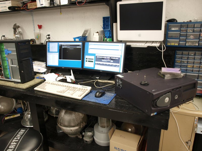

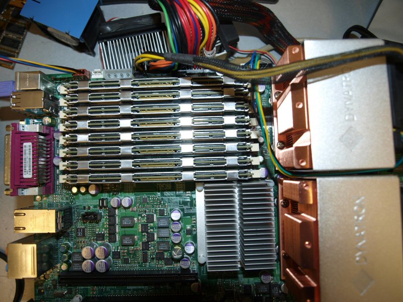

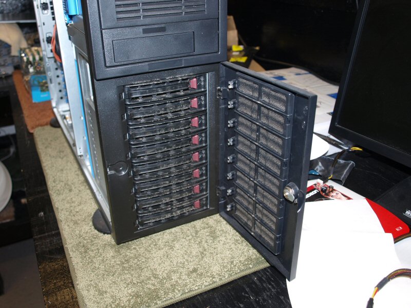

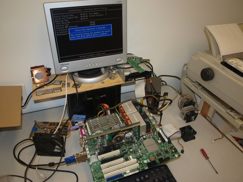

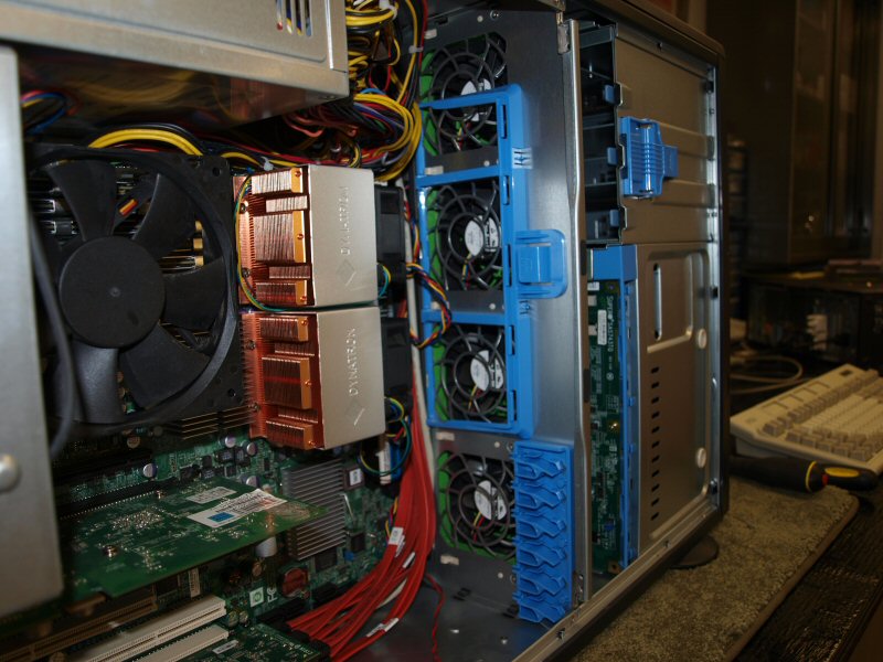

          Old Trusty 'Frankenserver' has been decommissioned today, its duties offloaded to a temporary shit system pending the commissioning of Frankenserver's replacement, FrankenMama.......
          The heatsinks arrived, and I did a final round of tests, all A-OK.
          Of course some pics:
          Frankenserver shut down for the last time....
          Patiently waiting....
          A few more of the retiree...
          ...and since I'll be losing my SLI abilities (Seaburg chipset supports it, but the board doesn't have the required nvidia SLI bridge chip to make it active), I'm going to go with a dual monitor setup instead. I'm not a gamer, so this will be far more beneficial to me, as I'm more in the 'power user' class, not the gamer class. Its not uncommon for me to have 10 windows open, so a pair of 24" 16:10 monitors will be very nice (the monitors shown below are 22"). I've been testing this on my hotrod Dell Precision 470.

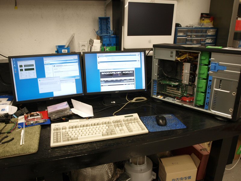

          I will commission this system as my office machine as well, relegating the Asus All in one to the workbench (where you see the iMac in the pics). The duties the Frankenserver performed were a complete waste of power, so on top of those duties, this machine will also be a daily use system in the office as well. She's well on her way though.

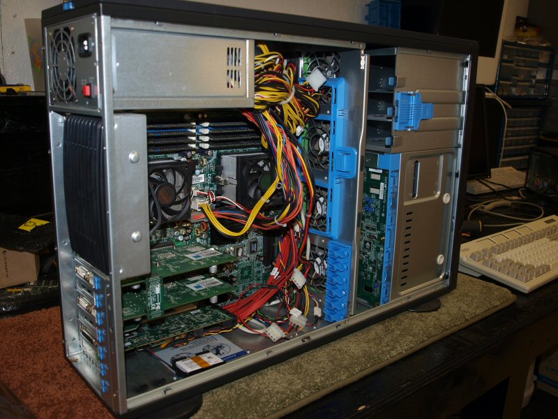

              Yes, that is an old clicky keyboard. A place was clearing those out abotu 11 years ago, and I bought 5 of them, brand new in box. I'm glad I did, they're impossible to find today!!

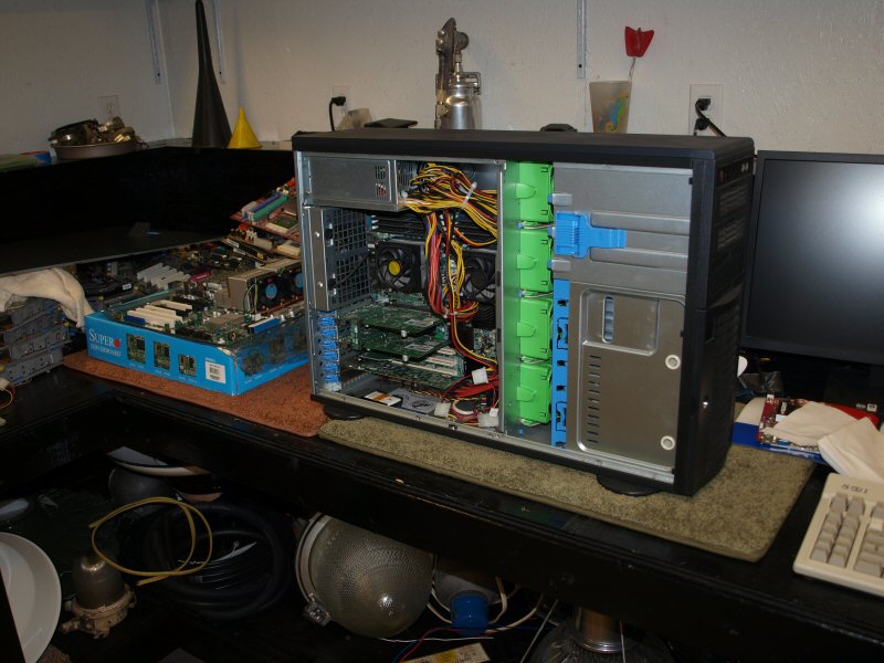

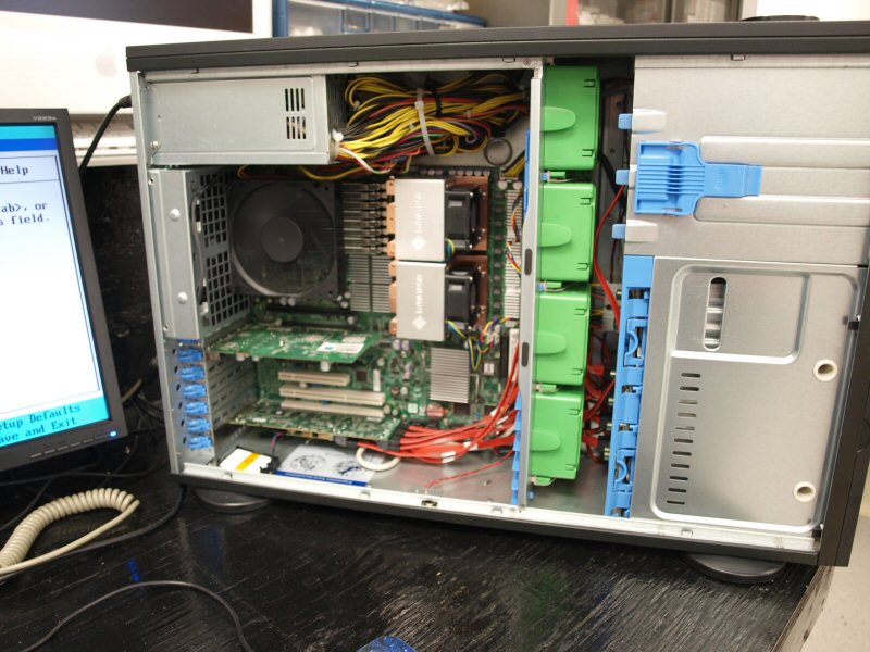

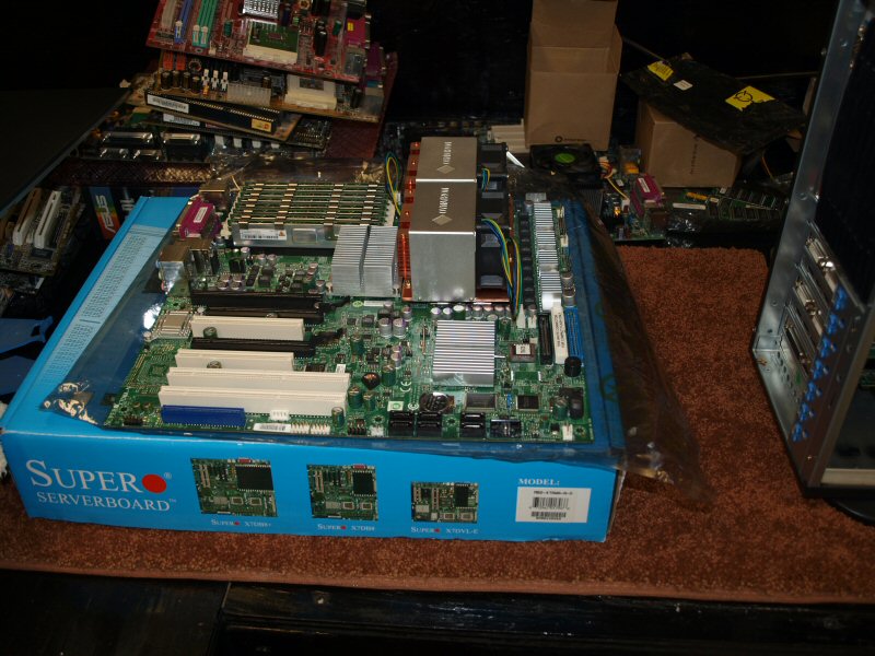

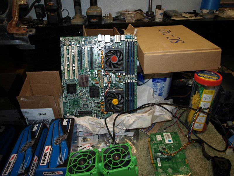

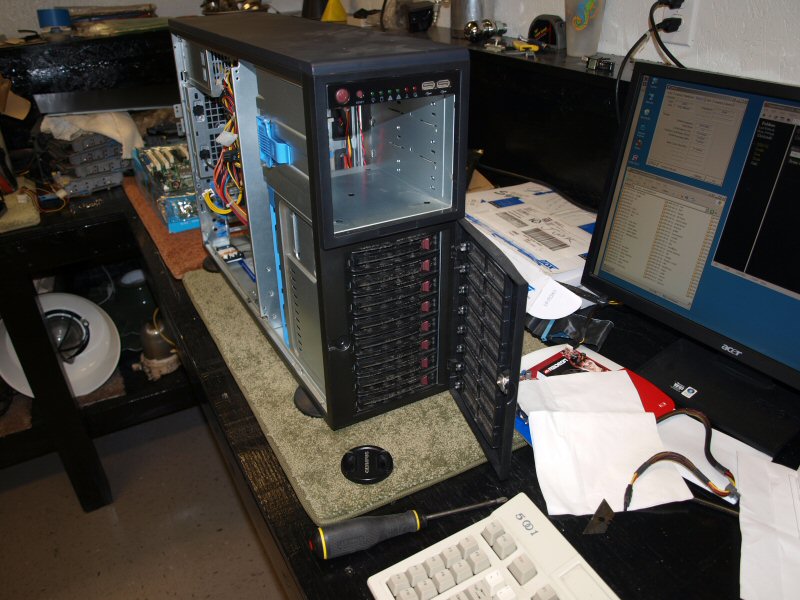

              It's alive! Encountered no problems putting it together. I do love supermicro boards in their intended supermicro cases....the front panel header and LED's are a standard ribbon, just plugs into the board....no guessing if you have the polarity backward for the LED's, and then of course the mess of those little annoying wires... I also stuck a pair of 160GB velociraptors in, set as a raid1 for the boot array.... It had a pair of WD blues. To their credit, the blues performed better than I expected on the 3ware controller, and were 100% reliable. They ran for 24/7 for about 2 years. Never had any problems with them being in a RAID or any other strange problems...
              The Tyan S2895 removed from the case:
              Empty case in need of a blowjob from the air compressor

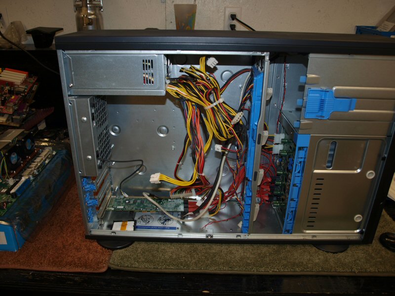

              All blown out and the new board installed:

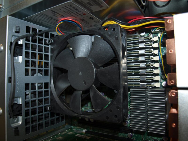

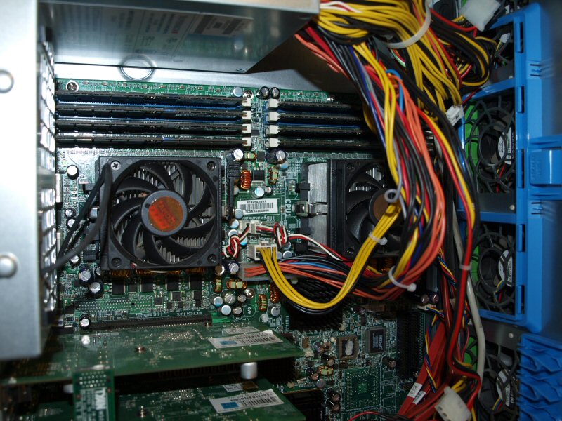

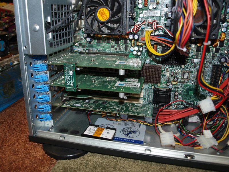

              No build is complete without atleast one ziptie mod....here's mine... The airflow over the RAM was lacking, and this FB memory gets miserably hot unless the onboard fan controller is disabled and the fans run full speed (insanely serverish loud)....so in comes a 120mm 4 pin fan I scavenged out of an old HP media center PC to the rescue. Being 4-pin, it plays nice with the onboard fan controller. I can keep the fan controller in quiet mode, and the memory stays nice and cool. The fan is zip tied to the metal mesh, nice and firm with a couple strips of felt between the fan and the case, so it won't vibrate or rattle. Fan looks like it was born there!!
              The four 80mm front fans. All the fan headers on the motherboard are in use. Another thing I love about supermicro, they put plenty of fan headers on their boards, and are very controllable in the BIOS.

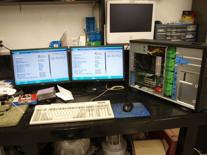

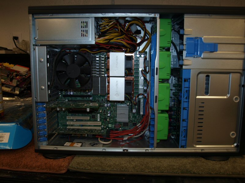

              ...Houston, we have ignition!

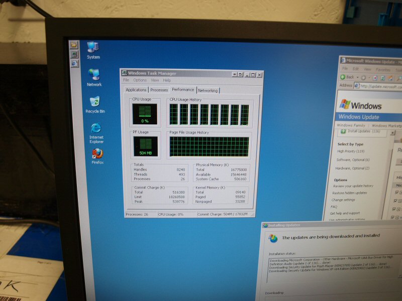

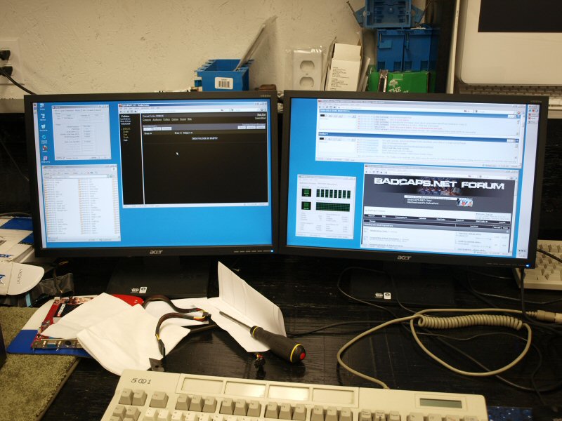

              Just for the XP haters, its XP Pro x64!
              all 8 cores and 16gb of PC6400!! hello FrankenMama!!
