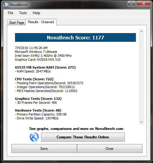

          Reran novabench after the reload with better drives and a newer SAS controller. Disk score came up a lot better....but this GPU is killing me!!! I need toe 4x DisplayPorts for my monitor configuration though. I wonder if I could run 2x GPU's, not SLI/crossfire, as that's not supported.....but be able to run 3~4 monitors off 2 separate GPU's...have to tinker with that one maybe.
          Anyway:

            Re: My Latest 8-core Project
            Anyway:
            Ouch, the Quadro 1000m in my Precision M4600 scores (slightly) better than that NVS510 and the 1000m is a 4 year old midrange mobile GPU.
            It looks like PNY makes the Geforce GTX950 and GTX960 with 4 display ports that would offer a substantial performance boost without breaking the bank:
            http://www.newegg.com/Product/Produc...28&ignorebbr=1
            http://www.newegg.com/Product/Produc...27&ignorebbr=1

                #87
                Does your system do what you want it to do and fast enough? Yes? Then who cares about those benchmarks.
                It's like the Windows User Experience Index - just bullshit numbers trying to get you to switch to new hardware.

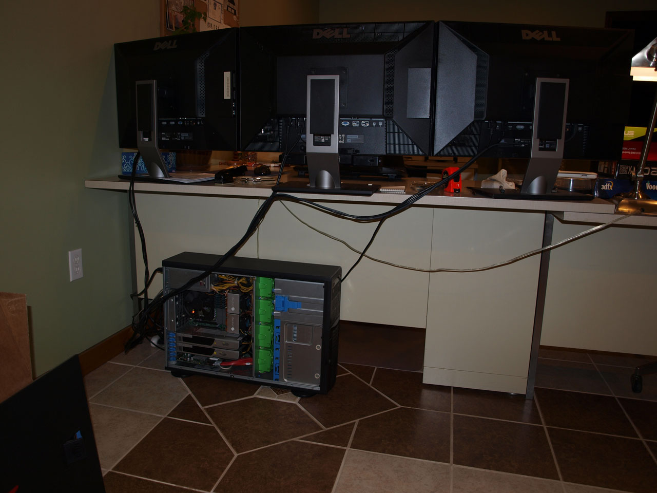

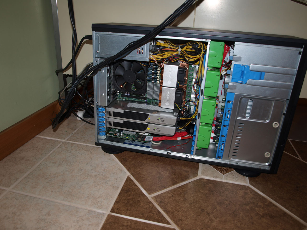

                        Just another little update since I got a box containing 5x quadro FX4800's and one FX5800... The NVS510 was ok.... It was easy to overwhelm it (camera software with a 6~9 camera split would make it groan a little), especially driving 3 monitors. I put a pair of the 4800's in this system, which worked out well since each has 2x displayport connectors on it. The 5400 series Seaberg chipset doesn't support SLI, but that wasn't the goal here.... The heaviest used display of the 3 is the middle one, so it has its own GPU and is the primary. The secondary GPU runs the two on the sides. Under load, its a lot smoother. I only noticed one 'quirk' using 2 GPU's over 1, and that's only in firefox/waterfox. If FF/WF windows are open on the side displays (the secondary GPU), if you resize them, it FUBAR's the aero glass effects, making the address bar appear 'washed out' and hard to read. It does this only in mozilla, no other program has this issue, and I've not been able to figure it out. A FF/WF window in the middle display (primary GPU) never does this, even when the other are doing it. Aslong as you don't try to resize the windows on one of those displays, it doesn't do it....so you have to set the window to the size you want on the middle display and then drag it to the side display....and it'll be fine. It didn't do this using the single adapter. I eliminated hardware, as I played musical GPU's, they all did it....and only in firefox/waterfox.
                        Ohh well....such as technology.... It still performs better!
                        pic of the quirk...note the address bar difference and the area surrounding the menu bar:
                        ...and it only does this if you attempt to resize a firefox window on the side displays... I found no information on this anywhere.
                          Nice, but... I think you are seriously suffocating those video cards!
                          The GT200b GPUs are rated for 182 Watts TDP, and they really need all the air and cooling they can get. Perhaps the way you have them may be just good enough for desktop use, but anything that taxes the cards even a little bit can make them overheat. IMO, you should check your temperatures with MSI Afterburner or Riva Tuner to make sure they are okay.
                          Oh, and your center monitor looks like it's hanging right at the end of the desk, ready to fall.
                          Other than that, nice solid build!

                            These cards draw air in from the front edge of the card, and there's 4 fans in the midplane...this case passes a lot of air. The cards exhaust out the back. It really doesn't get that hot inside the case, except that crazy hot fully buffered memory. 182W per GPU....they really don't get all that hot under normal loads, but if they were seriously taxed, I could see that for sure.

                              • ratdude747
                                Black Sheep
                                • Nov 2008
                                • 17136
                                #95
                                They make these SLI-able, which for modern triple SLI on a 7 slot ATX setup (ignoring the 8-slot taller ATX variant for this post) means at least two cards will kiss like that, which means making the cards so they can breath in such a placement. This has the side benifit of working better on "older" PCIe systems like this (or my various socket 940 Nforce pro 2000 builds) which put the two PCIe x16 slots like such. Such as the tilted fans on my old GTS 250's.
