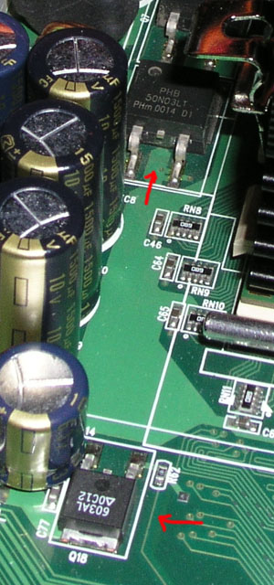

    Ok awhile ago liquid got spilt into my system, i cleaned it all out with an alchohol cleaner, it powered back on
    the lcd screen backlight, goes off after 20mins, i can hear a buzzing noise where the dc power jack is located, its a clip out jack so i thought about replacing this but the cost is stupid!
    i've noticed on the board there are a few small chips that look burnt, now matter how much i've cleaned and brushed with a toothbrush it remains.
    i looked at replacing the board but after checking the prices again $450 is too much!
    anybody know a place to get them cheaply? ive checked out http://sparepartswarehouse.com but still they are up there with the expensive bunch, and they order direct from sony so its a no go.

    Ok just to reitterate,
    heres my problem im really hoping someone who knows anything about this will reply as this laptop is my lifesource and without it im lost, and not able to afford another for awhile.
    ive searched the forums and found some useful threads but nothing that will help me, my model is the VGNFS195VP
    I apologise for the long thread beforehand but i need help guys!
    i believe its a power issue, if you read my previous post it will fill you in
    whats happening is that after i've cleaned down the board i got it to work and power on, but the problem is the screen will not last long before the lamp dies, i dont think its anything to do with the cathrode at all, because i hear an electrical whine coming from the power jack, so it has to be something to do with the power point on the board
    it will power on after a few mins of waiting, and i can get it to function OK for about 30mins before the screen lamp dies, everything else remains OK.
    before it does this i hear something like a power surge, (high pitched whine) right before it dies.
    replacing the board isnt an option as i cant seem to find one cheap enough.
    the power source is 19.5 volt and this works fine with my other laptop so its not this.
    any ideas guys?

      its a rather small rectangluar chip with two prongs into the board, one looks rather crispy but not sure if that has anything to do with the power at all.

        Re: Sony Vaio VGNFS195VP system board power problems
        like one of these? what is written on the top of yours.
          no its not like that its very very small, i will take pictures asap
          i've noticed that if i attempt to connect the battery, the battery light flashes, but within windows it tells me that the battery is either not compatible or something else is wrong.
          and when i look in the power status it reads as discharging

                laptop was working perfectly fine before the incident, no buzzing or power problems ever?
                its difficult to troubleshoot actually. we will need to see pics of the burnt items and also some overview pics of the board to figure out what part of the circuit they are in. i am guessing they are fets in the charging circuit. if one is actually burnt i doubt it happened before the incident.
                hmmm....what is that? some circuit starting which fails or something gets hot enough to fail at that point? interesting

                        Ok now its getting odd, if i hold the laptop in an upright posistion (sideways) the lcd backlight does`nt cut out!
                        but there has to be a fault with a circuit somewhere otherwise the battery would charge up right?

                          Screen problem sure sounds like the inverter coupler cap. They will whine awile and work intermittant before they roast.
                          Is it possible the battery itself was wet?
                          Most of the battery charge and control circuits are in there.
                          Jim

                            well the whine comes from the power source, the point where the dc power point is on the motherboard if you understand? even without the lcd plugged in it still makes this whine noise
                            if only i could get my hands on a new dc lead to test if the fault is there, but they are just sooooooo expensive.

                                    just to update, i've checked against other boards and its definatly a dead board well, half dead and not just a bad circuit, the circuit itself was fried as i mentioned the chips that were burnt out supply the power back and forth to the lcd and other parts and when underload it cuts out and kills the lcd lamp
                                    sad ending
                                    but now i've got the task of finding another system board thats under £200 wont be easy as sony are tight about upgrades

                                      If you provide some pics there is some hope that we can help you. Power sections in laptops are usually not that complicated, in most cases there is an buck step down converter, an charge controler and a high voltage circuit for the lcd light. May be all those funktions are integrated in one chip. As far as there aren`t mutch SMD components you can repair it probalby. But if the 19v dc has reached the cpu or other circuits there is no hope enymore.......
                                        since it works for 20mins, looks like that did not happen
