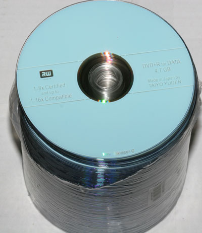

                              if you want to buy any optical media or drive check http://club.cdfreaks.com first. even the best companies drop a turd now and then. and dont get me started regarding media i have seen so many companies switch from decent manufacturers to shit now that i just buy Taiyo Yuden own brand unless i just want some crap to burn some drivers for a build.
                              BTC is sold to Foxconn. they will sell CD writers under BTC and DVD writers under Emprex.

                                delivery! imagine this company is so retarted the delivery man wants me to come down to the parking to collect the box.
