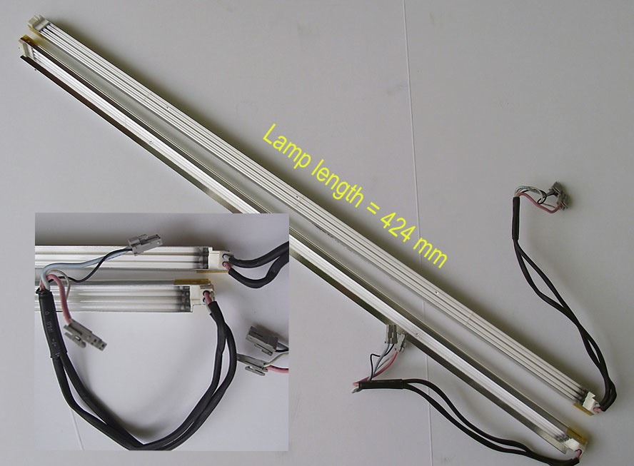

    I'm repairing a few of these.
    Basically, ALL offer the same fault: on for a few seconds - or minutes - and off or intermittent.
    Some have power caps problems, but I found out the screen lamps are basically the problem.
    My question:
    Monitor goes off because internal sparking in the faulty lamp?
    [See picture of one such lamp]

    You are experiencing 2 seconds to black.
    The inverter pwm circuit works as an "all or nothing" meaning all ccfls work or none at all.
    As ccfl bulb age, they draw more current. They look like your picture. Alternatively, the wiring can be bad. See
    http://s807.photobucket.com/albums/y...klight%20lamp/
    Replacements (bare or pre-harnessed) can be found at ccflwarehouse.com, ccfldirect.com, and ebay. The first has good feedback from members here.

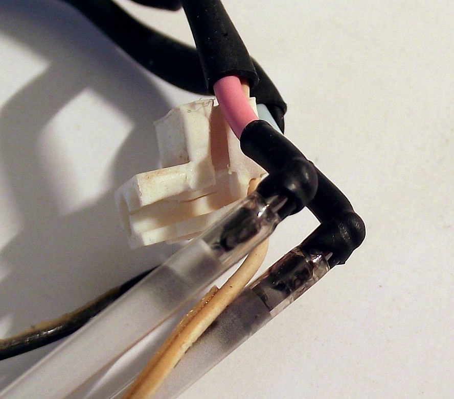

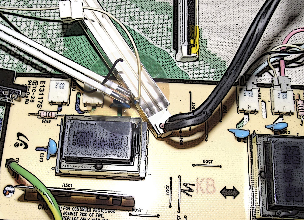

                  The lamps' cables were the problem with this monitor.
                  I've now repaired quite a few by resoldering them.
                  Most of the time it is only one on the top lamps, which is either burned or disconnected, just sitting on the lamp's terminal causing arcing.
                  It is a delicate job to unglue the wires and remove the two lamps; they can brake easily.
                  Note: the burned wire [or lose connection] is on the other side of the lamp, not on the side of the plug.
                    If that is the thinner guage wire, that is the return wire. This is consistent with what alexanna reports.
                    Good job on the repair work. I tried one and gave up. Too delicate for me and my soldering equipment sucks.

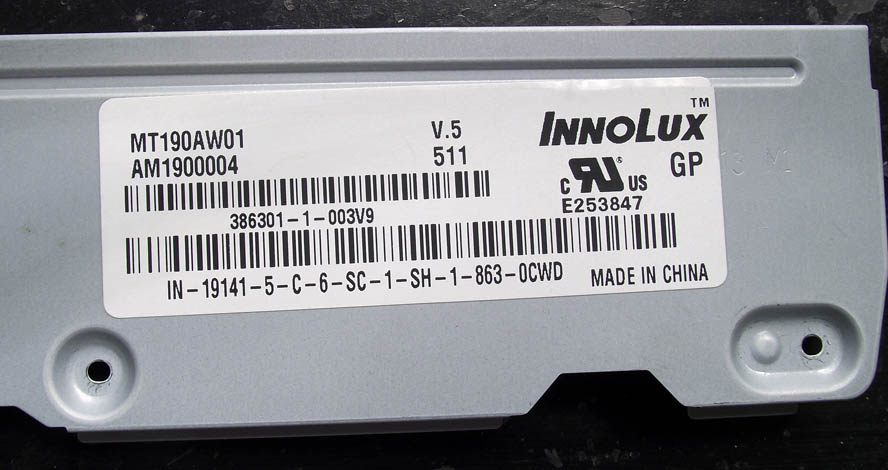

                          Just curious.. who's the panel manufacturer?
                          My bet is on Chi Mei or Chungwha .. had so many problems with these 2..
                          • burntfingers
                            • Jan 2011
                            • 148
                            Re: Monitor lamps' faults
                            Apparently, InnoLux ... never heard about them.
