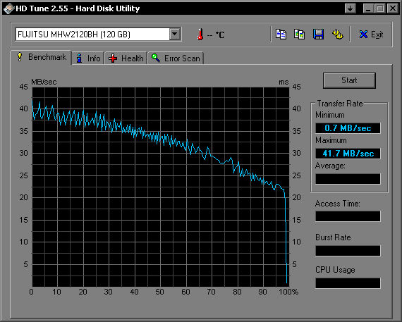

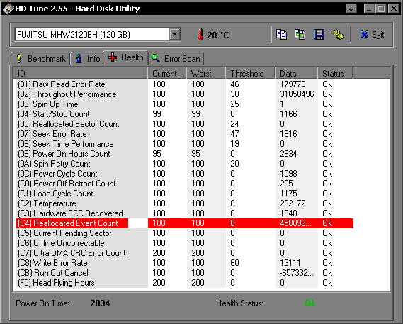

                      On that note, I was finally able to find a second SATA cable today to test these laptop drives. Well, the 40 GB laptop Seagate ST9402115AS I know works okay for now. It sure has a lot of reallocated sectors on it, though (1747 to be exact!) and almost as many pending. I dare not run a scan on it - it works fine for testing my new trash-picked socket 939 computer. At 1201 power on hours, it just seems too young to kill. See attached SMART log if you like.
                      As for the other 2 laptop drives:
                      - The 250 GB Toshiba spins up but does not get recognized in BIOS. I can't hear it click too much. I think it does calibrate successfully, but I'll have to open it and check. Need to find some small Torx drivers for that, however.
                      - The 160 GB Fujitsu actually worked! Yes, this is after opening the drive, getting the heads unstuck with a toothpick, getting the platters dirty by accident, and then cleaning them. Amazing! Of course, it didn't work for too long, though (maybe 1 hour total). I remember that even right away after fixing it, the heads would occasionally make a high pitched sound because one of them was probably too close to the platter (maybe even touching it). Regardless, I was able to get a reading of the SMART log from it today. It is attached in the image file (Disk Checkup kept freezing when trying to export the SMART log). Not only that, but I was able to format the drive and write some small files to it (I didn't get a chance to try large files, though) - granted Windows did crash once with a blue screen when it was trying to find the drive. But for the most part, it was all fine until I decided to run a HD Tune Benchmark - that one did it for good. At about 98%, the transfer rate dropped, computer started becoming unresponsive, both HD Tune and Windows lost the drive (couldn't see it any longer), and then finally, the drive began clicking and a blue screen followed.
                      Upon opening the drive again to see if it would calibrate, I noticed a deep cylindrical scratch about 1/4 way to the inner surface on the top platter.
                      I think I can safely assume that this drive is now dead. Although, I should note that even with the scratch, the clicking is still in irregular intervals because the drive is still trying to calibrate. I guess it just doesn't want to die yet!
                        Running a scan won't damage the drive. It'll just reveal damaged sectors that were not already marked.

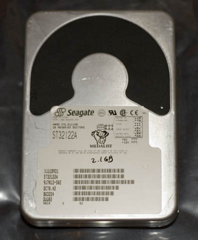

                          Oldest working HDD I have (of which I know that it's working, i.e. tested it somewhat recently) is a Seagate ST351A/X (40MB). One of the very last stepper drives, but with a single platter and thus relatively fast (for its time).
                          http://www.redhill.net.au/d/16.php (ignore the 40GB typo..)
                          I've got 2 even older drives but IDK where those are and I haven't been able to get an ISA MFM controller to test them in years.
                          One is a 40MB NEC, the other is a 20MB Tandon/Western Digital.
                          I also have a bunch of run-of-the-mill sub 2GB (200MB and up) drives that all still work. The crappier ones get used as a PSU dummy load every now and then. Especially the Conner CFS540A's don't seem to mind excessive ripple at all.. and I kinda like the sound they're making when they spin up.. *beeep* *slowly starts spinning*
                          Got about a handful of different Bigfoots as well. All of them still working fine, despite a few of them hanging on the wall as decoration for years..
                          They're basically DCU's (Dust Collecting Units)
                          Bigfoot CY 4.3GB
                          Bigfoot TX 6GB (Compaq OEM)
                          and a beautiful looking (black/silver) Bigfoot TS of which I don't know the size out of the top of my head ATM. The sticker telling the actual model number is on the backside and I don't feel like taking it off of the wall right now. What I do know is that the TS was the last series IIRC. They topped out at 20GB.
                          The others are buried in the closet somewhere..

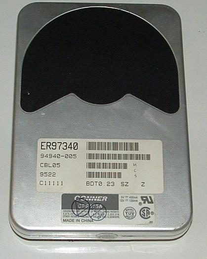

                                Definition of crappy???

                                    Old samsungs and fujitsus and of course the crappy connor-seagate hybrid f*cktards which are ridiculously slow and cheaply made, yet still survived all those years. Probably because no one used them for long lol
                                        The early Samsungs were indeed horrible, but the Fujitsus were OK for the most part. It was the MPG series with the faulty Cirrus Logic chip that was infamous.
                                        No wonder the Cabos were slow, as the 1.6GB models were the last 3600RPM 3.5" drives made.
