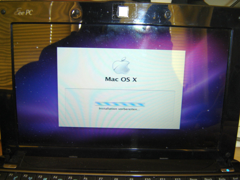

                              I solved the "Apple problem" my own way..
                              See below
