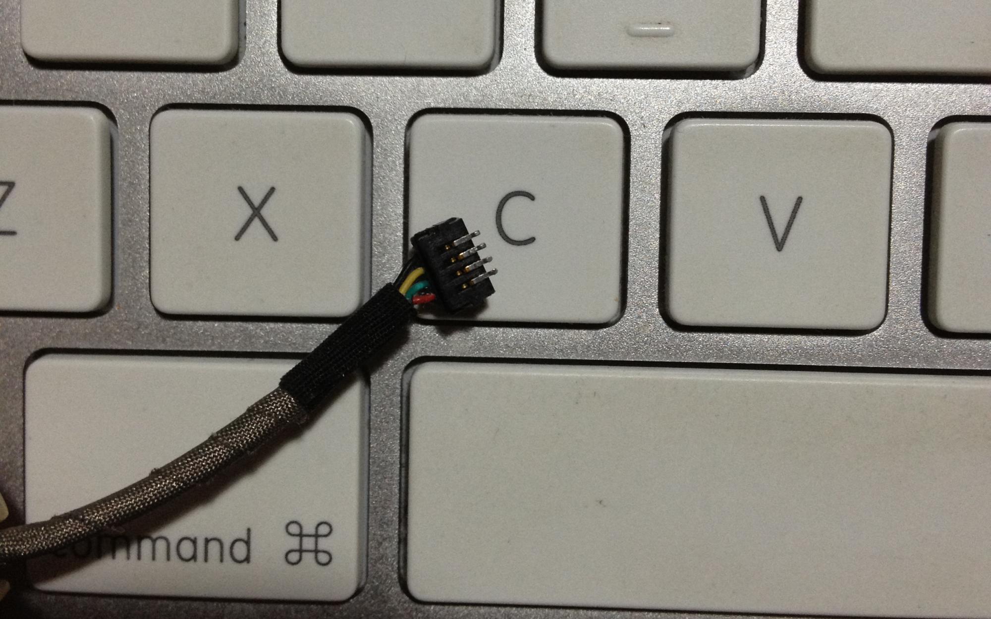

        I have a question in regards to this Macbook I got. Basically the last owner ripped the bluetooth connector off the motherboard while changing the LCD, but the solder pads and the ripped off connector are still there. I bought a 1/64 soldering tip which is as fine as a needle and also 0.3mm solder wire.
        What I want to know is:
        * Since the two clips on the side of the connector which hold the connector to the motherboard (to help the 4 small solder prongs as well) are broken, is it better to use RTV (silastic) or hot glue to hold it to the motherboard?
        * What do I coat with solder first? The motherboard solder pads or the prongs on the connector? In other words, how do you solder this to the motherboard properly since it's an SMT component.
        * What is the best way to hold this connector in place while soldering since it's a little shit.
        Thanks.

          A hot air gun with a tiny nozzle would be the best choice for this, and you'll need some solder paste. Remove the socket from the plug, apply solder paste to the 4 pads, and place the socket in its position. Then apply heat with the hot air gun until the paste melts and holds it in place.
          Normally there should be a metal strap that goes around the top of the connector and is soldered to pads on both sides. You can make one out of suitably small stiff wire, like from a paperclip, and solder that in place.

            I don't have a heat gun and knowing me i'd probably melt something else with it. Still, can I say hold the connector down with some tape then finely solder the leads?
