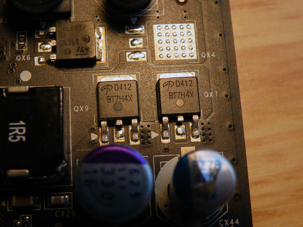

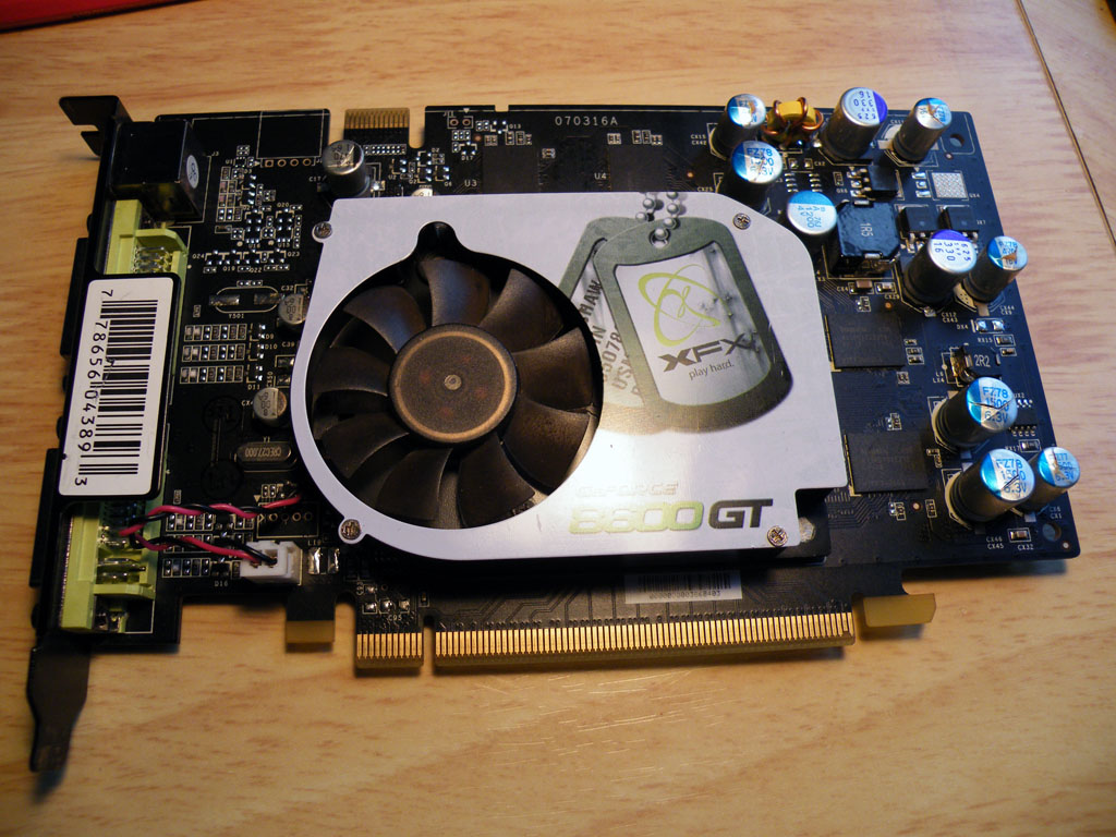

    I have one old video card XFX GeForce 8600GT. It got a lot caps gone and i think some mosfets are short. Capacitors is not a problem i have already found a replacements in farnell.com but mosfets are the biggest question for me. When i test a mosfets it looks like 3 of them are short. I have taken photos of them.

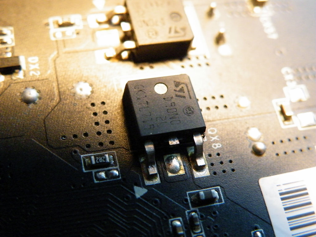

    There is a two different type of mosfets two of them is D412 and another one is D9020 2L.

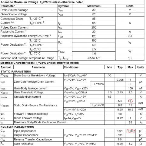

    For one of them i have found datasheet: http://www.ic-on-line.cn/view_online...07_4318425.pdf
    Other two was more diffcult to find a datasheet so i have got something from one russian website. I have included in attachements.
    So the main question: If i cannot find exact replacement for mosfet what specifications can be slightly different? I think i have found exact one but it costs alot of money but there is other ones much cheaper with slightly different values. So in my case what values i should focus on and which ones is not so important?
    By the way all bad caps is a cheap Sacon FZ series

    MOSFETs are extremely rugged. Chances are very low that any of them are shorted unless there's some obvious physical damage. Chances are that the chip they drive is shorted. Pull the MOSFETs and test them out of circuit. Then test the pads and capacitors for shorts.

      I would try and replace the caps and see if it works, and you should replace all those FZ caps. Only then if it doesn't work you should try replacing the mosfets.
